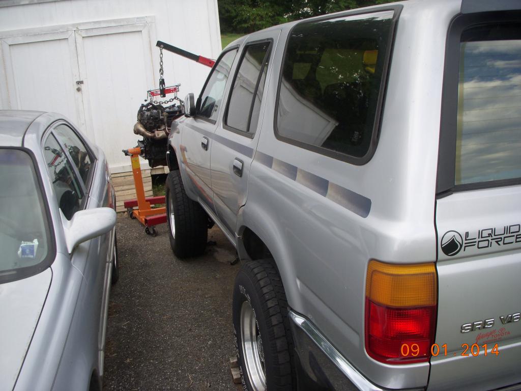

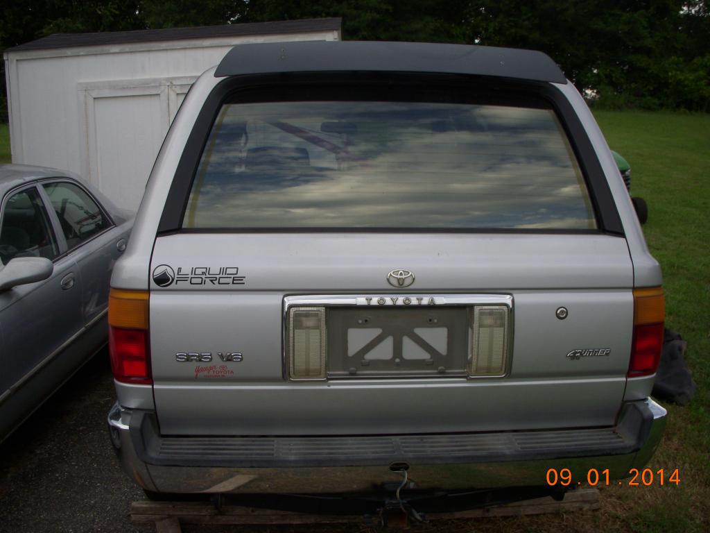

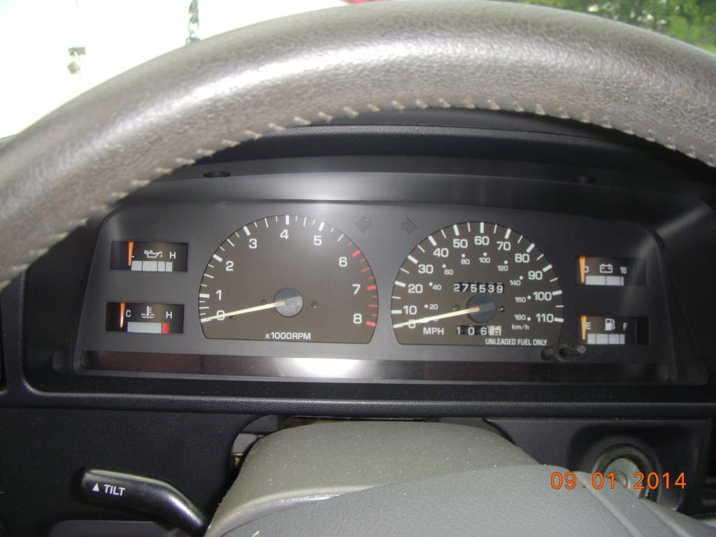

1992 4runner build up
I guess its time to start my build up thread for my silver 1992 4runner V6 SR5 5speed manual 4.30 open diffs. I purchased it approximately 3 months ago for a grand with a blown head gasket and 275xxx miles on it. The interior and exterior was very clean for the miles and all the electronics seem to work including the sunroof and rear window. Over the last 3 months I have only had a chance to work on it a few days. I finally pulled the engine today. As previously stated the interior and exterior were clean but there were signs of previous band aid maintenance repairs, poor reseal of oil pan, loose driveshaft bolts, and the odd standard size bolt here and there but overall pretty good. No rust as of yet.
I pulled the engine to do a partial disassembly to see if a head gasket job was worth the time depending how the bottom end looks or it may just be time for the 3.4 swap. Hopefully I'll get it apart tomorrow to find out.

Old Sep 1, 2014 | 04:22 PM
sphealy's Avatar
Joined: Jan 2014
Posts: 241
From: North Carolina

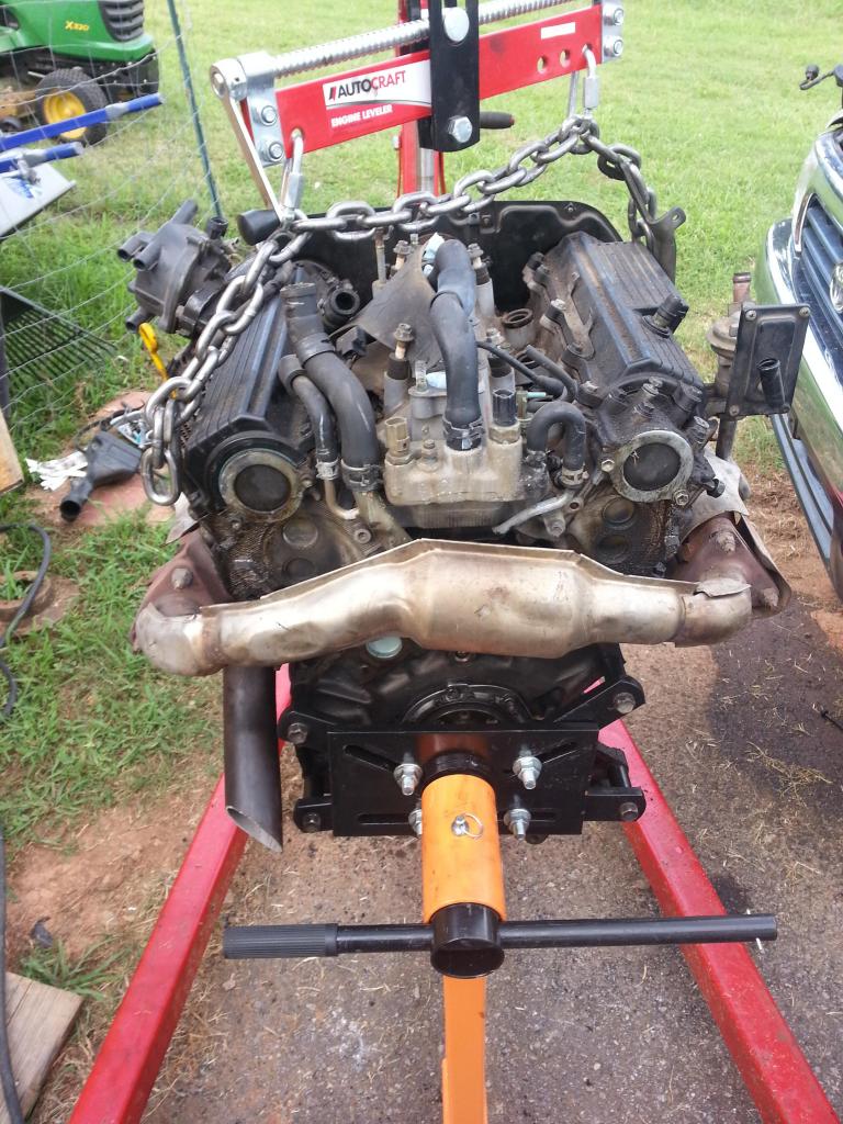

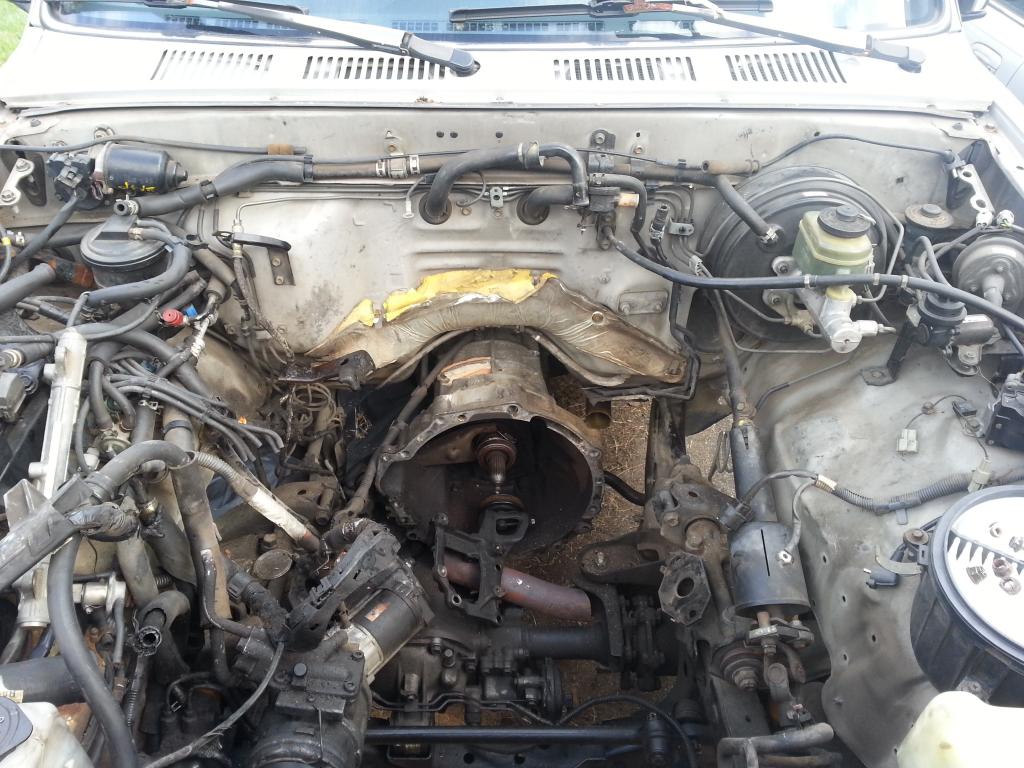

Old Sep 1, 2014 | 05:43 PM
sphealy's Avatar
Joined: Jan 2014
Posts: 241
engine bay...what a mess Name:  20140901_173342_zps3dbc55a4.jpg

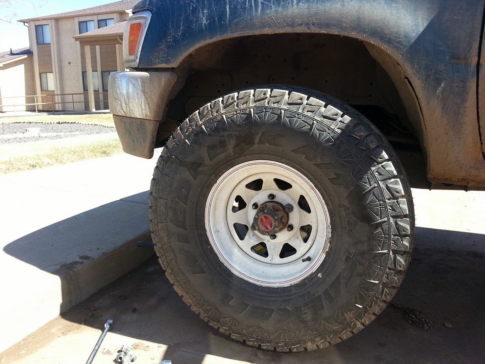

Old Nov 14, 2014 | 08:49 PM
4x4YOTA's Avatar
Joined: Oct 2007
Posts: 1,308
From: colorado
I fit 35s on my 94 4runner 100% stock rubbed at full lock but i only ever drove on the street so should clear no prob with 3.5" of lift
I really would like to run 35s to begin with so when I sas I don't have to by tires again but Iit looks very tight definitely no room to stuff them.

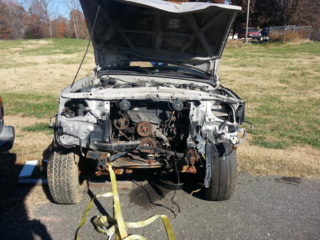

Got a little work done today. Pulled the 3.4 motor, computer, and engine harness. Still have to pull the body harness from the donor and a few other small things. But progress is progress.
Old Nov 15, 2014 | 07:35 PM
sphealy's Avatar
Joined: Jan 2014
Posts: 241
the donor vehicle
