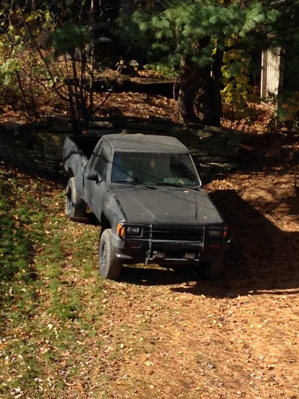

Just bought this beast for 350, the timing chain was broke and it needs a new head. A few cosmetic things but overall a solid truck.
Probably going to buy a re manufactured head from oreily auto parts. What kind of headers do most of you run on your 22re? I have a 95 4Runner with a 3vz but this is going to be my fist 22re build. Any suggestions are more than welcome

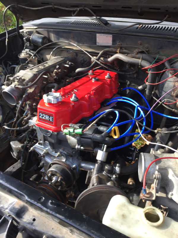

Starting to come together slow and steady. I am not sure about the placement of the power steering pump or the brackets for the belts. It was tore down when I bought it so I'm not real sure. Looking pretty good so far
Old Dec 1, 2015 | 06:12 PM
nwPaYota's Avatar
Joined: Sep 2015
Posts: 22
Well got pretty much everything under the hood done today and started it up. Ran pretty decent. Now on to the body work. It needs a rocker and painted.
