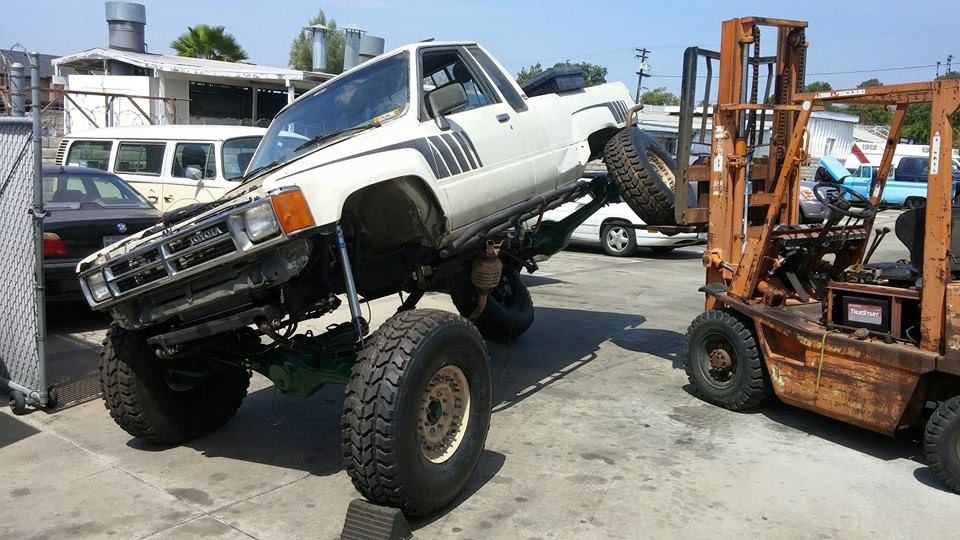

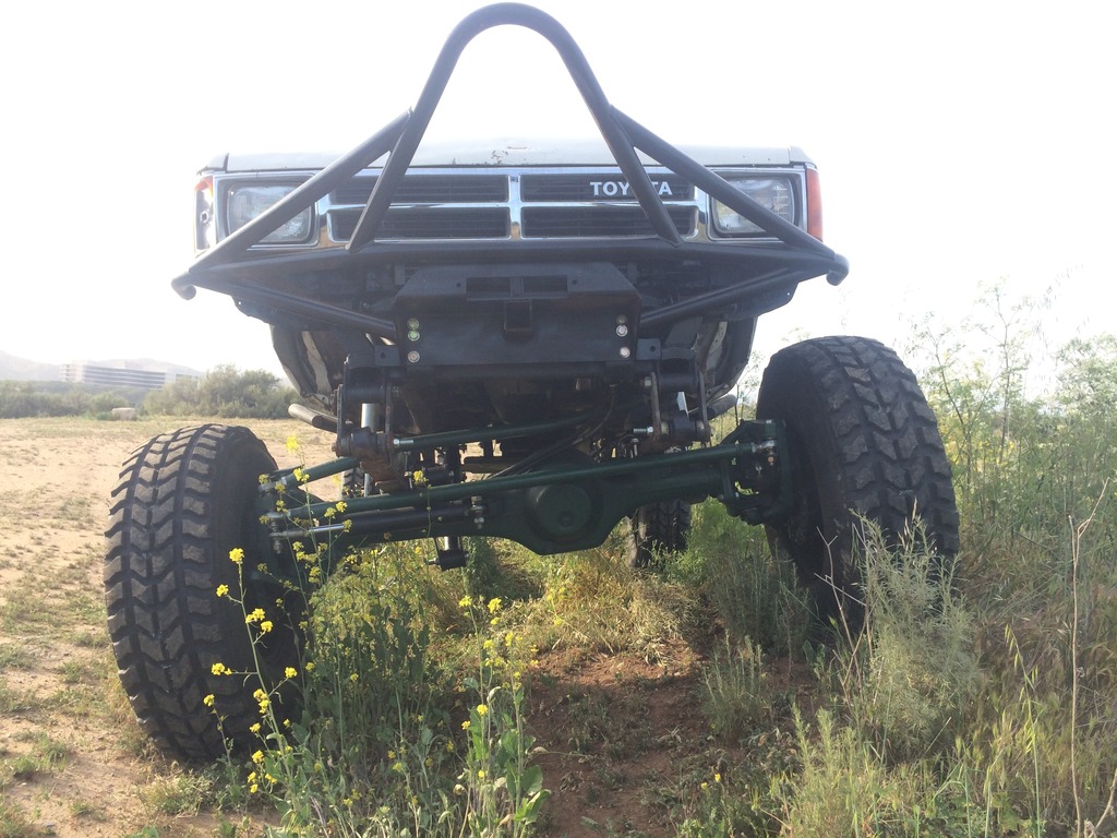

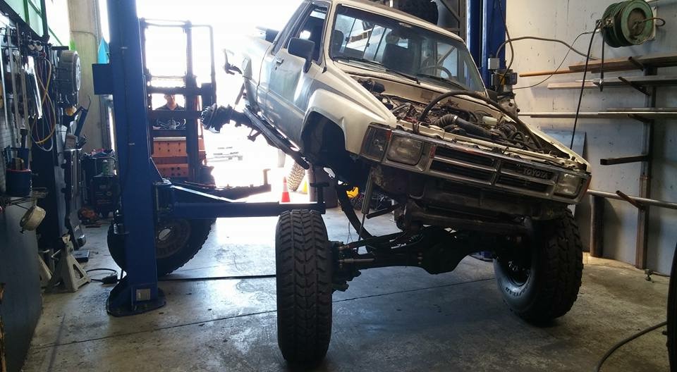

Flex and stance. Not bad for leafs

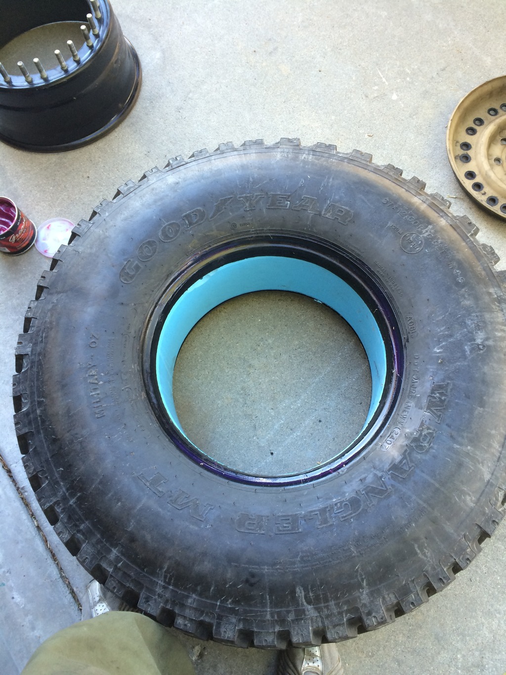

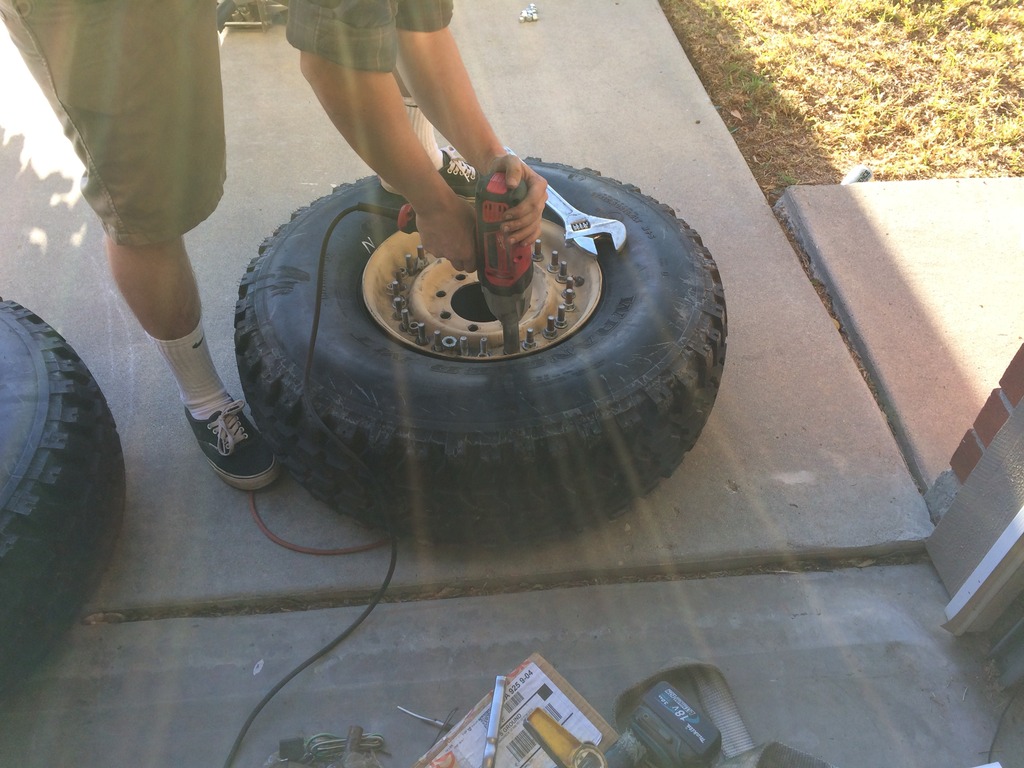

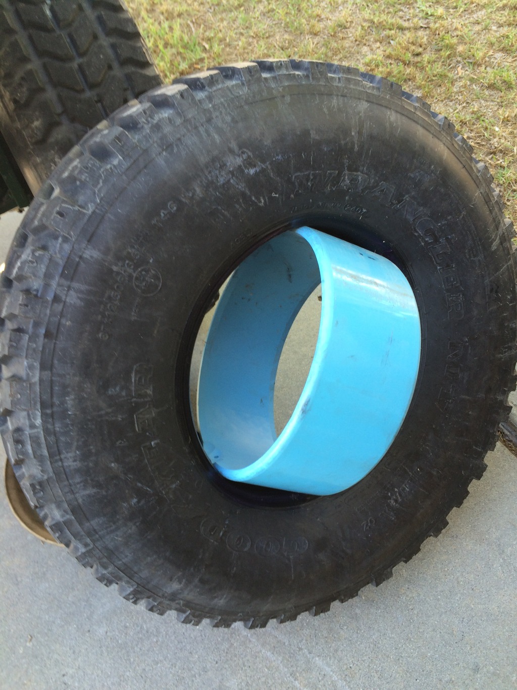

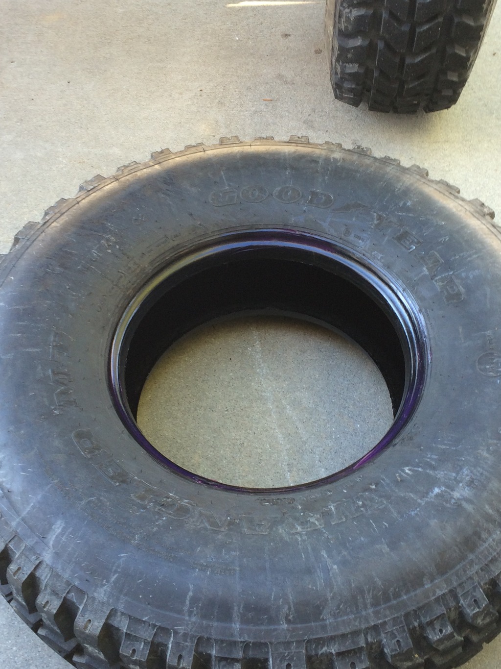

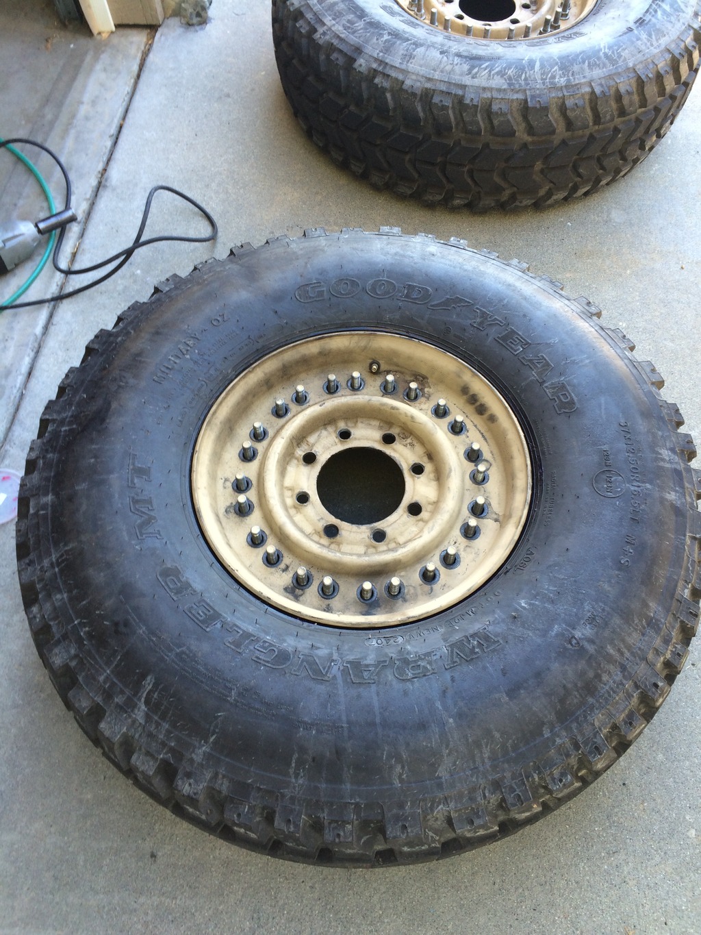

true double beadlocks

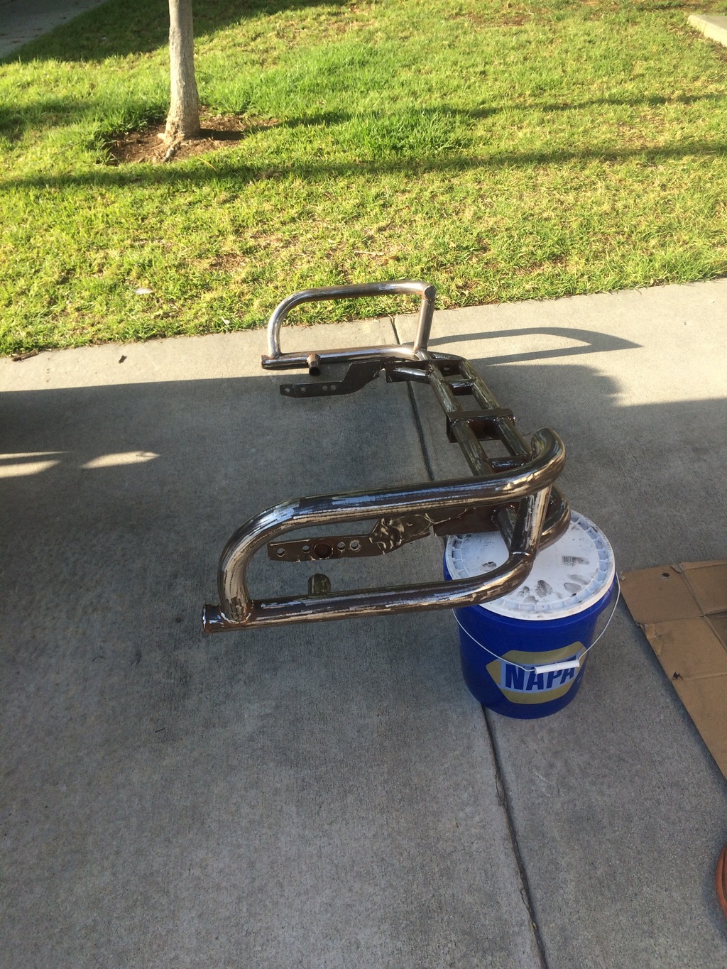

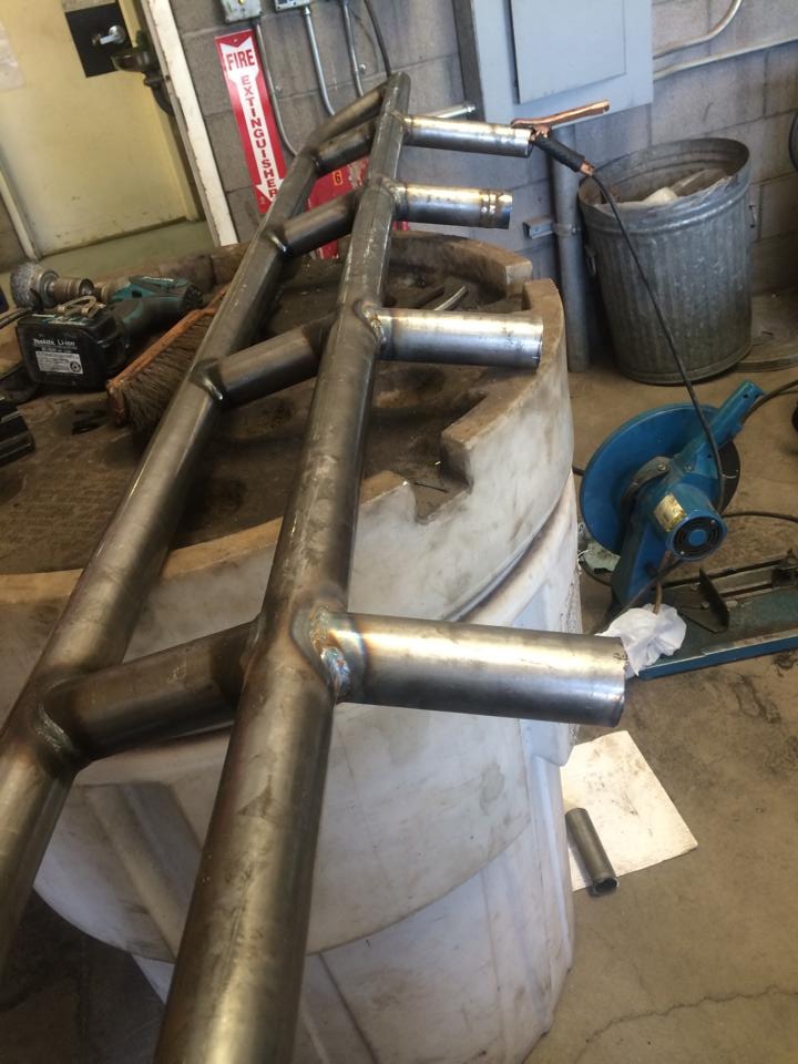

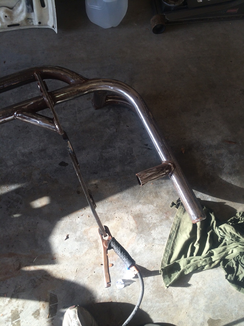

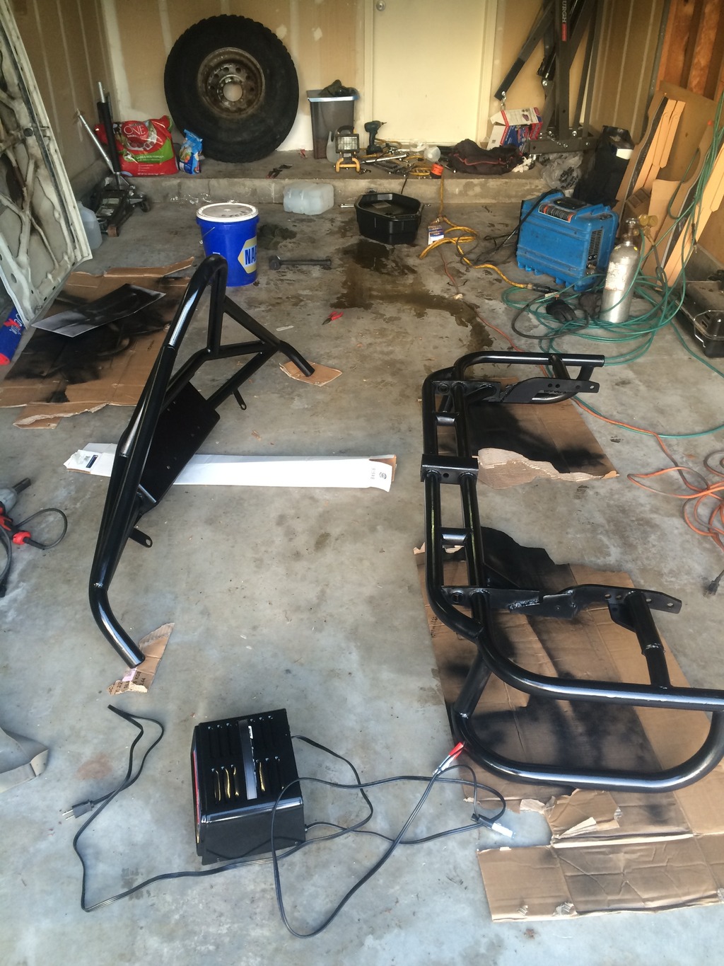

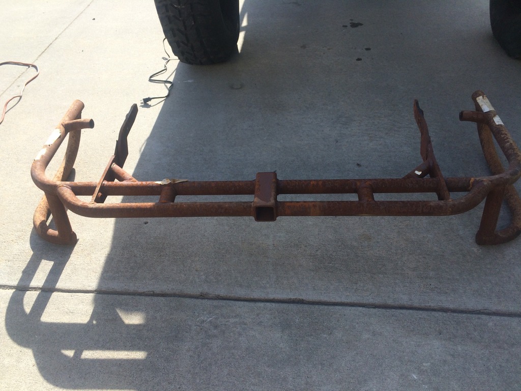

Bumpers

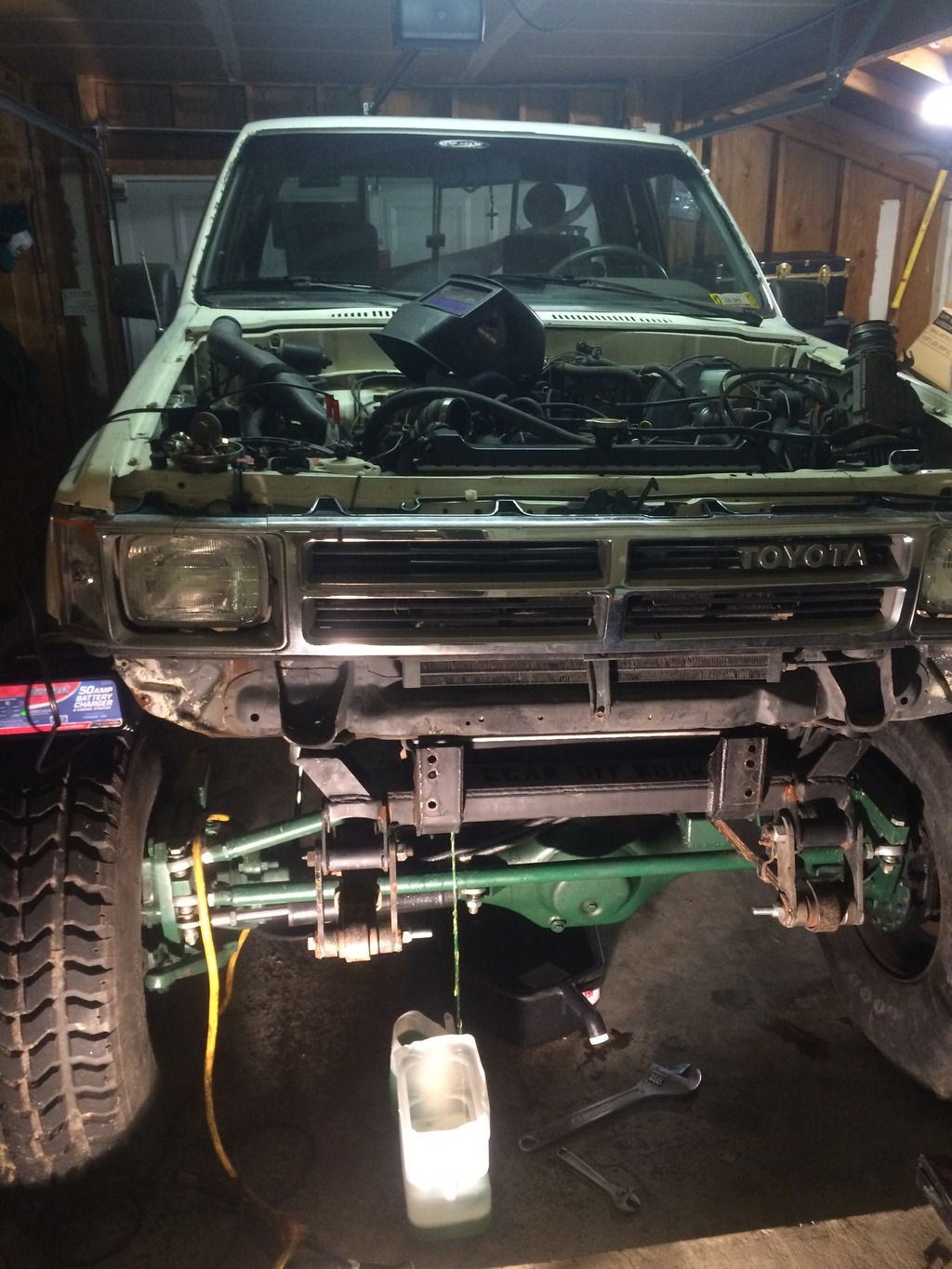

I had a mean front main seal leak so i had to tear into it and fix it.

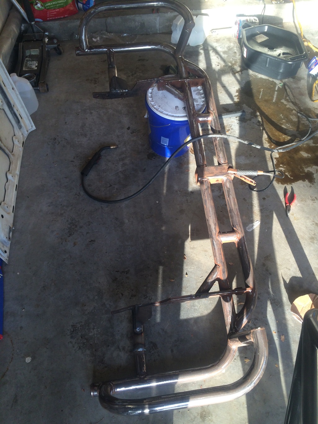

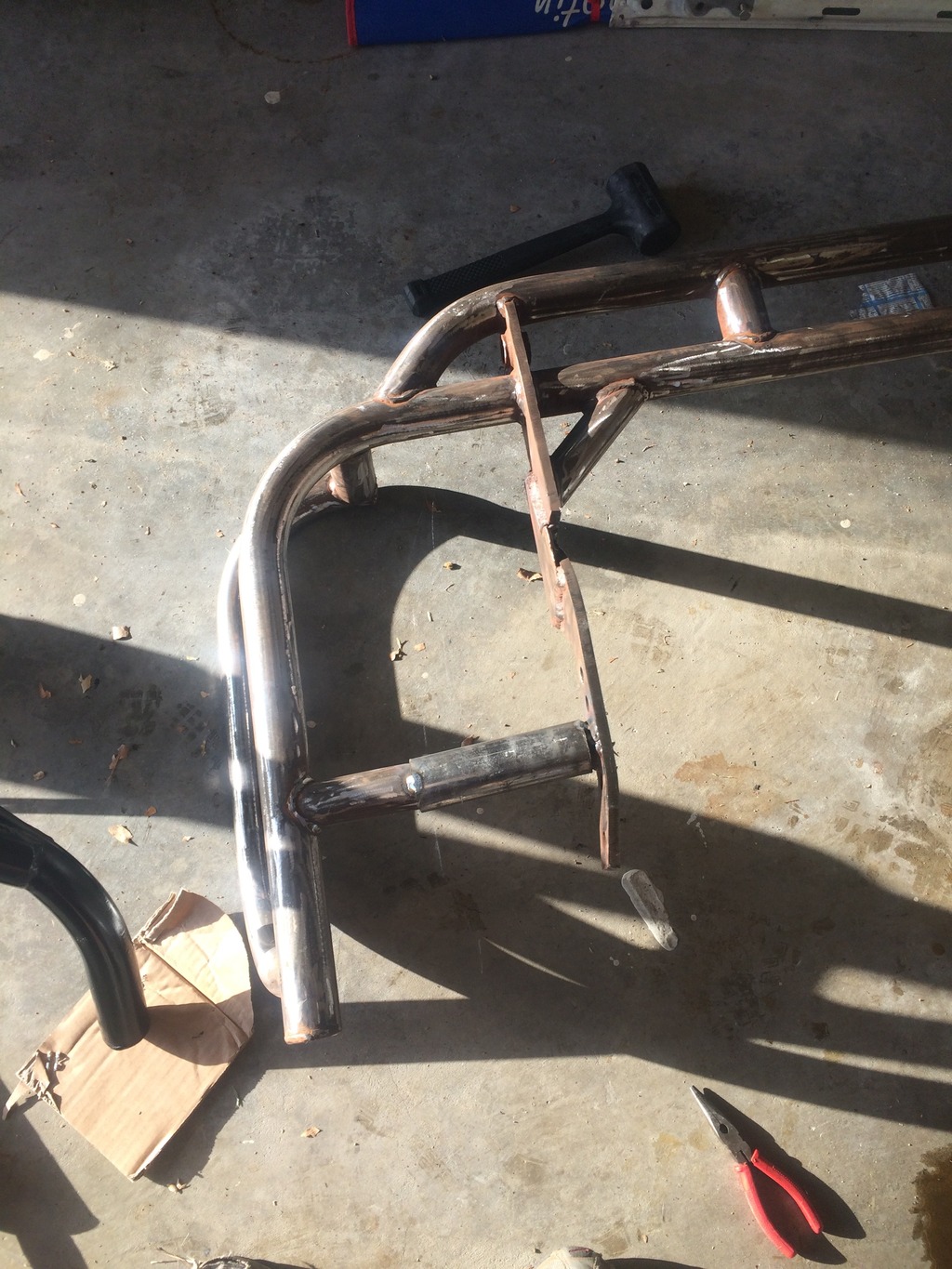

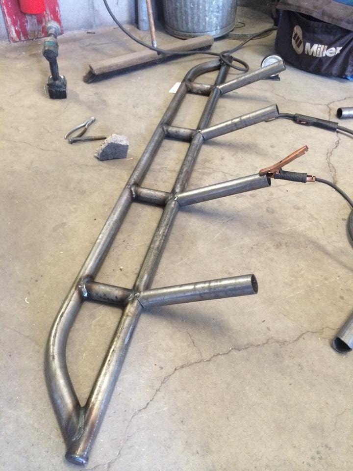

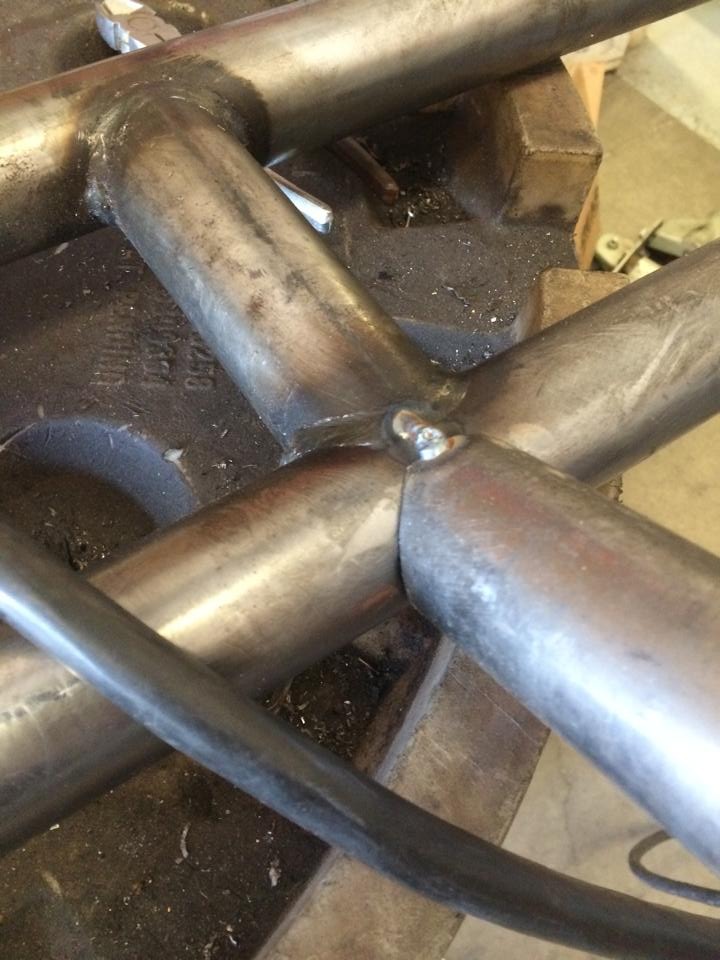

While I had the truck apart i did some long overdue rust maintenance, painting and some fabrication on my bumpers.
I modified the bumper a long time ago because i cut the bottom panel off of the truck bed so there would have been a gap. I did a bad just so i added some reinforcements after derusting.

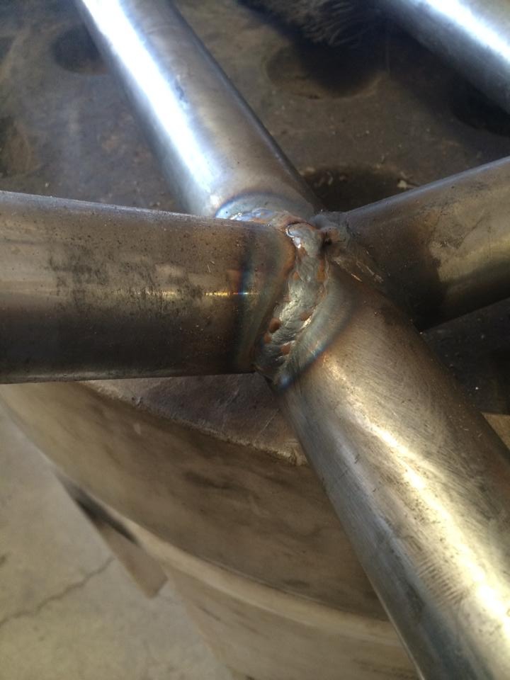

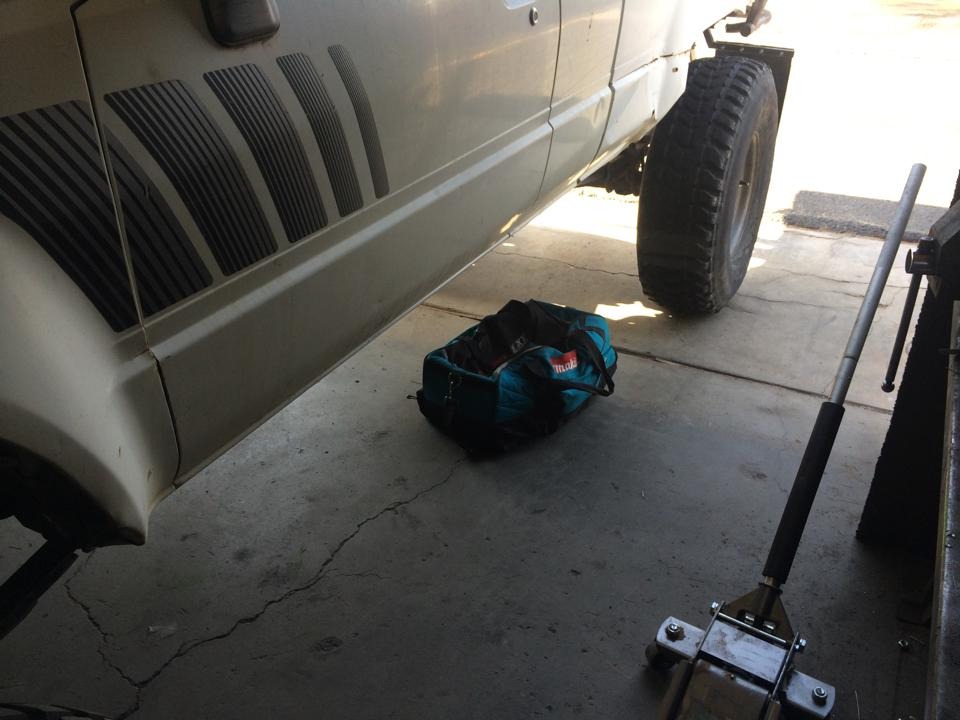

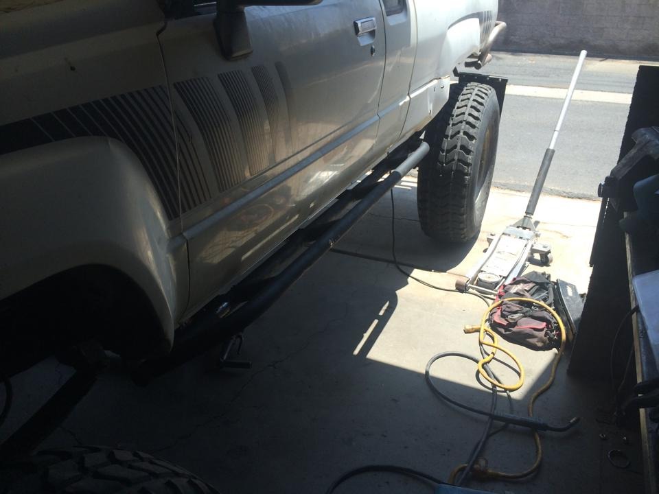

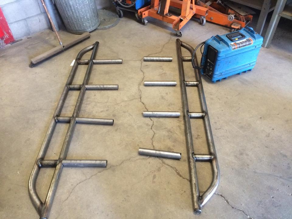

Rock sliders

I like those beadlock wheels...H1's? Looks like you don't have to worry about steep driveshaft angles with the portal axels! Just curious what made you change the front setup from having the shackles in the rear to having them up front? I've been doing some research and have been thinking about running the shackles up front if I do another sas, just looking for some more perspective on it, thanks, loving the build so far!

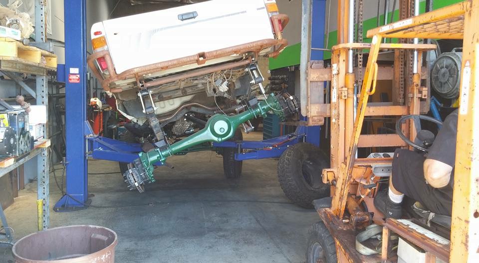

Ed.

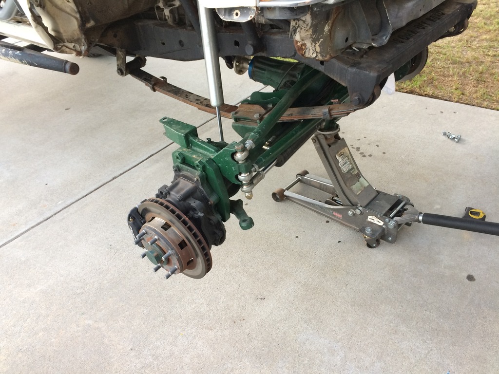

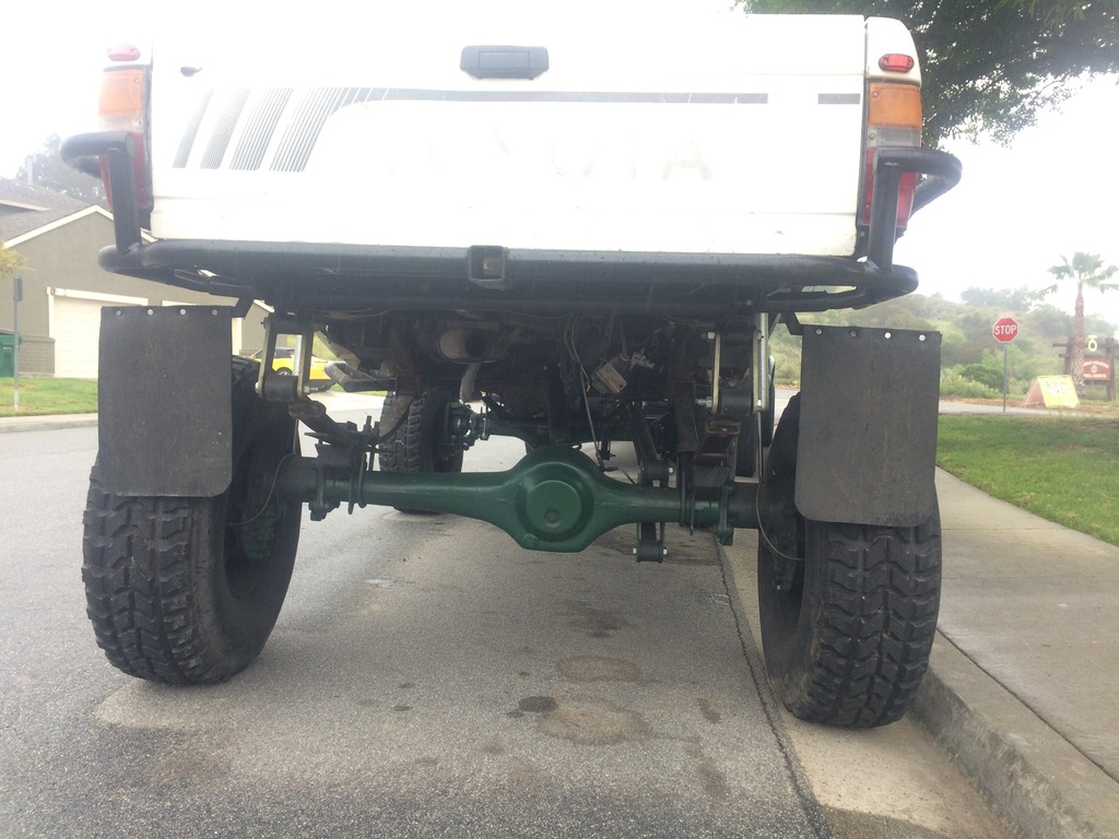

Yes H1's. Lol yeah toyotas are notorious for steep drive shaft angle in front so the portals definitely make it nice.
So the reason for changing the shackle to the front was because of the traction bar. Even with the traction bar having a shackle of its own, it will wants to rotate the axle clockwise(if looking at it from the passenger side wheel) or pinion up as the axle drops. The leaf springs with shackle in the rear wants to rotate the axle counter clockwise or pinion down as it drops. Effectively binding the suspension. With the shackle in the front, both traction bar and spring articulate in the same direction. Kinda hard to explain but hopefully I did it.

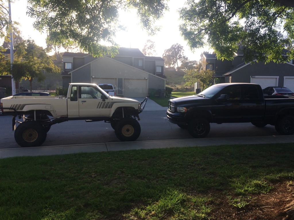

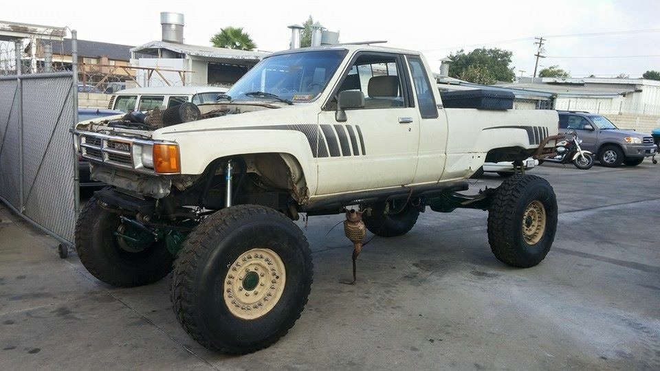

The truck as it sits now.
