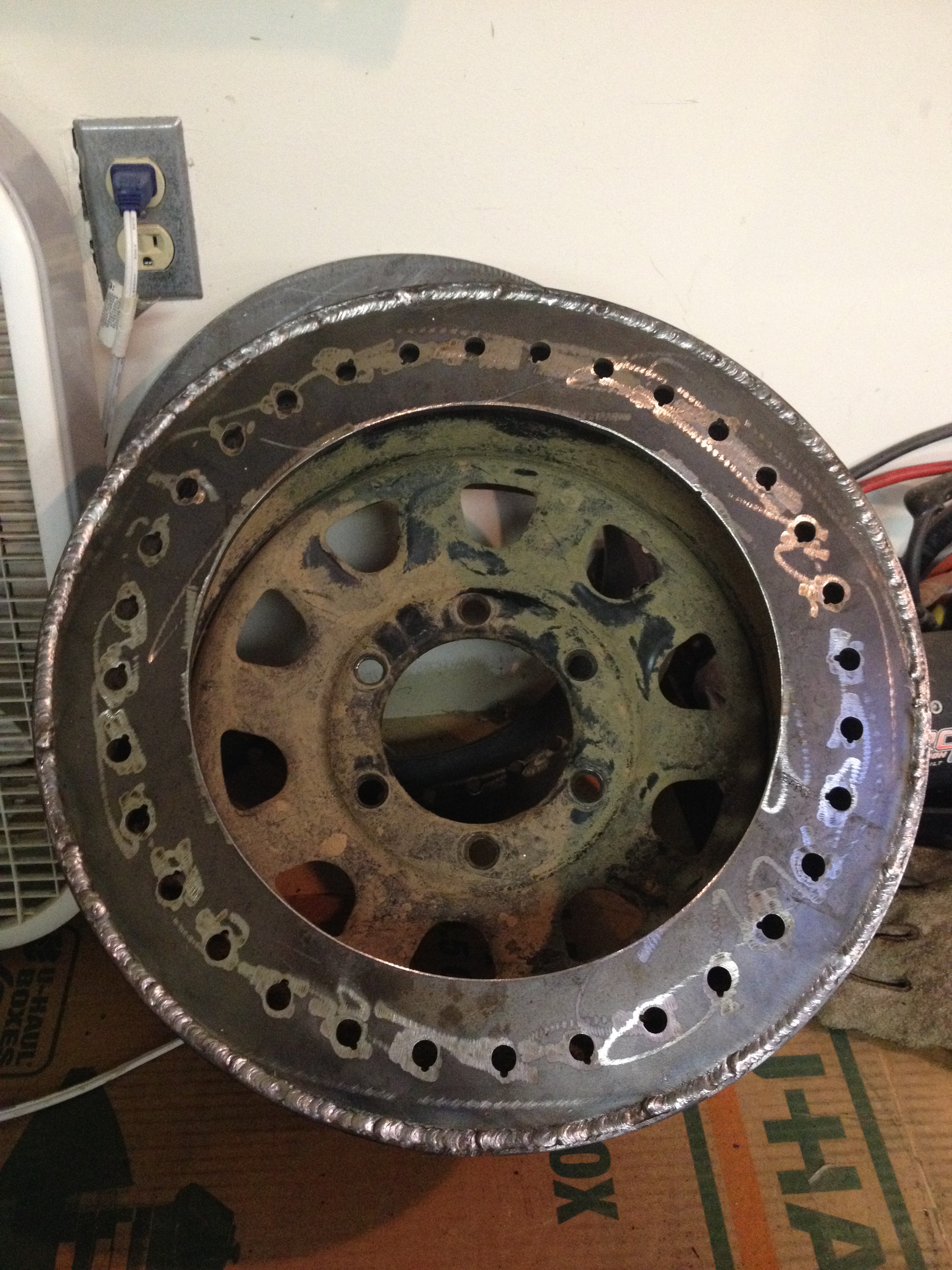

next on to the beadlocks ... these were a total b****!! everyone leaked so finally used silicone .

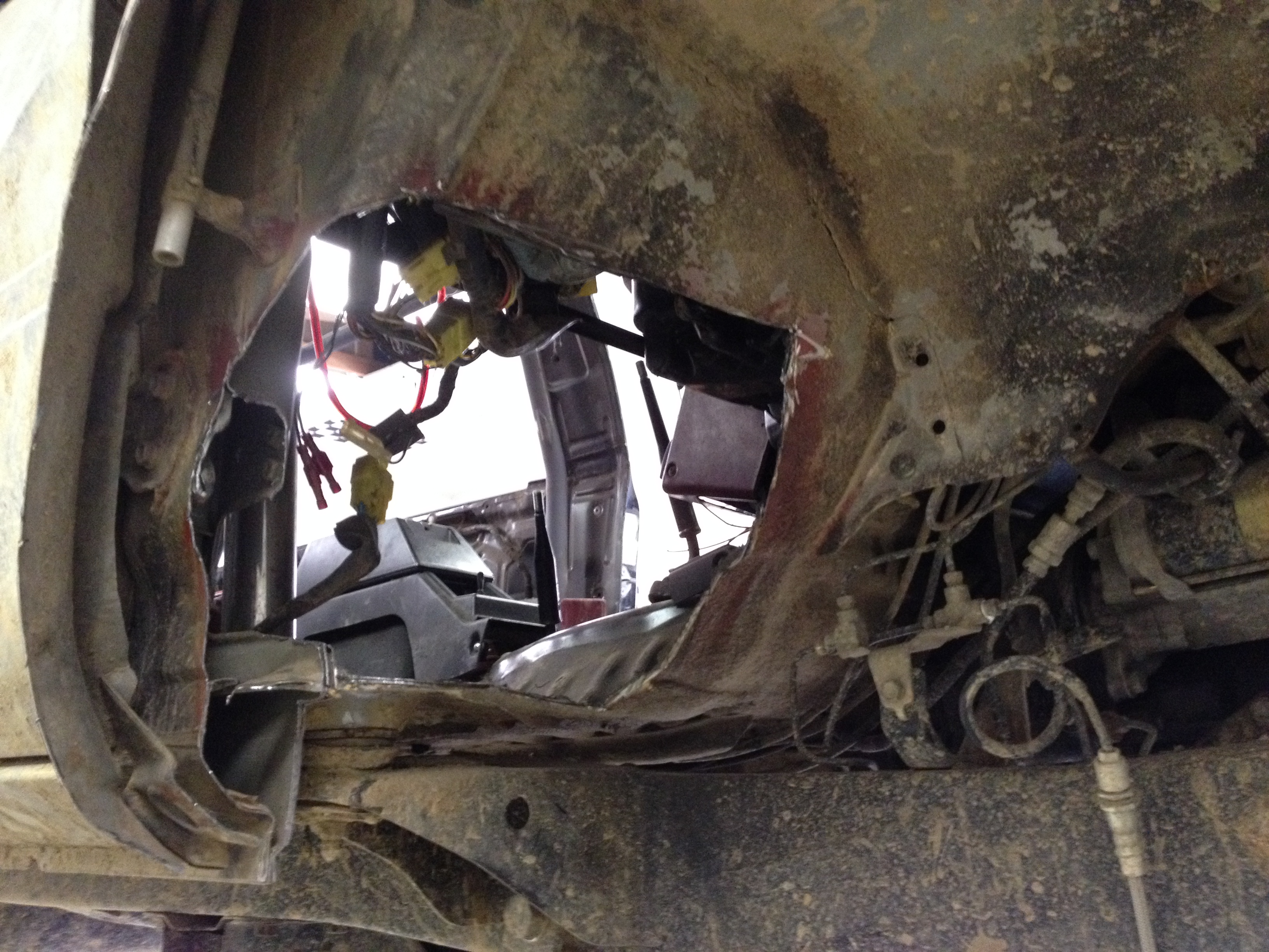

then to make room for the 39.5 iroks I started to tub the firewall, first I cut it out with a sawzall and grinder

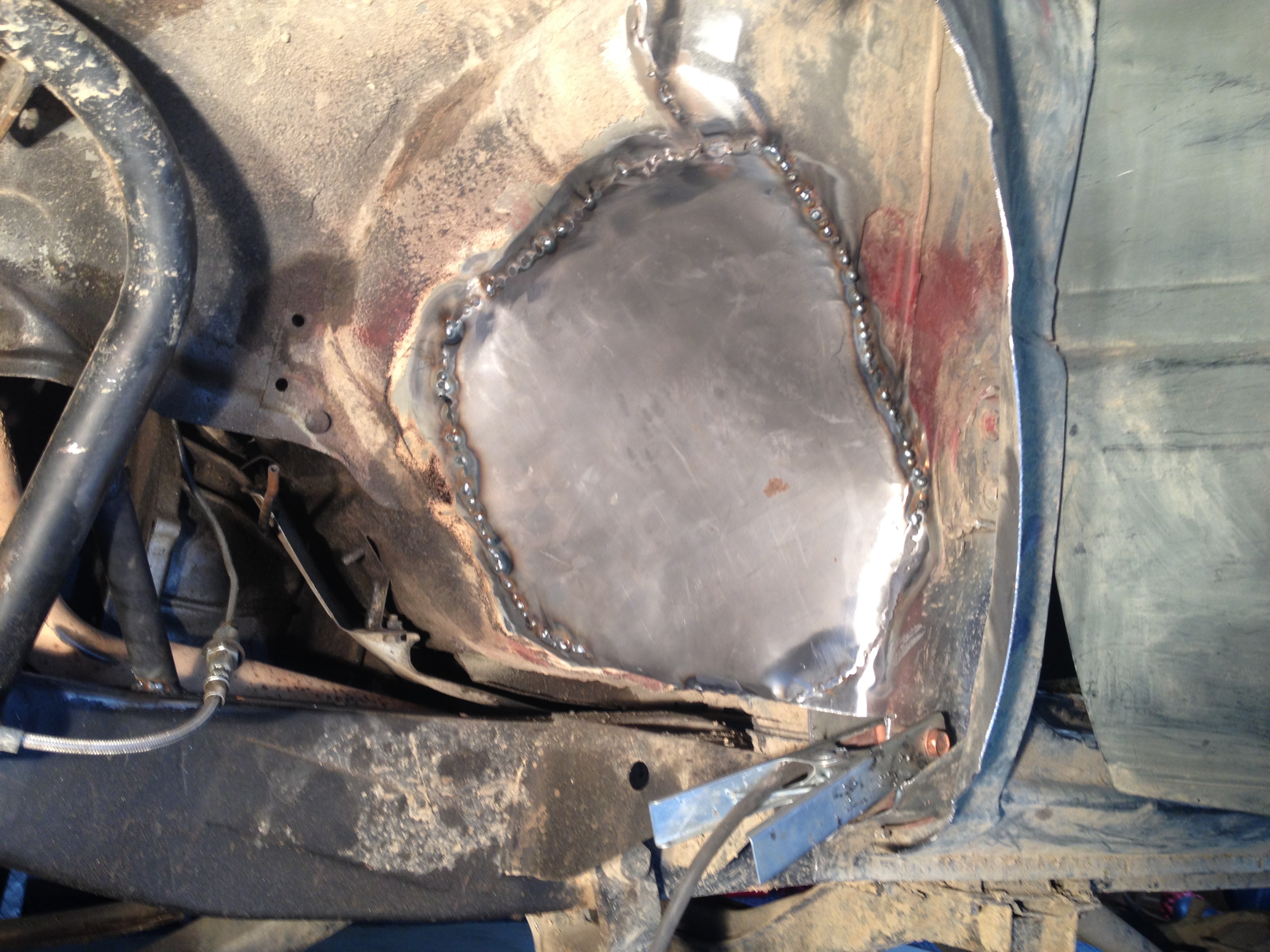

then I made a template and got some 20 guage sheetmetal and went to work

then welded anc cut into place , grided welds down and seam sealed and undercoated

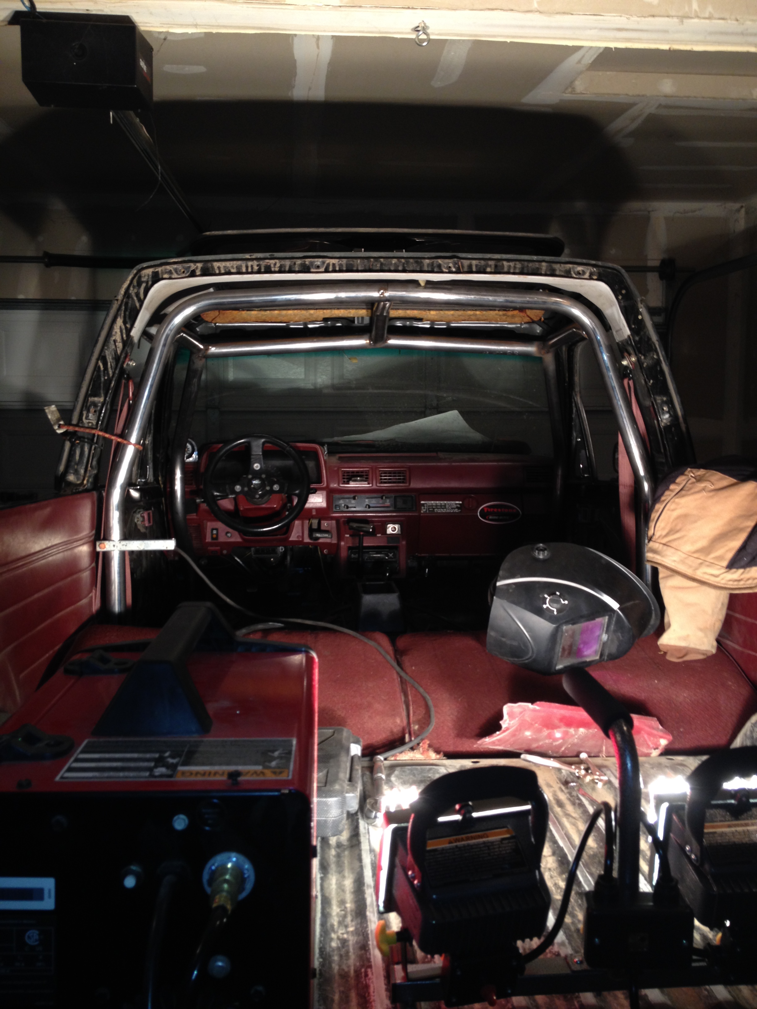

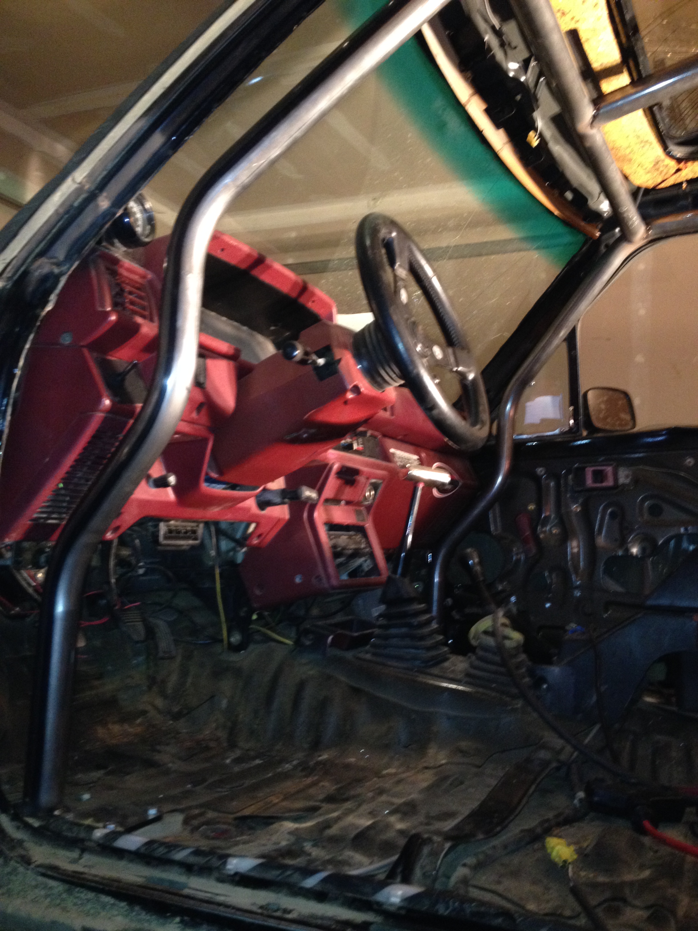

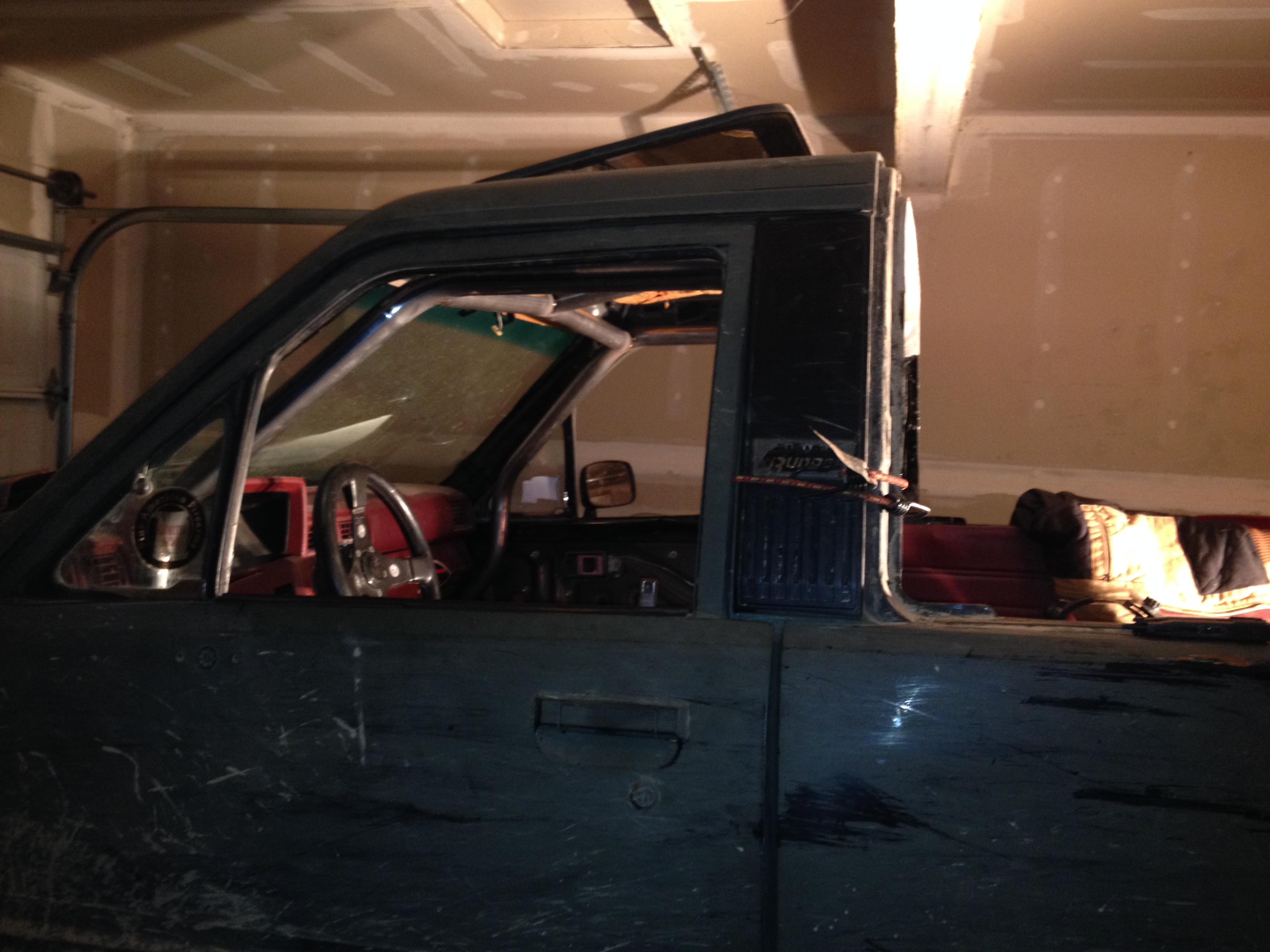

cage install from 4x innovations... cage was a lot of work but well worth it after I had rolled it .. probably beens ucking food through a straw if I didn't have it
Attached Thumbnails 1988 4runner first toy build-073.jpg   1988 4runner first toy build-074.jpg   1988 4runner first toy build-072.jpg   1988 4runner first toy build-075.jpg

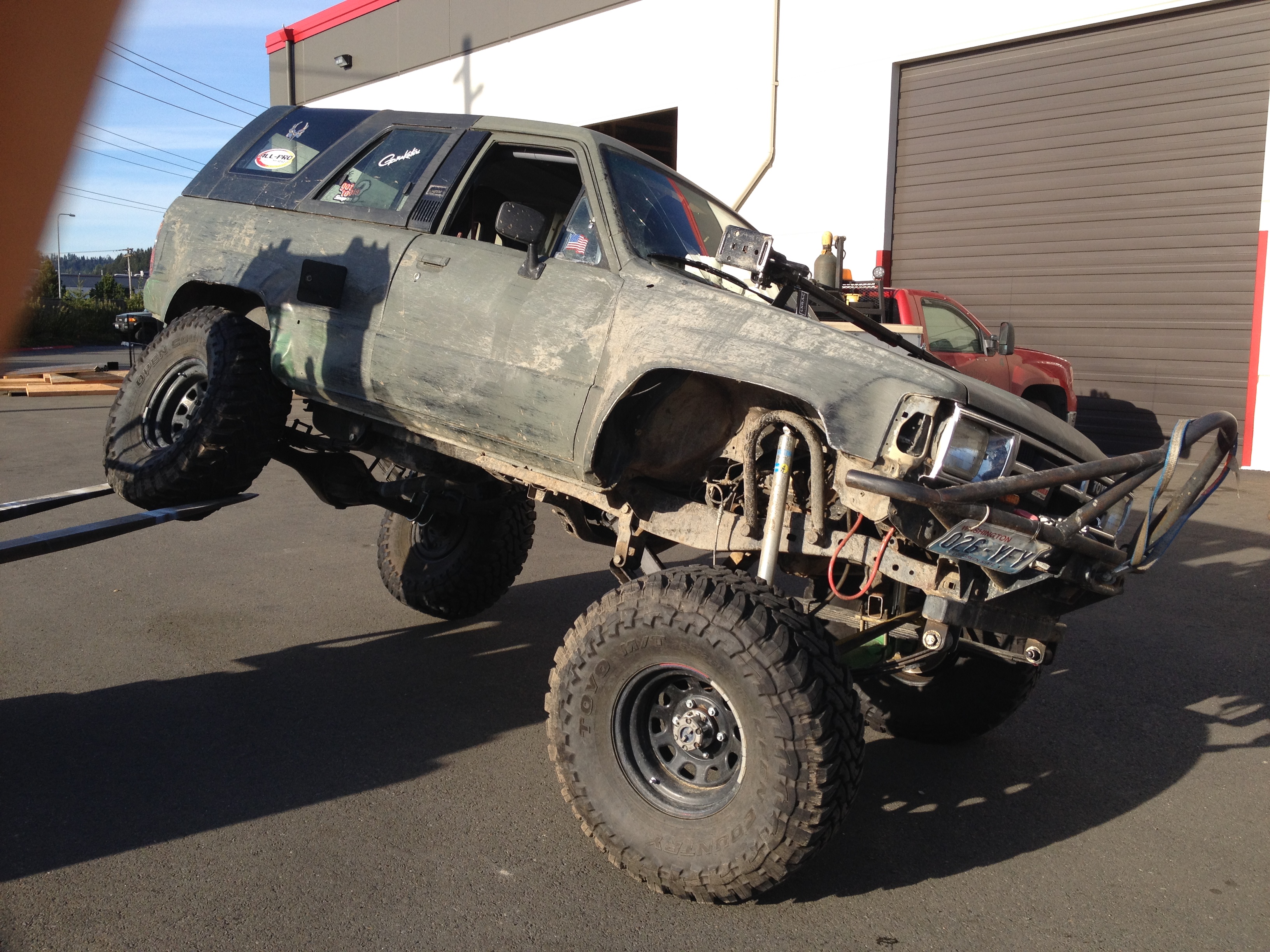

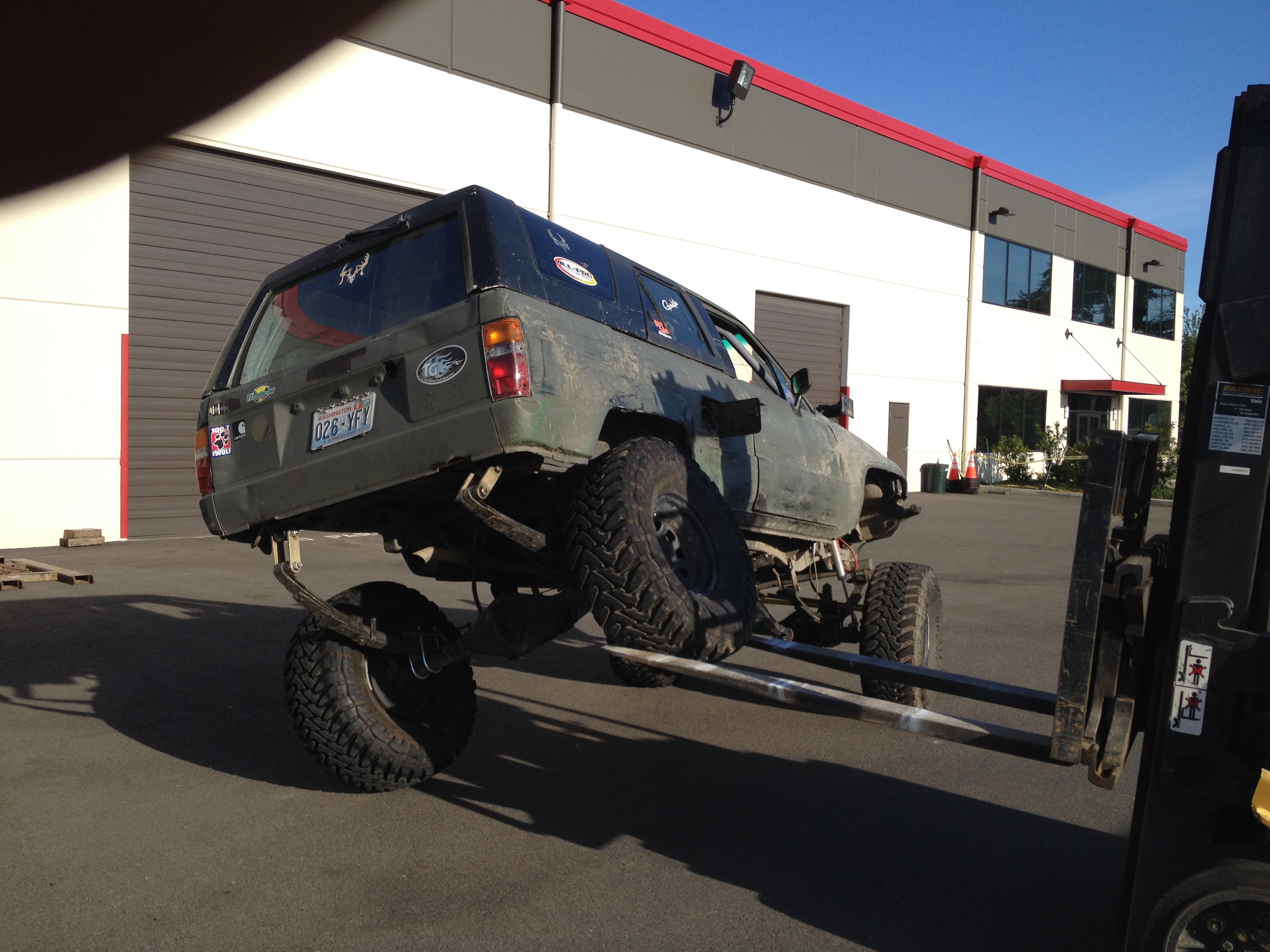

before the 39.5s were the 35 toyo mts flex test brand new trail gear 4 inch leafs
Attached Thumbnails 1988 4runner first toy build-133.jpg   1988 4runner first toy build-134.jpg

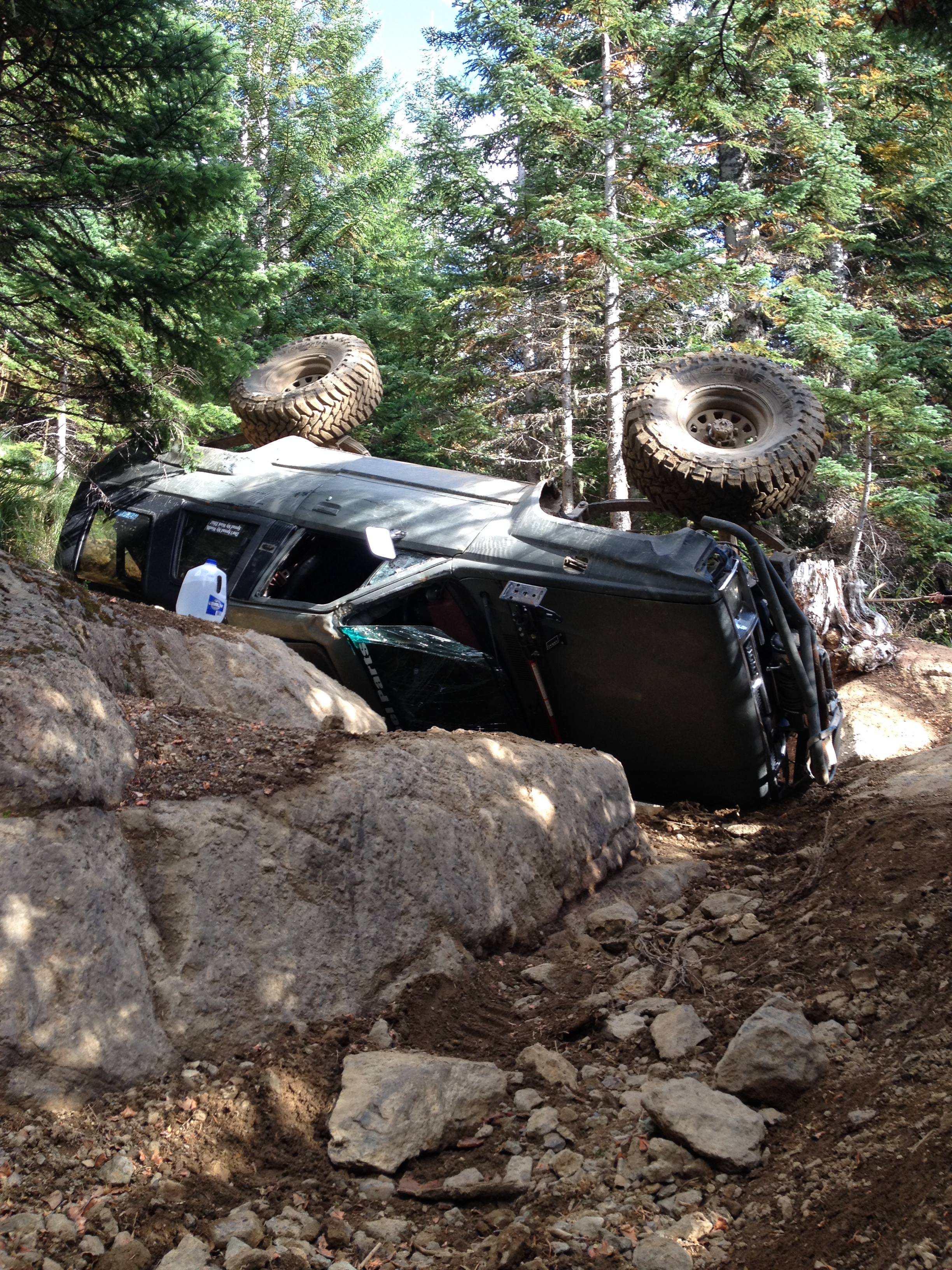

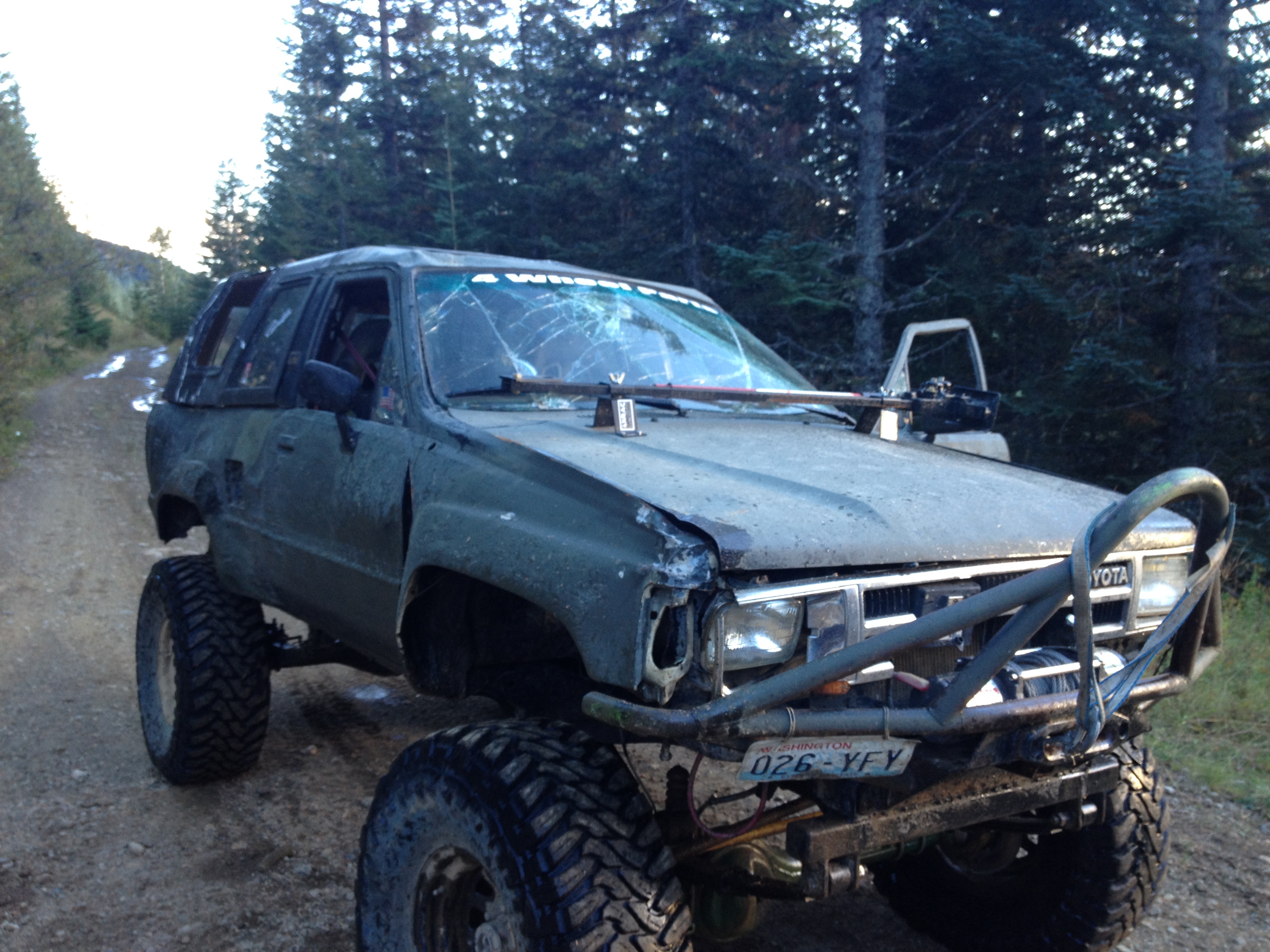

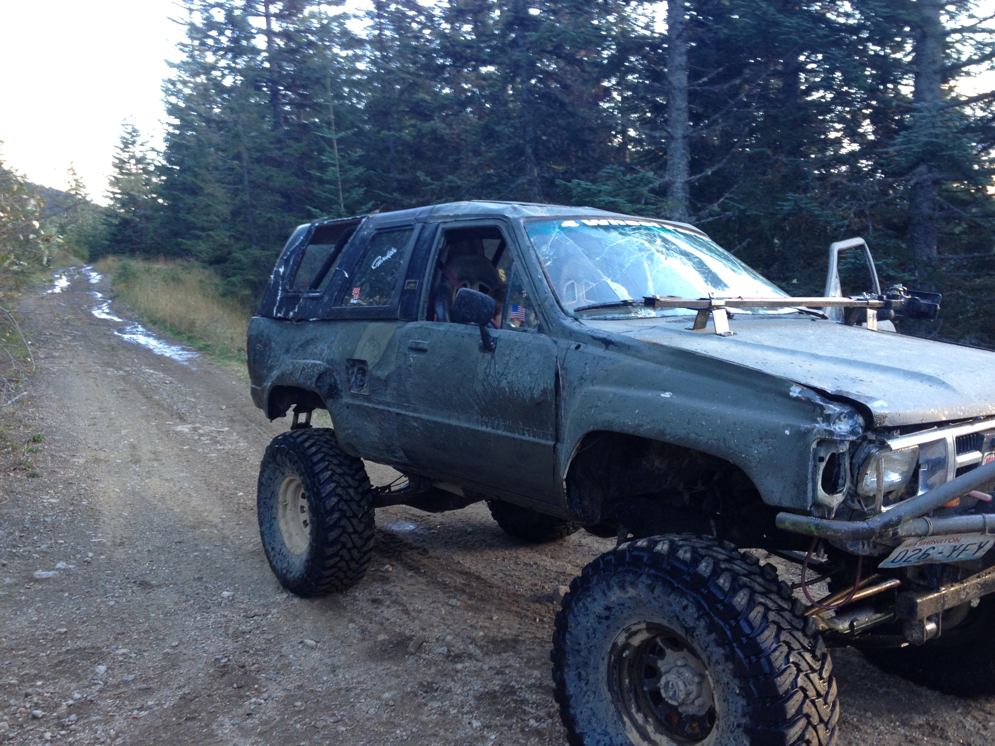

the reason for the total rebuild
Attached Thumbnails 1988 4runner first toy build-198.jpg   1988 4runner first toy build-199.jpg

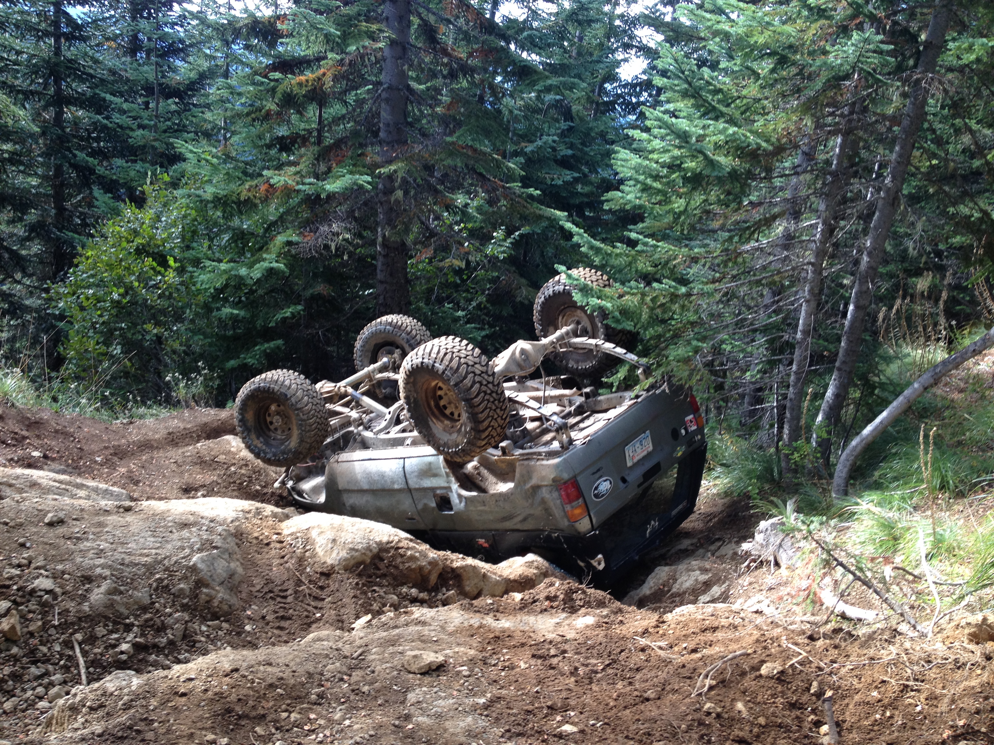

rollover pics
Attached Thumbnails 1988 4runner first toy build-192.jpg   1988 4runner first toy build-196.jpg
