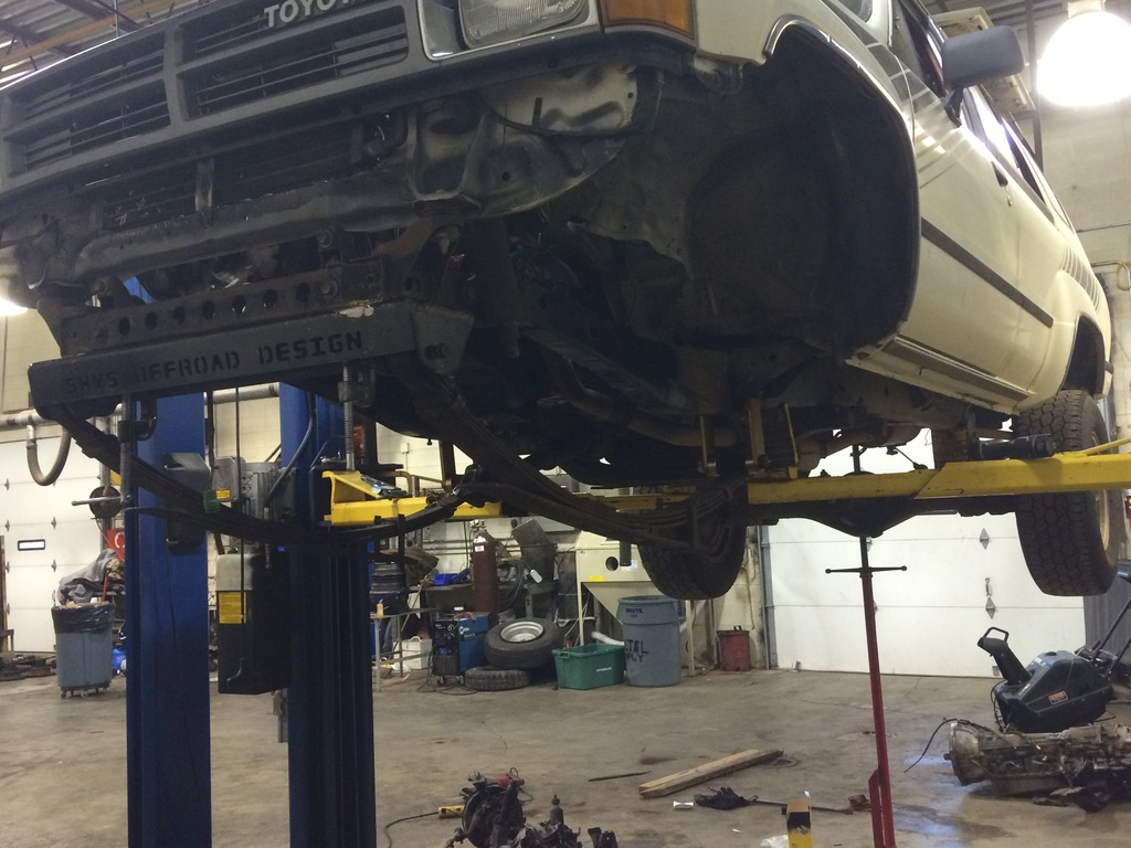

so the runner has been sitting awhile and i made the decision to put in a spare axle while i build the fj axle. the past few weekends ive been going back up as gizler and i have been busy with our own lives. today we got the axle installed and set of wheel on it to see how it looks. i am surprised how high it sits but it looks good. so the RUF high steer setup is going to require a short pitman arm or move it forward. probably end up moving it forward, clocking it and using a flat arm. heres some pics
getting the axle installed
so heres how it sits with stock wheels and tires, stock rear suspension and the swap. i removed the overload leaf and added 2 leafs off a rear spring setup from a different runners rear leafs. they were cut down by me.
here is the last picture. i put one of gizlers wheels on to see how it looked with 35s. the lift was setup to lift the rear of the runner to a similar height to see what it looks like. it should sit pretty good.

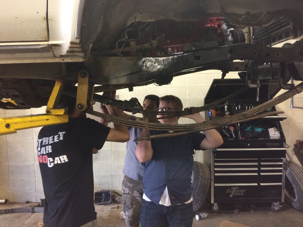

its been awhile since i posted, but an update. after installing the mini axle i towed it back to lincoln to mess with it as my fj62 axle wasnt done yet. ended up doing it in the parking lot at my apartment with my older brother which took about 4 hours to finish. the axle install was fairly simple, only a few hang ups. i need to install my axle shims to turn the pinion angle up as its incorrect. i will also need to get a longer drive shaft. i got it aligned and all buttoned up and been driving it since. i moved to denver colorado at the end of june so ill hopefully be hitting some trails soon. i know this weekend the fiance and i will be going to chinns lake with some friends for the meteor shower.
