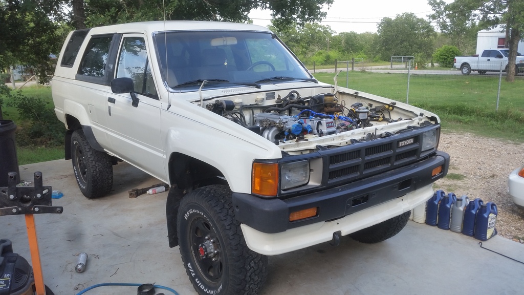

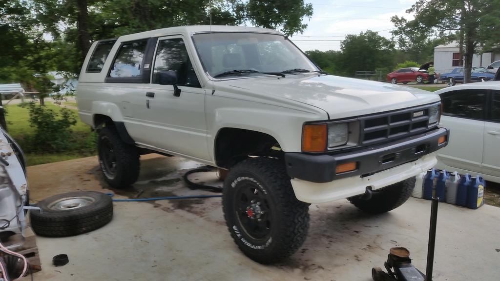

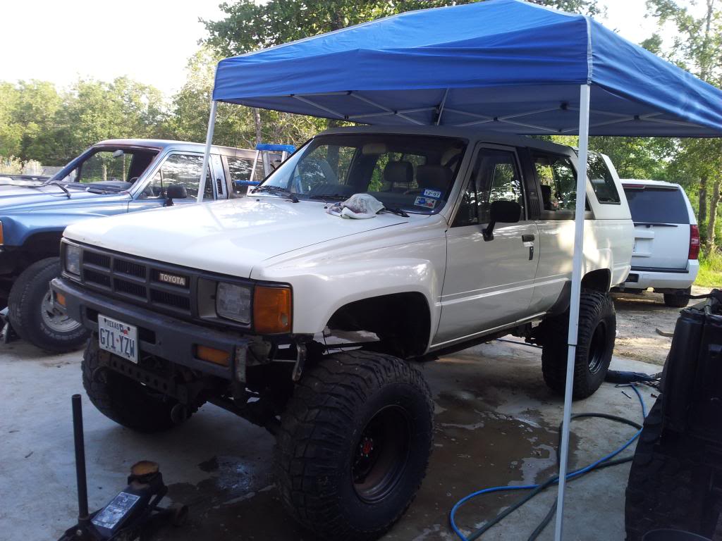

Day I picked it up:
At home:

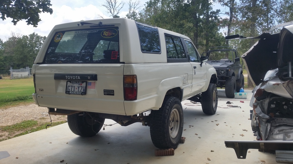

I then removed the 3" body lift and installed polyurethane body mounts, then I sold the 33x12.50r15 wheels and tires. I also removed the rear bumper to make room for a marlin or trail-gear rear bumper:

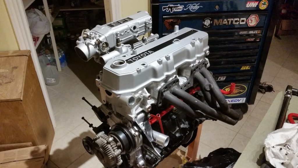

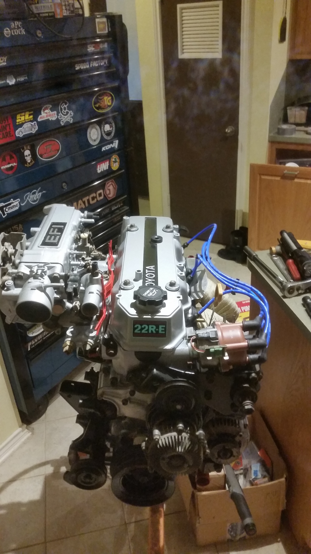

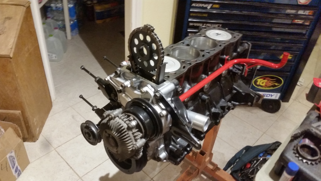

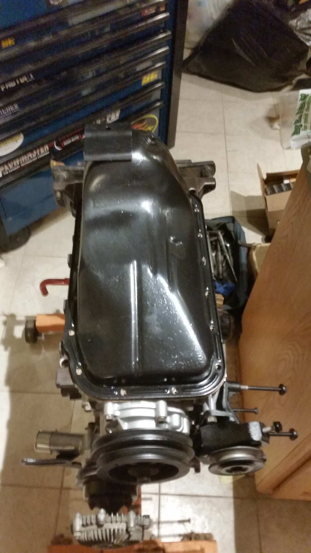

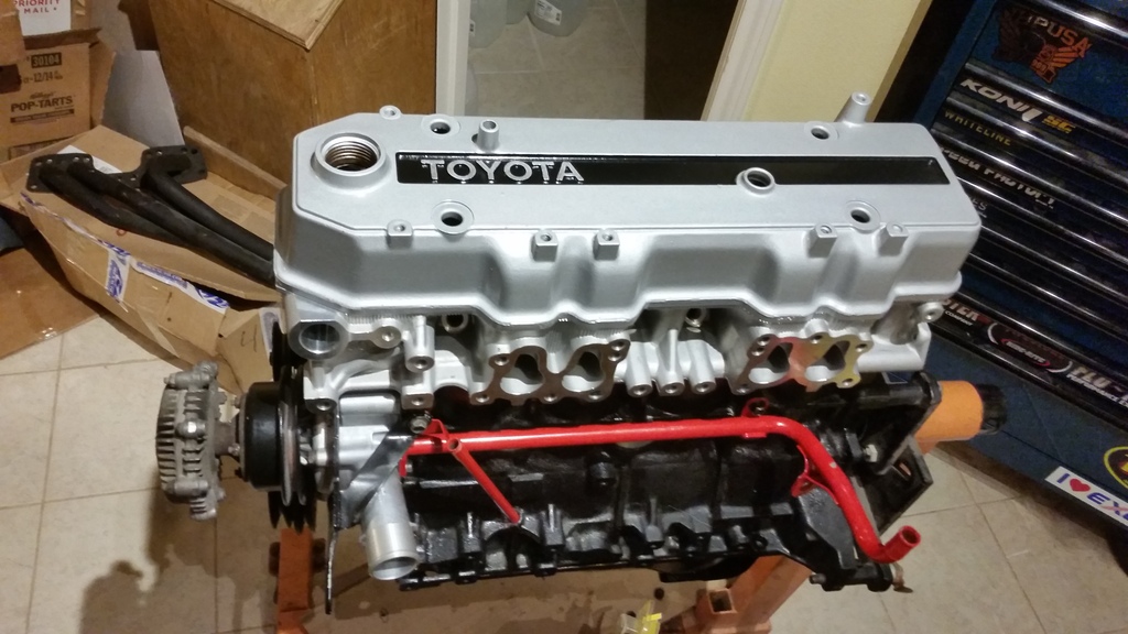

Started building the engine
engine specs:
-bored 40 over
-engnbldr cylinder head w/ss valves
-engnbldr front cover, timing components, and gaskets
-RV camshaft
-EGR block off plates
-long-tube header
-Marlin Crawler 1600 clutch kit w/flywheel
-Marlin transmission mount

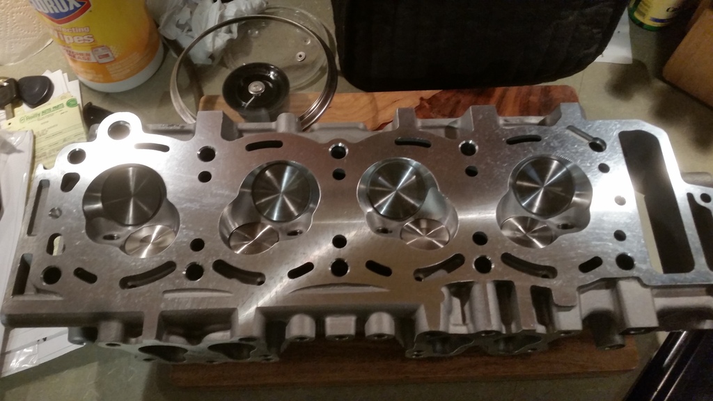

Cylinder head:

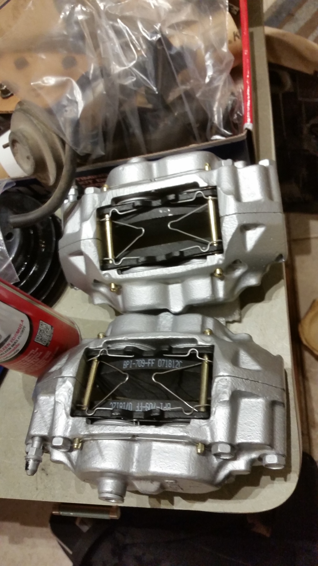

Re-man calipers nice and painted with silver caliper paint, I've never understood why they sell all of these re-man calipers with no finish but raw steel.

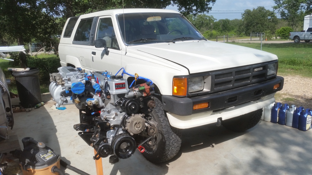

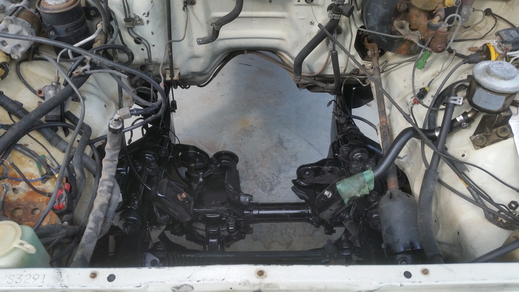

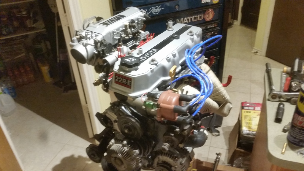

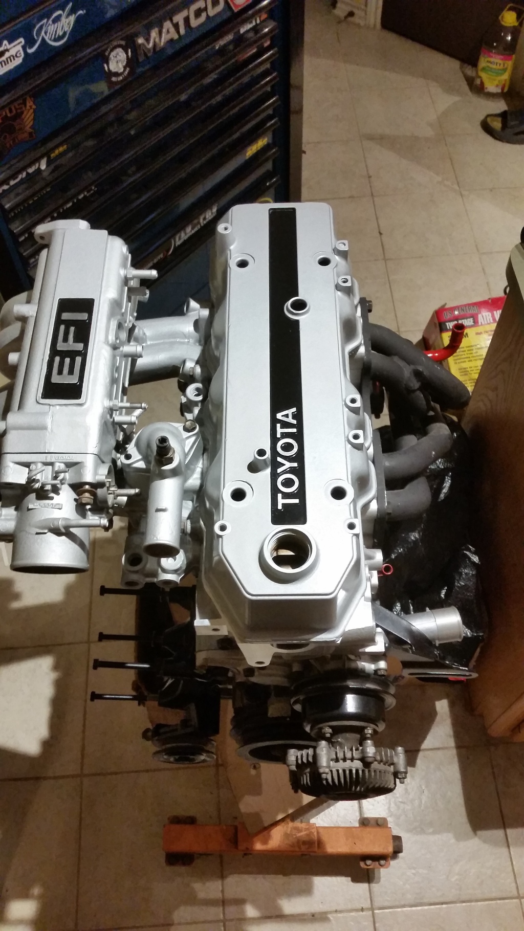

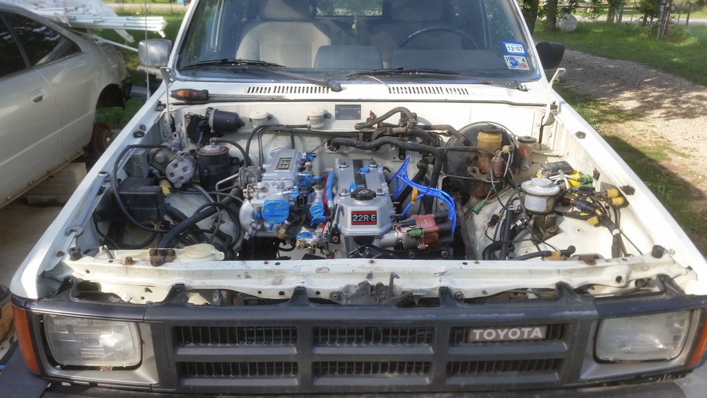

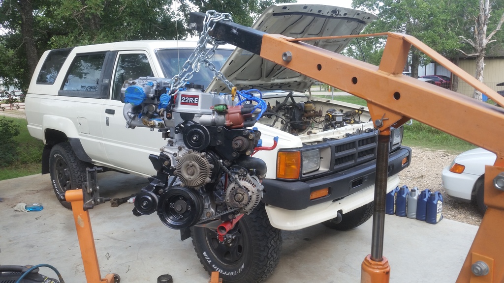

Finally got the engine almost finished up and installed

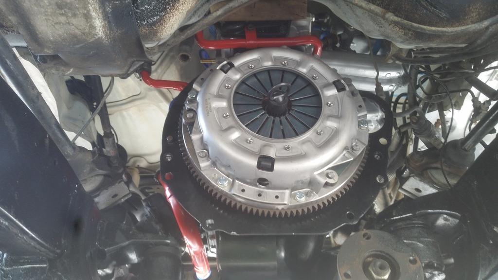

Got the marlin crawler clutch kit installed along with a new flywheel

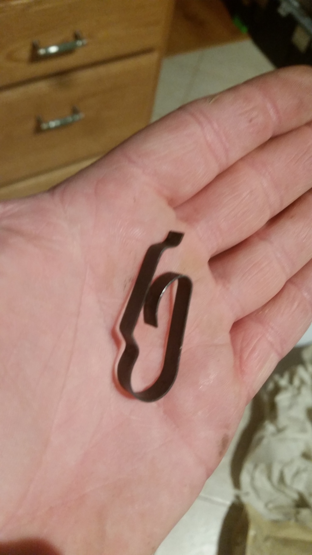

I almost had the rebuilt W56 installed the same day as the clutch but I could only find one of the throw out bearing clips. So my progress came to a halt because of a $2 clip...
