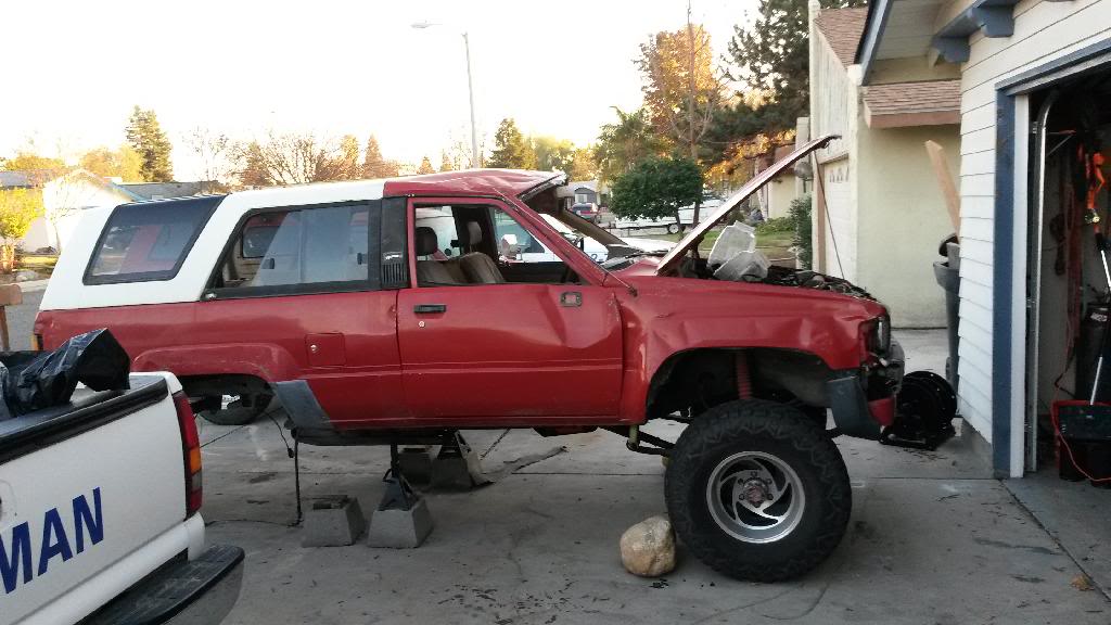

Here is a pic of the donor. It has a 4 inch lift, lockers, 4:88 gears, lower gear in transfer case and a manual transmission.
I hope the pic is not to big.
My brother helped me get the axle out. Dad wont let me back under it until we get more jack stands under it.

post them all! the more the better. do yourself and us all a big favor tho, get those jack stands off those blocks and onto the hot top or put wood between them. steel stands can cause cement/concrete blocks to shatter. heck your donor trucks nicer than mine, lol. the phone # for eastwood is 1-800-345-1178. eastwood.com get their catolog its handy for locating paint products and tools. welcome to YT

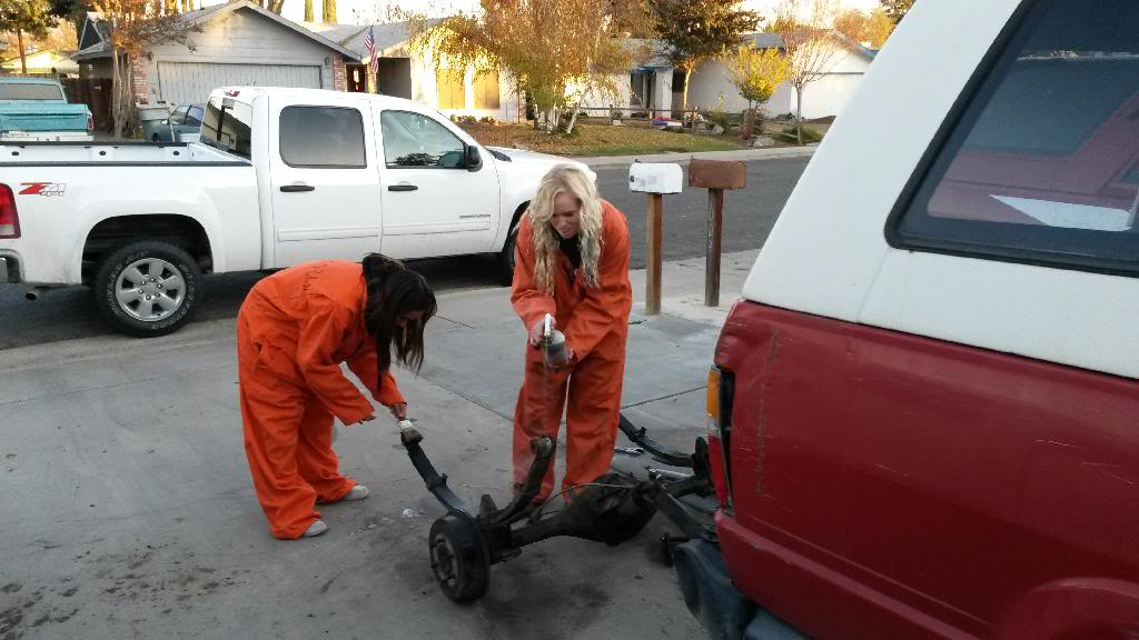

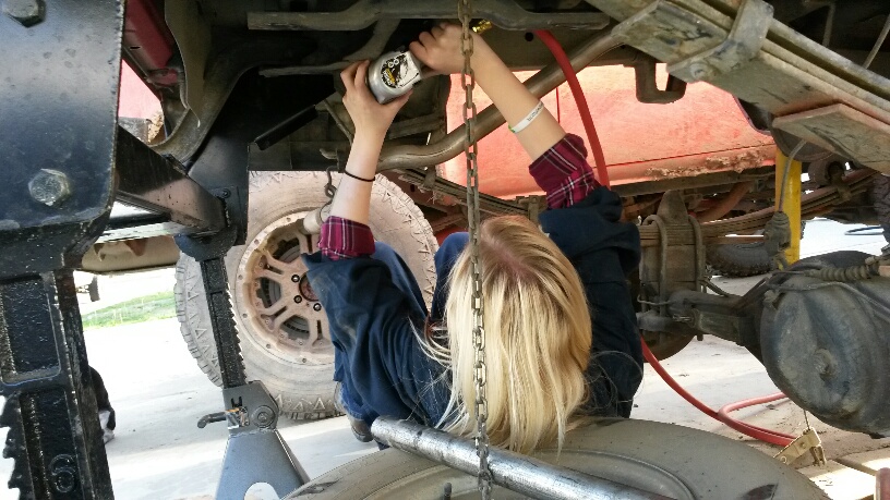

pulling the shocks off.
simple green and pressure washer time. Dig the coveralls

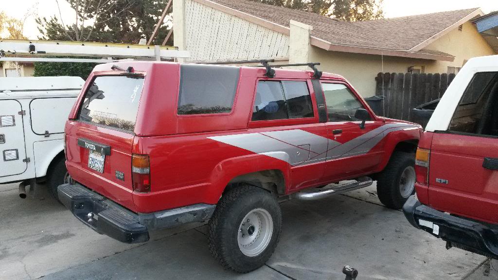

The runner that gets the parts

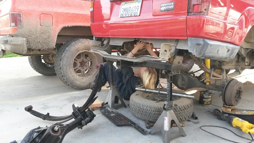

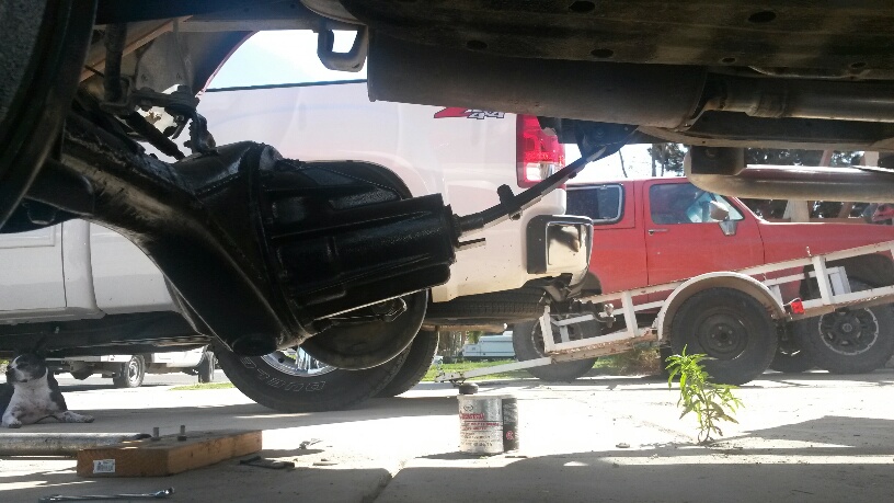

Sorry its been so long. Now with the time change we can get back to work. We installed the rear suspension and rear end off of the donor, It looks to have too much angle on the diff. There is a wedge under the spring that looks to be installed the wrong direction
