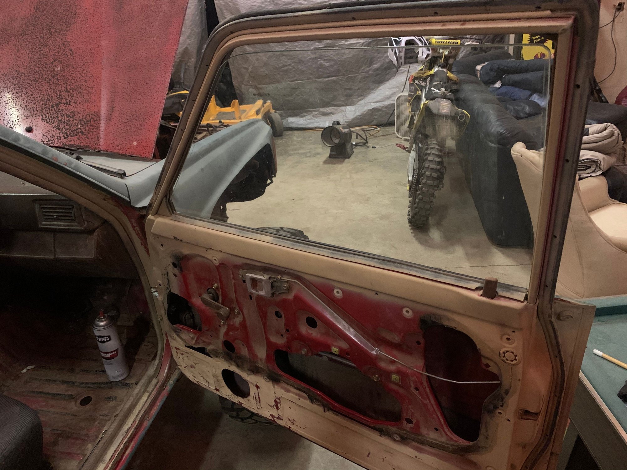

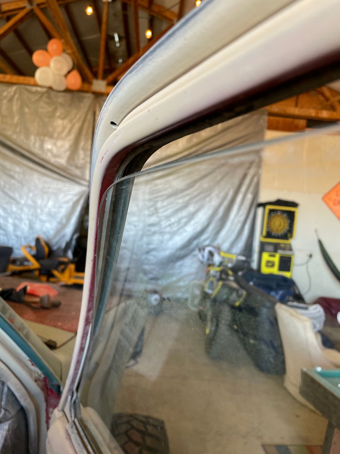

I replaced my window mechanism on my passenger door because the old one was sticky. As I’m finishing up I noticed my window doesn’t line up with the top of the track on the door. The window will move about a quarter inch in either direction if I push it. I’m not pushing hard. What can i do to make it line up better?

It is in the channel inside the door. It’s only when I roll the window up that it doesn’t want to stay in the channel.

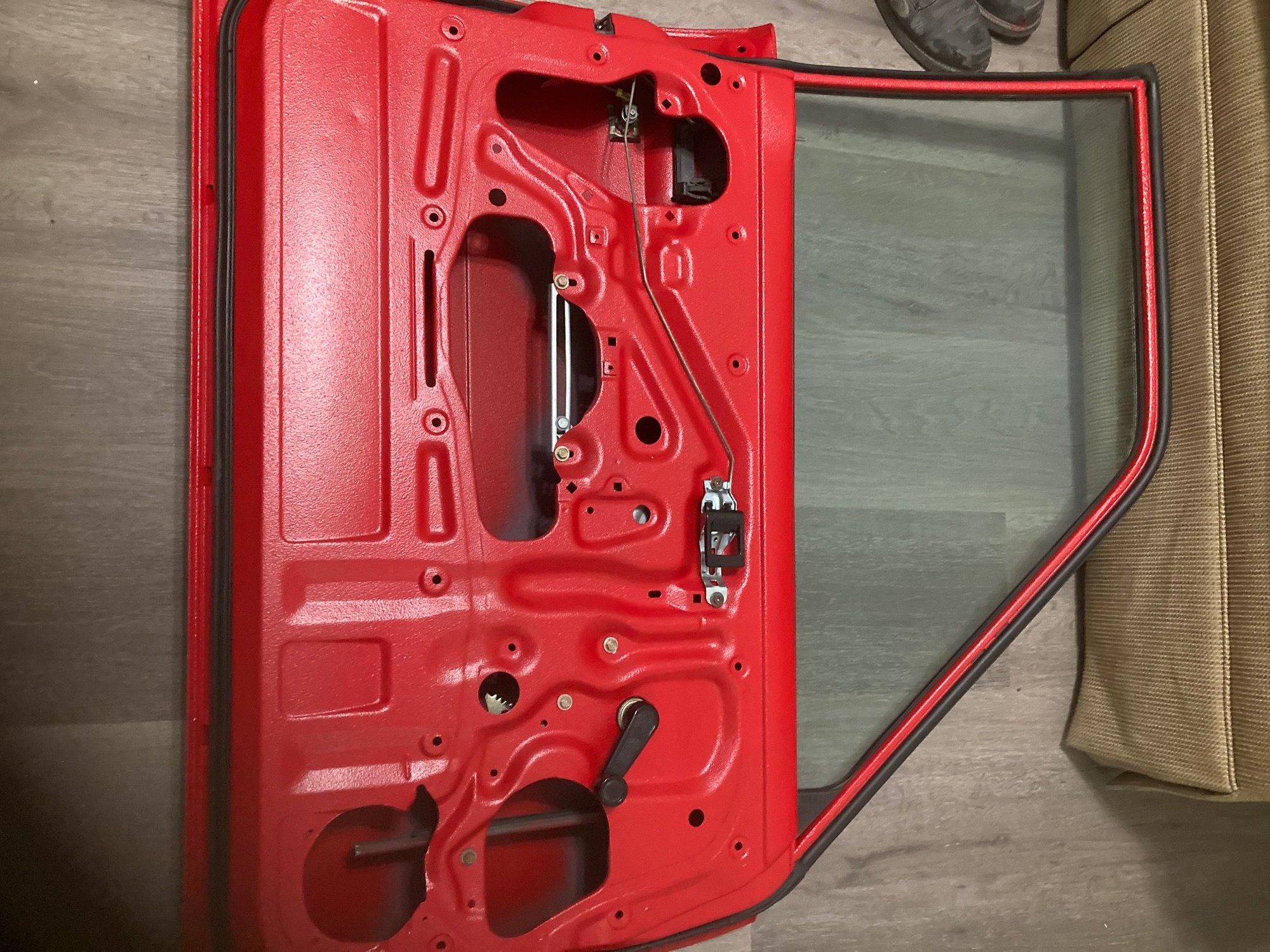

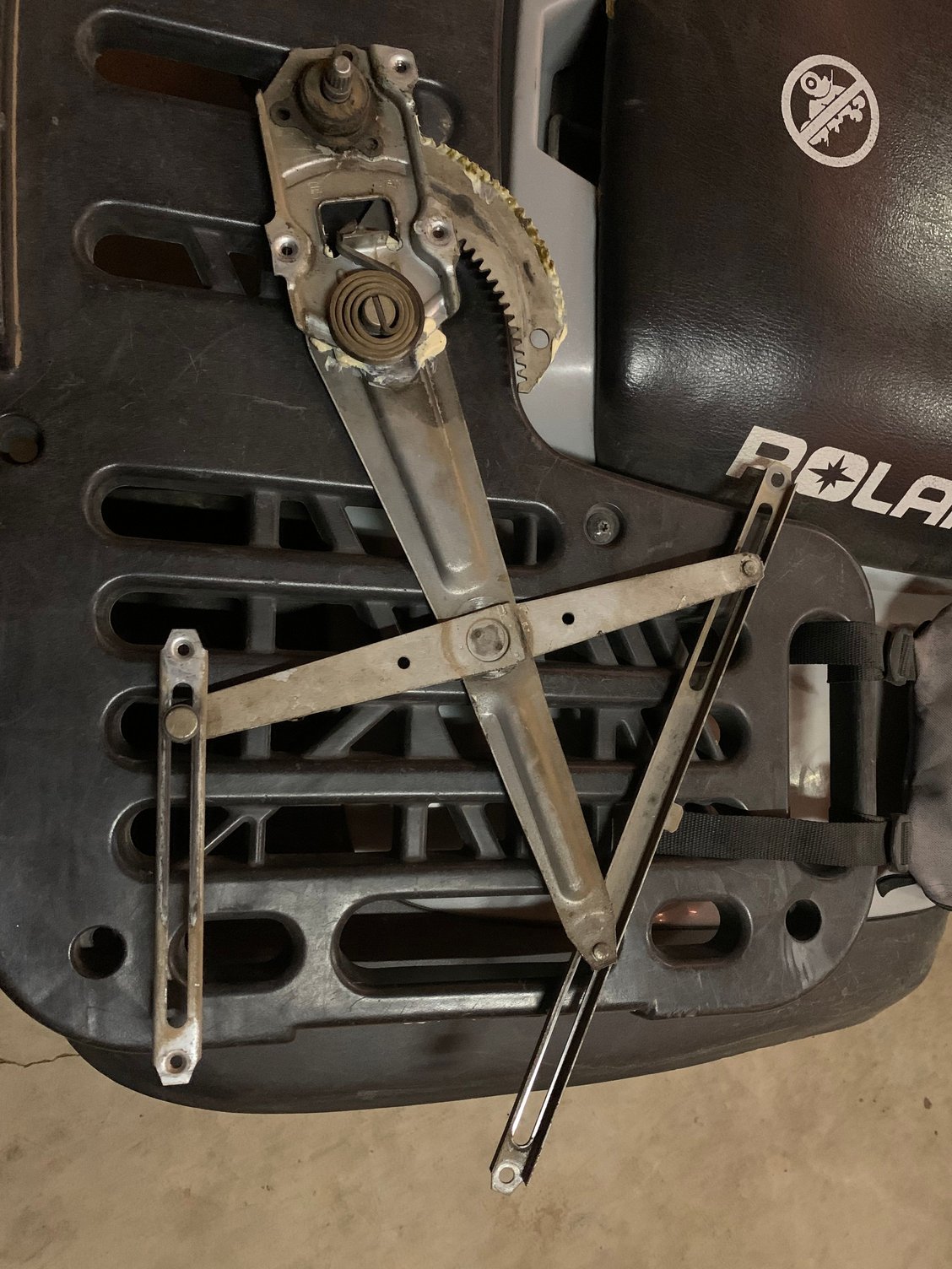

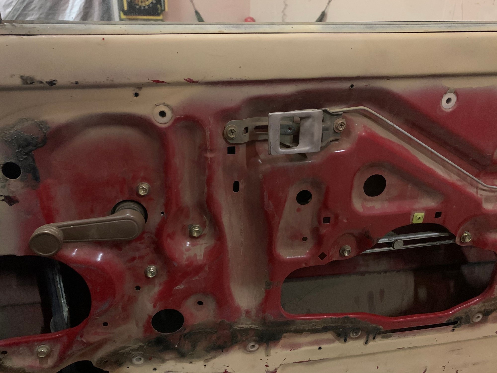

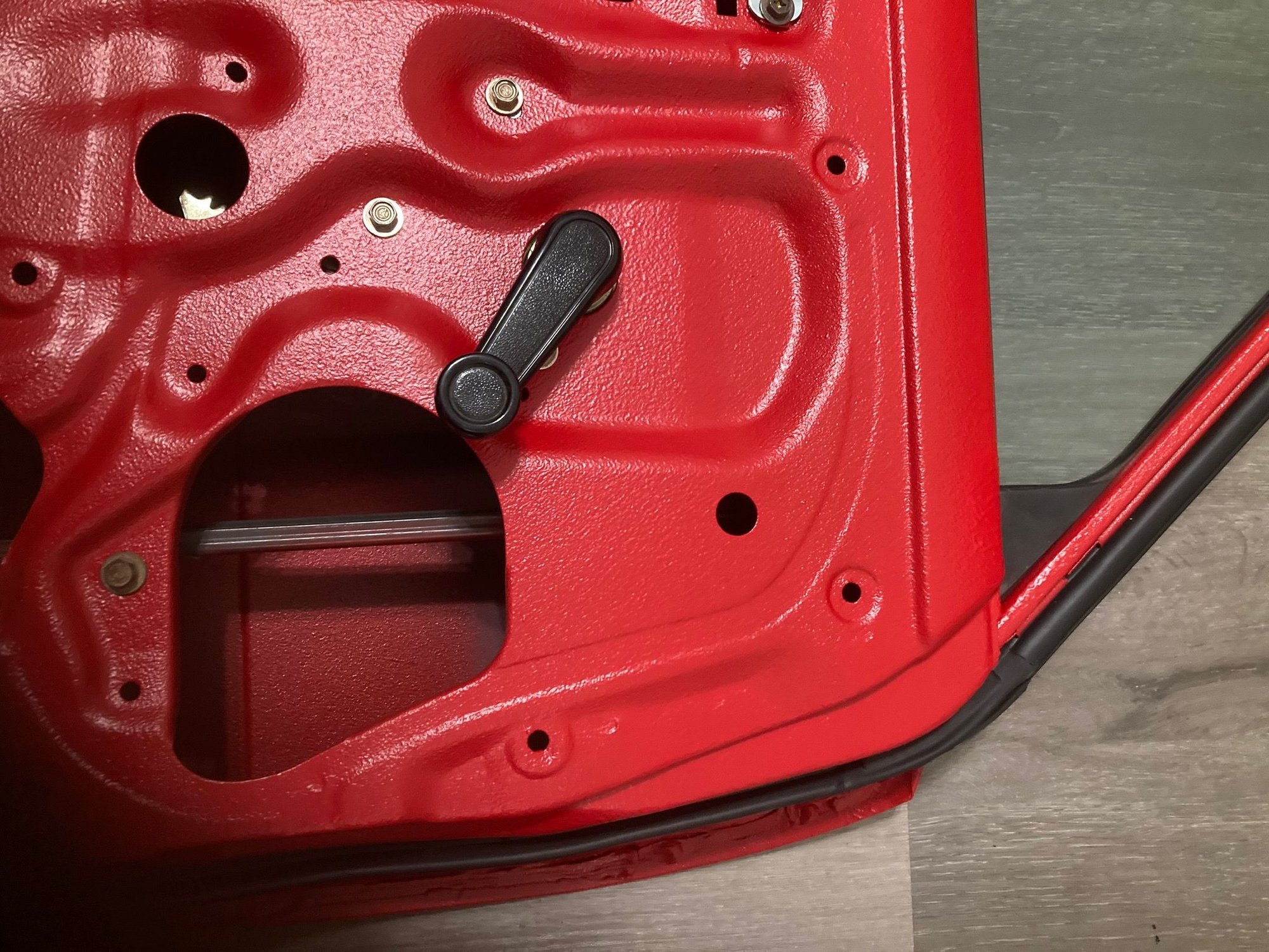

What rubber are you talking about? The window trim that snaps in? I have both of those snapped in. Here are some more pictures of the door. It’s an 85 pickup. This is what the window mechanism looks like that I put in.

Ok, The triangle piece in the front of the door should be attached to the rubber that goes inside the door channel and the other end is metal and sticks down inside the door and has a bolt that attaches it. On the rear of the door there where the rubber reenters the lower door there is a frame piece (see pic above) The piece goes inside the door and is right in front of the door lock assembly and the rubber goes inside that bracket or frame piece. That piece is what keeps the window from shifting out of position. Note: If you don't have all the rubber in the channel it's not going to work.

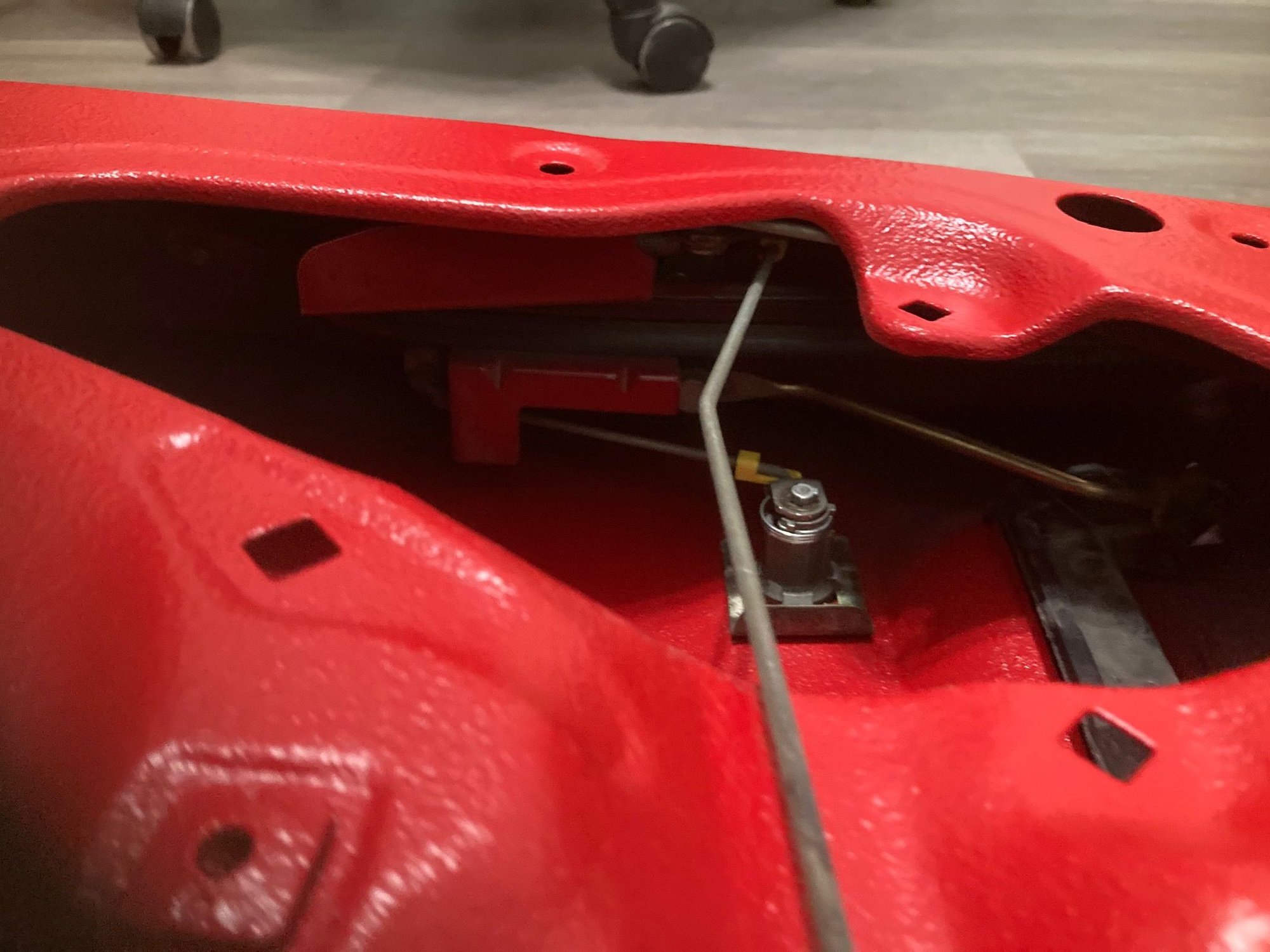

here are a few pics of what I'm talking about
This pic shows the triangle piece and the metal piece that goes inside the door and bolts up
This pic shows the frame piece inside the door near the lock assembly
This is the door, just like yours
