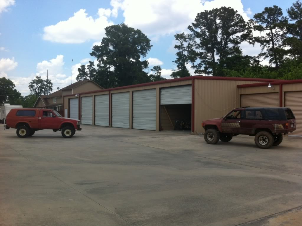

When I went to look at it

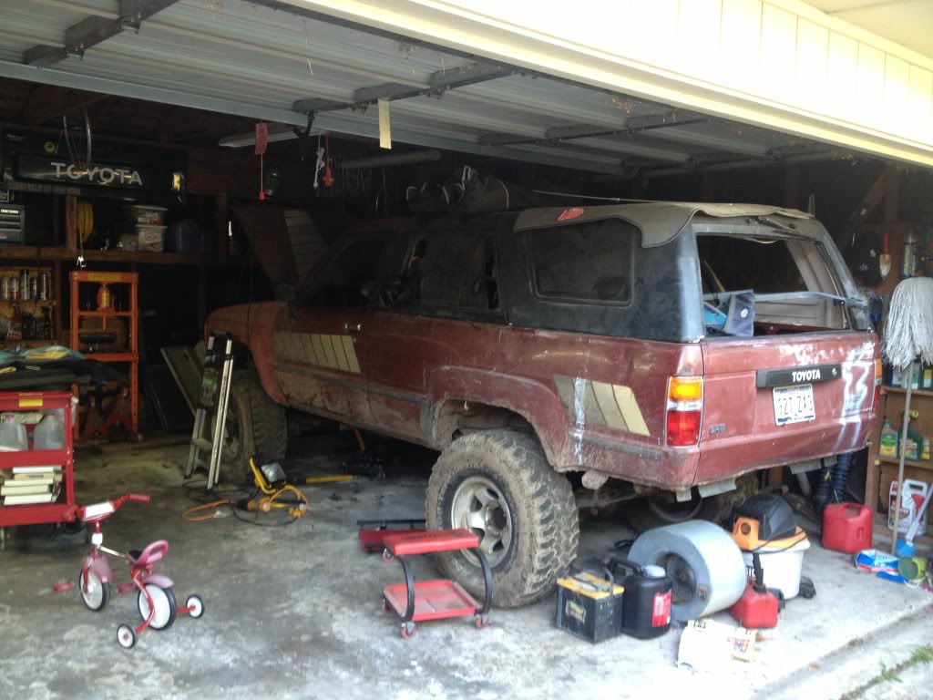

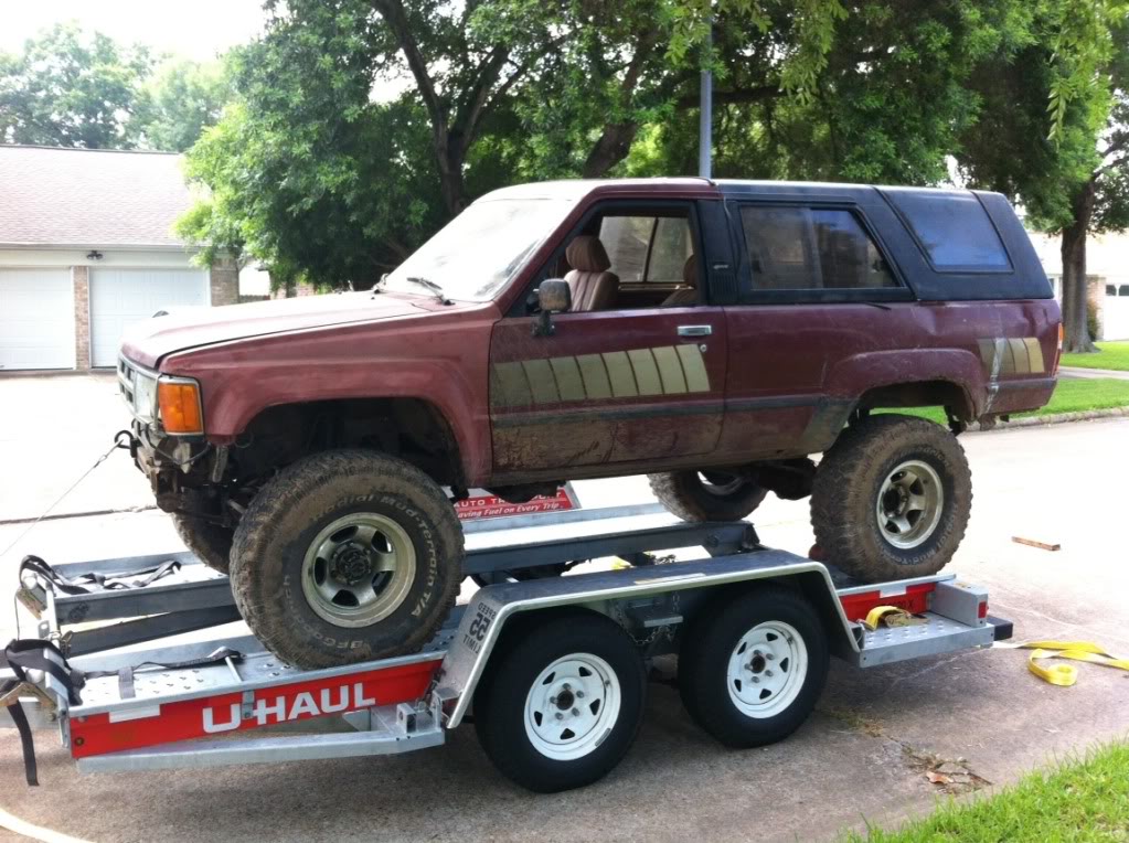

Loaded up!

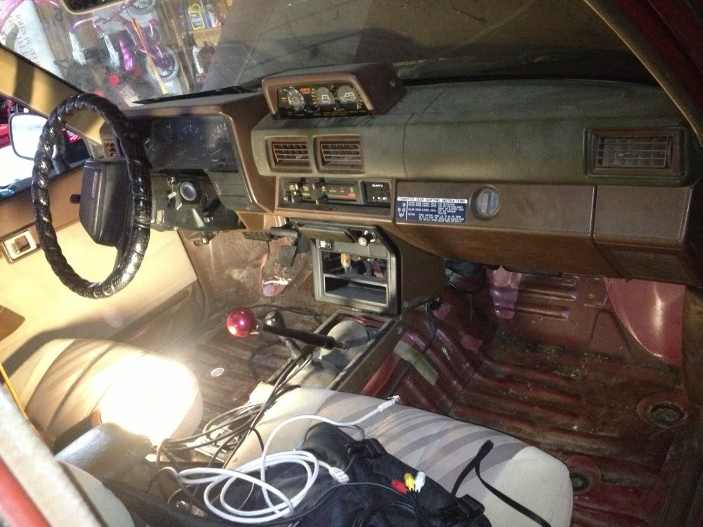

Interior

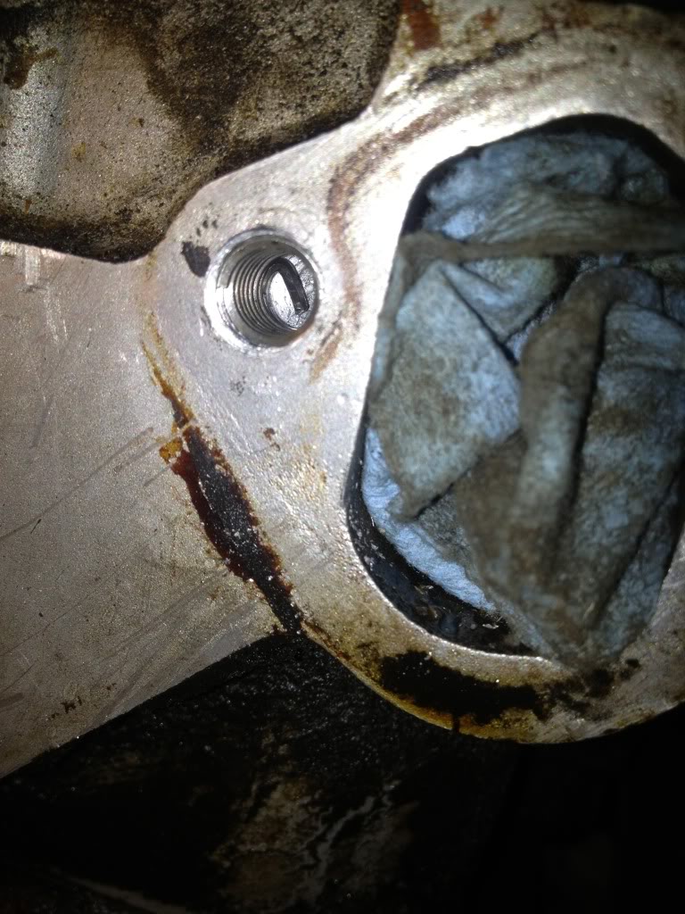

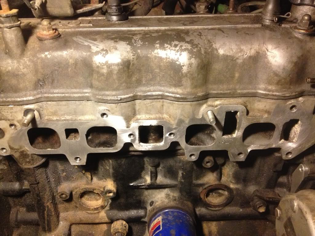

Removed intake manifold only to discover desroyed threads in front part of head. Tried my luck at Helicoils...we'll see if they hold...torquing them down tonight for reinstall hopefully.
Rewind:
On FIRST reinstall after desmog as soon as I added coolant it started POURING out of intake...this SHOULD have been a clue that they weren't tight...just thought there might be an issue with squareness of head (recycled intake manifold off of another 82 as well bc original was destroyed trying to remove water plate on bottom for desmog)...well I drained all coolant just to see if it would fire (needed to hear it...i had been slaving away seemingly forever to get everything ripped out and needed SOME sort of confirmation I did something halfway right). I turned the KEY and POW! strange sound I've never heard before...turned key again and it started fine for a few seconds (w/ starting fluid)...my heart sank when I saw liquid coming out of exhaust pipe...I immediately knew my mistake...I was afraid I hydrolocked the engine. Checked again to make sure all coolant was out and I figured damage was done...so i tried again...once gas made it to the new carb it fired right up and idled smooth! Kind of a whine/whistle (maybe leak from intake?) was only sound I noticed..
Now:
Gameplan for tonight is to try and get everything reinstalled/torqued down and re start engine...more to follow...
My VERY FIRST attempt at helicoil last night!!! HOPE they hold...didn't seem too bad once i got the hang of it...never even tried tapping before...seems sturdy...

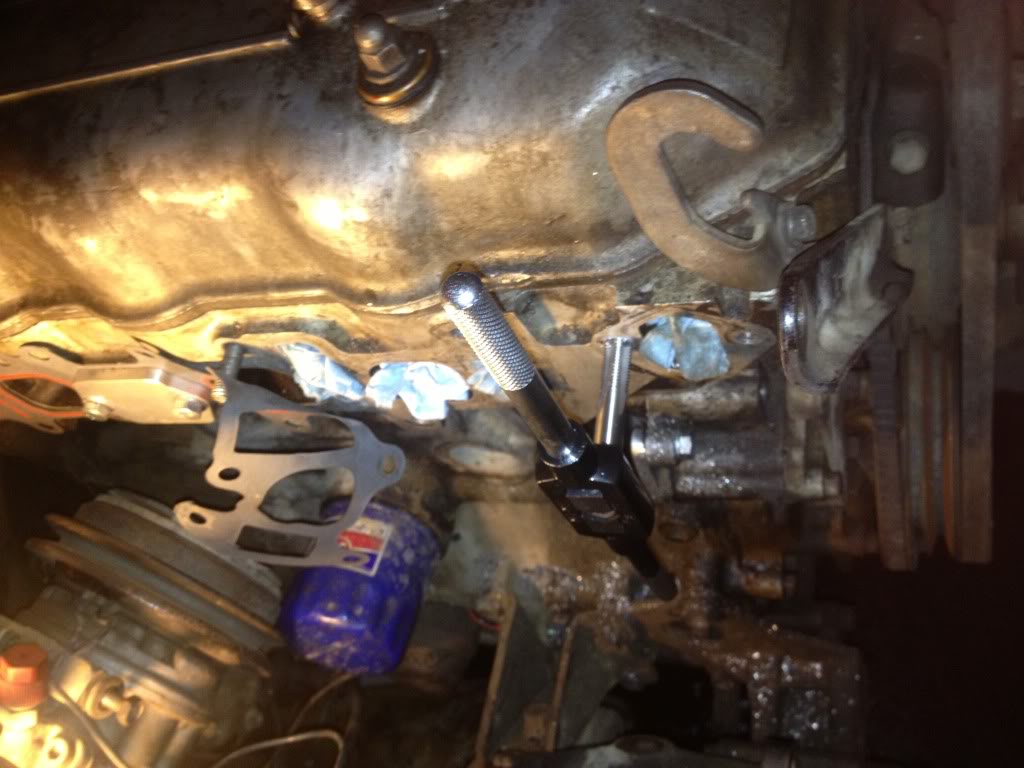

Installed...I DID remove that tang at the bottom before mounting fuel pump.

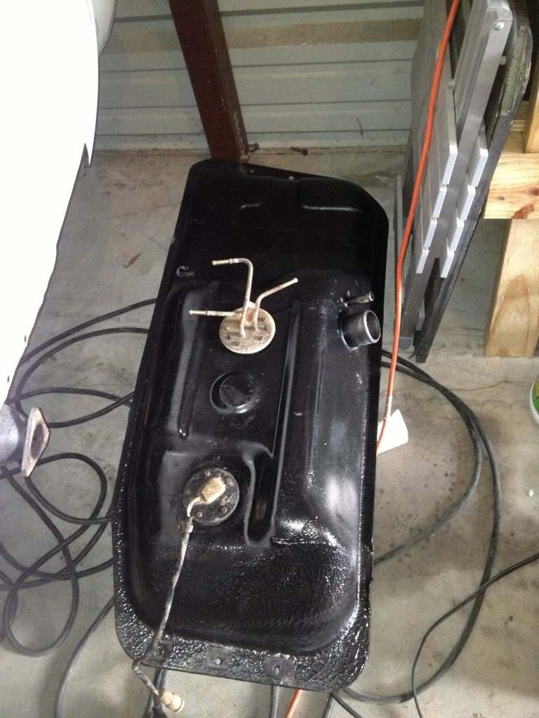

Nice clean tank

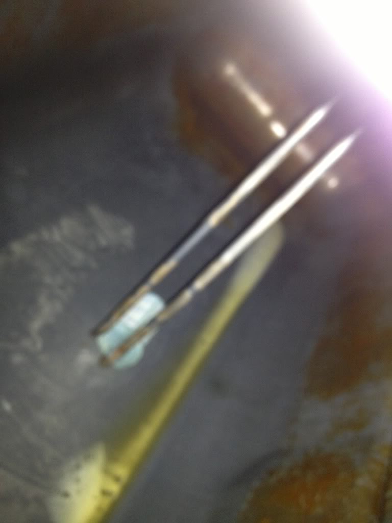

All shiny and new looking inside!!! Even got a new pickup screen from dealer...(fluid is WD40 to prevent flash rust)

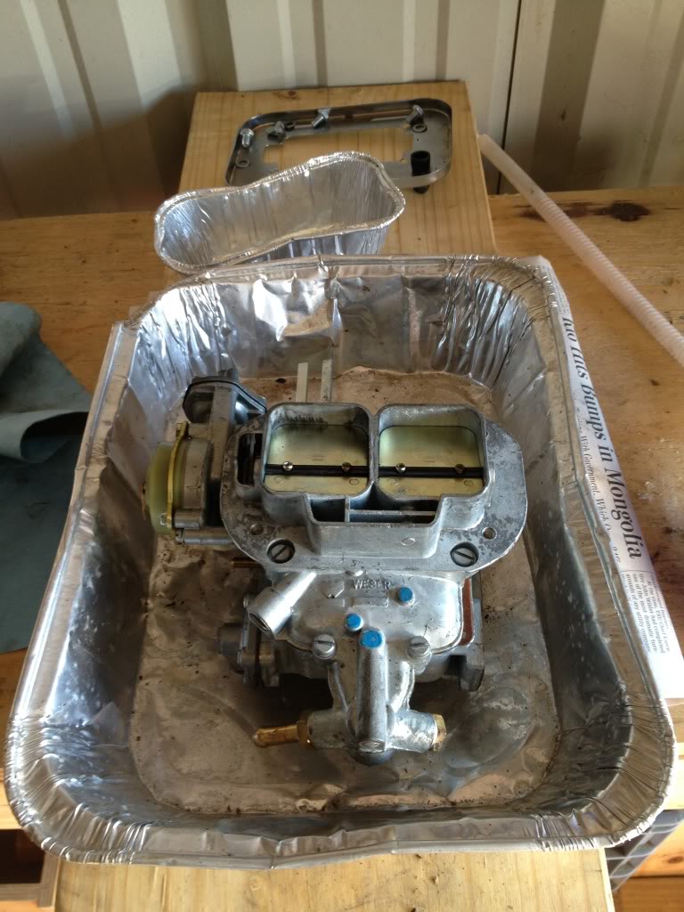

Prepping for my first Weber surgery

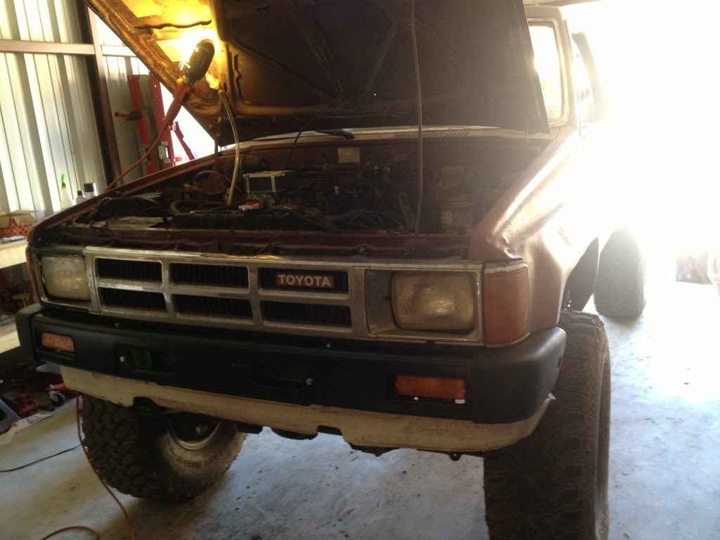

Also started trying to make this look more like a 4Runner...had an extra valence/etc from a truck I had a LOOOOOONG time ago (I KNEW I was holding on to it for a reason!). Ended up picking up front bumper/bumper ends/brackets from rockauto pretty cheap...I want to eventually paint grille black for more utilitarian look. PO also gave me a drivers side fender he had painted to match...he just left older/more beat up one on since he planned on wheeling it...I ended up bolting it on to see how it looked...I'll post updated pictures later this weekend.
Hoping to get exhaust knocked out tomorrow as I have NOTHING other than the manifold/downpipe...I'll prob just take to shop to get it done as it will only save me 70-80 bucks doing it myself (based on my math and estimate from local shop)....anyone done homebrew exhaust setup with all flexpipe???
