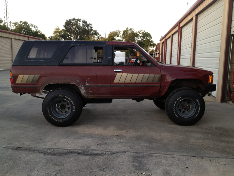

looking great man, love the color of it, if you decide to keep 5.29s they go great with 36s, I had 36s and 5.29s in my 86 and speedo was dead on and had plenty of get up and go, could hold 65 or 70 on the interstate as well but it was at 3,000 rpms, been toying the idea of trading my z71 for a runner....

Thanks, all! I appreciate the encouragement!
