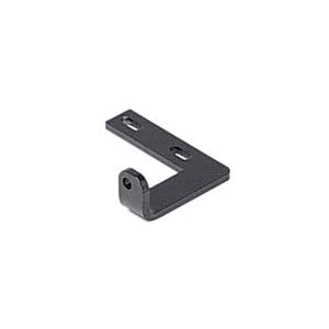

Installed the winch Monday night and realized that warn doesn't supply the M8000 with a solenoid bracket to mount the solenoid control box to the winch
I had to cut off the forward facing light tabs to install the winch. I also had to cut down and pound out one of my front rock light tabs.
Here's the Warn bracket for $12
Here's mine for free (minus about half an hour of labor)
What it will look like installed. Still needs painted.
