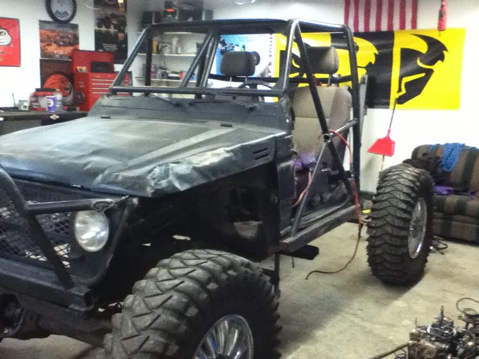

Not sure where this fits in but i'll post here and hope you guys don't mind too much.
I'm james and my suzuki is ending up with a lot of toyota parts.
this is my rig before i started the latest swap
[YOUTUBE]http://www.youtube.com/watch?v=S-E0hwMifOs&feature=plcp&context=C32ccf44UDOEgsToPDs kICv0cgPKtaGpZeryflYyDu[/YOUTUBE]
heres how it was 3 years ago..
then i put yota leafs and axles on it and stretched the wheelbase
i always wheeled with built toyotas so i was always modifying trying to keep up with them and my short wheel base was killing me on climbs
i linked it front and rear and went to 113 inch wheel base
moved to moab for a year and wheeled a bunch
the rig took a beating over the year.. and motor was worn out.. so i was going to swap in a 22r with dual cases.
then i found a good deal on a lexus 4.0 v8 and decided to basically just rebuild the whole rig

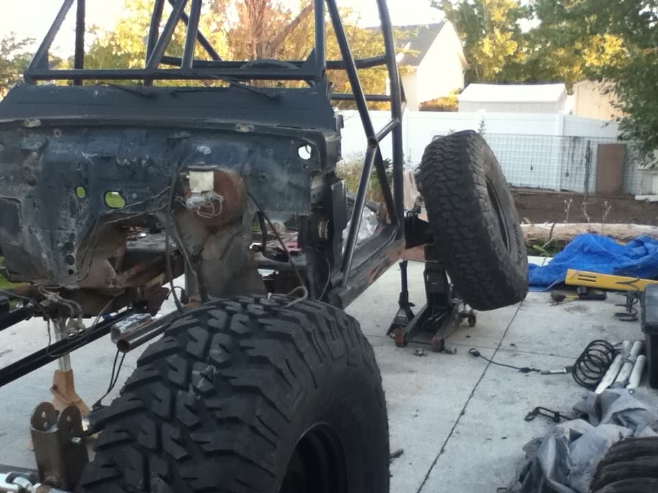

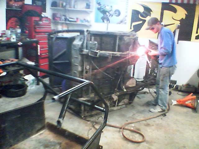

moved the rig once again so i had to take it apart since it wasnt together enough to move it the way it was
so it sat out in the weather and has been rusting away behind the neighbors house..
but my girlfriend got her land rover running and pulled it out of the way so i brought the zuk home and got started again fianlly
here rover when i used it as a daily drive..
dana 44's locked front and rear 5.89s chromo shafts in both axles and ctm ujoints
heres her rover after she took the 14 inch gas powered cut off saw to it.. on tons and 40 inch stickies
got wiring harness and got most of the motor stuff plugged in
working outside kinda sucks but i finally got the zuk home and unloaded.
rear suspension is all welded on on the frame side and axle side is tacked up pretty good but not burned in solid yet
my 40 inch good years are alot bigger than my 37inch treps
i dont know what to do about the front still.. my pinion is rotated up 8 degrees with knuckles at factory angle..
if i rotate the axle down i can get about 5 or 6 inches of up travel before drive line hits on oil pan
but that puts my knuckles rotated back pretty far and i think my tires will flop side to side instead of turning..
i dont want a panhard but i dont know if i can get enough triangulation to get away with a 4 link
sorta got things figured out so then i played with the calculator a little bit
so this is what i think i can fit in the front
rough estimate on weight and cg height
anyone see anything horribly wrong? I worry that thats not enough triangulation to keep the axle under the rig..also not much vertical separation
fancy throw out bearing.
drive line wants to hit on oil pan

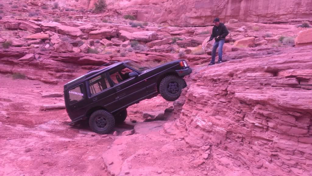

I bought a stock landrover, then trimmed fenders , tube rear bumper, sliders , welded rear diff and added 33s

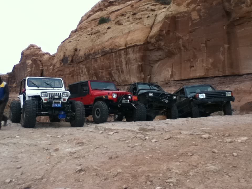

took it to Moab did hells revenge, steel bender (twice) flat iron Mesa , PRICHETT canyon, some of strike ravine, and the bypasses on greenday
Everyone at the end of prichett
Jeep with 42s, jeep with ls1 and 38.5' yota with 37s. And land rover with !no lift and 33s

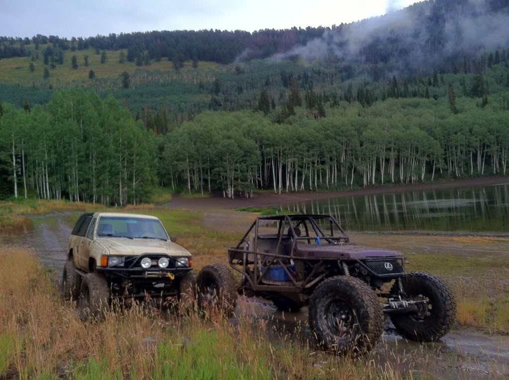

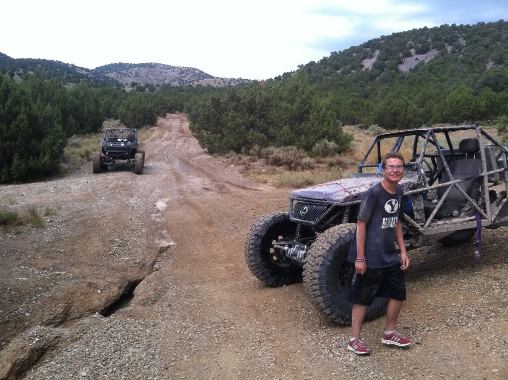

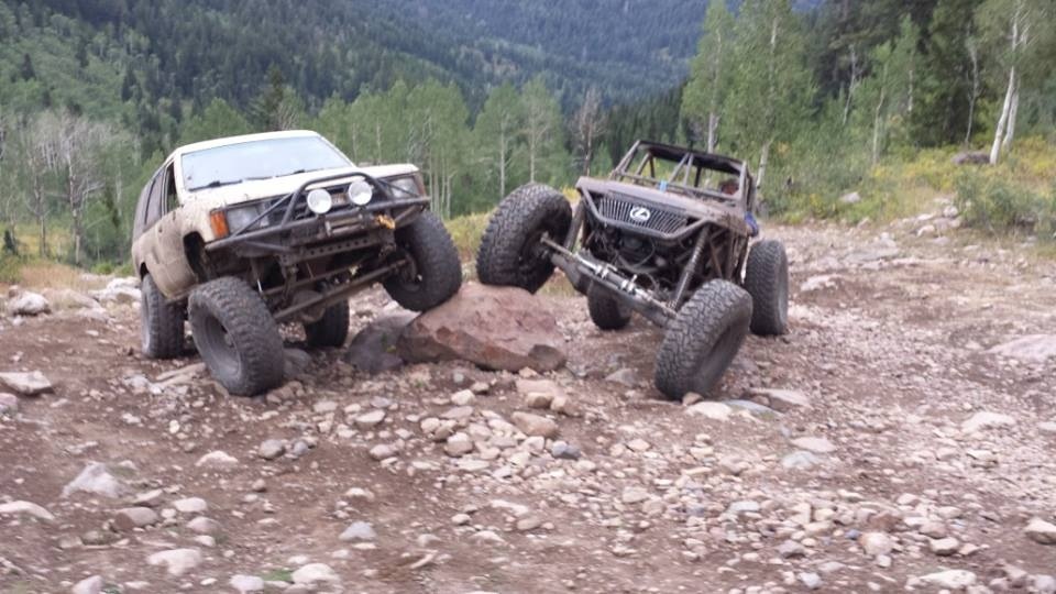

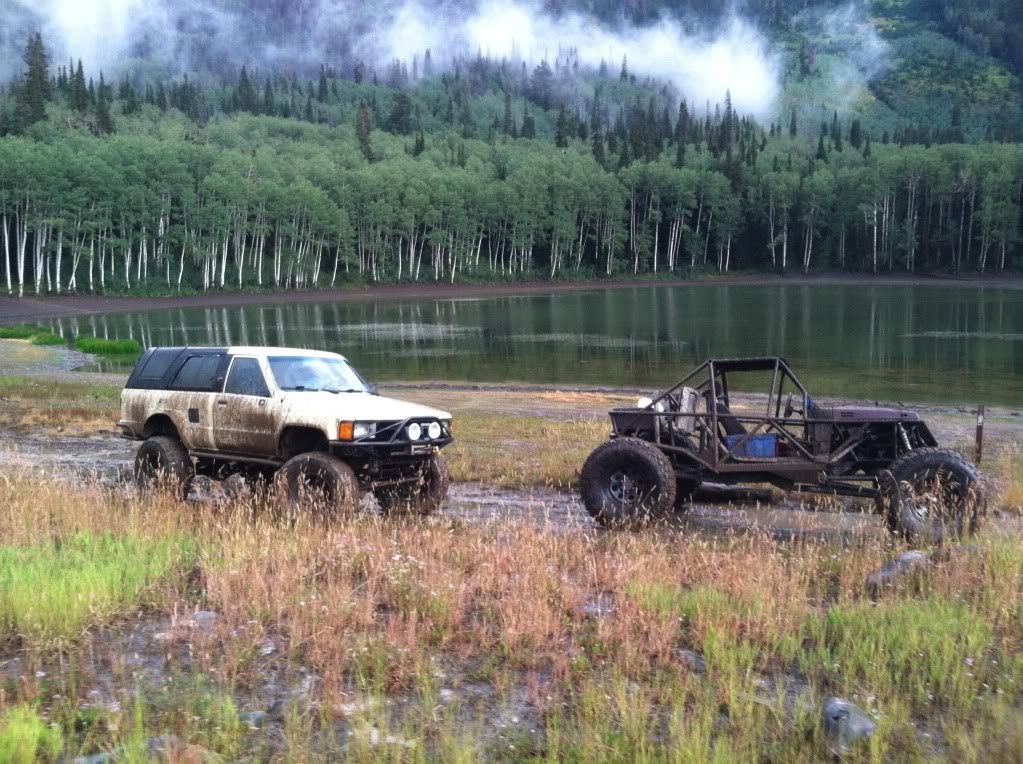

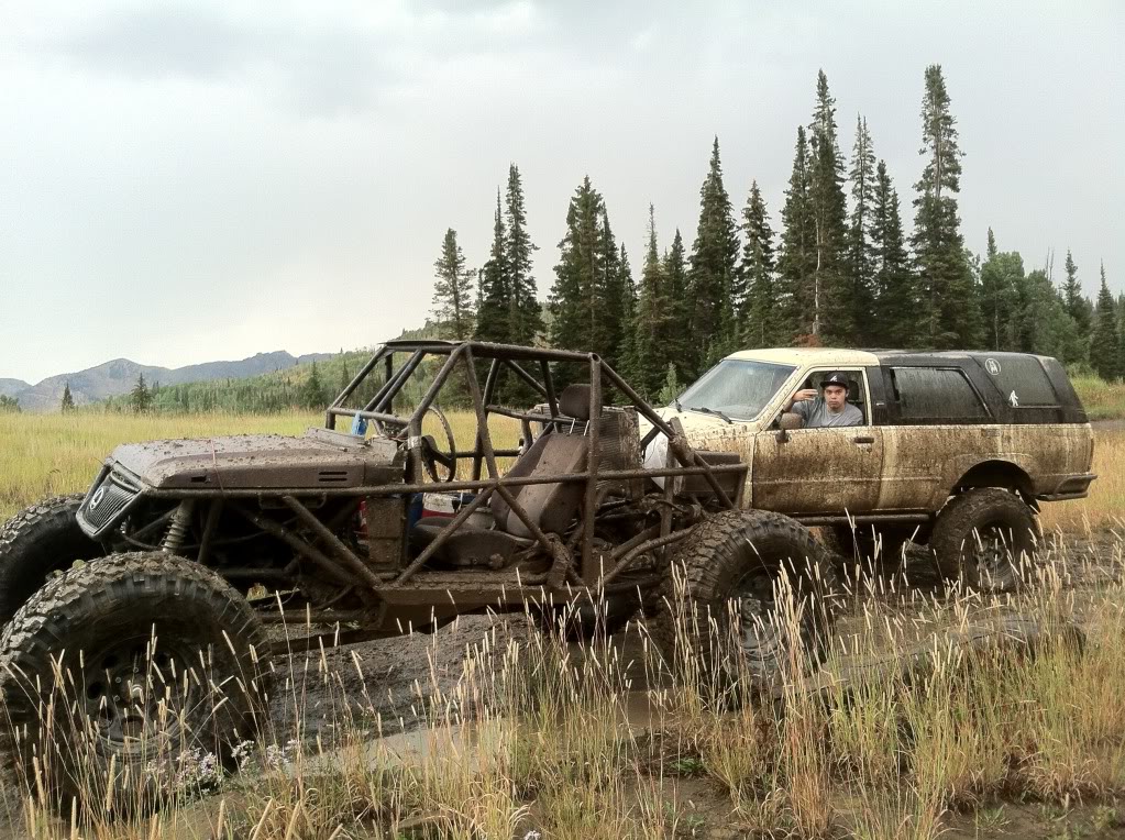

Maiden voyage for big green and angel and first trip on Maddies buggy since she used and abused her buggy in Moab so we weren't to sure how it would turn out
7E24A213-D2E3-4BA8-B5B8-9CDA387D3A2D-152-00000083C3F6D7FD_zpsf7a5bedf.mp4
The end of the trail it started raining hard and got real slick
Maddie got a flat on the way down tire was low and going fast around corners burped it out
My nephew had a blast even though his glasses were all muddy
Thought this pic looked cool
Made it home with minimal issues (for us anyways) and a few mile hike at 5 am Maddie got 2 flats and the jb weld on her air shock let go again,
My new output seals leak like crazy front and rear , front axle seals leak like crazy !
The captin rob racing/lowrangeoffroad Toyota needs a new wiring harness
A Sami might have caught on fire
But we make it home safe and muddy

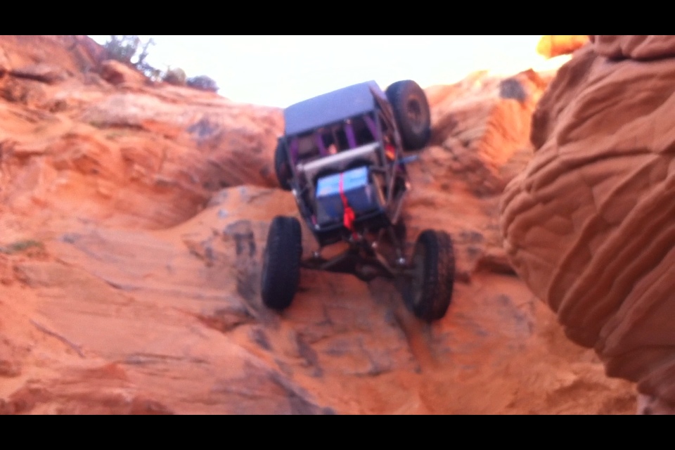

1uz,r150f,dual ultimates, fj80 axles, front uses a rear 9.5 diff
october 6th first moab trip
october 13th first sand hallow trip
both of these were solo trips so i didn't get too crazy not wanted to get stranded in the desert the day i was heading home
