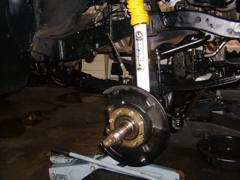

Here are some pics of what i have done so far and it has come a long way but i still have alot of work to do.

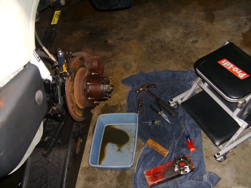

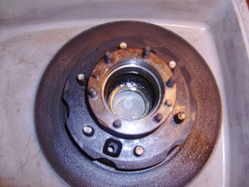

Replacing break pads, rebuilding calipers, regressing bearings and hub assembly
Cone washers are hard to get off!!!

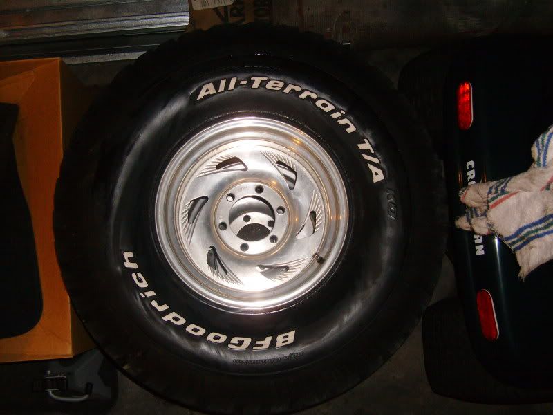

Center Line Rims with 35x12.50 tires

Hub parts
Right front strut

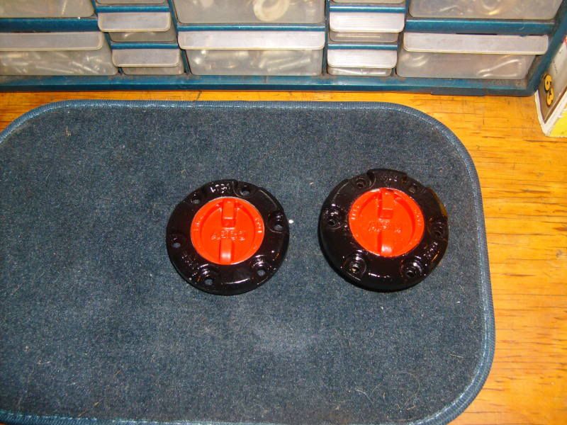

Repainted hub locks

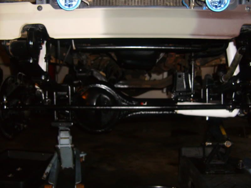

Undercarriage before & after
After

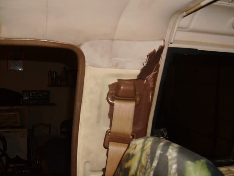

Needs new B pillar covers

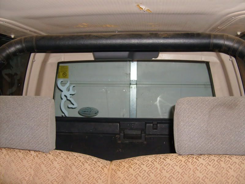

Roll Bar

How big is your SL lift? Obviously you put 35's on. My ProComp is 4" and I'm planning on going 33's (295/75 16). Recently, I've found a deal on 35" Boggers and now am torn between the 2 tire sizes.

3 inch suspension lift in front and 3inch blocks in rear

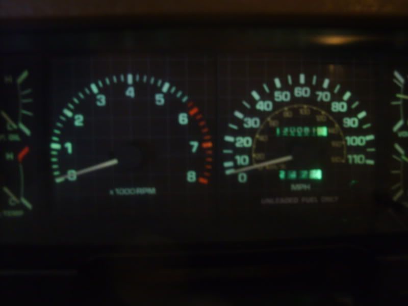

I need what you got
I want that altimeter on your dash!!!!
You know anywhere i can get one????
Im also looking for the turbo digital gauge cluster if you can help me with that.
If you are referring to the cone washers that are in the hub assymbly that hold the locking hub tightly in place, they are not that difficult to remove.
Just loosen the nuts that hold the hub until they are just beyond the end of the studs, then tap them with a hammer and the cone washers will "pop" out of the taper for easy removal.

White lettering looks better on the inside black wall out imho.

How did you go about cleaning up the undercarriage?
