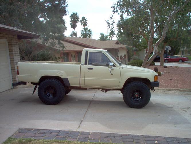

fwiw here is a pic of my abused worn out ifs front end sagging. with 33x10.5x15.
i did have to pound in the pinch weld to stop the rubbage.
aired down offroad i didnt rub, would most likely at full lock and compressed up at street psi tho.
32x11.5 is a good choice to tho, little smaller, and more width for more traction
