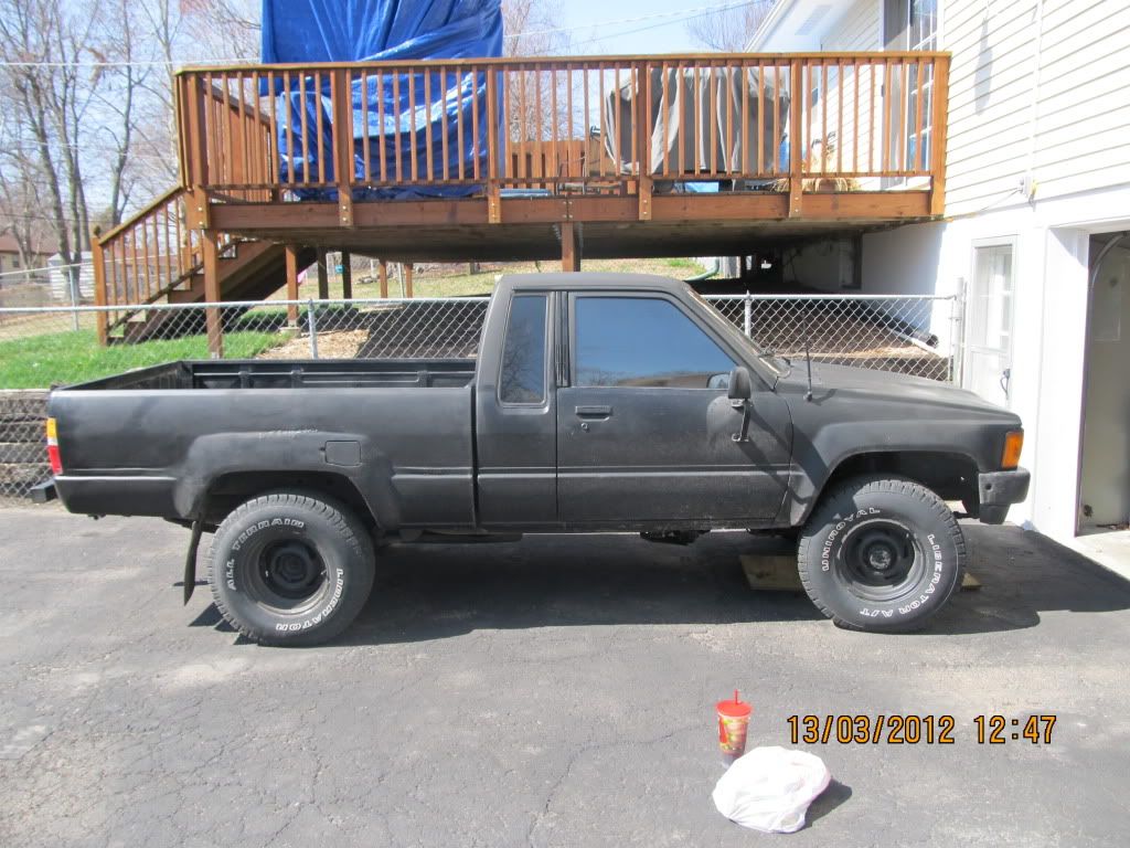

We bought this truck about 3 months ago. Got it home and it was 3 quarts low on oil checked it before I bought it and it was full. Had oil all over the bottom of the motor and the valves where making alot of noise now. So took it to a friend of mine and said the motor was toast only had 135lbs of compression in each cyclinder. Said that somebody had put JB weld in the timing cover to cover the leaking oil. So i bought a rebuilt engine from Oregon engine builders and got put in with very few problems. Did alot of work to clean up parts on engine bay and the underneath side of the truck. Now it looks like a brand new truck. I have few questions what year of brake booster, master cyclinder,calipers, and rotors can i put on to make it stop better?

I hope the pictures turned out okay. First time using photobucket.

Did anybody look at the pictures did they come out?

I don't see any pictures.

http://s1263.photobucket.com/albums/ii635/Rntduckman/ Here they are I must of done something wrong. Sorry
