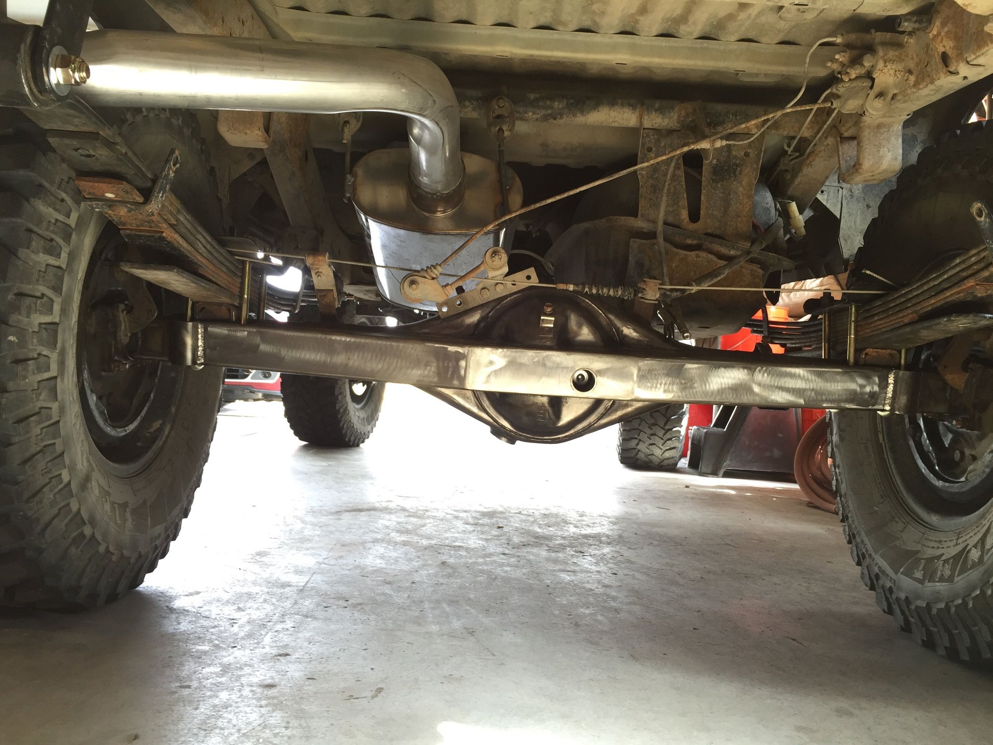

Well replaced all the wires, plugs, new cap and rotor and redid my exhaust. New exhaust is 2 2 1/2" into 1 3 1/2" outlet Magnaflow, little quieter than I was shooting for but I like it, all in all I think quieter is better long term. The tune up solved my stuttering issue I was having and now runs much better. Haven't done the fuel calculations yet but I'm thinking it's about 2mpg better based off my last tank. Picked up my canoe from where it was stored and drove home hitting 80 on the interstate no problem.

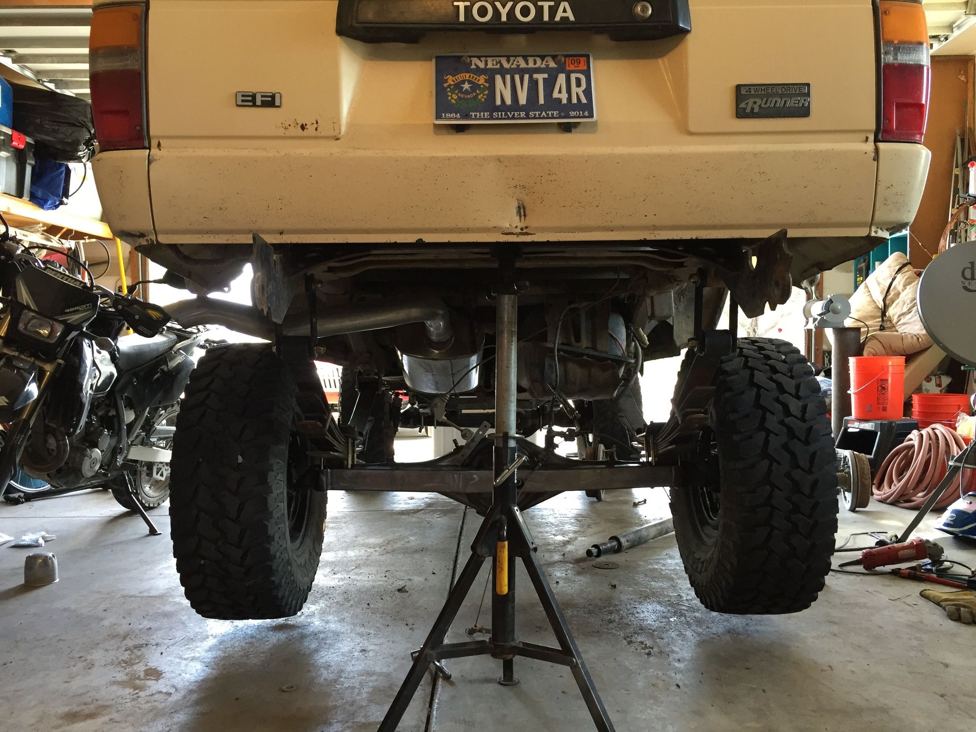

Finally installed my wider rear axle, and Explorer leaf springs. Waiting till Monday to get an extended brake line made and hopefully mount some shock on the back of this thing.

Looking good, I like the rear truss you put on the new axel. The exhaust turned out nice too! I need to re-do my exhaust and was thinking of doing the same thing (2 inlets with one pipe coming out) it's kinda of hard to route the exhaust any other way with the gas tank taking up all the space on the passenger side, lol. Have you ran into any clearance issues with the shackle making contact with your exhaust when your 4wheelin?

Not yet since I'm still waiting on shock tabs and extended brake lines before I can take it out and get it all flexy. But the way it is currently doesn't look like there should be any interference.

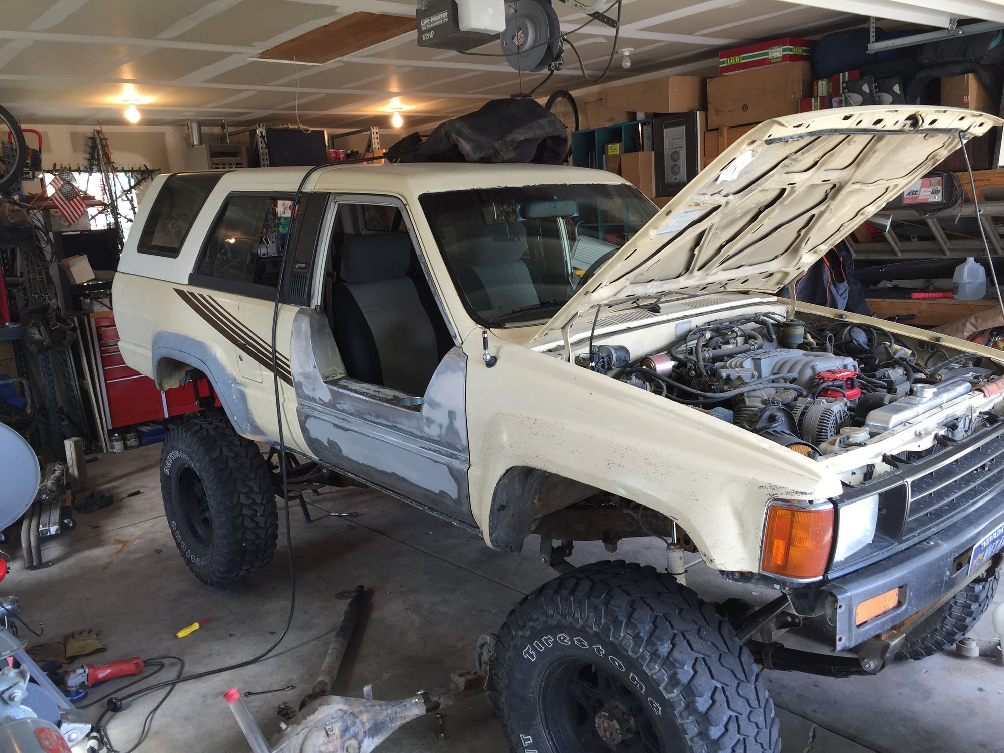

I can't pass on projects. I bought another 4Runner. Same people that had my 85. Got it to our "storage" property, threw a battery in it, new fuel pump and what do you know, the 4Runner that "didn't run" runs. I think the power steering pump and it has no rear driveline but I was able to throw it in 4hi and drive it. It held 75mph off-road with the a/c on. Ended up paying $650 for it. Bought the cheapest fuel pump I could find online so now I'm into this 94 about $690. Here's some photos.
Long term plan for Ol Blue is 3.4L swap, Total Chaos 4x4 long travel, deavers in the rear along with a T-100 rear axle. Will probably also do a dual T-case as well.

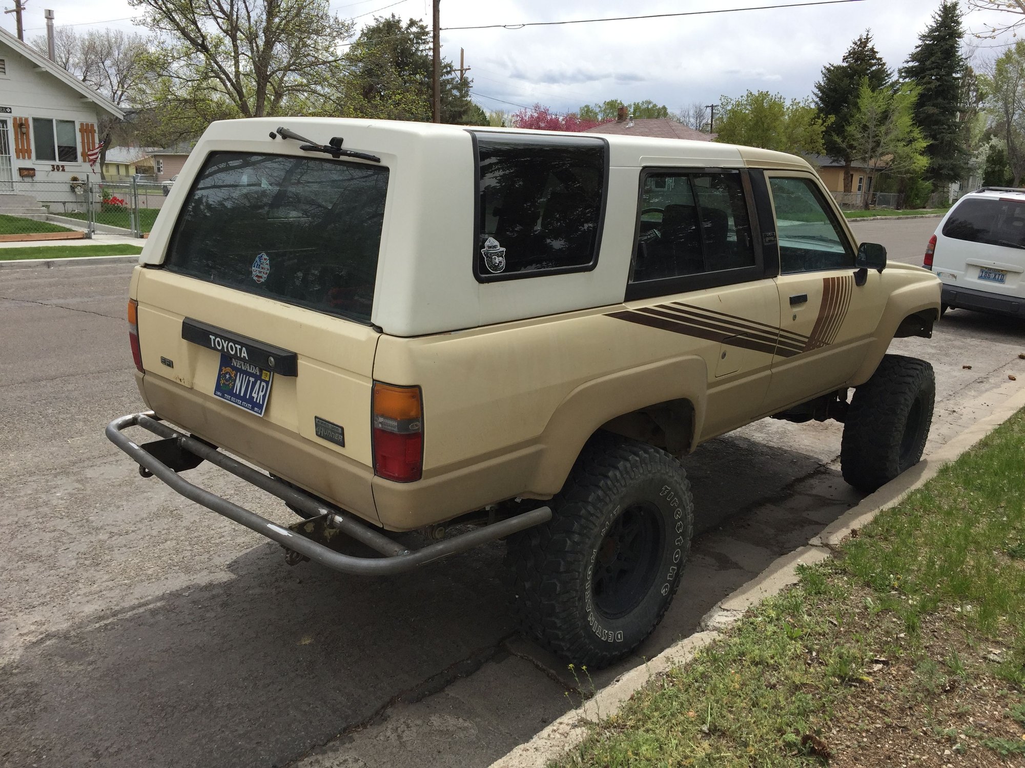

Haven't updated this in a long time. Most of it is still the same but I've finally done some work on the rear bumper. <br >
Trying to focus on what I want the build to end up as. So saving up for a 4WU 3 link front kit, and deavers for the rear. Unless I design the 3 link myself.

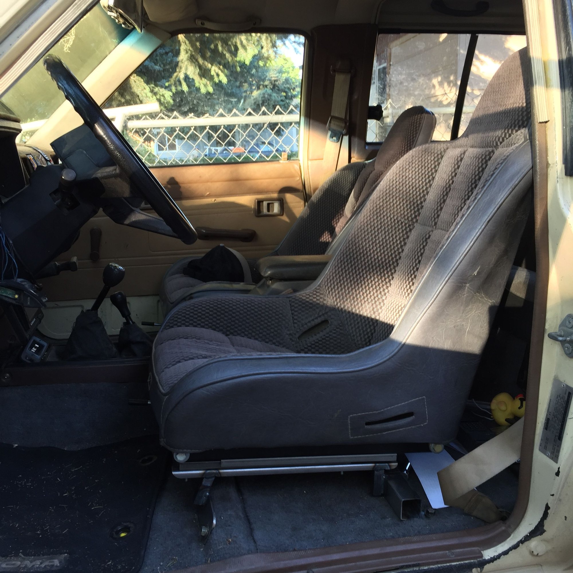

I've had some Beard seats laying around for quite some time. Since the stock seats weren't the best and I like how the Beards hold you in the seat I decided it was time to fab up some mounts. So I got some PRP slider mounts which conveniently mounted right up to the Beards and began making a solid seat mount. This is what I've come up with so far. I plan on making an aluminum plate that covers all the bracket from below the seat frame to the floor of the 4Runner for a clean install.
Old Jun 29, 2016 | 03:49 PM
  #140
rustED's Avatar
Joined: Sep 2010
Posts: 2,716
From: Tri-Cities, Wa
The seats look great, look like they'd be nice and comfy too!
