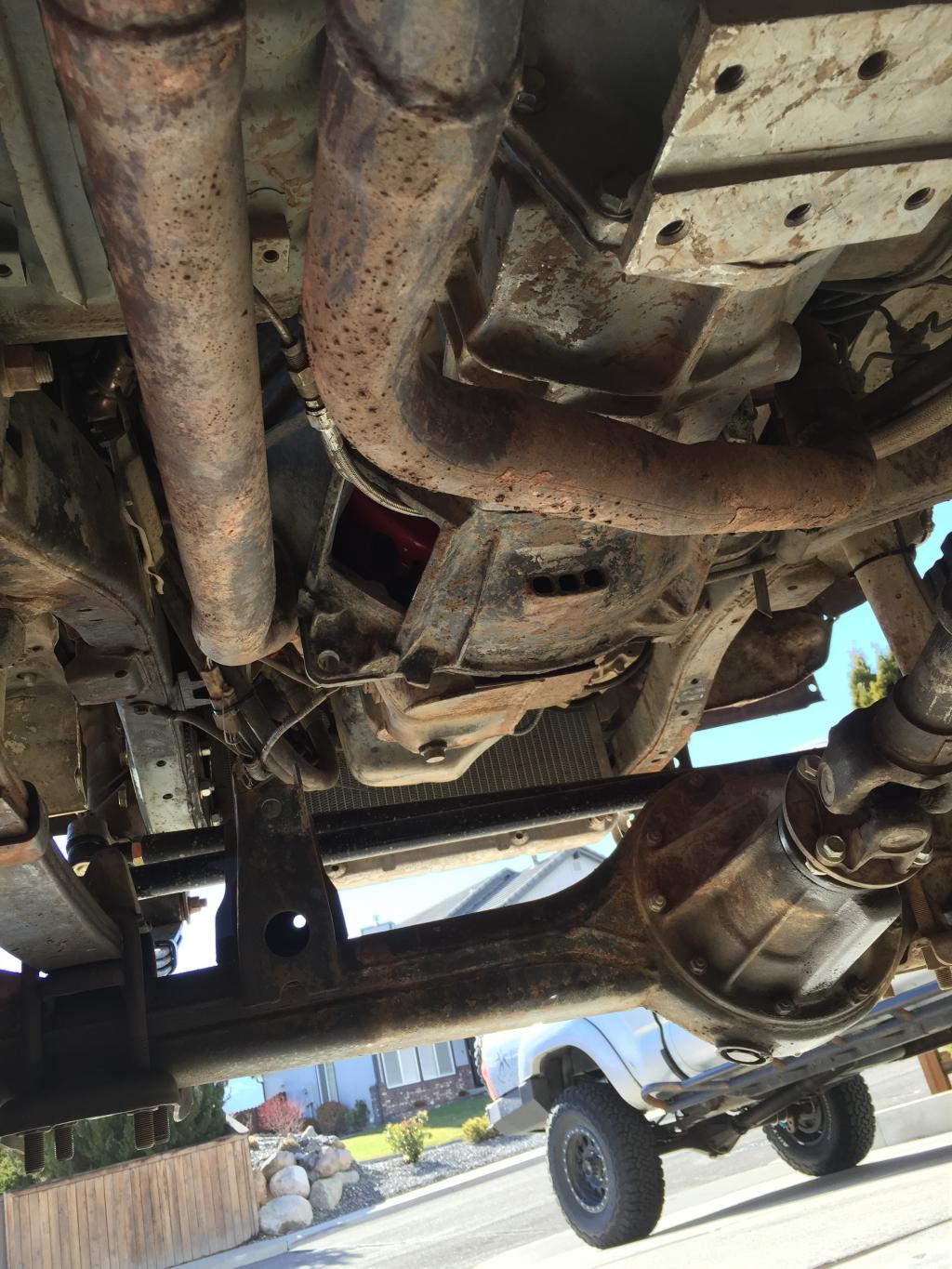

Hey I had a quick question, what are you running for exhaust, stock manifolds or headers? Do you have any pics of where they dump out? I'm thinking of changing mine, I'm tired of constantly chasing leaks, just looking or some options, thanks.

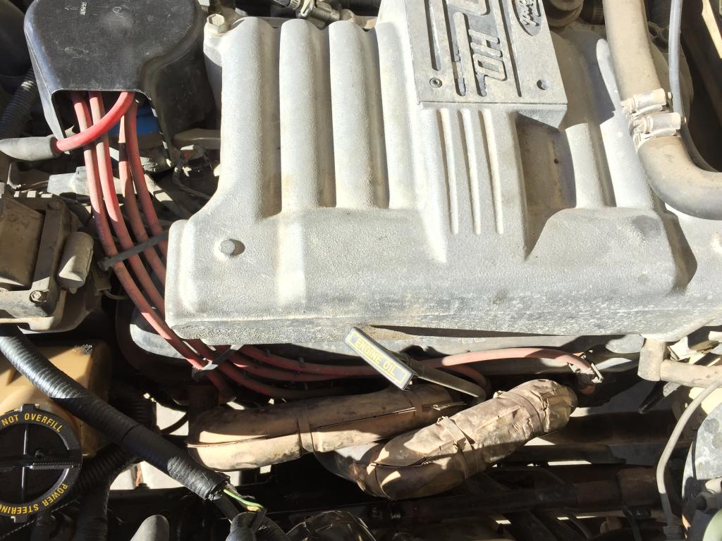

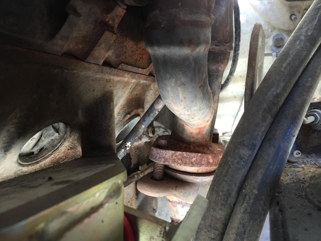

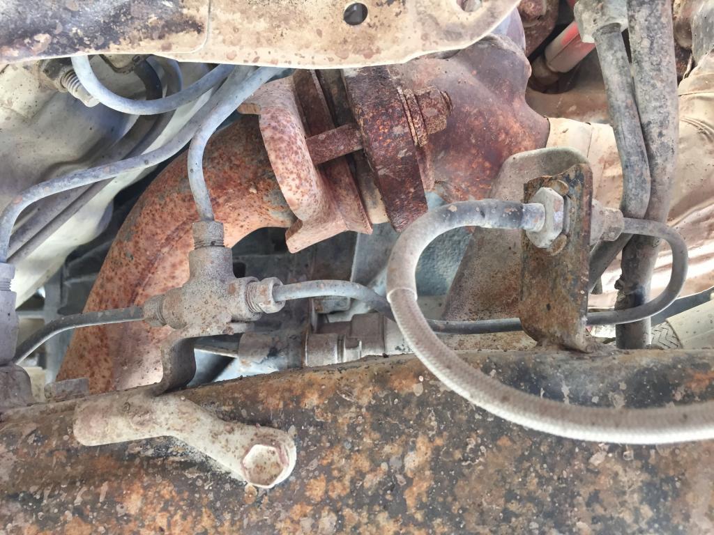

I'm pretty sure my headers are stock headers from the V8 Explorer back in the day. Hard to take pictures to really explain where they route but here ya go.
[URL=http://s772.photobucket.com/user/nvwiggins/media/37E82986-E5BA-45EF-AE99-107EEA9789FE_zpsw2b5wjov.jpg.html]Name:  37E82986-E5BA-45EF-AE99-107EEA9789FE_zpsw2b5wjov.jpg
View from passenger side wheel well:
Inside drivers side framerail:

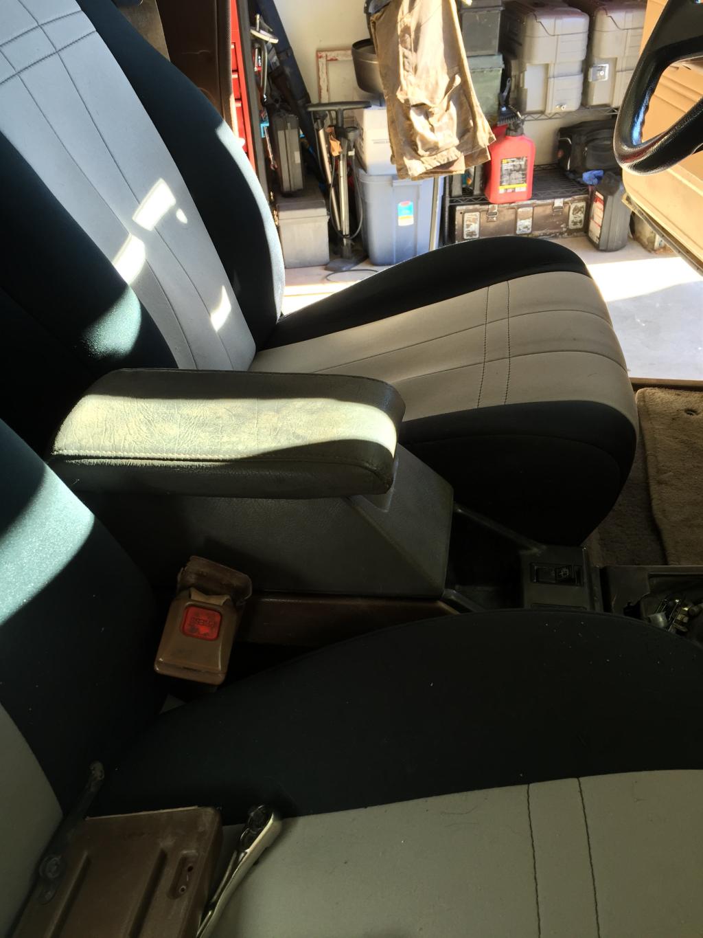

Also I went to Pick N Pull today and scored an armrest center console, and a perfect working CLINOMETER for 8 bucks!!!!!

Nice score on the armrest/console and clinometer, can't beat that deal! Looks real good installed!

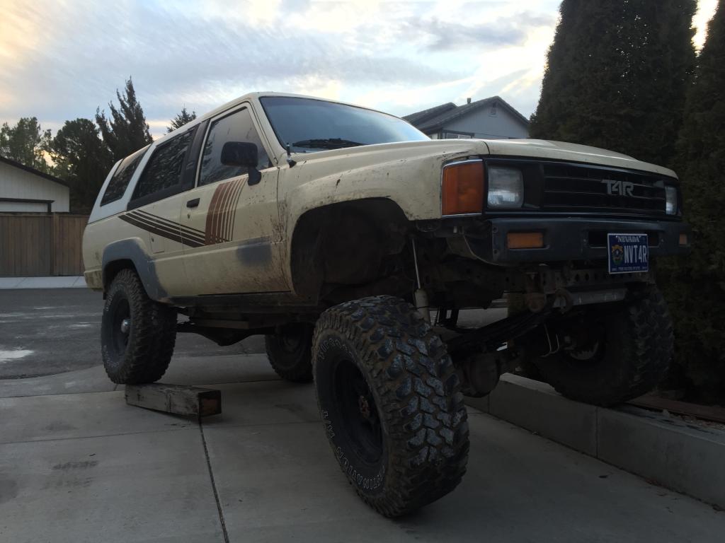

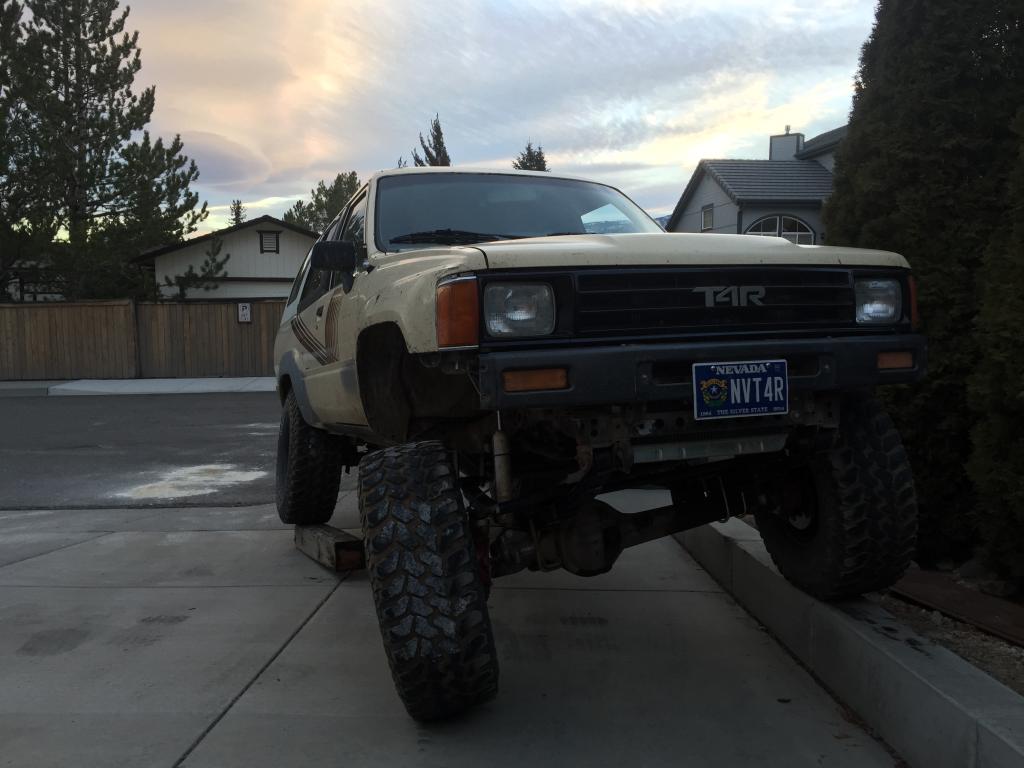

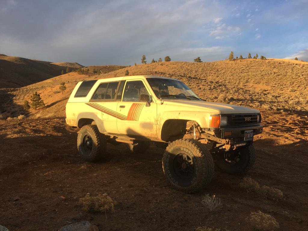

Welp few new updates, made 6" shackles for all four corners, got some used 3" TG HD springs and installed them.
Here is what it looks like now with the TG springs in the front.Name:  70D778E4-5660-47E4-917E-59205659468F_zpslj9mo4hx.jpg
Had to see what it flexed like in the driveway haha
With all that fun new lift/flex I now have to make a new front driveline, and get some longer shocks. I'm also going to swap in Explorer springs to the rear so I'll be relocating the front hangers and finding some new shocks for the rear too. It'll end up stretching my rear end 1.5 inches. Fun things happening!

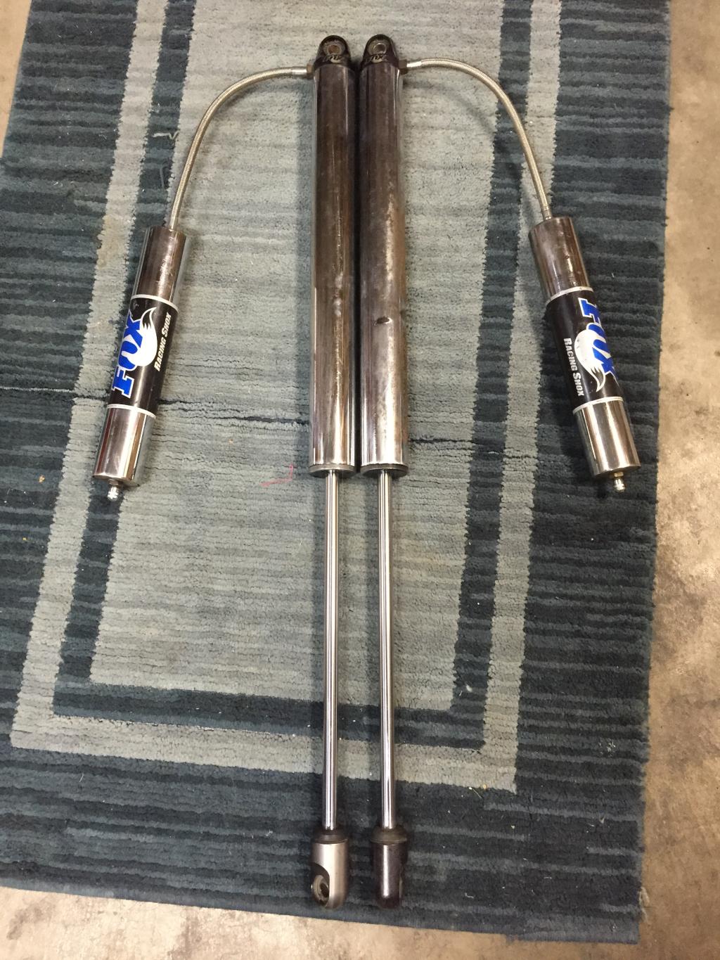

Other updates, I started building sliders on my break at lunch today, 2x2 .250 wall square tubing for the main straight bar and mounts then 1 3/4 .120 wall dom for the outer rails. And I may have picked up a set of these:
Which means some badass shock towers are in order!

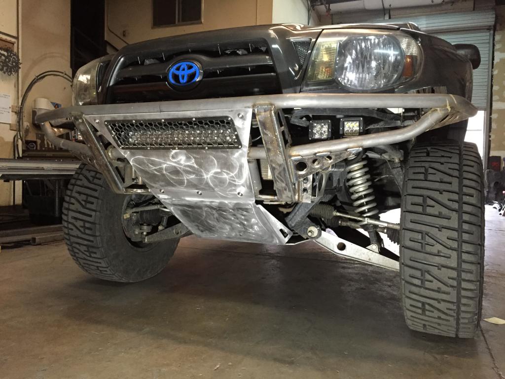

Started on my "lunch break" rear bumper today. Figured I'd share one of the front bumpers we've been working on in the shop, going to kinda model my front off of it, but fill in all the spaces with dimpled filler plates.

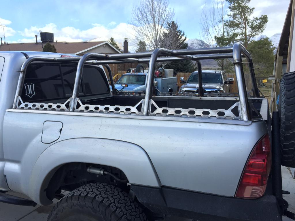

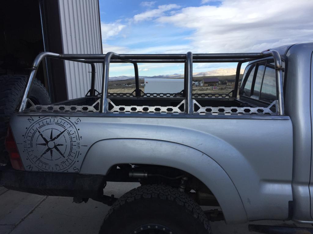

There will be some 4Runner updates soon, lately I've been working on getting the bedrack on my Tacoma buttoned up, a couple more support tubes down to the bed bolts and it'll be ready for paint. I am real happy with how it's turning out so I figured I'd post a couple pictures of how it's coming together.

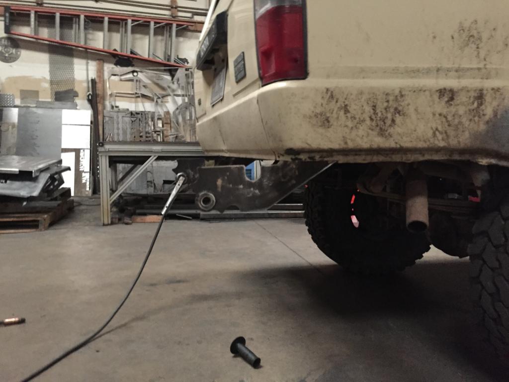

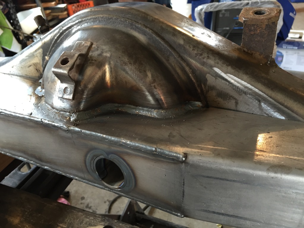

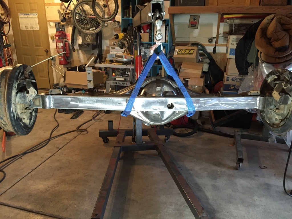

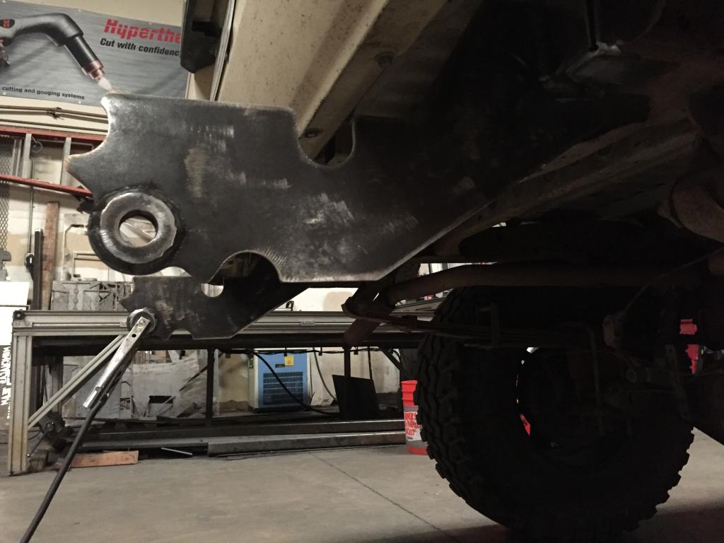

Started work on my wider IFS rear axle today, got it cleaned up and welded up the rear truss. Need to make some shock tabs and a new crossmember to mount the shock rather than the stock locations.
