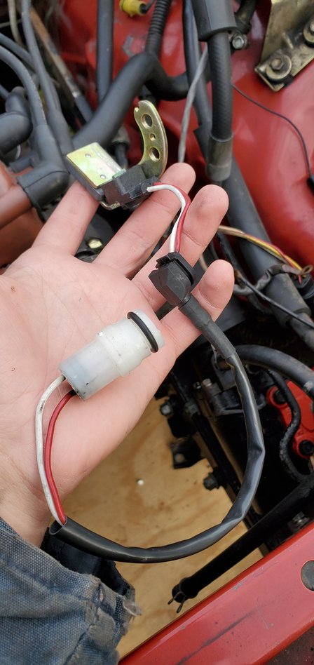

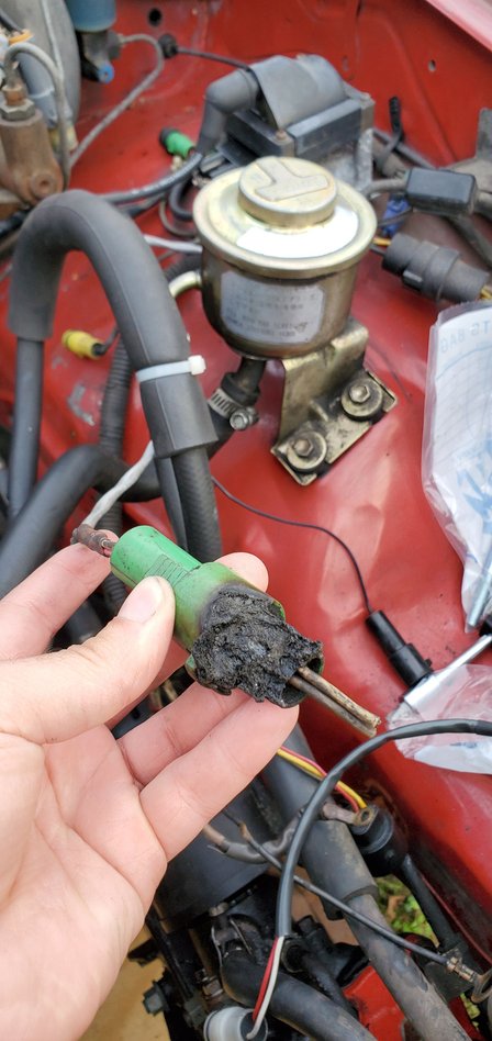

I have a problem finding out how to fix the wire/plug that comes from the ignition coil to the distributor. The green connector (male end) has melted on the exhaust manifold, I have bought a new ignition pickup connector (female end) that goes inside the distributor but don't know how to connect it to the melted male end of the ignition coil. I tried looking online for a new male end of the wire but can't find any. If there is a simple solution or a part I can buy without having to buy a whole new ignition coil assembly that would be great.
This is what I need replaced
This is the new pickup I bought

Look for a thread by atcfixer he details how to find the part numbers on these connector housings in a few places IIRC.
Once you are armed with the prefix you can reach out to the forum and get someone to snag the second half of the part number off thier good connector..
In a pinch you can just swap out the pickup coils plug with a random two wire weatherpak connector from AMP (which is who designed the 2nd gen 4runner connectors), but alot of these connectors are still available from Toyota aspig tails once you know the full part number.
