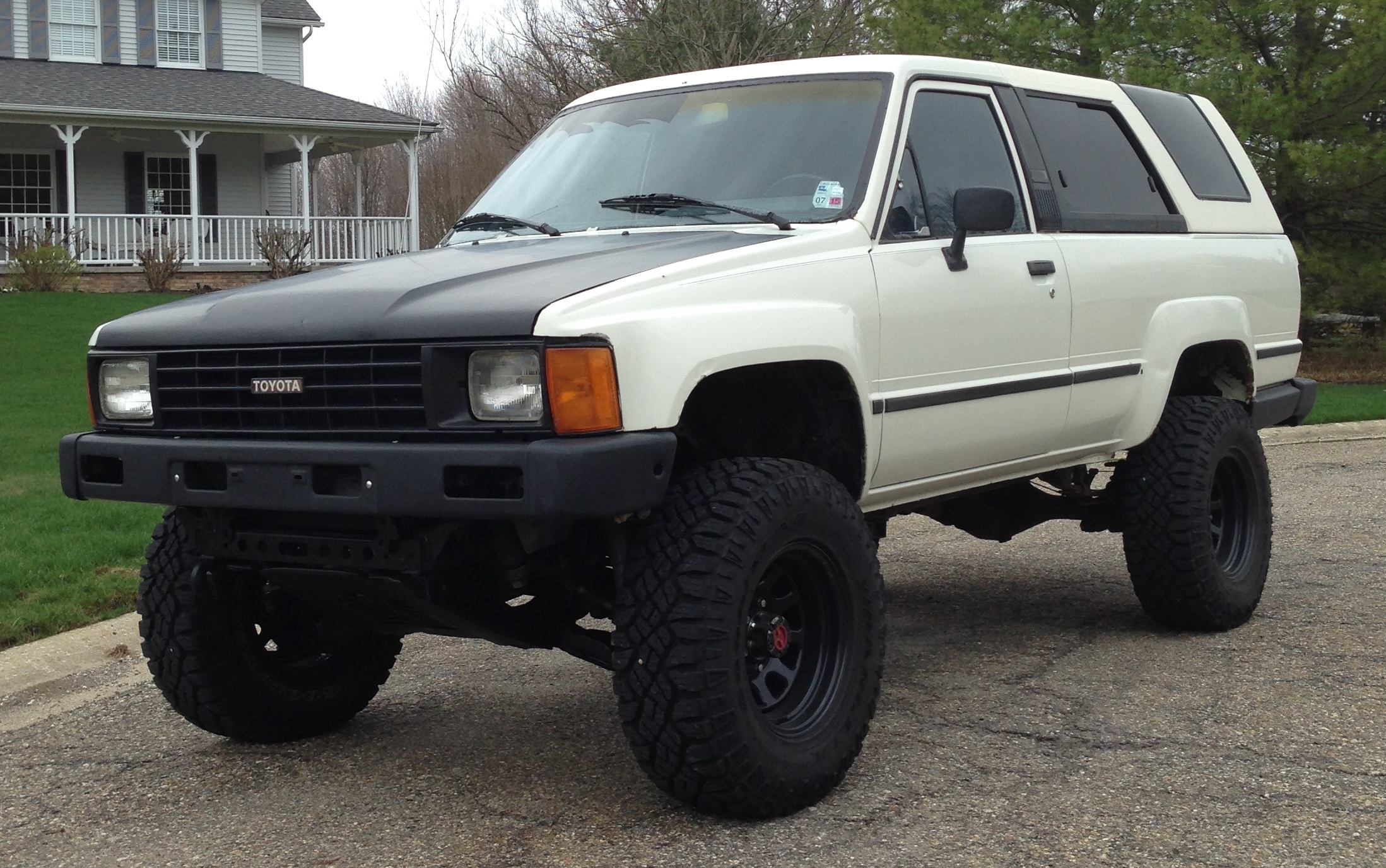

Picked this up not too long ago and has been a solid project thus far. I too did some sound proofing. hopefully mine will look that good sometime in the future
Here's a link to my build thread if you are interested: http://www.toyota-4runner.org/classi...-el-chapo.html

I just finished going through your thread when I saw this post. You have a nice 85 ext cab as well! Keep it up!
