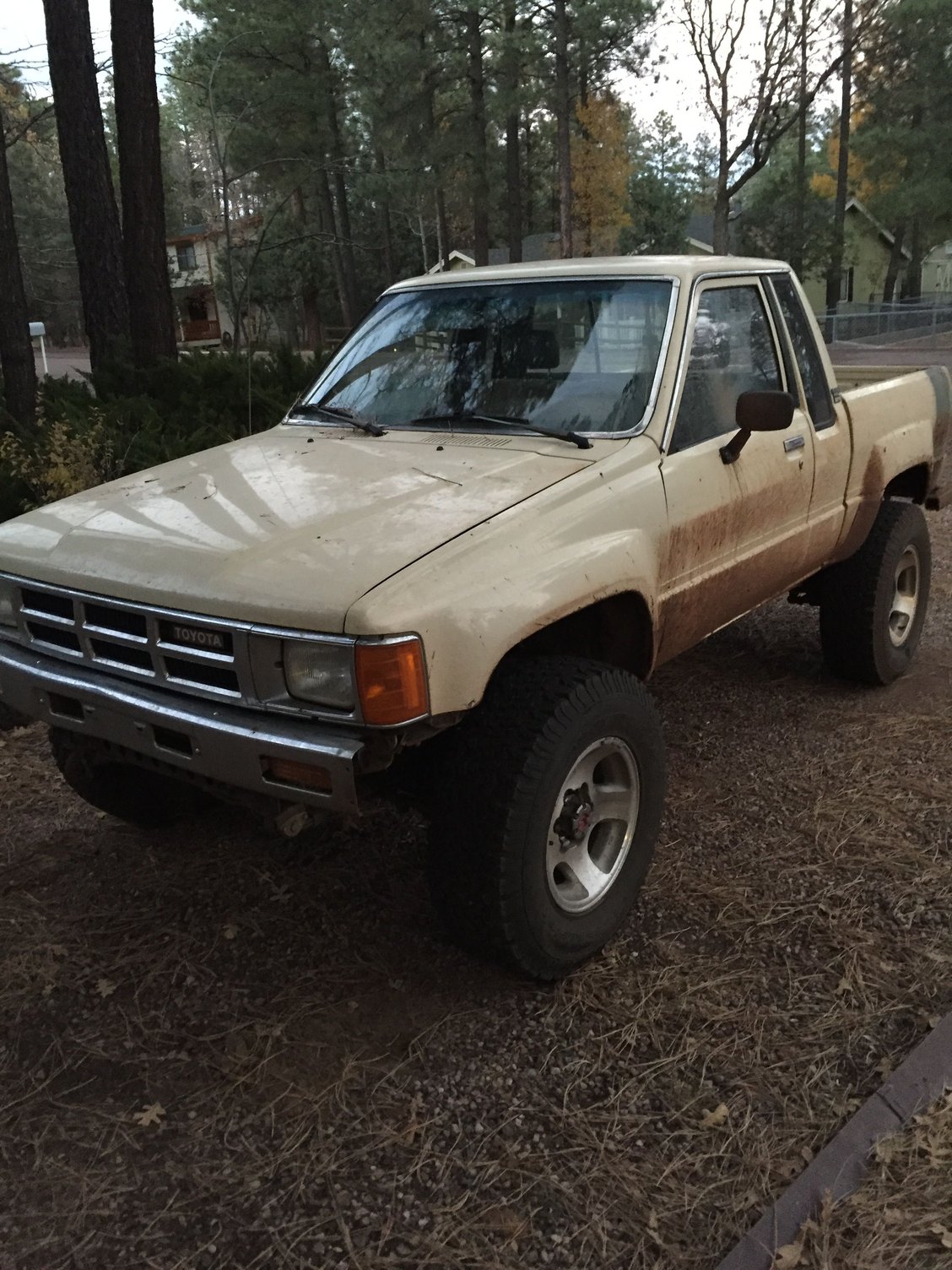

86 ext cab and bed on 85
single cab frame

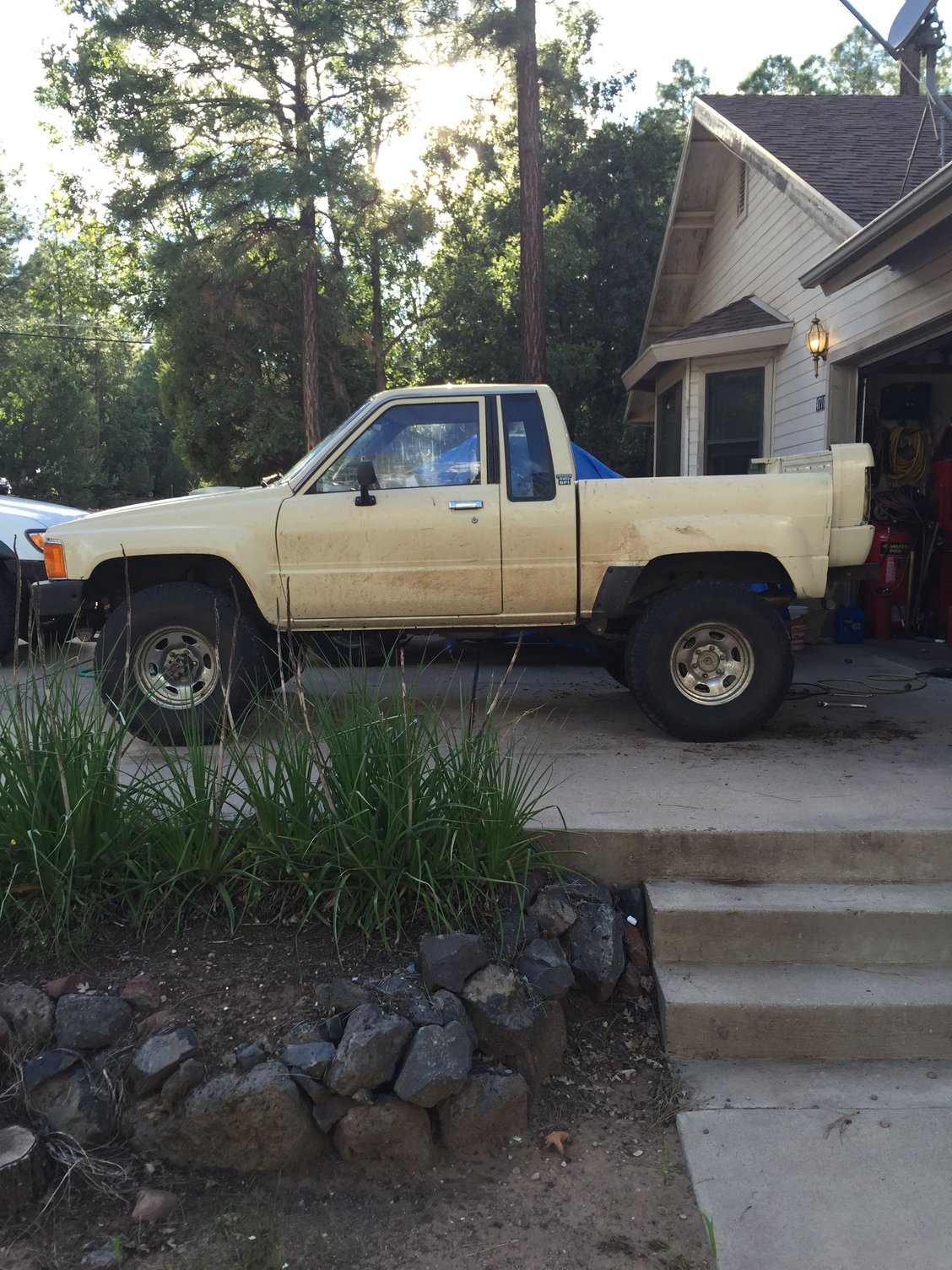

New fj80 16x8s, had to get wheels spacers to fit and swapped the rear axle to the wider ifs one to match the front.
Looks kind of goofy with 265/75s i know, oh well.

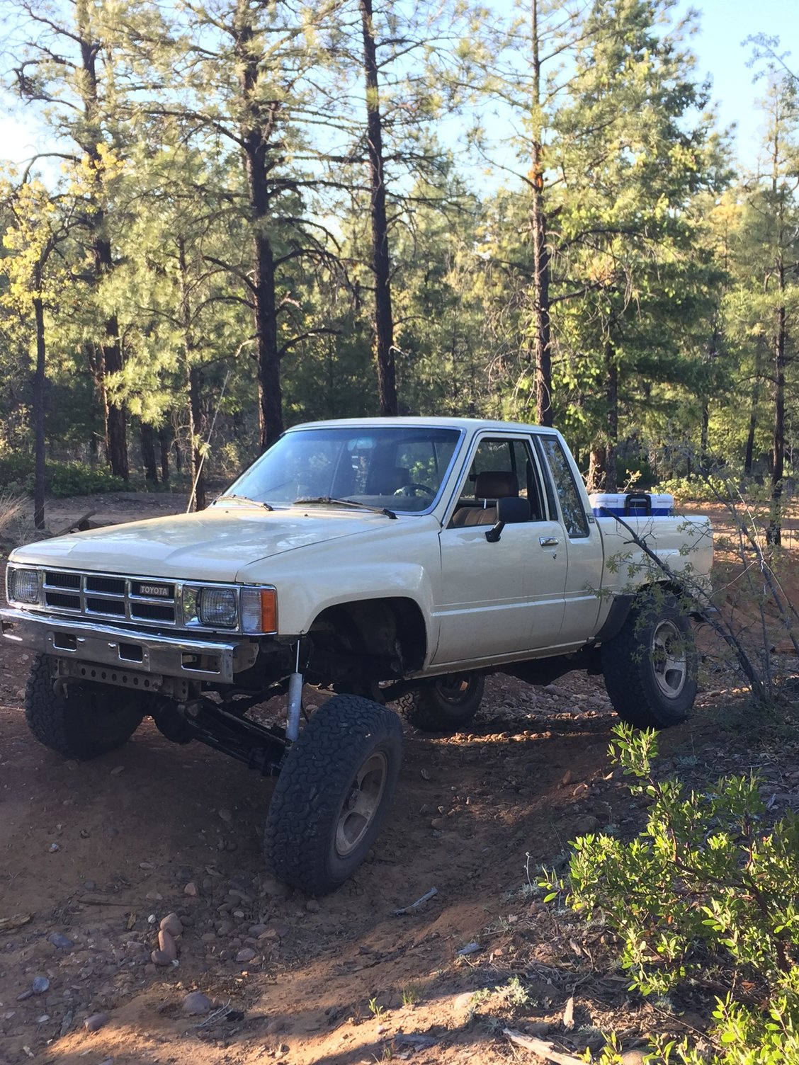

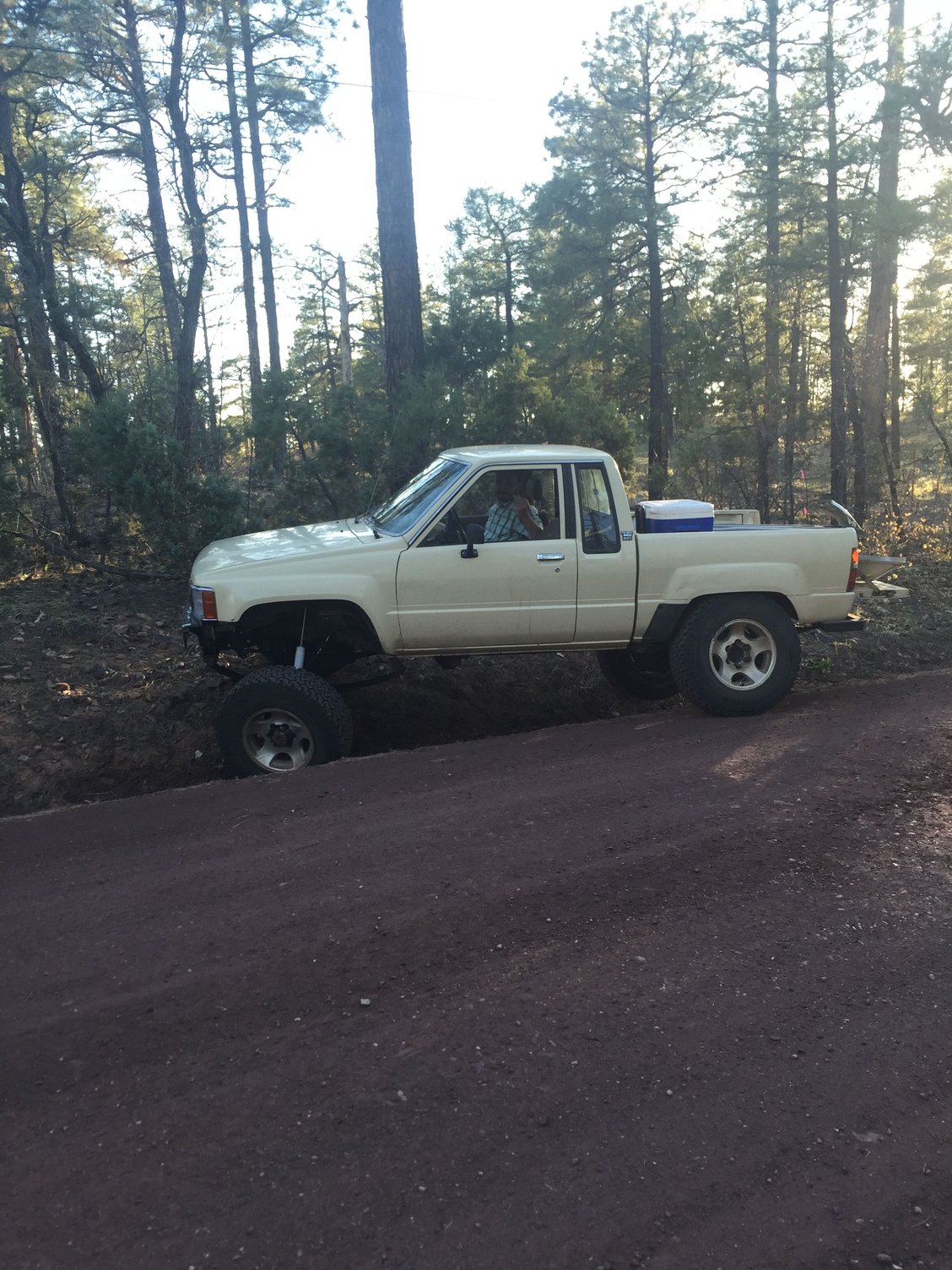

Snapped some pics at a local trail. Ordered stuff for hy steer and RUF conversion.

New wheels look good on there, I really like the looks of the stubby bed! How much did you have to cut out to make it fit? RUF springs and high steer are going to make a big difference!

Yes it definetaly will, i cut 9 out of the front if the bed and 12 out back. Stock springs and shocks are just not cutting it.

Update: ordered u bolt flip kit, bushings, axle truss, shocks, brakelines, banana shackles, and the ifs steering box mount. Should be doing rears up front next weekend.

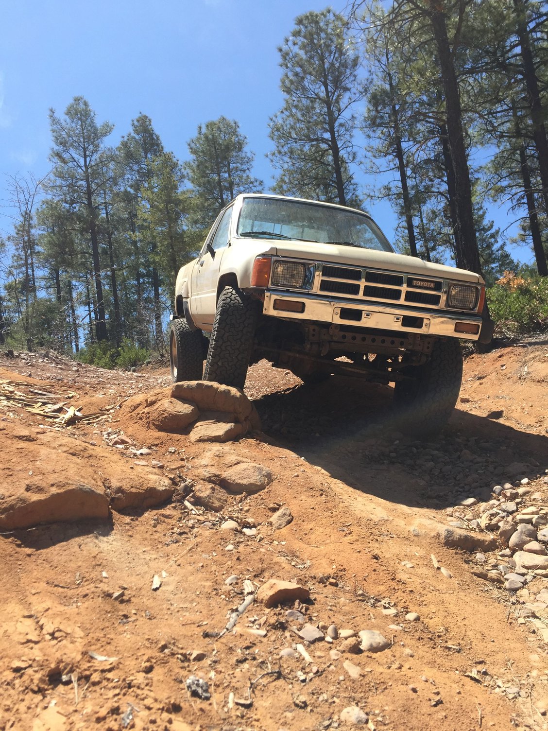

Installed hi steer and 5 pack ruf with stock spring hanger and skys banana shackles. Flex is better than i thought.

How does the Hi Steer handle? Much better??

oh yea for sure night and day difference, i can turn the wheel with my finger on the pavement.

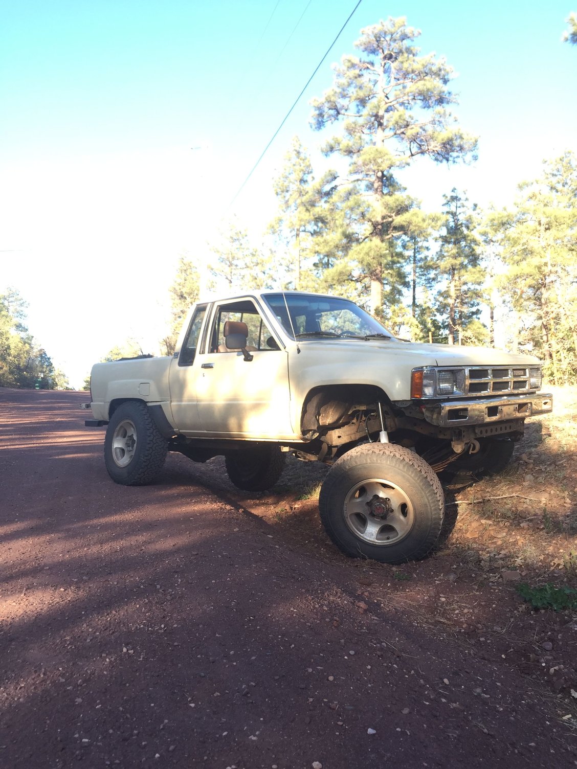

Another photo from local trail.
