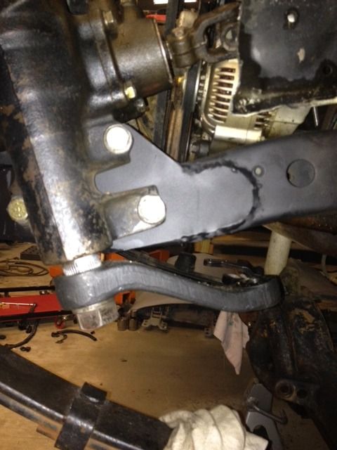

From ur pics it looks like you might be able to tilt the back(shaft side) of your steering box upward...u want the arm close to the frame WITHOUT hitting or binding on it which gives you the most clearance with leafs before they strike the pitman arm. happy balance of both

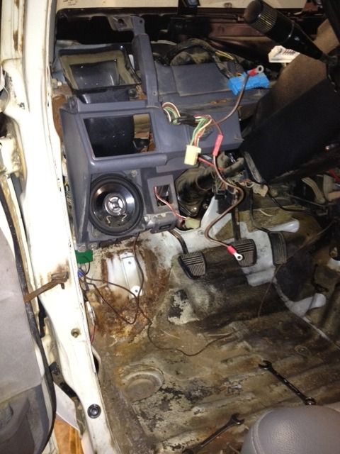

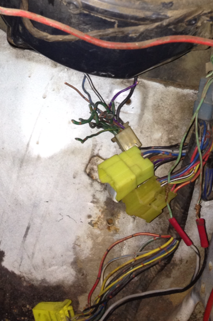

Well after a night of chasing wires and the PO's previous problems, I ended up taking every wire out of the truck! Talk about agravating having try and fix what someone else has butchered! Here is a couple of pics of the wires and what I started with
A little eye candy
At this point I have the complete harness and just about everything wiring related off the parts truck and in the 85. Everything works so far except the dang fuel gauge. Still trying to work out that problem. Any advice on chasing that problem would be nice. If I remember corectly the sending unit works off a ground. So if I ground out the wires it should tach the gauge out to let me know if the gauge is functioning corectly. Correct me if I'm wrong please. I'll get some more updated pics of the truck as a whole soon.

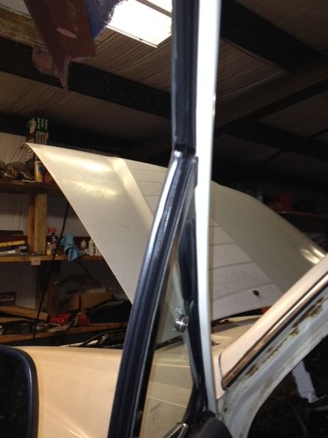

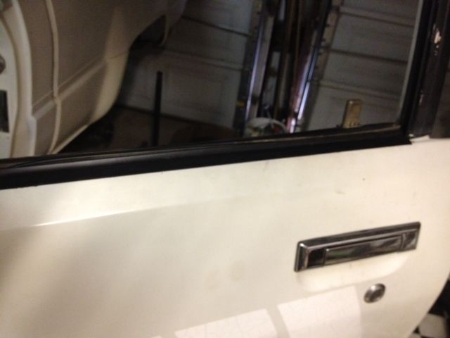

New window rubber seal.
New outside window weather striping.

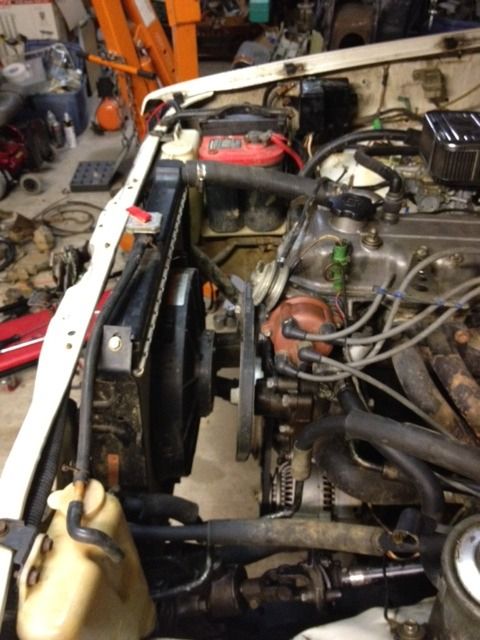

Radiator and harness in.
Steering box finished.(for some reason it looks like the box moved from the angle I had to begin with but no looking back now.)
The pile of wires that came out, and there was still more wires on the other side
