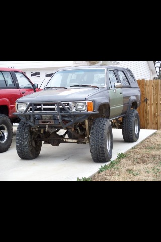

I will put a few pics of her on here before i started the build, she has many dents, one of which i did, most of them i didnt do. Previous owner was rough with this rig.
I have a decent photo or two of what she looked like before i tore her down.

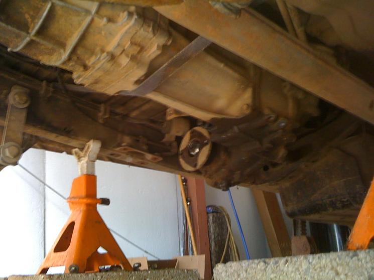

Well i have the tcase unbolted and is ready to pull. Now i have to try to do this by myself or use a friend to help. I dont have access to a tranny jack, all i have is a floor jack so i'm thinking of using some afro engineering here and put a block up on it and a pice of plywood and use it to slide the tcase on to and lower it down. I jerry rigged a strap to support my tranny when i took my crossmember off. I have a trail gear skid plate that is replacing the old one. *Note to others doing this!! SUPPORT TRANNY FIRST BEFORE TAKING OFF CROSSMEMBER. I'm sure the motor mounts would have held just didnt like that much weight being put on them.

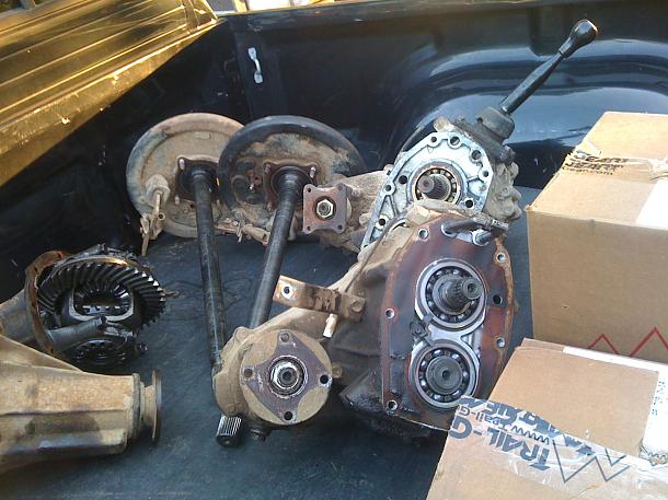

OH MAN!! Loaded up transfer cases, diffs, rear axle shafts and all my parts and taking it to a shop and have them all installed and diffs built. It might take a few days or maybe a week or so to get it back....but its well worth the wait.

Shop called yesterday and the 4.7 tcase is done with twin stick. Front and rear diffs are fixed up with a Yukon Grizzly locker, a detroit wasnt availaible so this was cheaper and worked just as well. Hopefully by next week everything should be ready for me to pick up.
