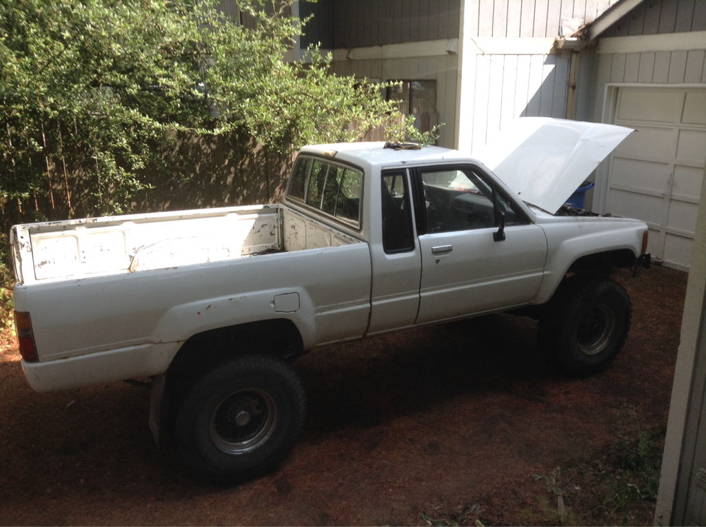

I'm a new member/sometimes lurker and have never done major auto repairs. When i was 19, i made one of the best decisions of my life; faced with the buying-a-vehicle dilemma for the first time, I decided I would stick to one make/model of vehicle for my whole life so I could temper my lack of mechanical ability with accumulated experience. In a rare piece of genius for me at that age, I chose Toyota pickups, and later I narrowed it down to 1985 4wd pickups. If wish I had extended that line of thinking to my career or women, but ya can't win 'em all, anyway, back on topic.
I bought my current truck already built about 5 years back for $2100, yes you may be jealous now but also disappointed that I didn't build it myself.

Welcome to YotaTech, That is a nice looking xcab, I'm definitely jealous, been wanting one for years! Look forward to seeing your rebuild and pics, there's a lot of good guys on here that are knowledgeable and willing to help, again look forward to seeing your progress!

Great looking truck you have. The 84-85 doesnt get as much attention as the 86-95 does. Most everything that apply to the 86-95 will apply to yours. Getting involved in threads that are going in the direction that you are wanting to go will be the greatest source of information. You dont have to be a pro. By being involved, you will be a pro in no time. Lots of great people on here want to see your project turn out as well even as their own. That is what makes this site so great.

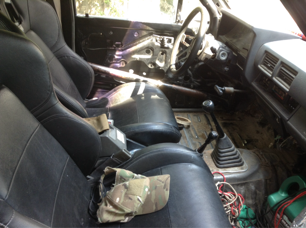

Redbayredneck, I looked all over for the brand on the seats but no luck. If you want, I'll take a bunch of pics and post them so you can at least find em. Just ask.
So, a little more back story first. I bought the truck from an out of work union welder. He had installed the interior roll cage and his friends had helped him do the build. Honestly, I think it was a good but not just right build but what do I know.
Here's a list of the build as best I can remember from what the previous owner said, theres probably more to it that I'm currently ignorant about:
-5,000 miles on the new top end at the time i got it
-stripped interior, racing seats, racing wheel, interior roll cage
-rv camshaft
-regeared, i cant remember exactly but I think the new gearing is 1.87 from 2.37?
-new header and 2.5" exhaust.
-33" tires, they were mud tires, i've since replaced with a 33" mountain tire. Both 10.5" wide.
-new driveshaft
-4" lift
-replaced timing chain and metal chain guides
