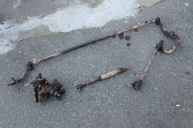

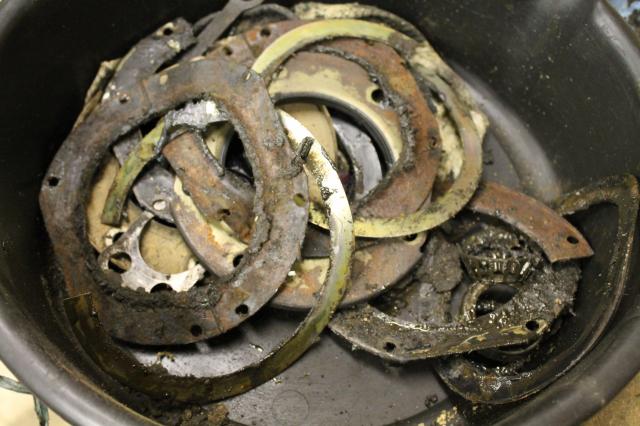

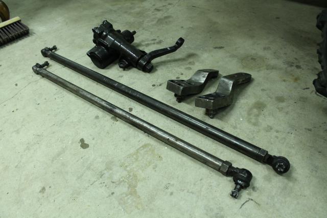

Alright so to be honest the 4runner has been sitting in my yard with the front axle taken apart waiting for Hi-Steer...
Finally picked up a hi-steer kit, ifs box and knuckle rebuild kit and got to work!!
OUT WITH THE OLD AND IN WITH THE NEW!!
30 year old steering & seals lol... That's some original toyota right there lol

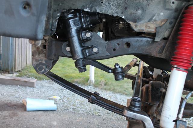

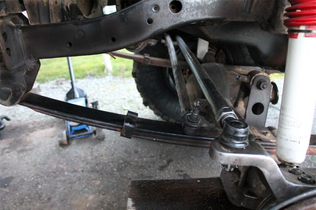

Hi-steer installed, old box removed with the plate, next up installing the ifs steering box and get an alignment!
Anything I need to know about mounting the IFS box and bolting up the steering!?

Yeah buddy, it was much needed! That's the only thing I have to do now is mount the IFS box.. Getting a bracket today to make things easier from TrailGear..
http://www.trail-gear.ca/steering/pi...ing-box-mount/
Will post pictures later!

Here are some pictures with the ifs box mounted and the first time I have wheeled the truck in 6 months! The hi-steer worked wonders, WAY less bump steer on rocks etc..

I just looked at where other guys had mounted there's and wen't from there. Pretty much want to put it as far foward and high as possible..
