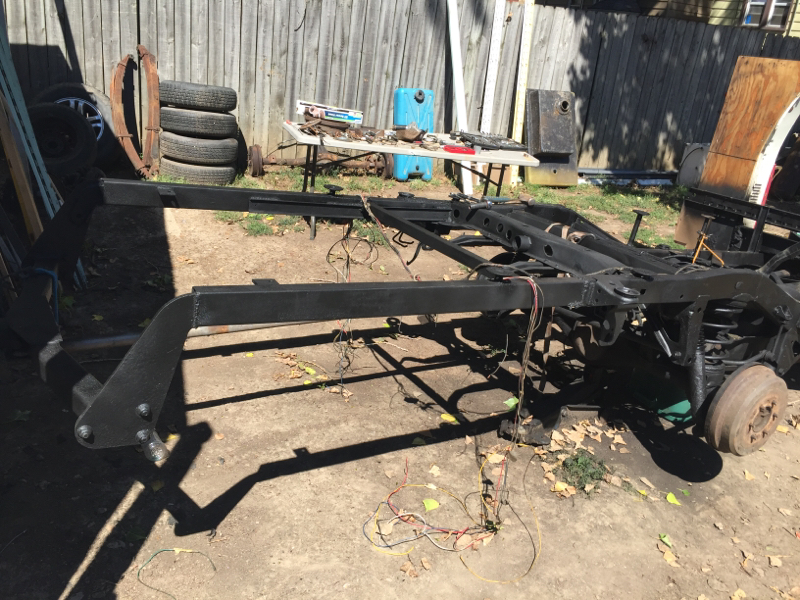

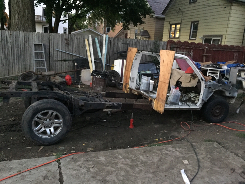

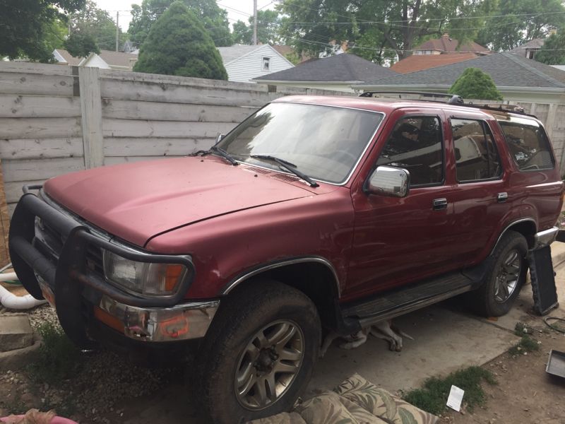

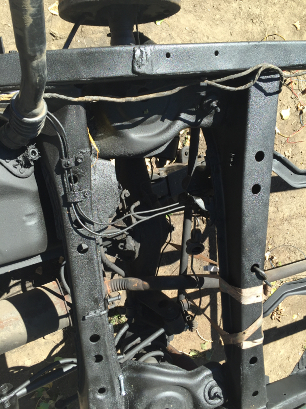

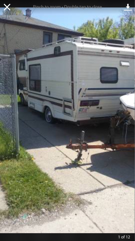

So here's what happened, I got a motor home with the recalled death dually's , and just couldn't live with the poor set up knowing the wheels could fly off and crush my lp tank blowing me to bits while only going 55 mph not the death I have in mind , I had a 4 runner I just bought for a part out and turns out there are quite a few similarities such as frame size axle comparability to the old drive shaft and with a little ' ton ' of modding I'll be on my way Rollin a 6 lug single tire rear with anti sway and air ride , to be continued .... Tomorrow

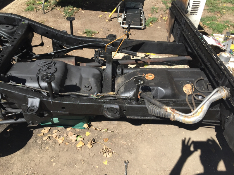

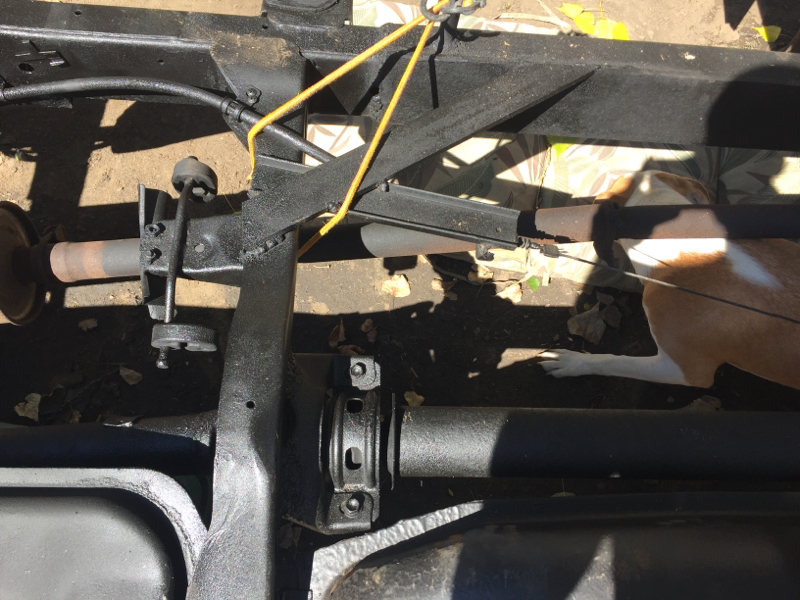

It's been kicking my ass but finally made some visible progress now that the welding and custom works done ,
went through 12 lbs of welding wire , but she's solid , posts are welded in and level for the rv floor , 2nd gas tank is in, I'll run a splitter to the generator and my primary tank and will be able to refuel while driving or fill the Jenny without even pulling over , so pretty excited about that ....
fabbed up e brake brackets and cables , new brake lines, cleaned out a lb of rust from the 85 pickup tank and painted it with some leakseal ,,,, it will be done soon with in next week or two
