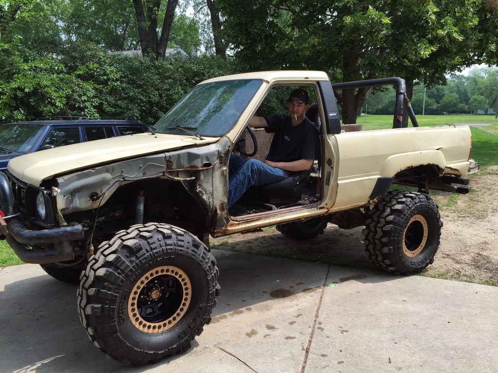

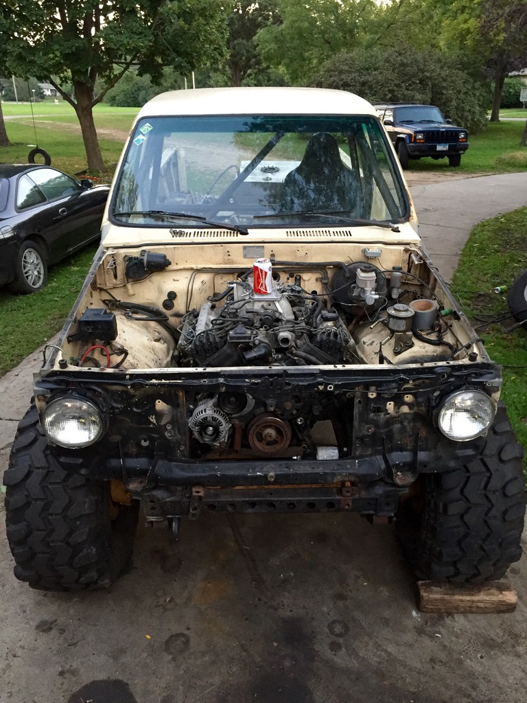

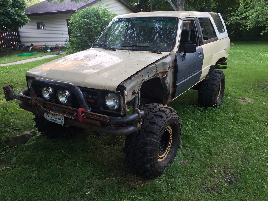

Front fenders were chucked, doors removed, top off, interior stripped for rollcage and no motor, it sits on 35x15.5 swamper SX on 32 bolt beadlock rims waiting for build time!

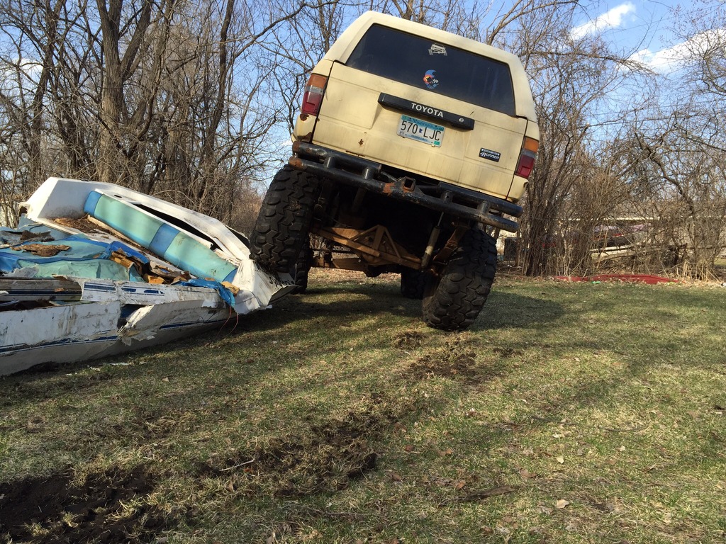

The rear tire came loose at 65 mph! -junk aluminum rims

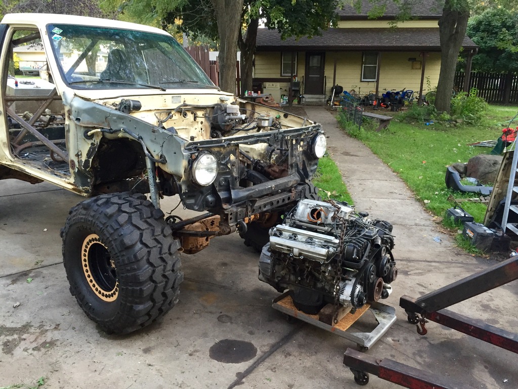

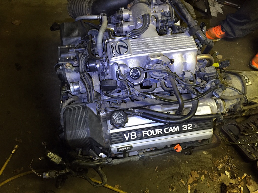

Got the motor testfit!

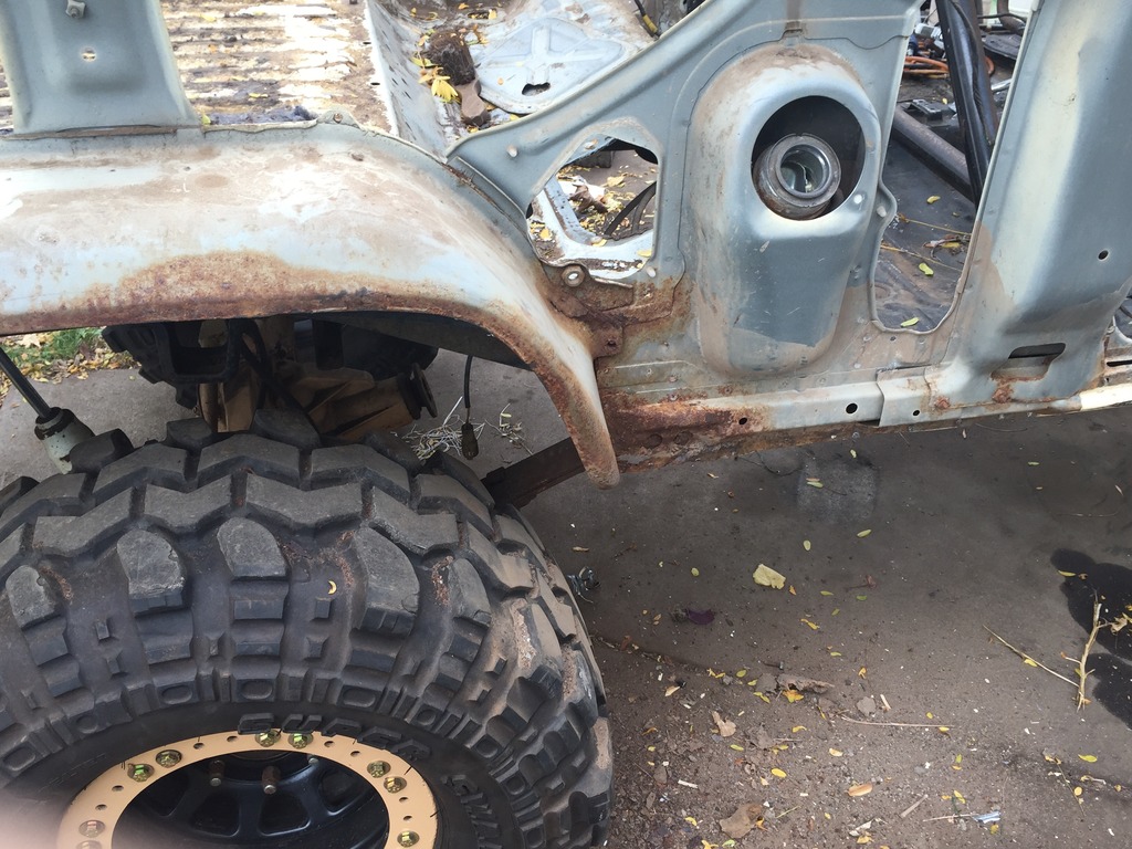

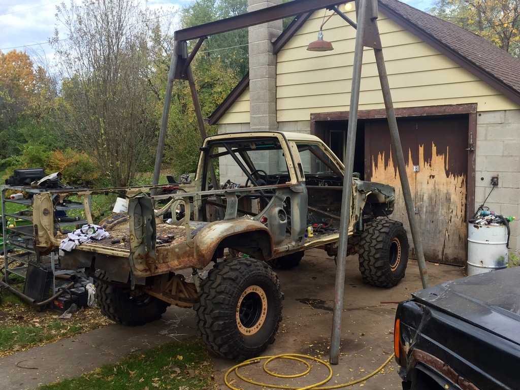

A frame up!
Passengerside rear off!
Second airtank connected for blasting!
More tonight!

3m 08115 panel bonder for the quarters, door skins and tailgate skin!
Going to be blasting the rest today, then start replacing metal tomorrow!
Needs body mounts so after most of the body is repaired, body is coming off for a full enderbody blast and a coat of Por 15!
Bottom 10" of all body will be with Por 15. Sure its going to weigh a bit more but... This truck will live a long time!

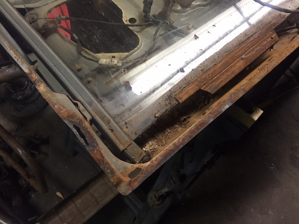

Before:
After:

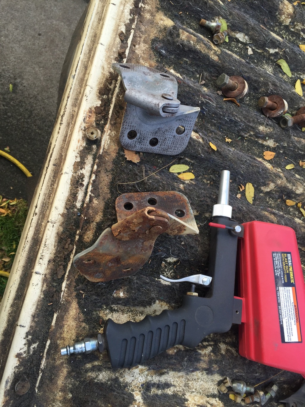

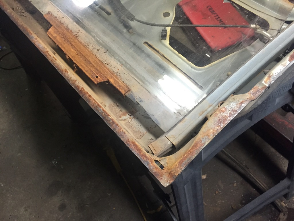

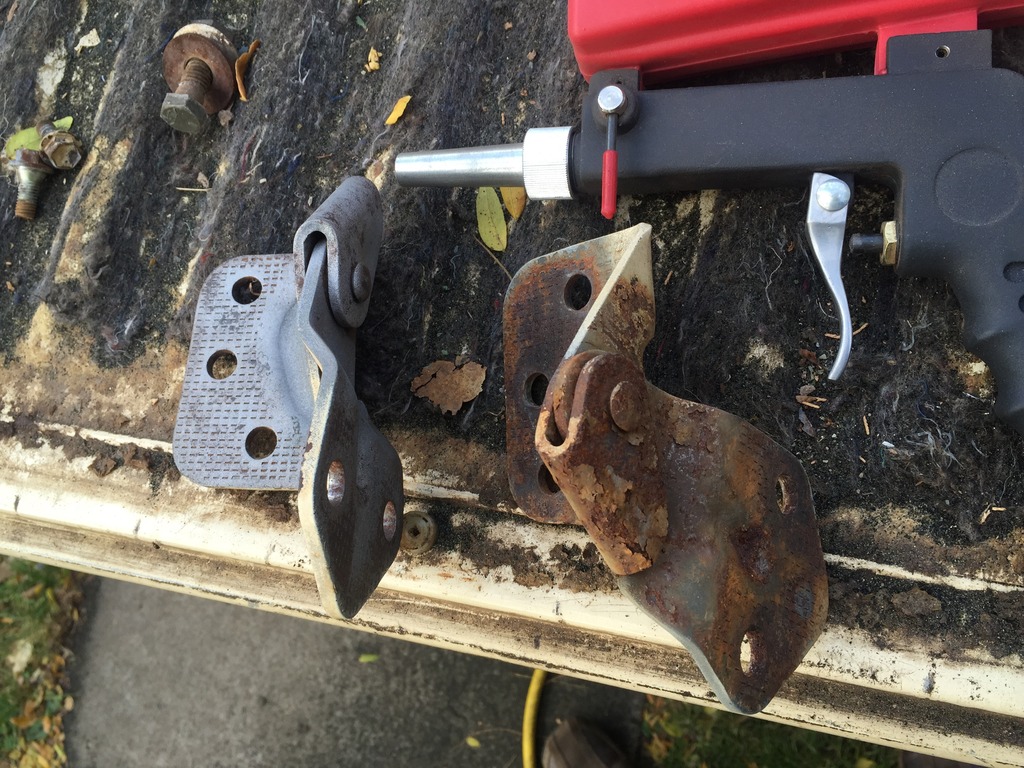

Tailgate hinges:

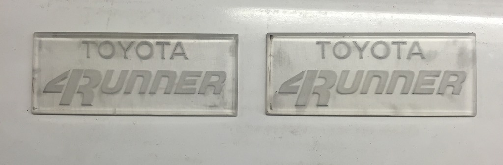

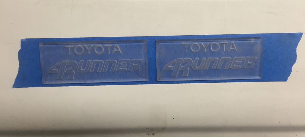

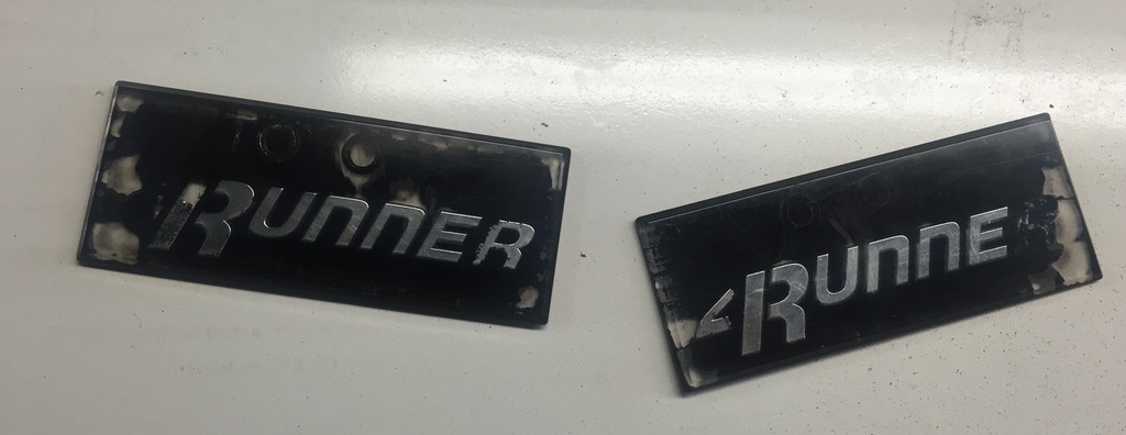

Side badges are hard to read...

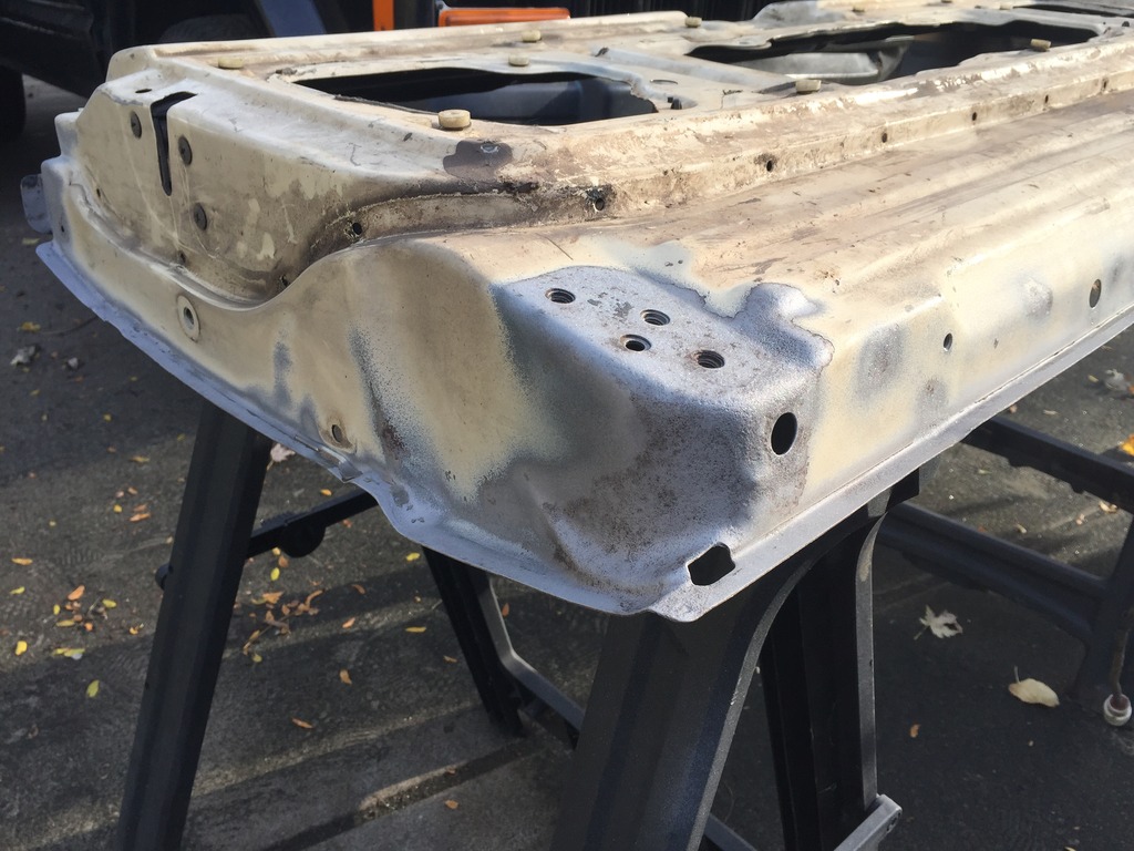

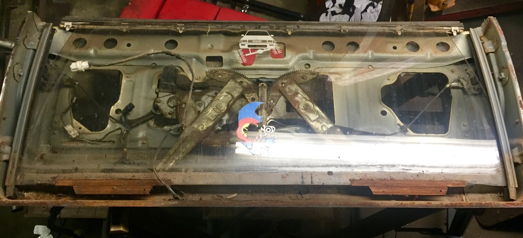

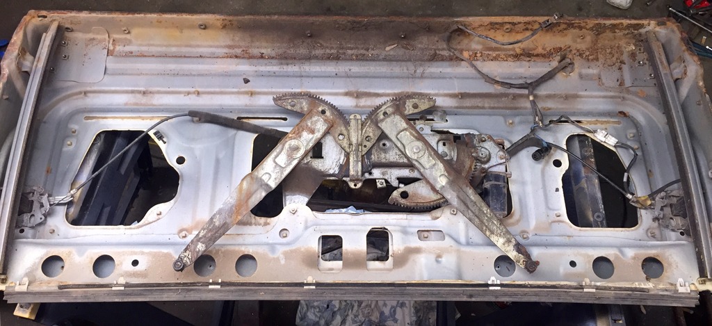

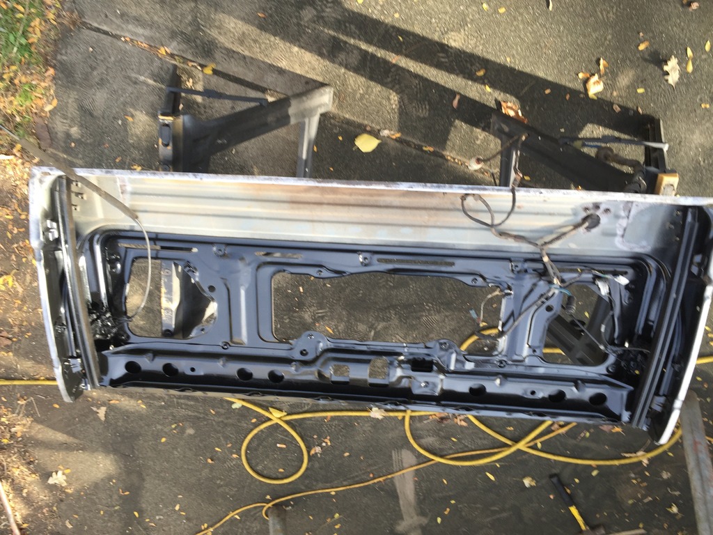

Tailgate
Tailgate time!
Heres a preteardown shot.
Grind the edges till they pop! Bam!
Little rusty inside... Not Por long! Hah!

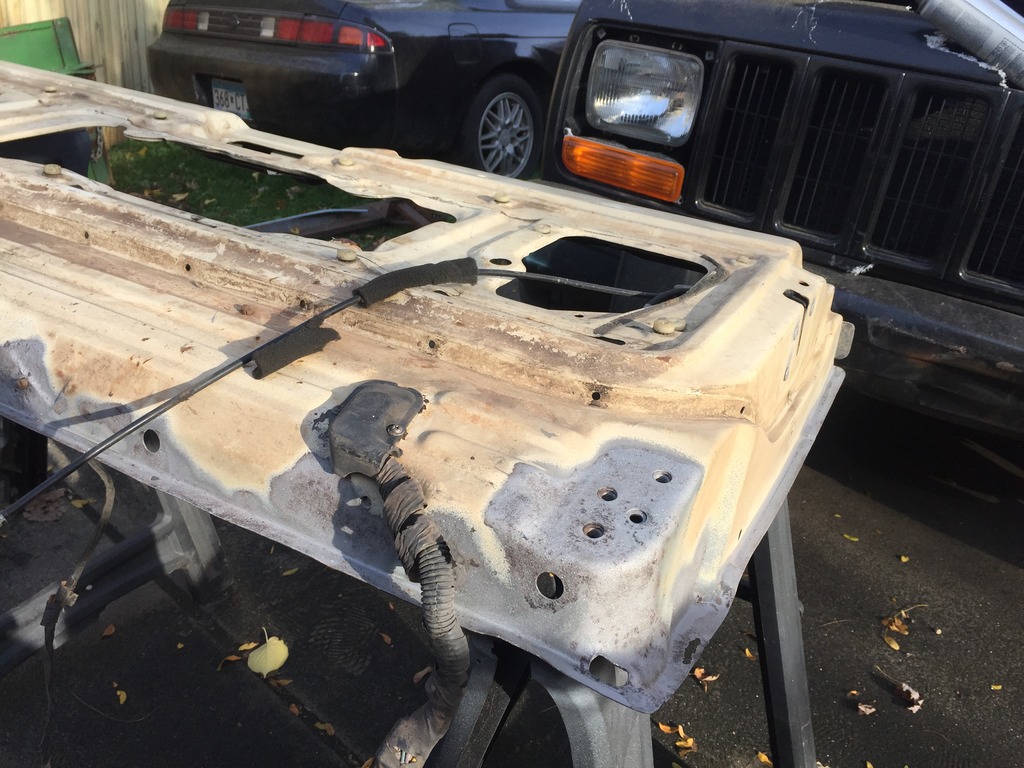

Heres a couple of my night time project that went into today...

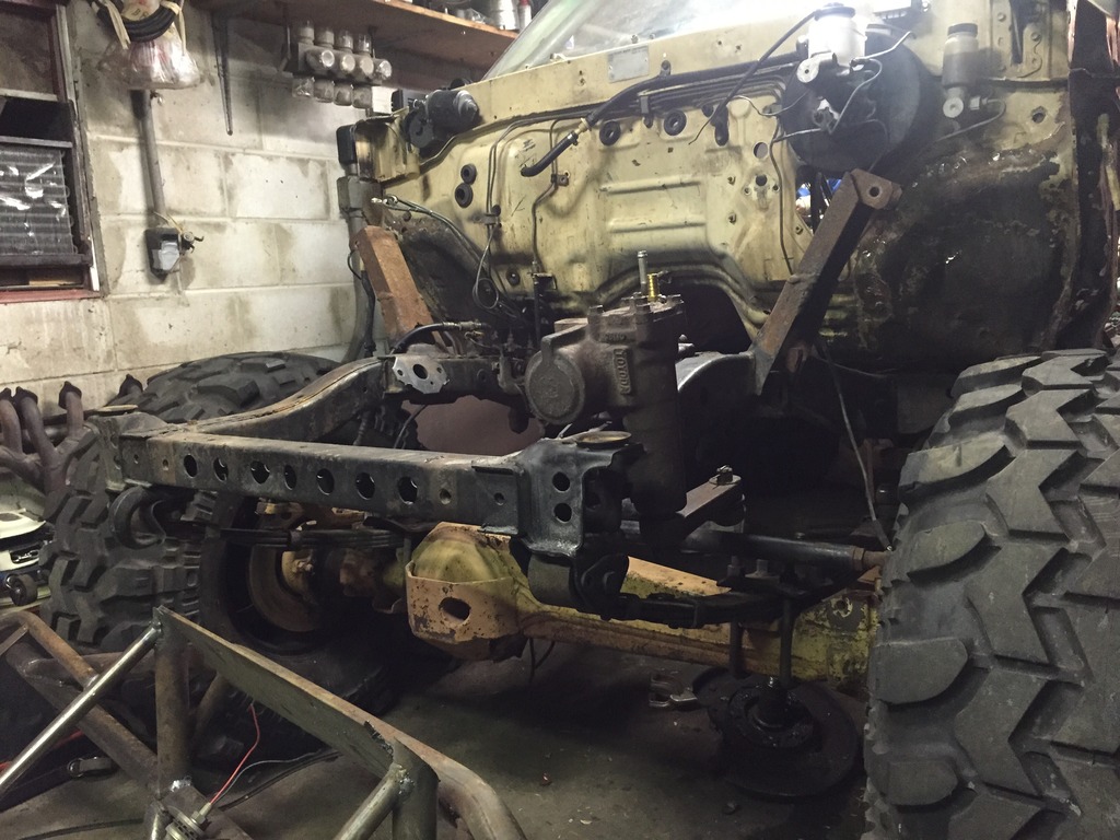

I keep looking at it thinking its way too high, even with the V8 in it. After the testfit with the new body, I want to lower the truck 4" while keeping a flat bottom center. Thats not going to be easy and I will have to build a custom oilpan but I believe it will be will well worth it!!
While all this is going on I am also planning to use a set of rubicon express front Longarms and either airshocks or coilovers. I really liked what they did for my old XJRubicon. I'll have to take some measurements and see if I can make it work before I pull the trigger on that one though.
Off to the store for supplies!

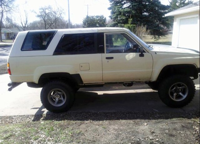

Found a pic of the day I bought it!

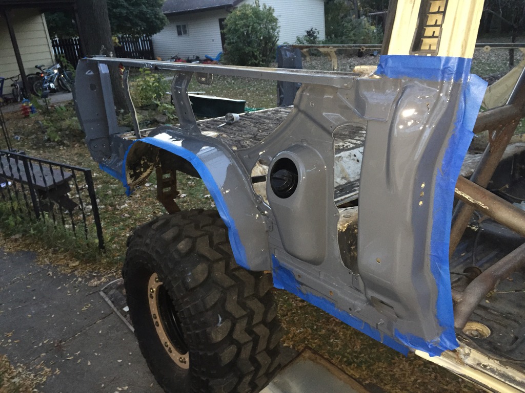

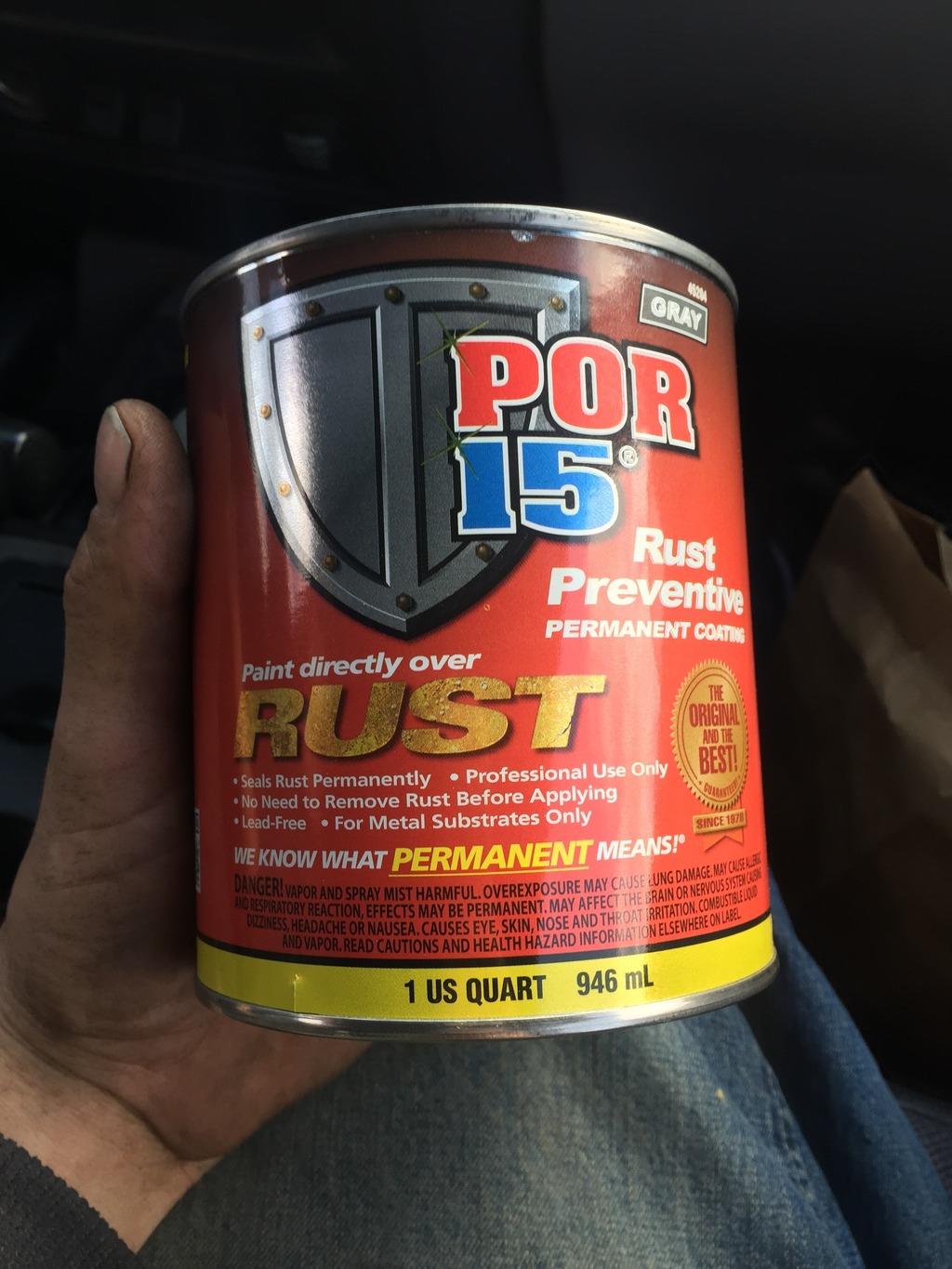

Picked up a quart and a pint of:

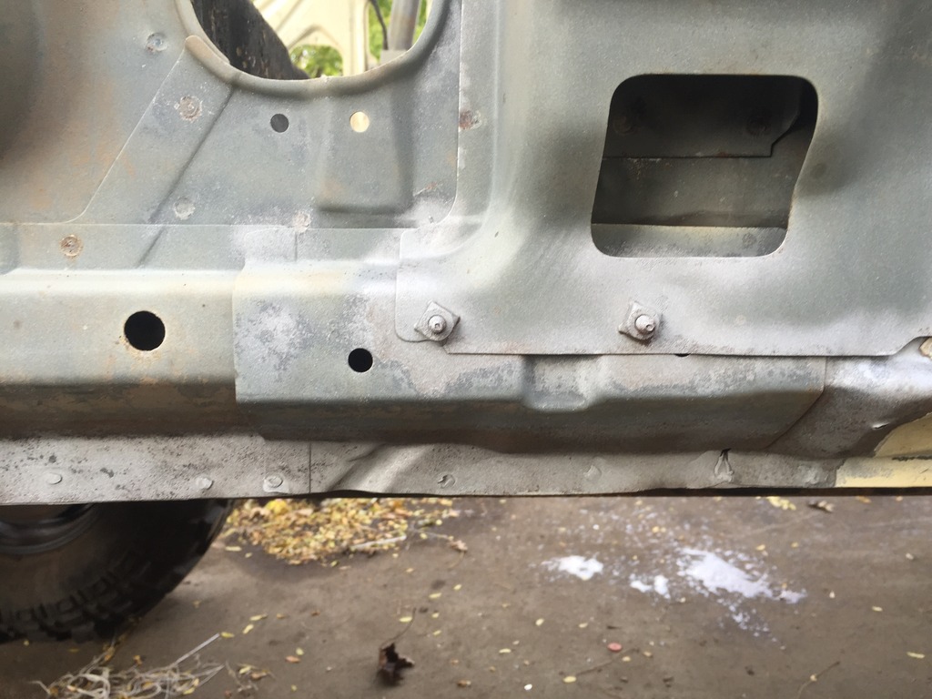

2 coats in the doors!

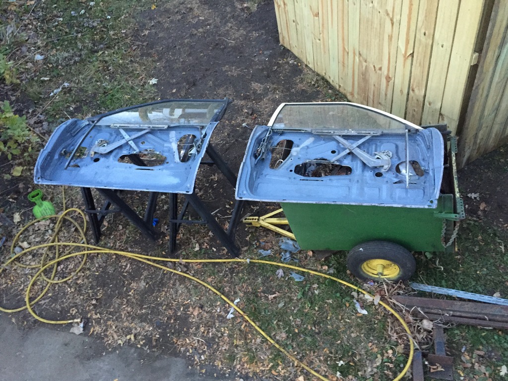

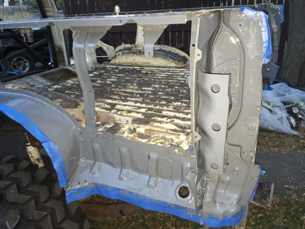

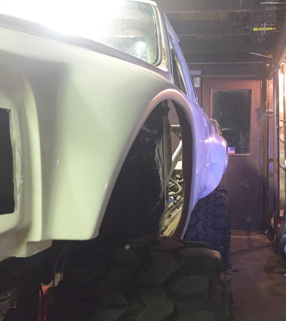

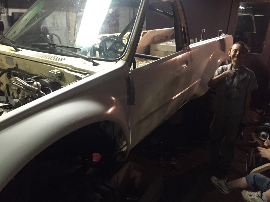

Quarters:

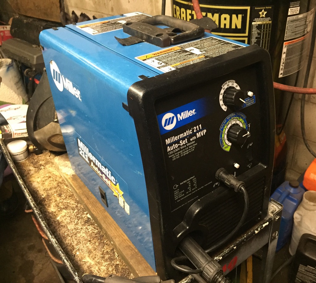

Had to retire the old junk wire feed. Picked up a Millermatic 211!
Now we can start getting serious!
Didn't get the quarter panels on like I planned but I am a lot closer. Got a lot of the puzzle pieces in place this week. Getting the new welder was one of the huge things holding up the Body and Cage work.

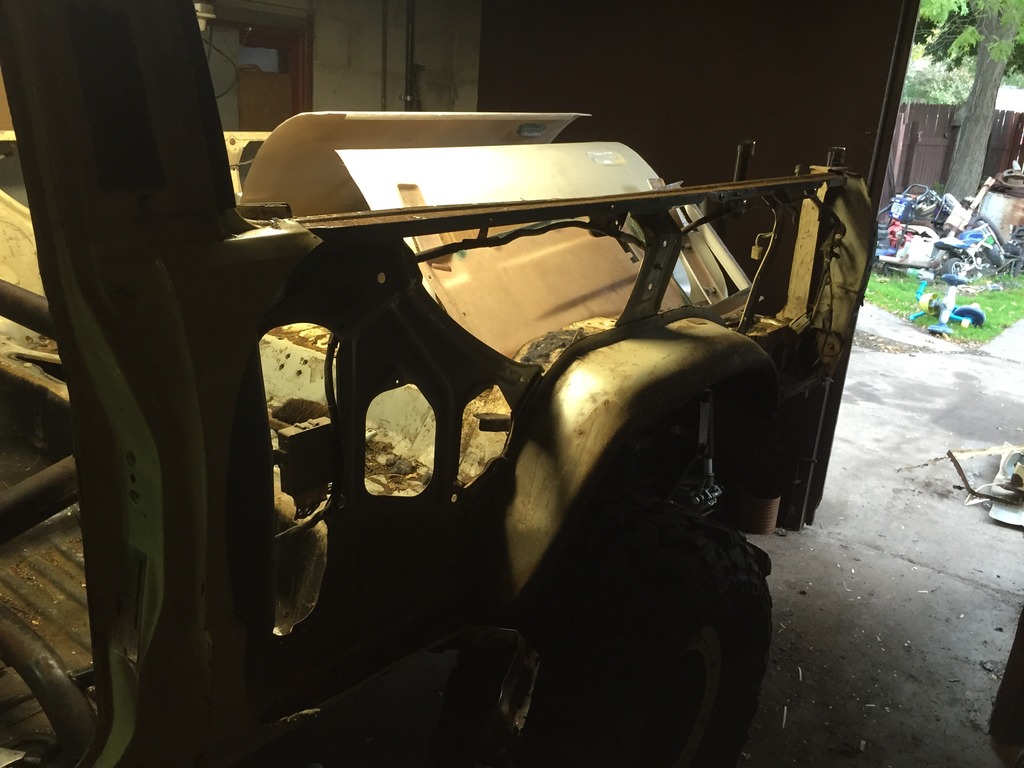

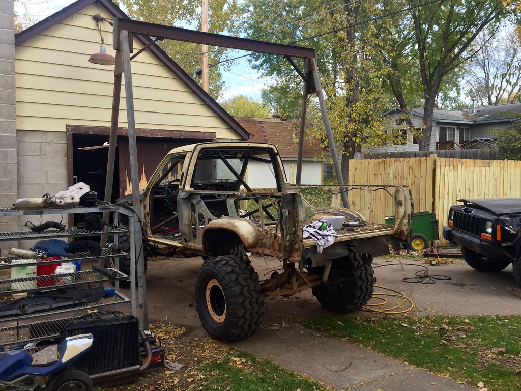

Old Nov 7, 2015 | 06:54 PM
1uzRunner's Avatar
Joined: Jul 2015
Posts: 48

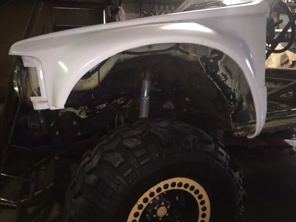

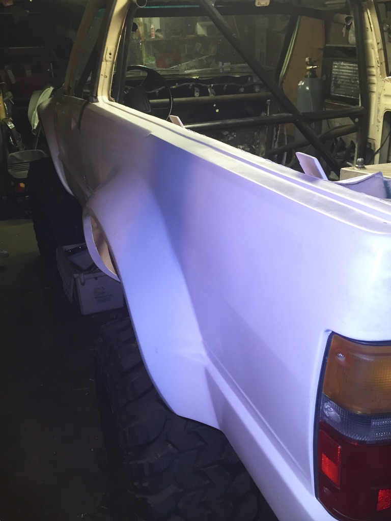

Been busy with work and been sick but got something done...
