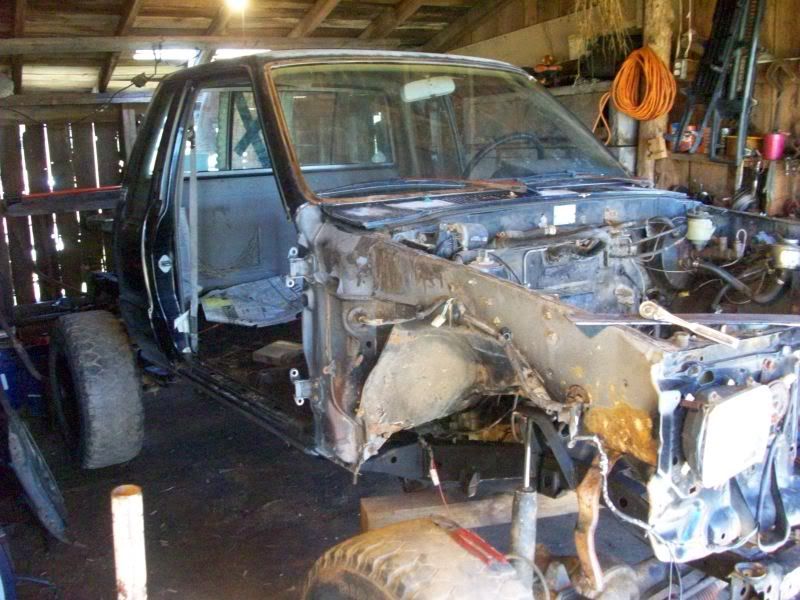

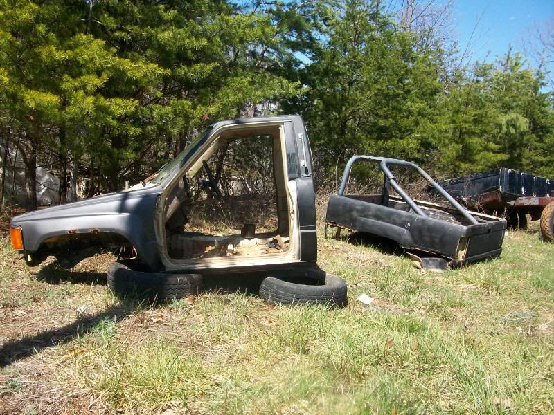

alright, we are making really good progress, not so much this weekend, more drinking than working. but since last sunday we have the motor on engine stand, old cab and body off, frame completely cleaned out and sealed off, cab ready to come off other truck, and tomorrow evening probably get that off. here are a few pictures of the progress...
Motor on Engine Stand
Cab and Bed off
Working on the Frame

aight, here are the pics with the Xcab on there, there aint no doors hood or fenders so it aint pretty yet, haha, they off for paint, and in this pictures we hadnt got it completely bolted down. We also now have the dash taken out in order to put in a different wire harness off a spare EFI truck my buddy had since the other one had been chopped up in places after further inspection.
im gonna have to change springs i believe to get it lower, its way to tall, it has 32's on it now in the pictures and is taller than my buddies with 36's
