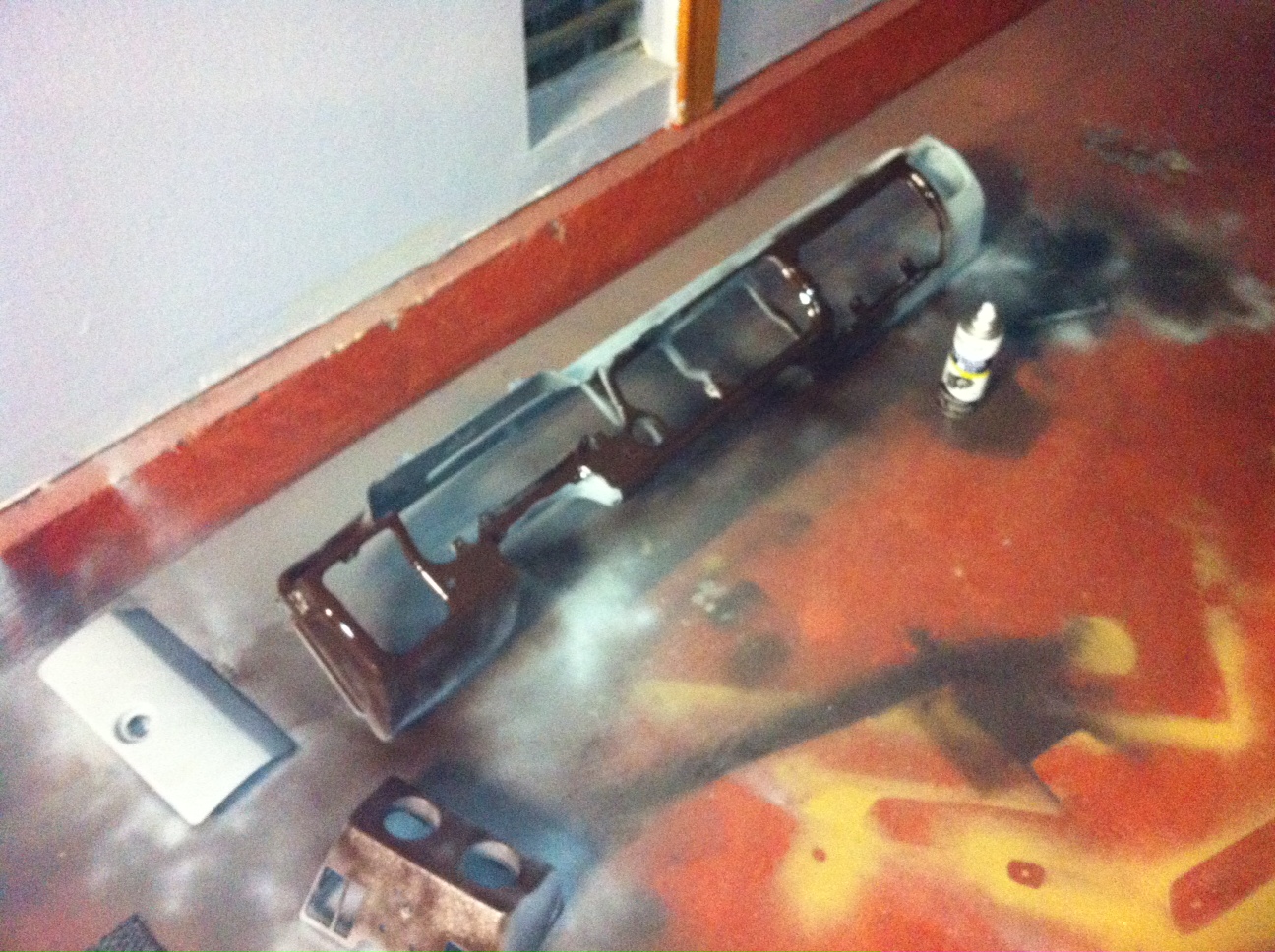

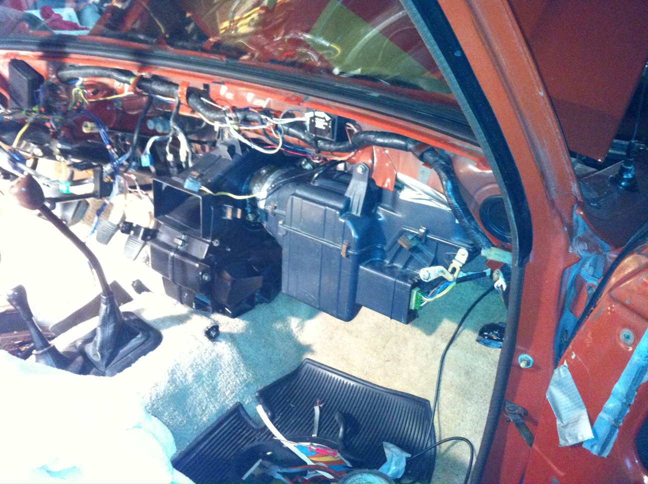

I wanted to give you a little idea of what i did putting factory A/c in...While you have the dash open you might as well do it all. Change the heater core, clean the gauge cluster, clean the de-frost plenums ect. I know you want to get things up and running, but this is the second time I restored" the interior and I wasn't going to compromise this time. It was well worth the hard work, I won't have to do it for another 30 years! Plus I got factory A/c, best of luck -t
PS you do have the FSM?
Good stuff though. I mean, replacing that heater core for sure. That's what was busted in the mid 80's that caused me to beat the dash to make the heat come on. (made sense then)
Your sprayed dash sure looks good. Got a pic with the pad back on it? I'm going to look into all of that.
