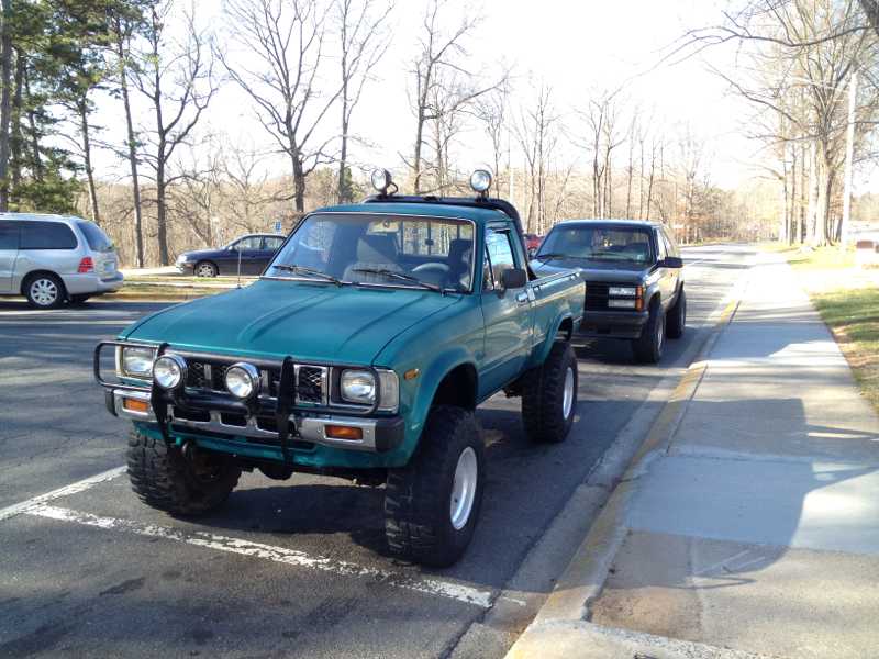

Here's a quick pic from the day I brought her home(along with the gf's 93 blazer):
My friends have dubbed it the teletubbie machine because after I bought it I installed my cb and put my antenna on top of the rollbar......they also call it dipsy....so I guess we'll stick with that lol
It's an 82 SR5 with all the goodies (ps, a/c, etc...)
I bought it as it is in the pic with a 3" rough country lift and 33x12.50s.
I've done some small things in the last few months of owning it....

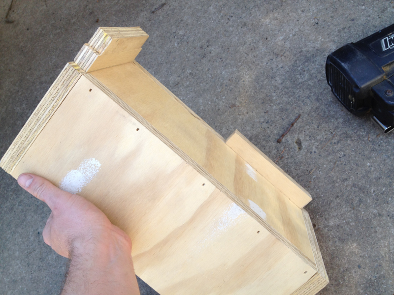

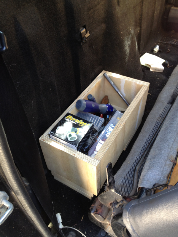

---Installed a radio, CB, floormats, and also made a small tool/parts box that sits behind the seat

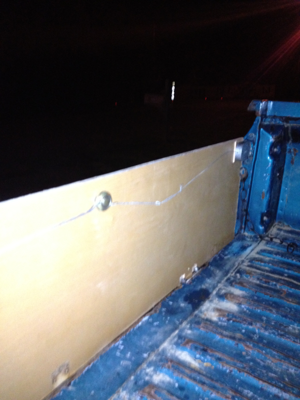

---Made my own locking tailgate out of wood since It didnt have one when I bought it
Some pics of that stuff:

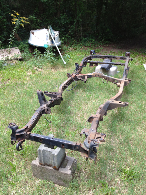

Now that everyone got their pic fix, haha.....I started this build thread because a few days ago i went through some bad road construction and when i got to work i noticed that the bed looked like it was touching the cab. I found a crack on each side of the frame right behind the cab where they all rust. I decided since I daily this truck and I also take it around here and up to uwharrie frequently to trail, that I didn't want to try and sleeve it or plate it or anything. I wanted something that i didnt have to worry about its integrity. So yesterday I went and picked up a solid 82 frame off of CL up in Asheville. It was about a 2 1/2 hour drive for me up into the mountains, (I live just east of Charlotte, NC) but it was worth it. This is the best Toyota frame I've seen in a while, nothing but minor surface rust and straight as an arrow. I'd say how much I payed for it but you wouldnt believe me
my only mistake was using dads dodge 1500 to go get it. It's a 360, and going up the mountain it was averaging less than 10 mpg's.
So I will be undergoing a frame swap starting here in the next few days, so keep an eye out for me. I'm sure i'll have some questions along the way. I'm pretty mechanically inclined and have been working on cars as long as I was old enough to turn a wrench, but I've never done a frame swap.
Don't have any pics of the cracks and rust but I will get some, but I do have a pic of my new frame in its temporary home. Enjoy!

I did some work on the frame today. The guy I bought it from buys all kinds of toyotas and parts them out if they aren't worth saving. He told me he had bought mine in SC and had parted the whole thing and I was the last person to buy what was left of it.
At first i got pops and we stood it on end and took a hammer to it and knocked any loose trash out of it. While i was hammering i didnt find any suprises and its all really solid so that was a major plus. I also sifted through the dirt that i knocked out of the frame and found almost no rust flakes. <<<<Awesome!! I guess the PO didn't have a bed on the truck because they had welded some brackets and put trailer lights on the back. So I got the grinder with a cut off wheel and cut through the welds then knocked them off with a hammer then got a grinding wheel and got everything smooth. Did a bit of sanding on some of the questionable pieces of rust and it was nothing out of the normal small pits.
So now I know the frames all good (thank goodness) I'm ready to get this thing going!
