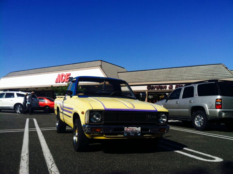

Here's a more recent picture in Nevada where I'm visiting a friend. Rebuilding the engine right now but it's going well.
