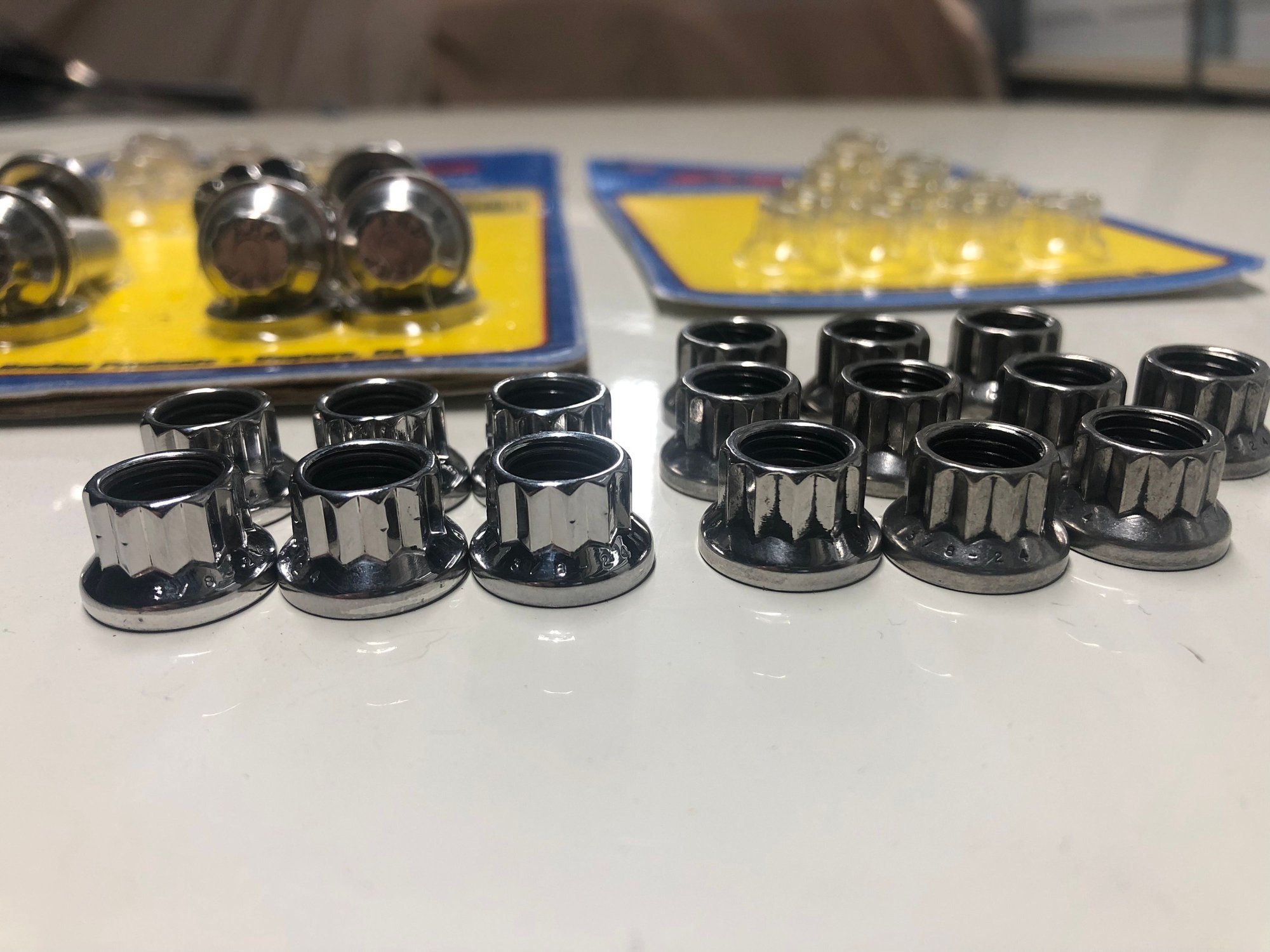

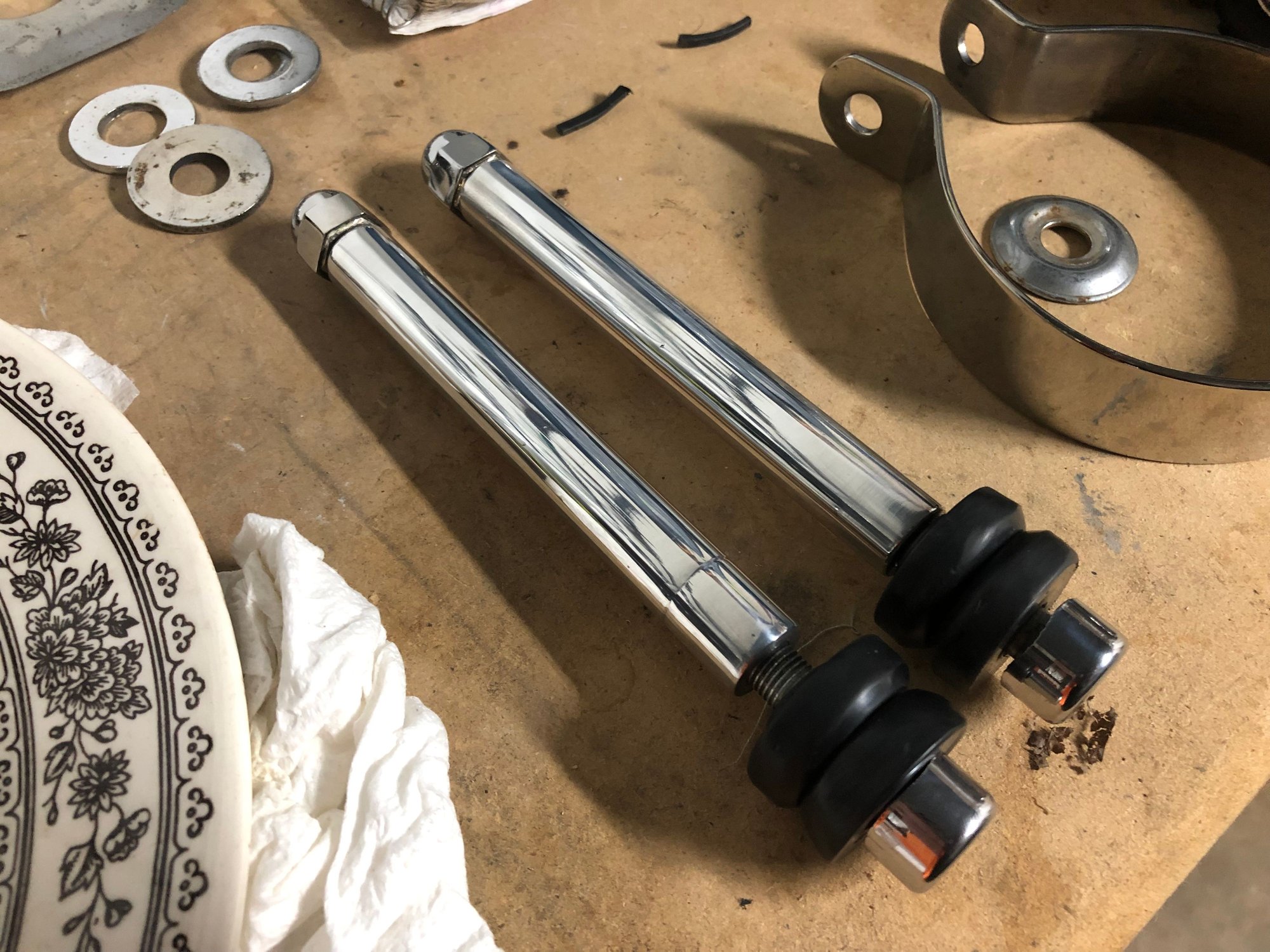

Waiting on the dash frame, diff flanges, tcase mount, fuel tank and fuel pump box to return from the paint shop. Between now and then I’ve surfaced, wet sanded then polished a bunch parts starting with 400 then 600, 1000, 1500, 2000, 2500, 3000. Refinished the distributor and all its little parts, the oil pressure sending unit, exhaust mounts and a bunch of misc supporting pieces.

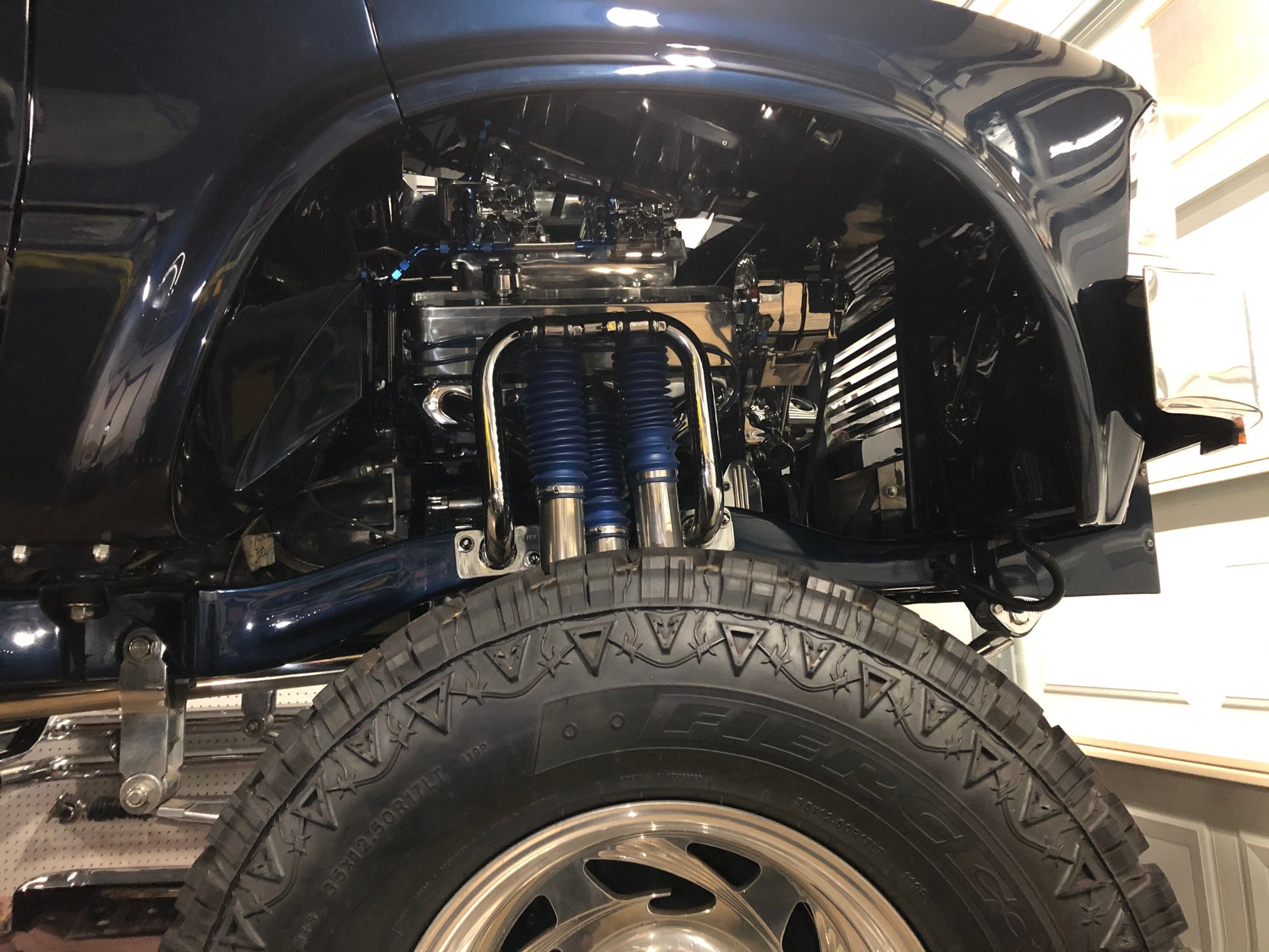

Also cut new insulators out of stainless for the front lower triple shock mounts and gave them the same procedure. All the hardware for the shock mounts has been replaced with full stainless with nylocks cut down to fit then polished, then covered with the original but re plated chrome caps

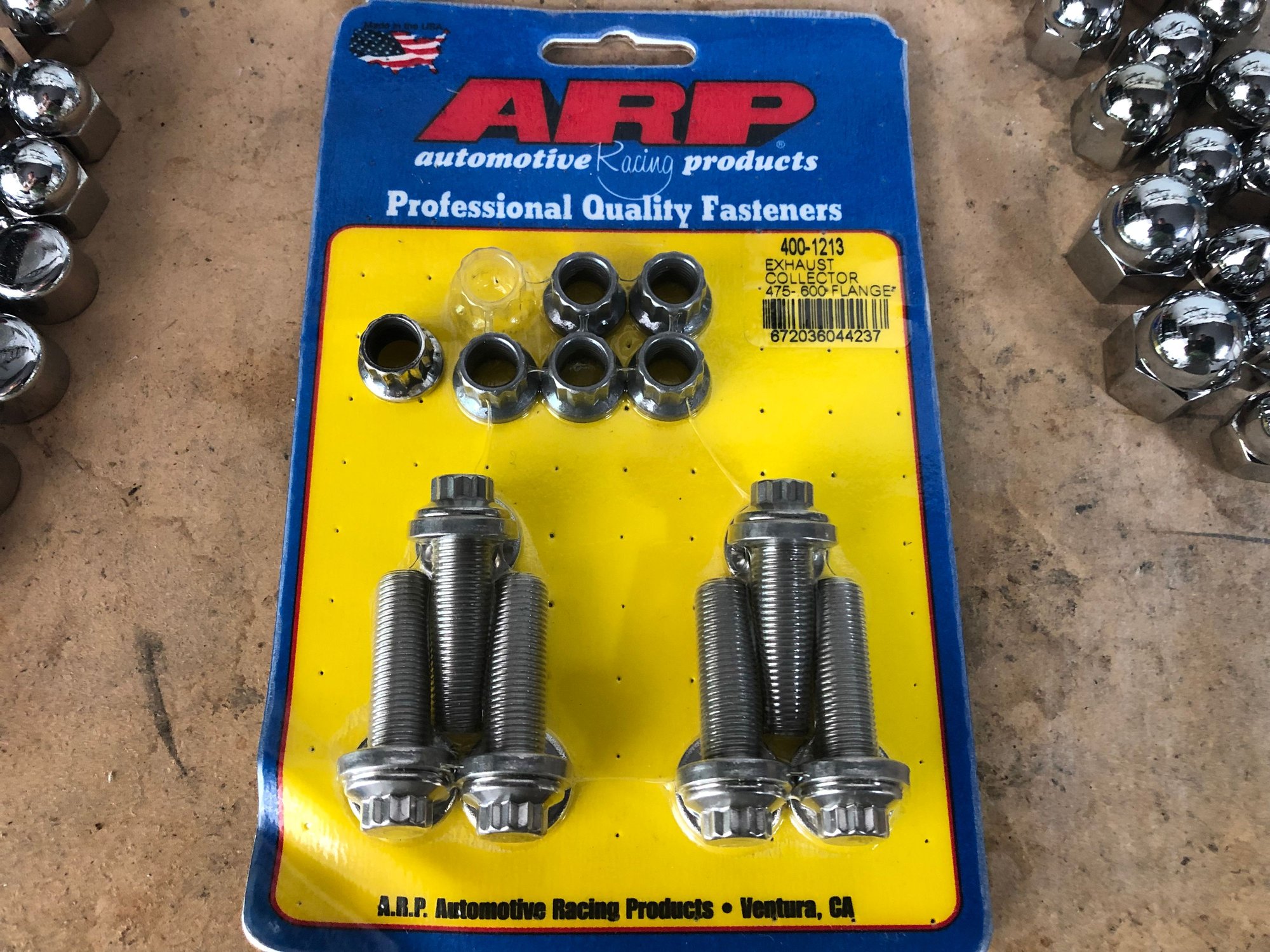

What was was supposed to be buy bolts and throw on turned into cut down to fit, surface, sand and re polish. The nuts themselves were sold as “polished” but they did a horrible job so I spent a couple hours polishing everything myself. When I had the hardware ready I had to carefully hang the exhaust and bolt it on.
Almost nothing on this truck has been a pull, re finish and slap back on. Everything has had some sort of hang up or the ocd forced me to go the extra mile on the detail and added weeks to what could have been bolted back on then and there.

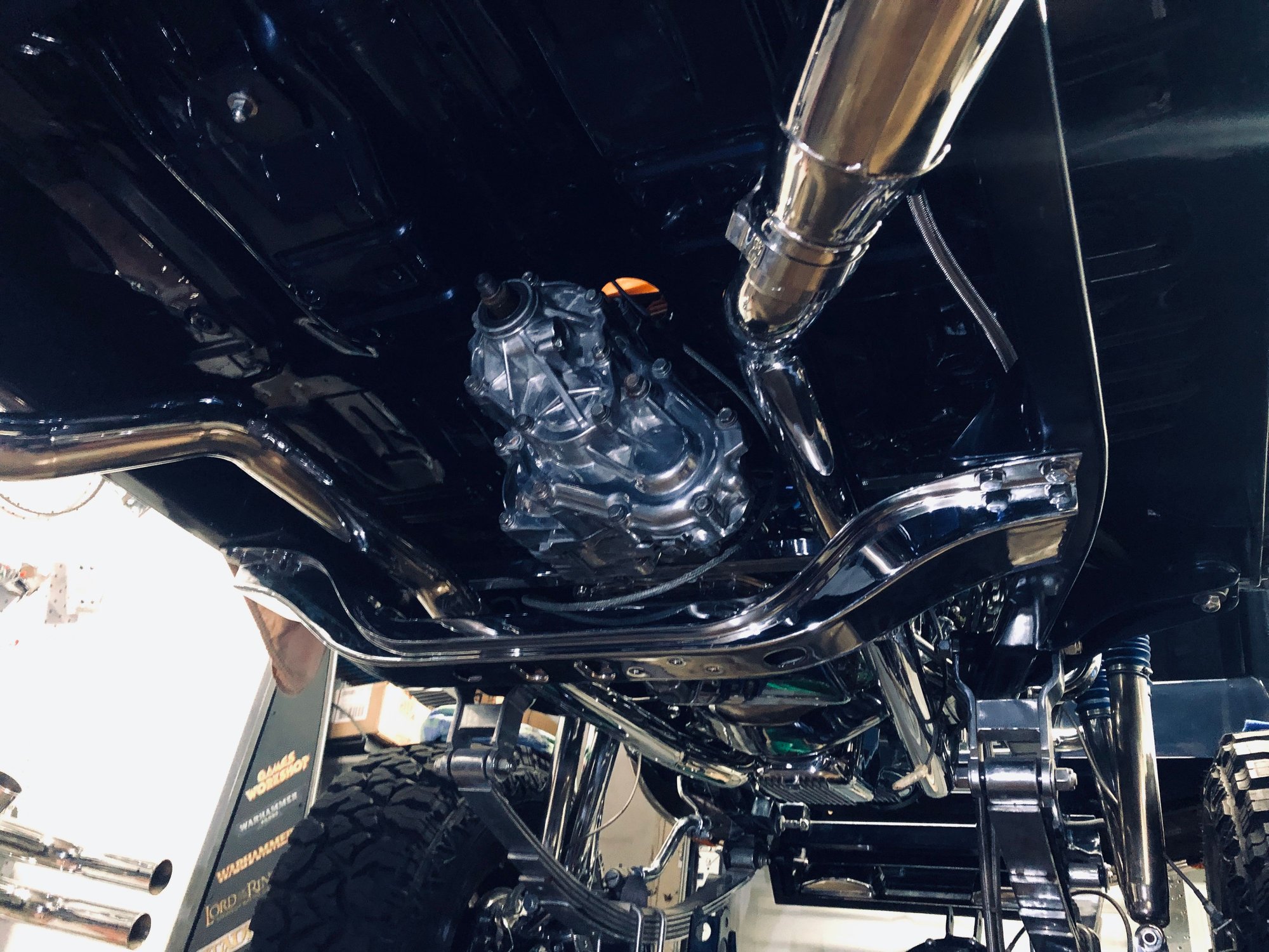

I had the T case out to repolish and re seal it while I sealed and polished the transmission. It also made it easier to build the fuel system with the extra room in there. It’s all bolted up to the trans for good just waiting on the rubber mount to be back from the paint shop so I can snug down the crossmember.

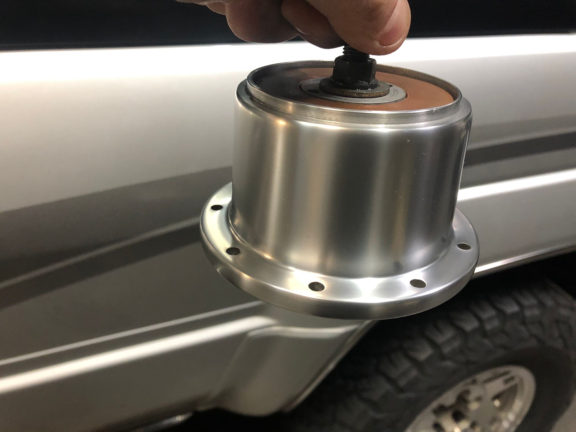

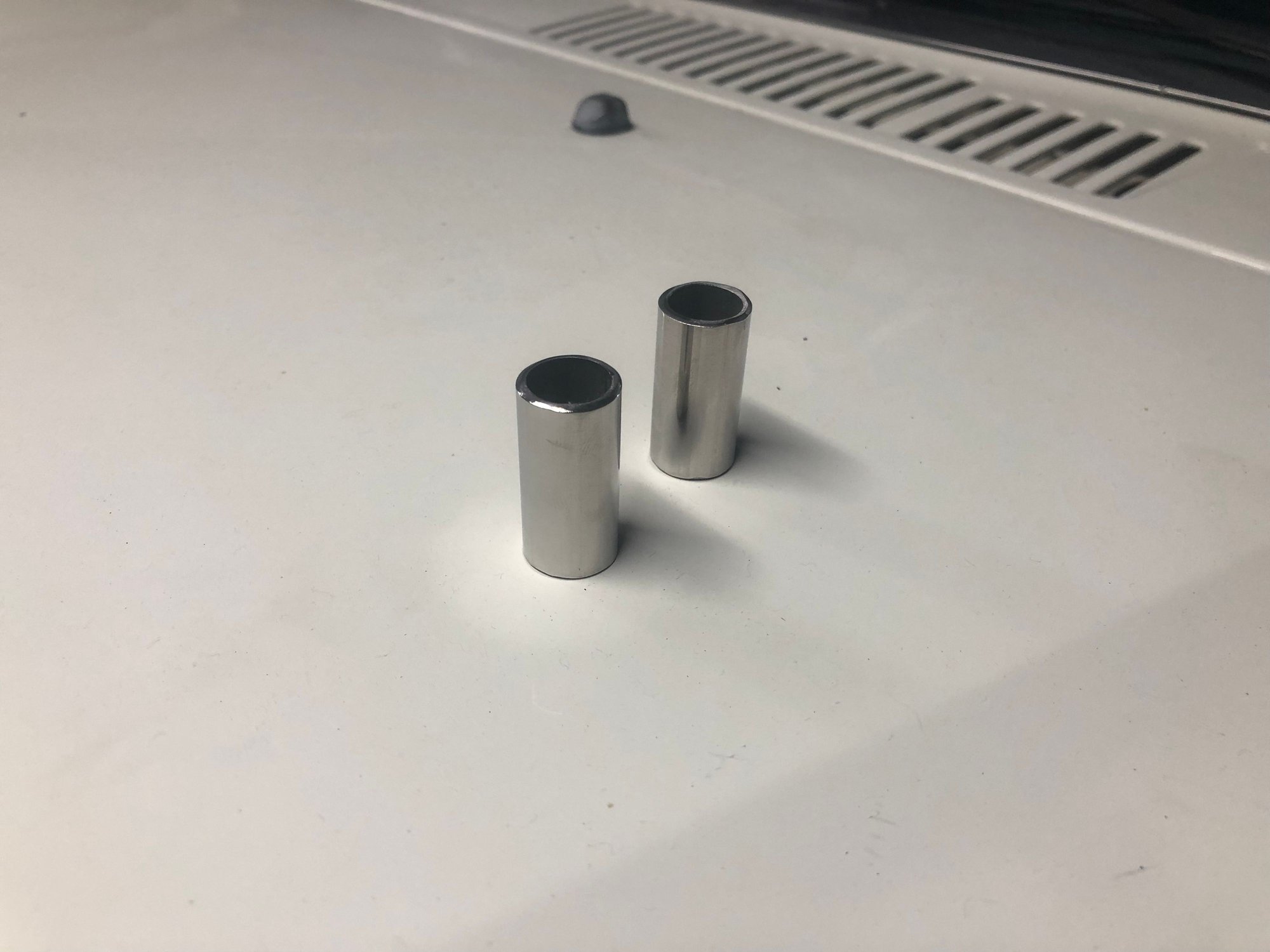

The steering wheel adapter was pretty scuffed, scraped and corroded so I refinished it today. Had to sand some of the deep scratches out with 80 and 150 grit. Then chucked it up to the drill using a 14mm bolt and wet sanded it with 220, 400, 600, 1000, 1500, 2000, 2500 and finally 3000. I like the finish but I may do a good polish before it goes back on. Night and day over what it looked like this morning so I’m happy.

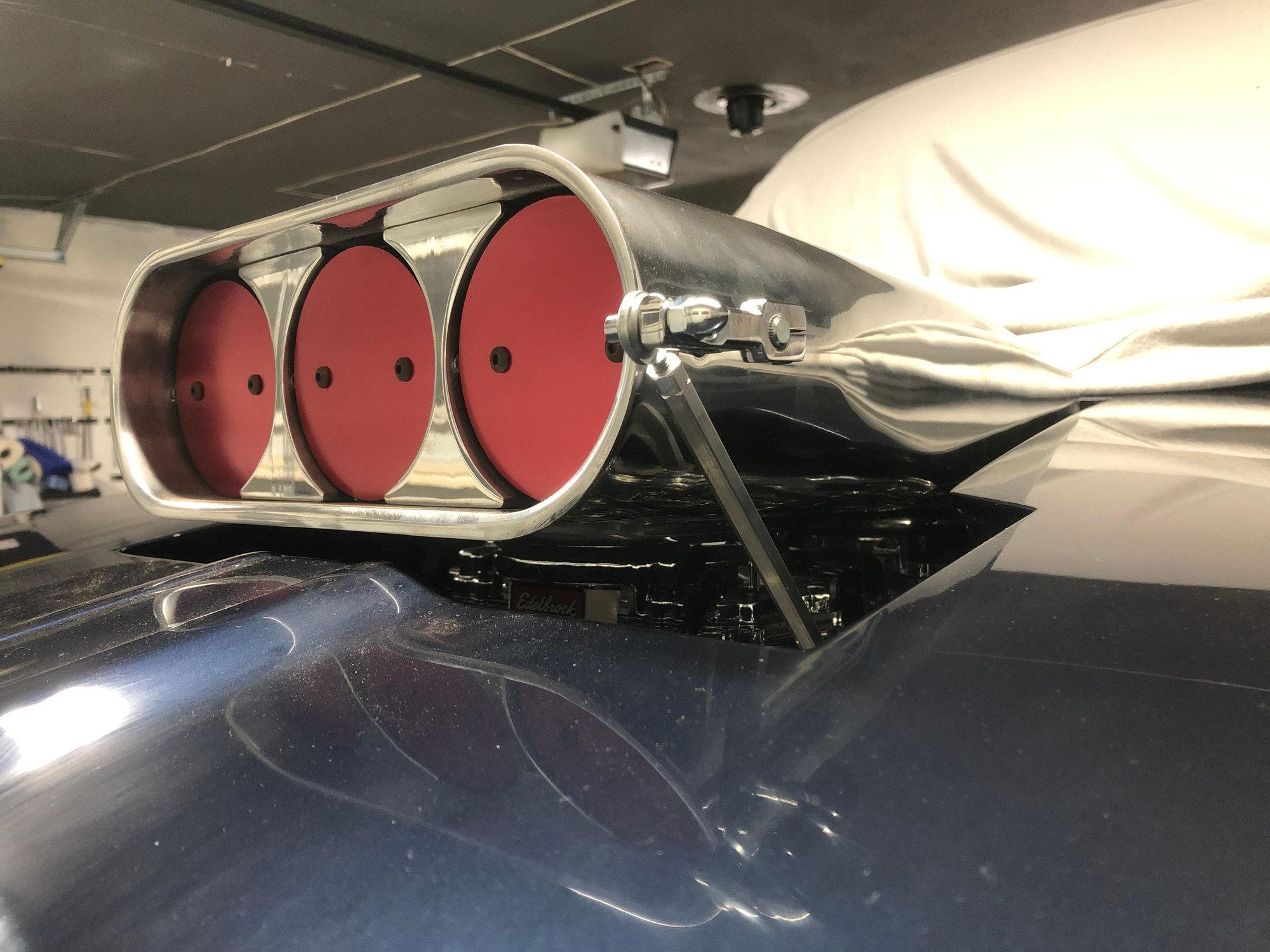

I got all the scoop linkage sorted and on after an hour at elliot’s hardware deciding on what chrome bolts I wanted. I’m going to take it back off now that it’s all fit up and polish the aluminum tie rod. I may even cut it down some to bring the lever down and correct the angle between the scoop and carb linkage. For now it opens very smoothly and works well but my ocd wants to take it further.

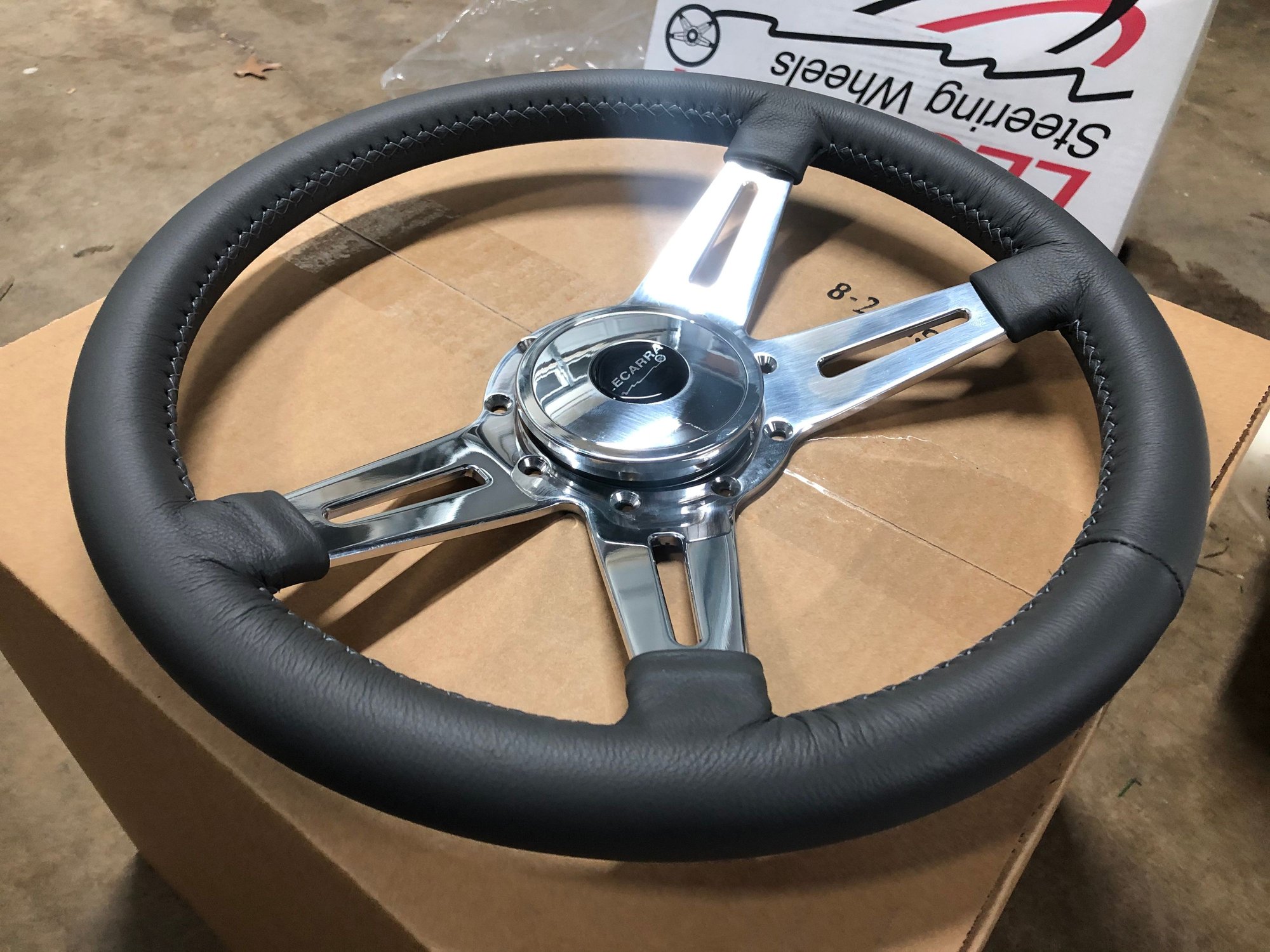

Summit racing is less than an hour away so I walked in and picked up some parts. They had the Lecarra dark gray steering wheel which is supposedly the one it had in it back in the day. I’ve been on the fence about what steering wheel to go with but it looks pretty good. Now to get some stainless hardware and polish them up so it can be mounted

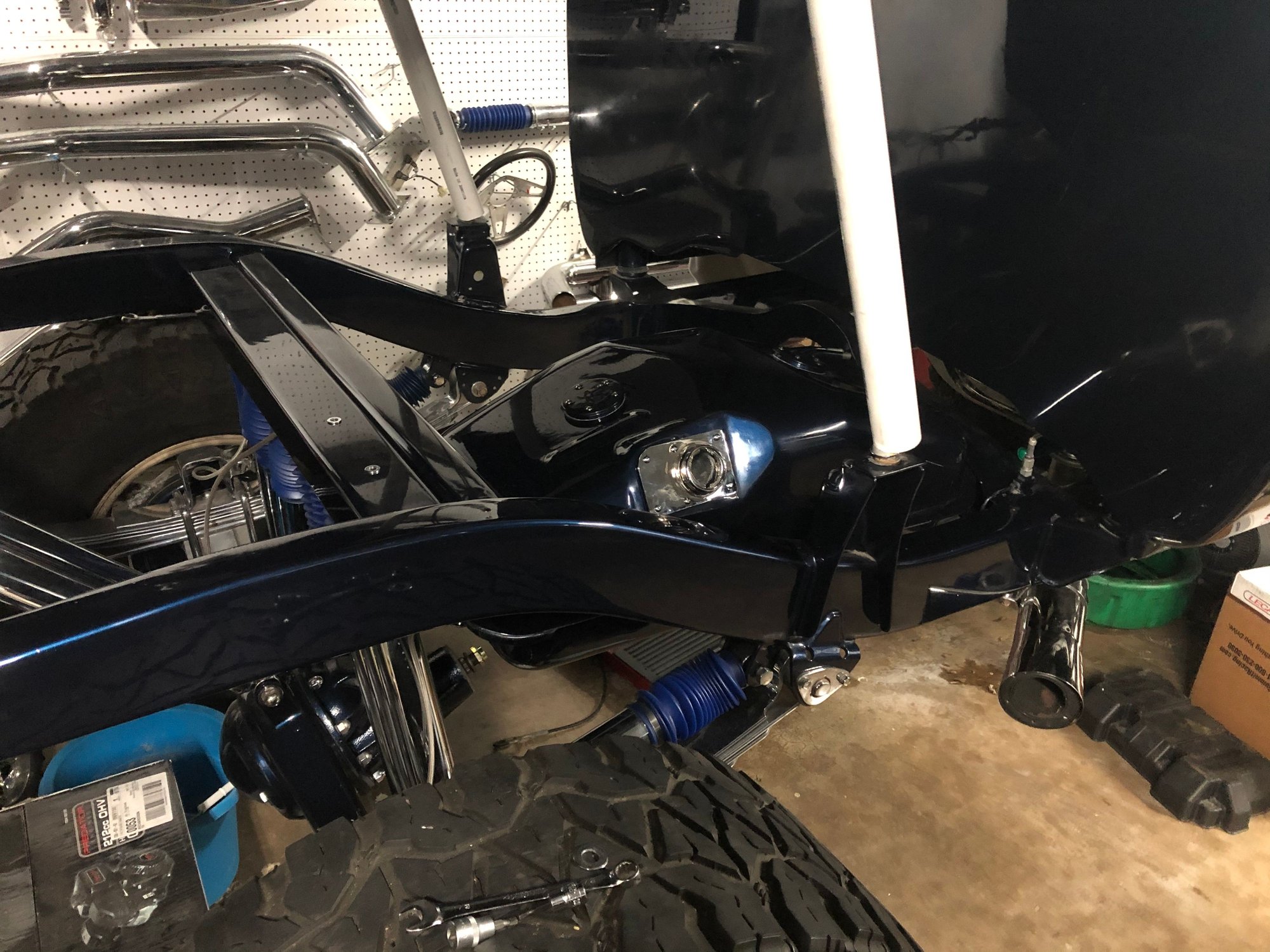

after waiting 9 months I’ve just finally got my dash frame, fuel pump box and fuel tank back from being painted. I had the tank painted a while back but I had to go back and modify the fuel filler and get a few scratches fixed so it was painted again. Now that I have them the rest of the fuel system can be completed and I can continue wiring the gauges.
I am also in the middle of having a custom radiator built and will be shipping mine off anytime now to be replicated out of aluminum. It’s going to have 4 electric fans which will allow them to clear the water pump pulley. Since there is 4.5” between the nose and back of the radiator support I cannot fit 1 large fan. It will finally have the cooling it needs to be streetable and it’s going to glow like a core with blue lights inside
As soon as the radiator comes back and is installed it will be down to running a starter wire, wiring the distributor adding fluids then show time.
