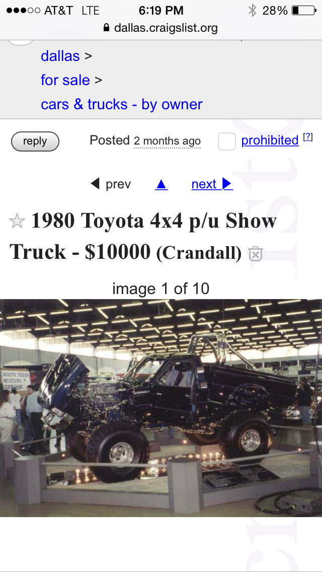

Originally Posted by dropzone
haven't checked out your thread for awhile, nice score on the tires.
getting parts back is cool
Nice progress
crazy that they had $125K into the truck.
You may have mentioned it but can I ask what you paid for the truck?
I know you are gonna have a bit (ok a bunch) getting it back to it's former glory
I didnt wanna risk missing out the truck so I paid the $10,000 he was asking. Never thought I'd spend that on an 80 but was totally worth it.
