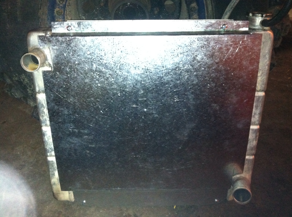

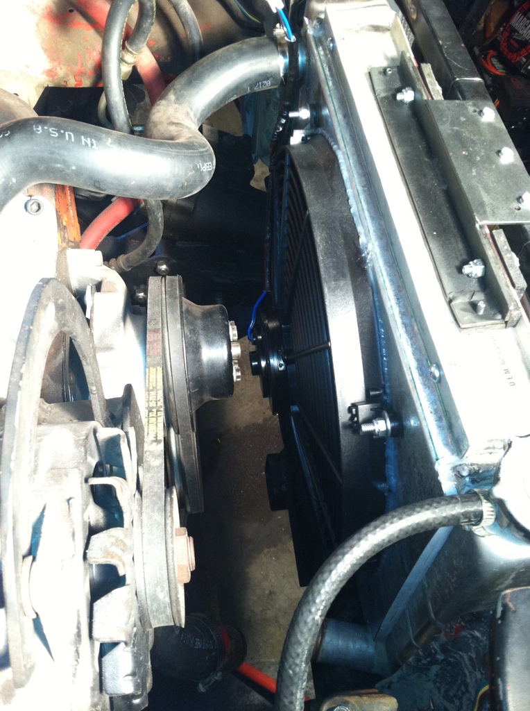

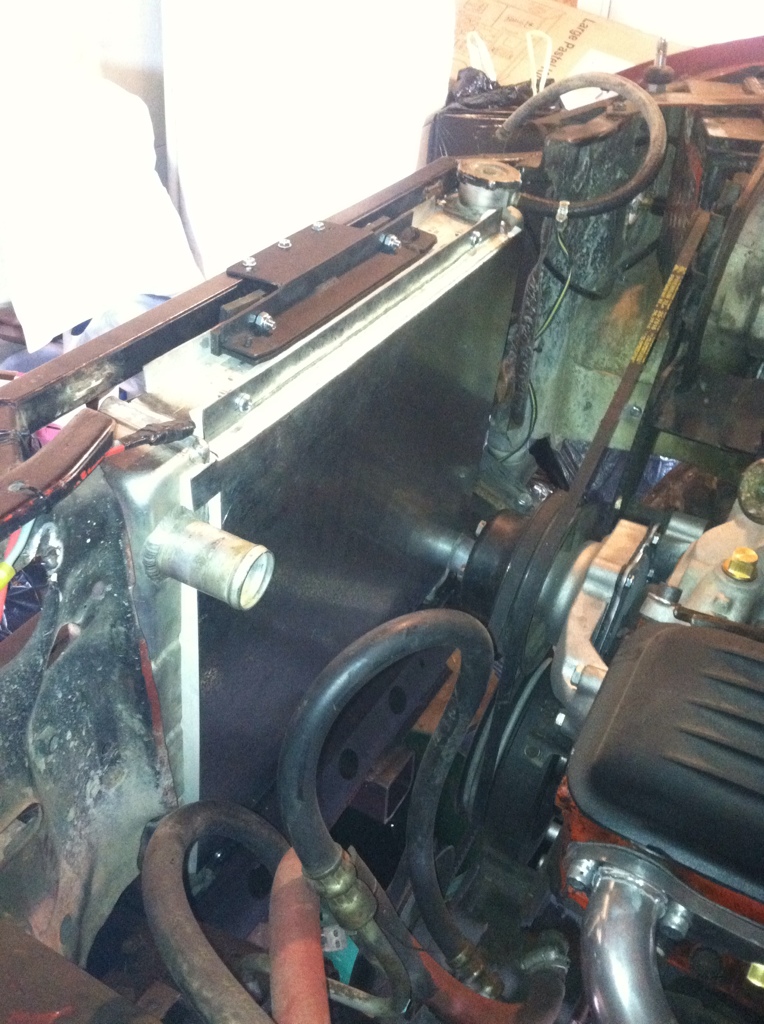

Ok I have done a little on the truck, but nothing major lately. Kinda short on funds for a while. I hope to finish my hood this weekend if nothing else comes up. I also started to cut my front fenders to make room for tires turning. I cut the front off at the bottom of the light. Hope to build a front bumper sometime. I also built a shroud on my radiator and mounted a bigger fan to it. A 16" fan almost twice the cfm of what my old one was. The truck used to get hot when I would crawl around.

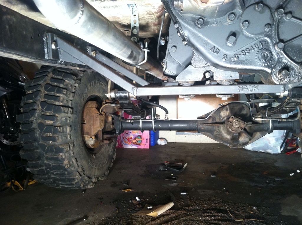

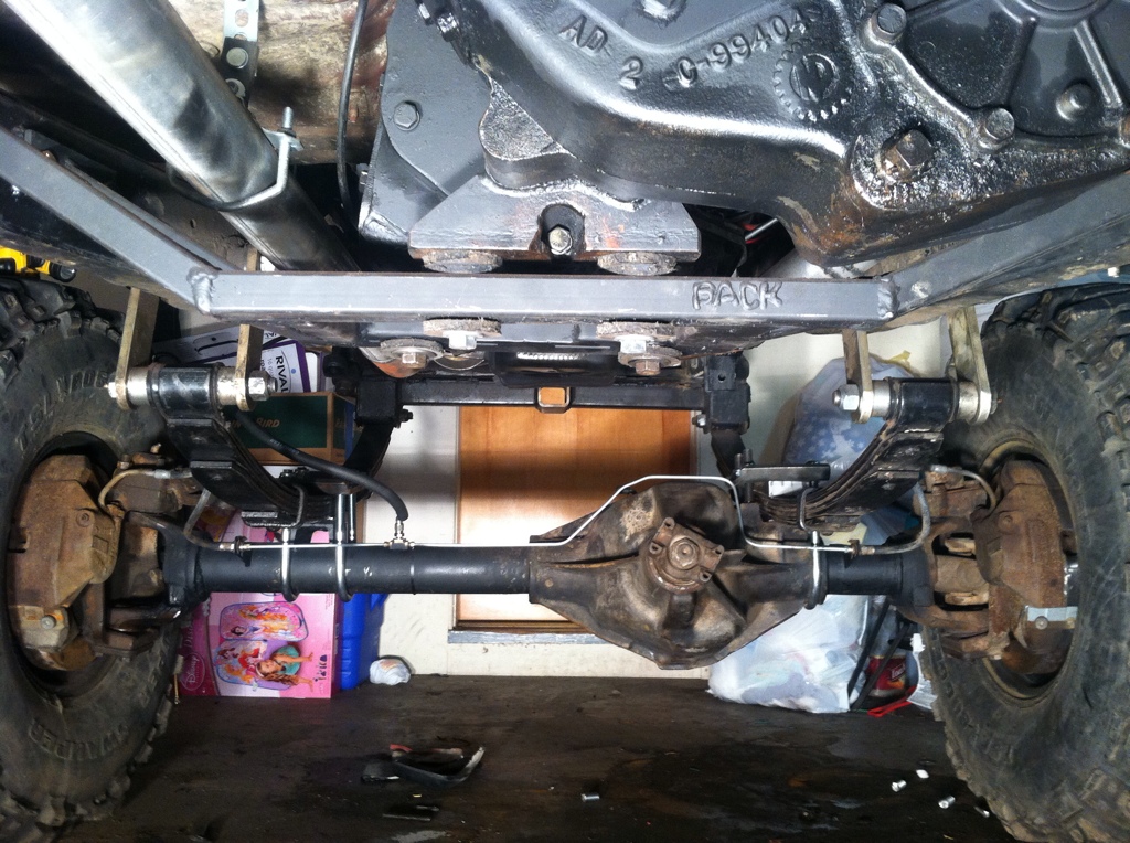

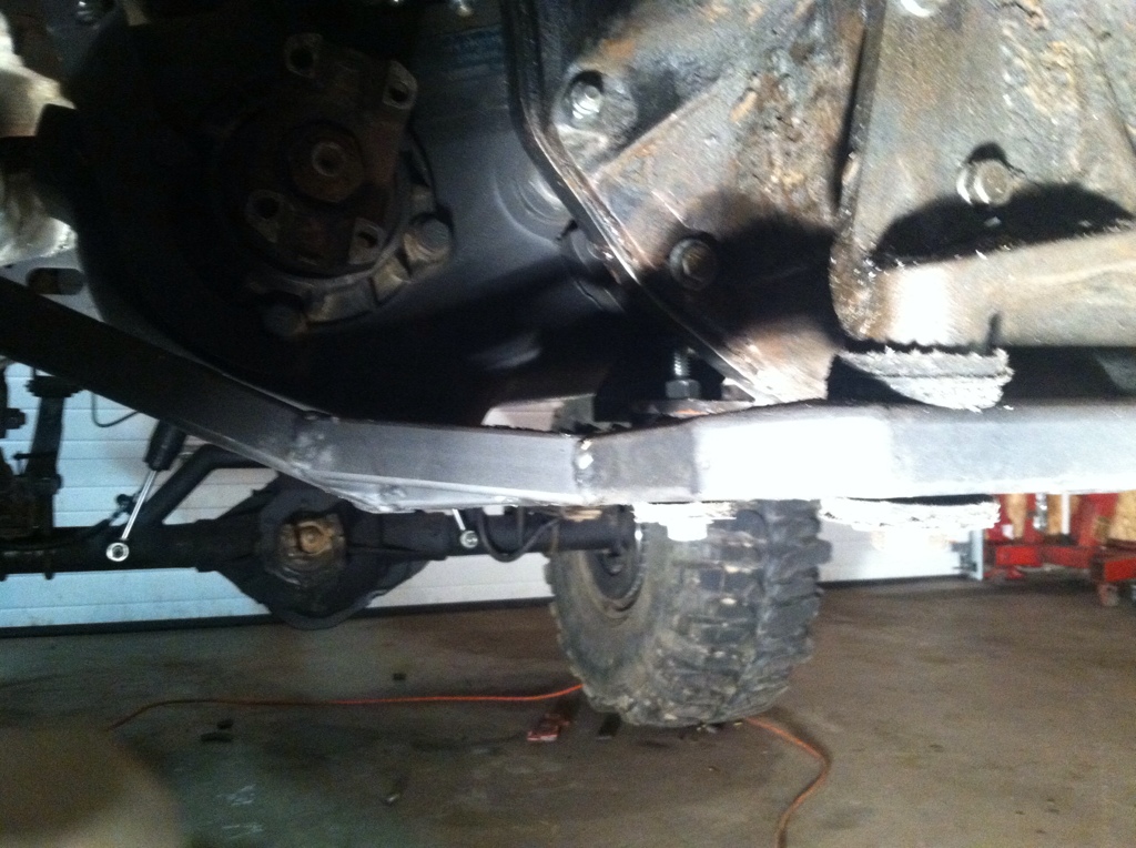

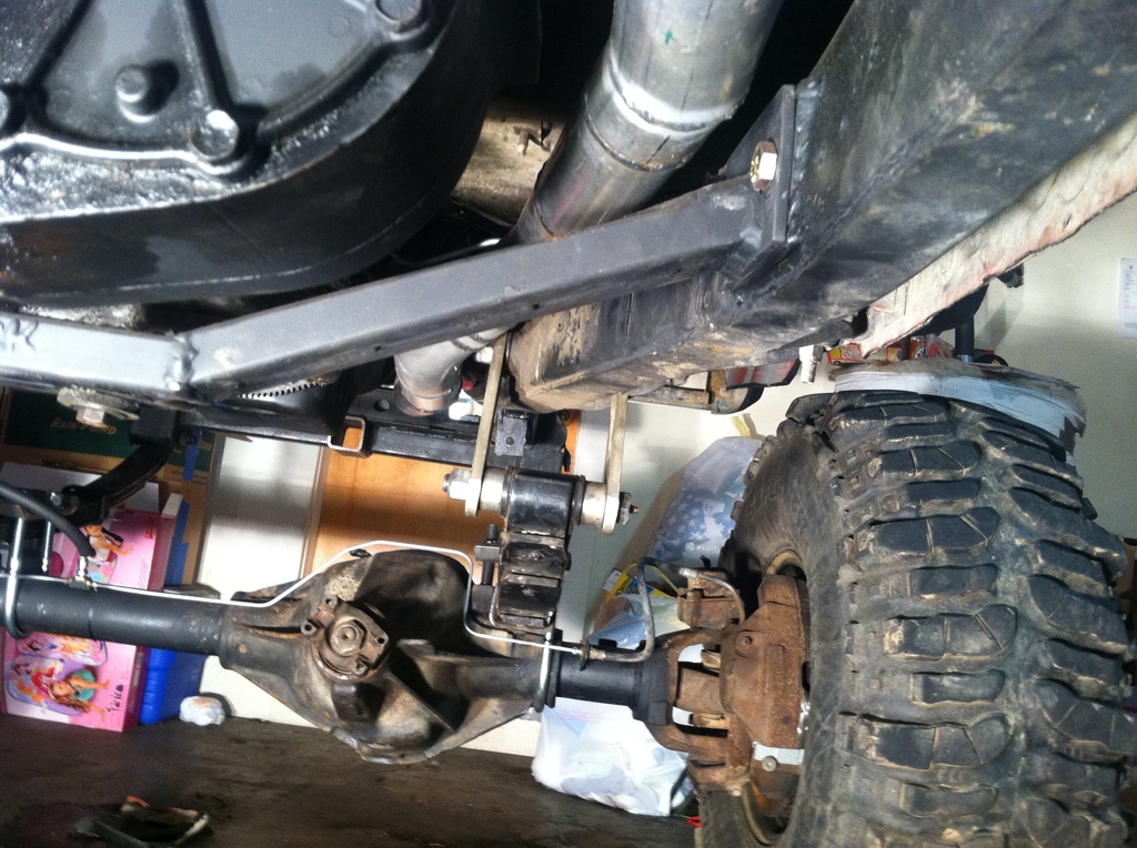

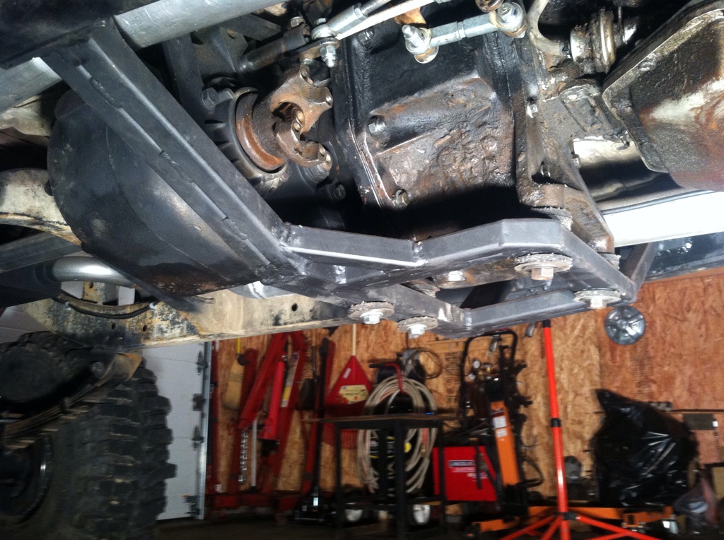

Wow bad ass truck! I am very interested in that transmission cross-member. Do you have any more pictures of THAT?

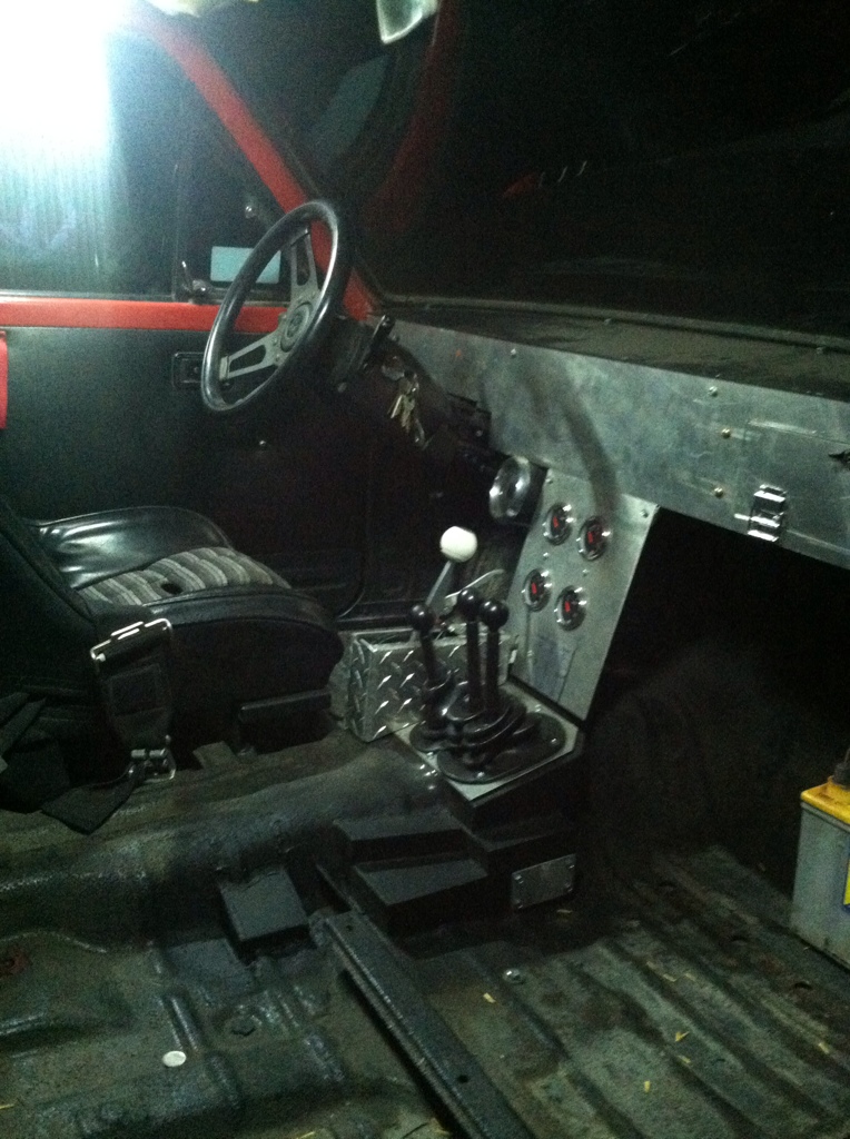

Thanks for the comments. Here is a pic of the whole dash. Kinda dark though. I can get more crossmember pics. I'll try to find some of my phone or take some tomorrow.
Here are a few more pics I took tonight. Was busy after work so it was dark by the time i got to take the pics and I turned on a work light for the pics. Any in particular that you would like?

Right on, man. I appreciate that! Looks great. What wall thickness did you use?
Arent you worried about sheering off those bolts off-road?

I don't remember the thickness i think 3/16". It was the thickest I could get in the size. Also it has 1/4" plate for gussets. As for the bolts hanging down. I'm gonna do a piece of tube going over them and incorporate it all into my skid plate. It's not done yet, but should be plenty strong when finished.
