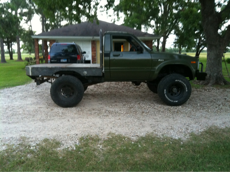

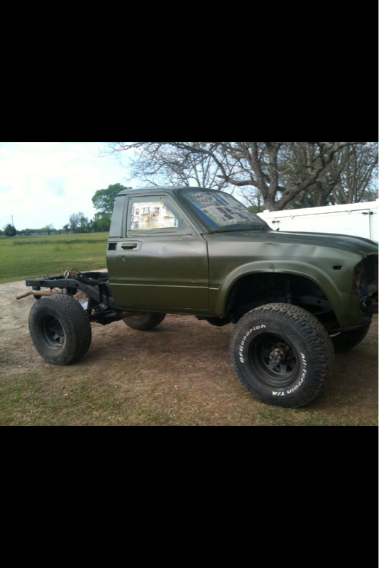

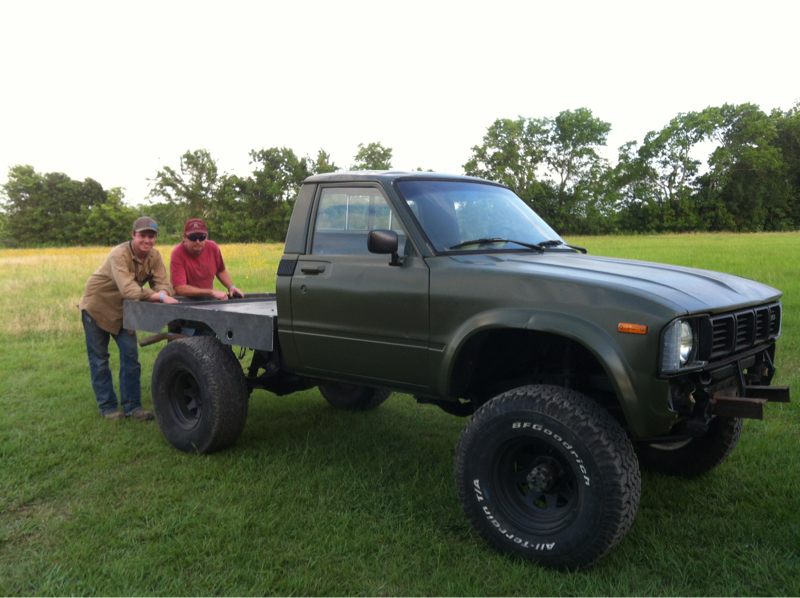

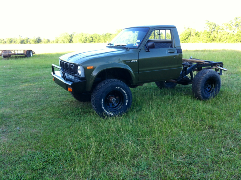

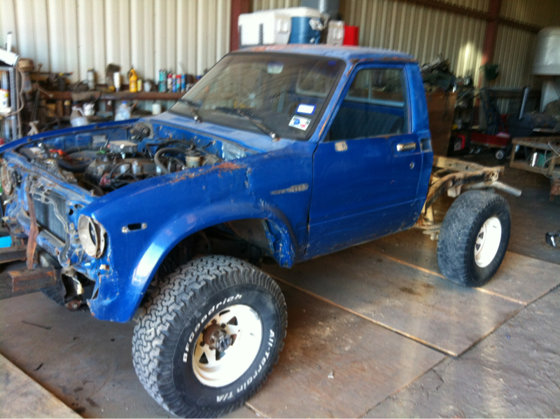

So I'm new to the yota world. I pick up big blue from a man for 1200 back in February and started work on it. Mechanical the truck is sound although I do have a few electrical problems with dash lighting and the headlights and park light. After the bed is finished I plan on wiring all the lighting into rocker switches to bypass the factory harness. All work has been done by me and my old man. Hope y'all enjoy and maybe throw out a few ideas on the lighting.

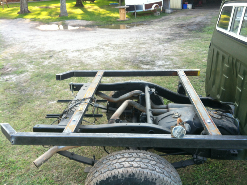

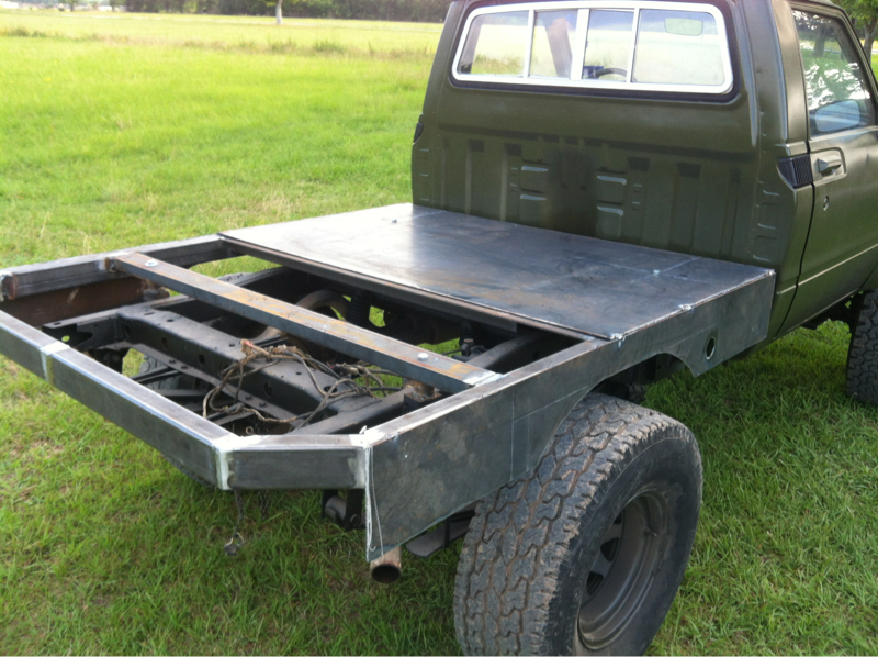

Good looking truck. I'd strongly suggest that you raise that bed up a little or your gonna cut those tires all to pieces upon flexing.
Notice how high up mines mounted
Every so often I do rub however my edges are smooth verses yours are sharp do to the design you created.
Keep us updated I'm enjoying what I'm seeing so far

Thank you toyota boy. In the beginning we discussed the wheel clearance on the bed. I'm not looking to do any serious off roading in this thing although the kid may come out of me one of these days. It's just more of a hunting rig and a rig to use around the ranch. As far as the clearance goes since those pics have been taken I have added new helper springs to the back to pick it up a little. We put the bed back on and flexed the wheels. I have a bout a 1" of clearance after the stops hit on the frame. I plan to leave it the way it is for now and see how things go. Hopefully in the next couple weeks the bed will be complete and put back on for some final pictures. I am ready to get mean green complete and out on the road. The electrical is going to be a booger for me.

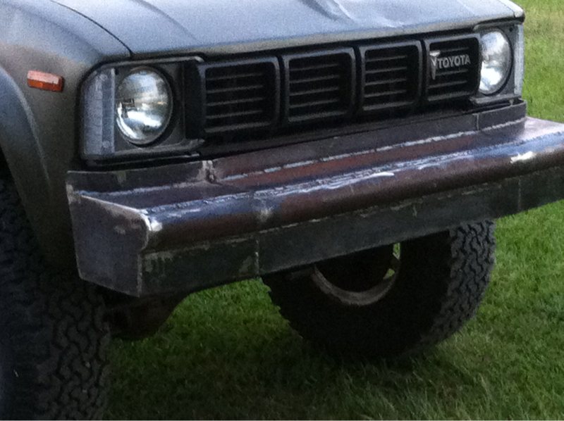

I love that front bumper!
Do you have any other shots of it in process or behind it?
