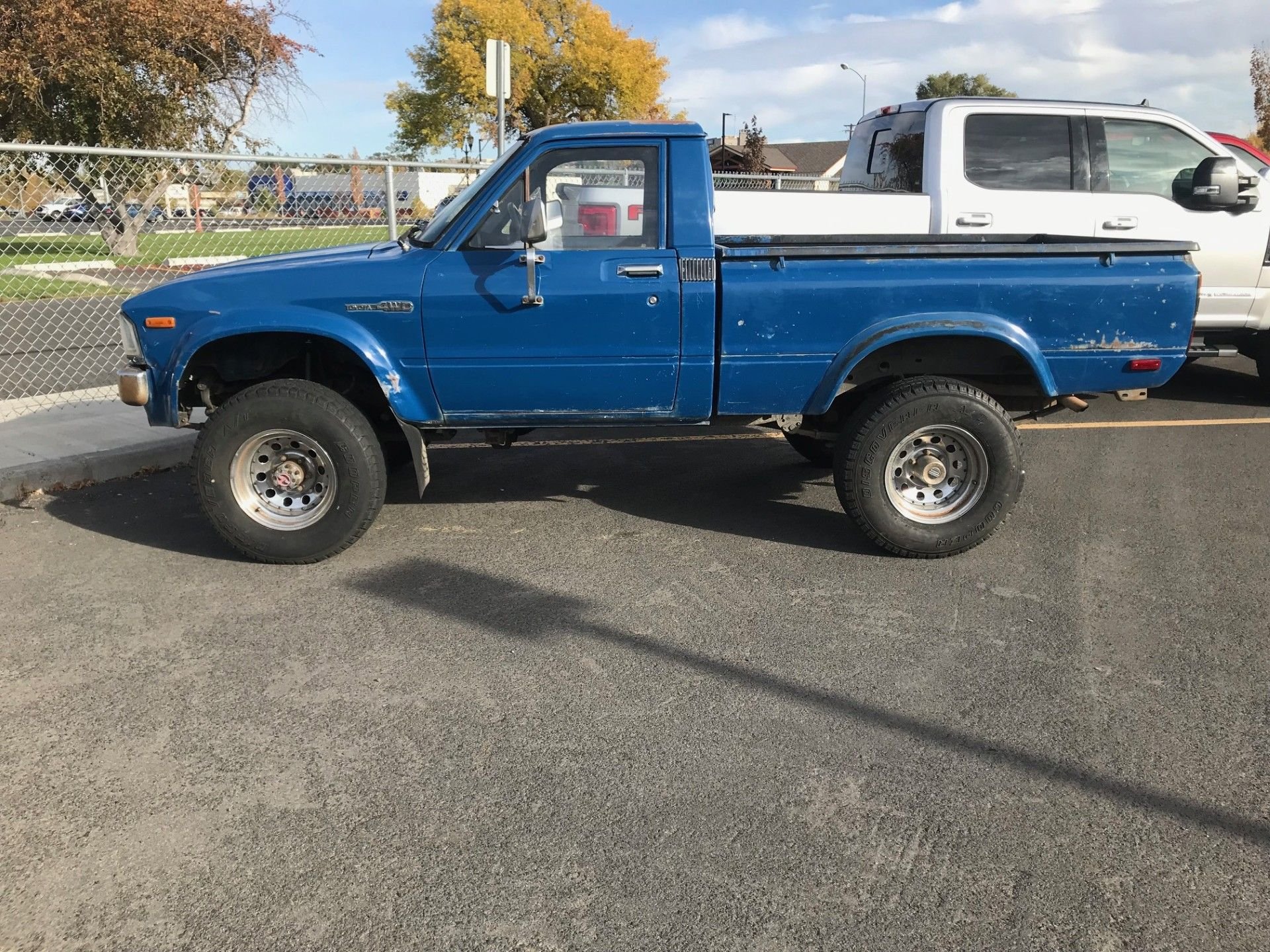

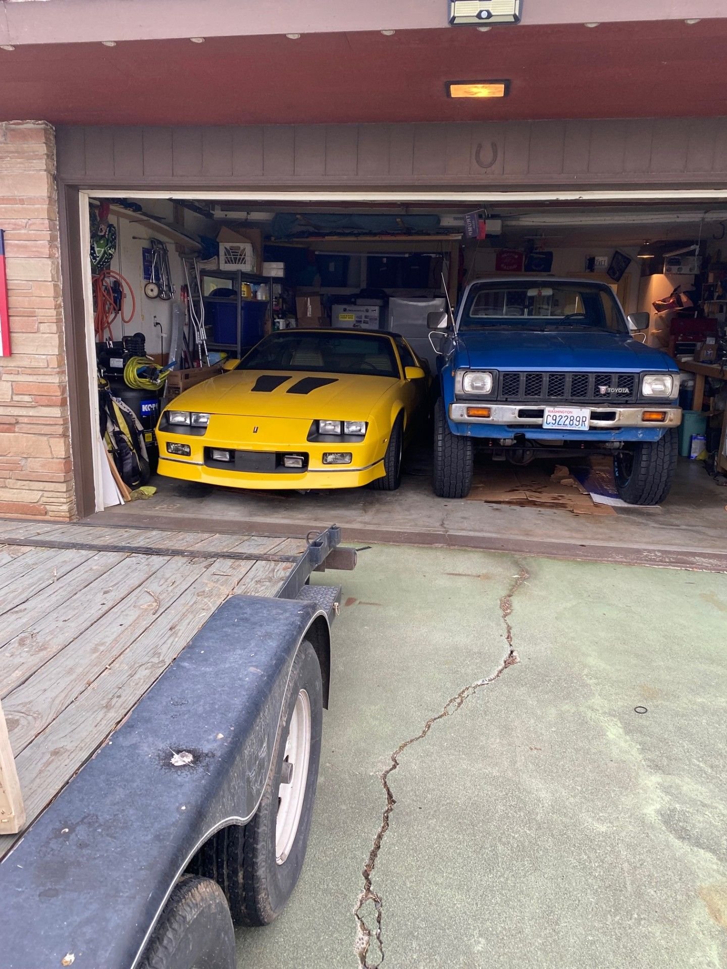

Well, I bought this 82 back in 2019. I had just started playing with it when we decided to buy another house. With much to do I stored in a buddy's barn until things settled down. Took four years for me to ready so I got her out storage. My plan is to do a full frame off restoration eventually but I want to drive it an enjoy it along the way. I figure in a couple years when I am fully retired, I'll go down the frame and start over. Here's what I'm starting with:

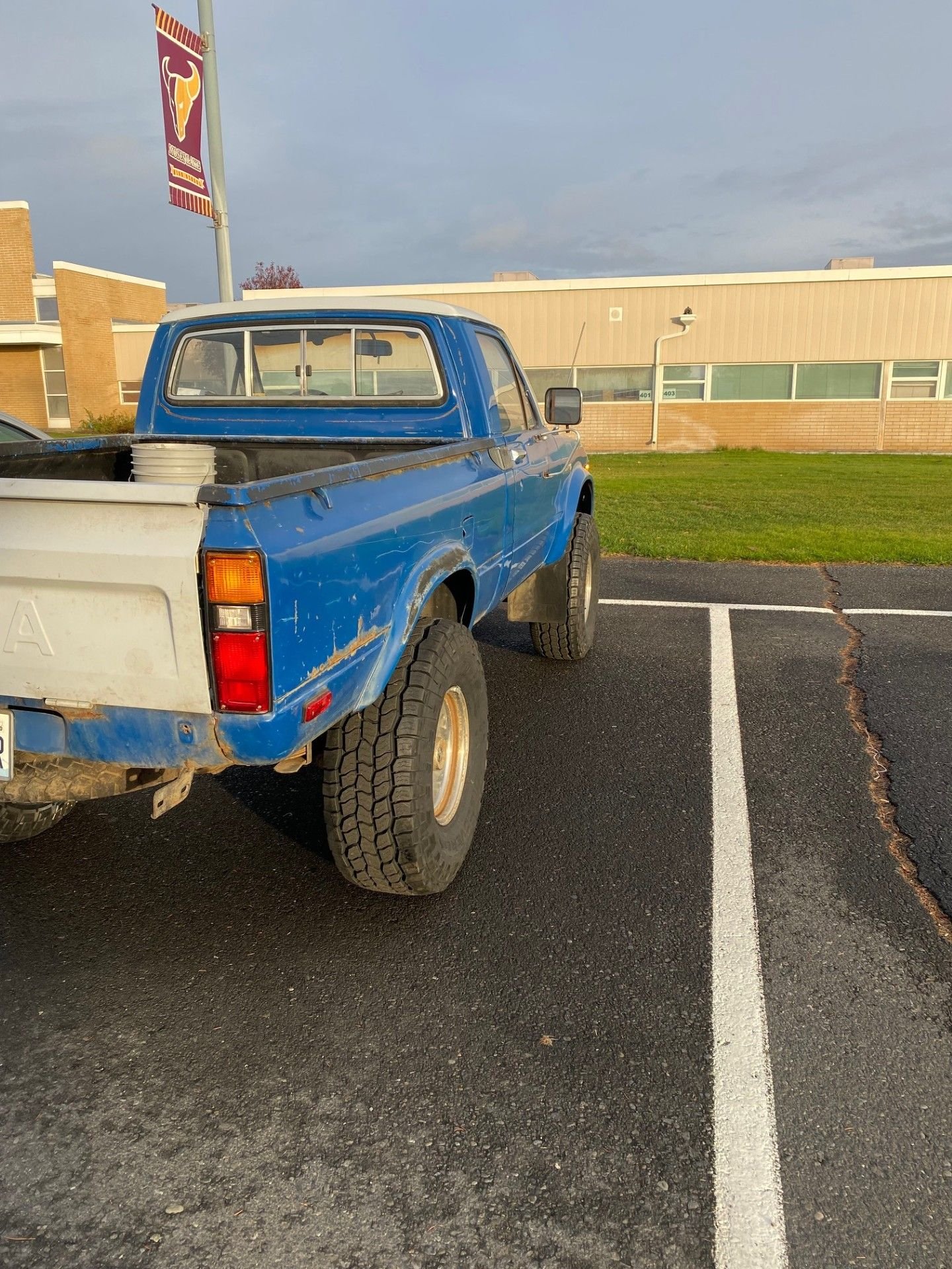

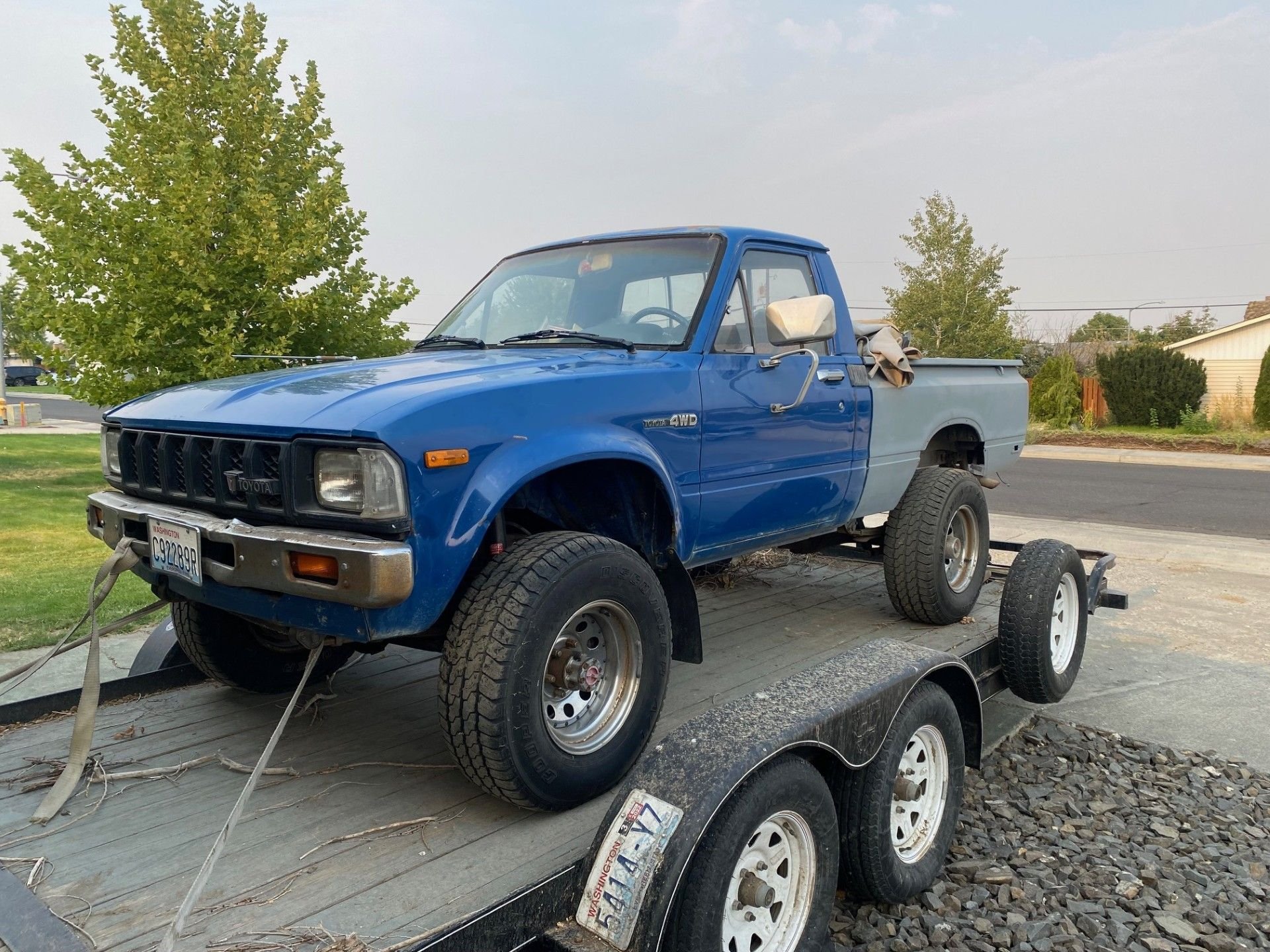

The day I brought her home from storage.
It need a new fuel pump and battery to get her going and today it runs like a champ.

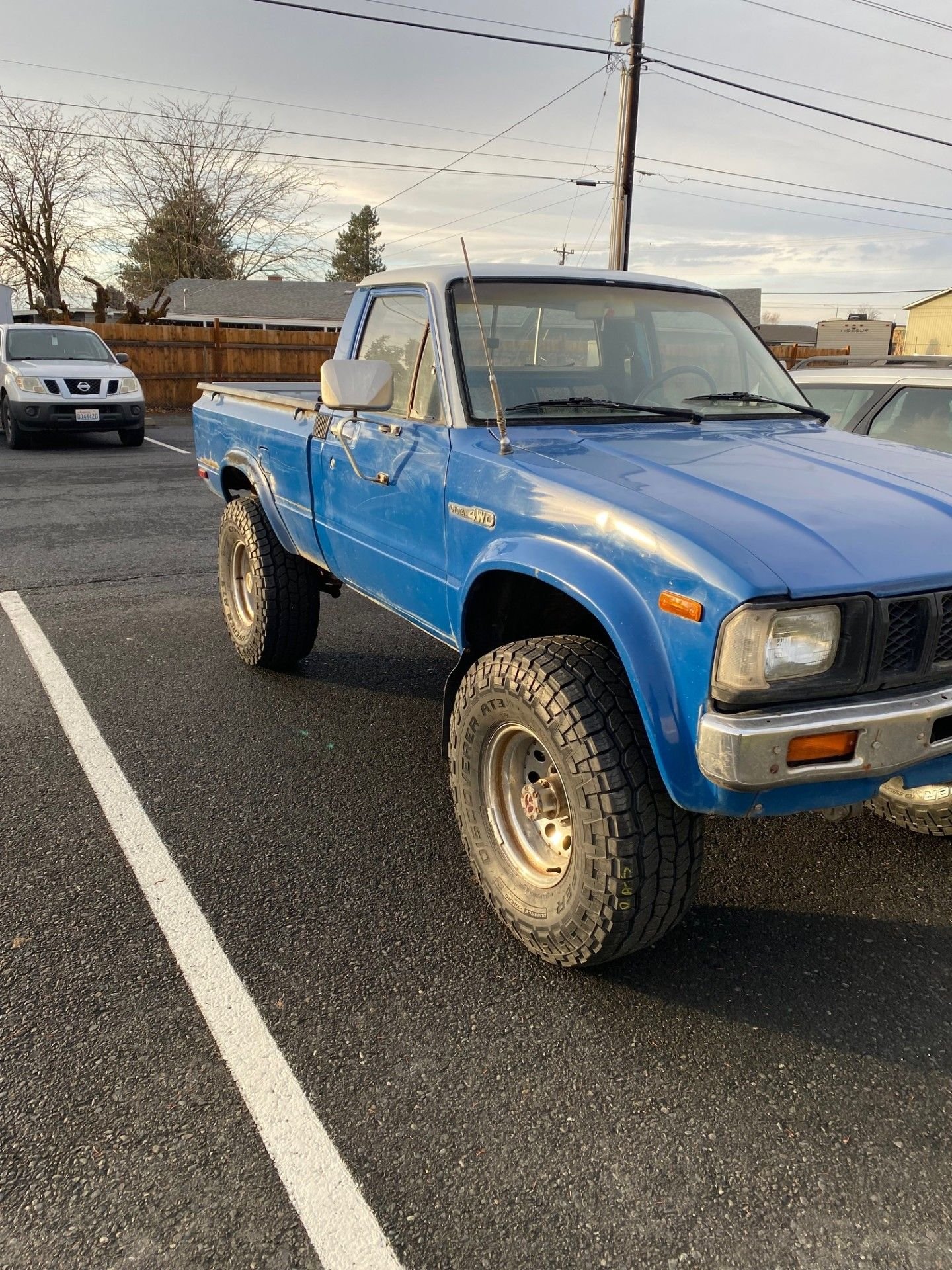

The guy who stored the truck in his barn gave me these wheels and tires. Decent enough tread but they are over 20 years old and the rubber is hard as a rock. It could start snowing here any day and I think they would be way to slick. So I got me some brand new 33's. They look bad ass!

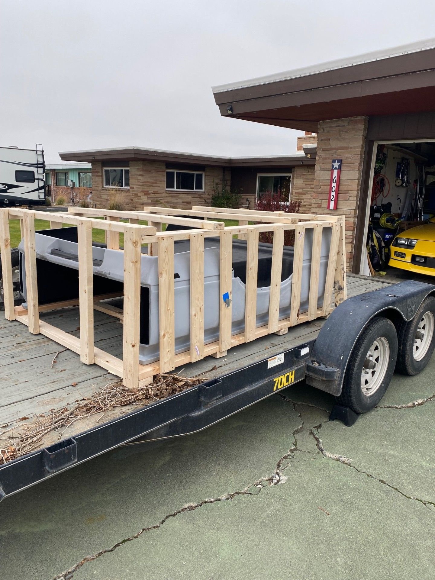

Exciting stuff! My bed from Corey arrived today. The lift gate on the delivery truck broke earlier in the day so I had a couple buddies come over so we could unload it. It's all covered now until I can get to it come Spring. Thanks again Corey, it looks amazing..

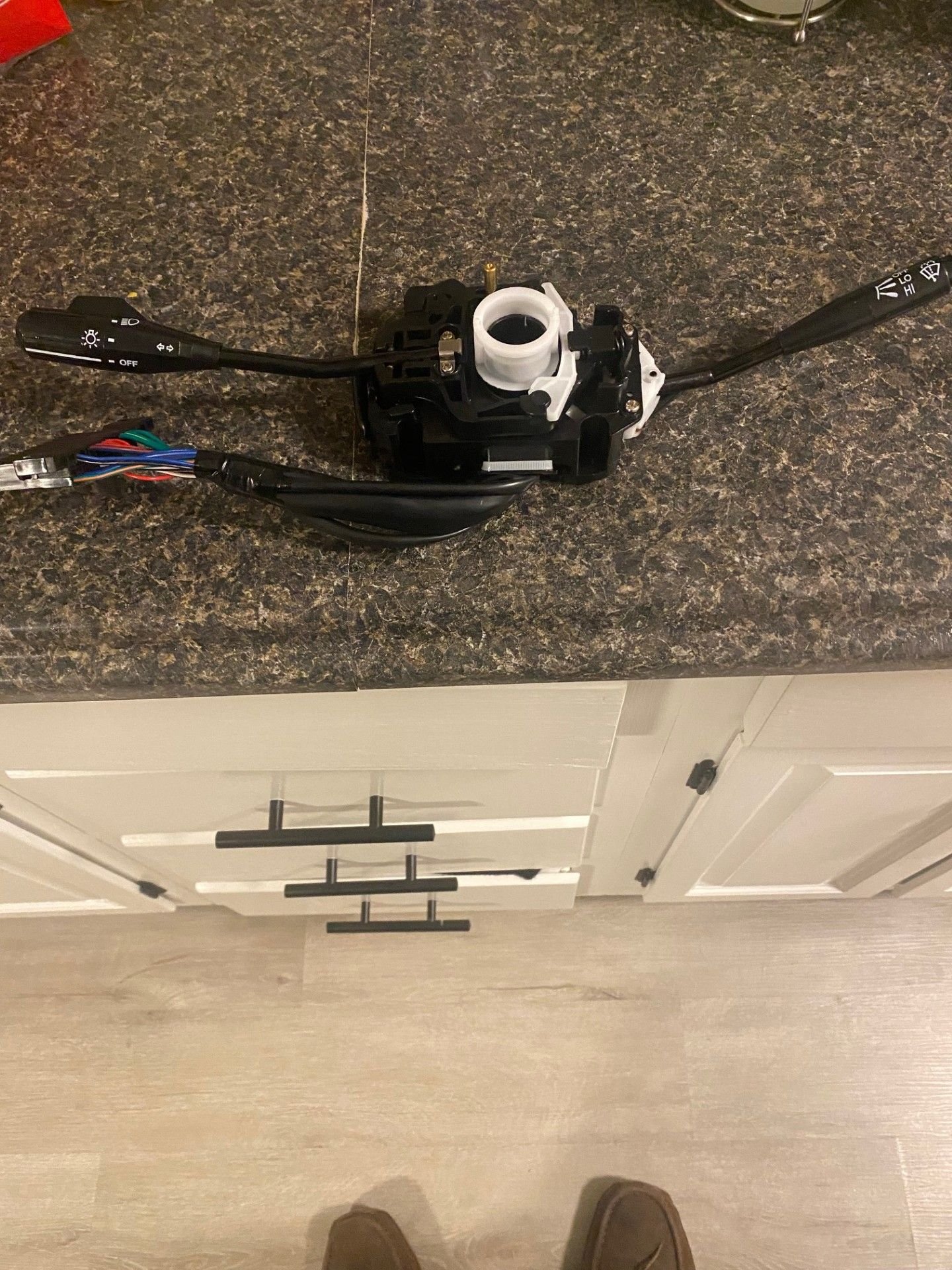

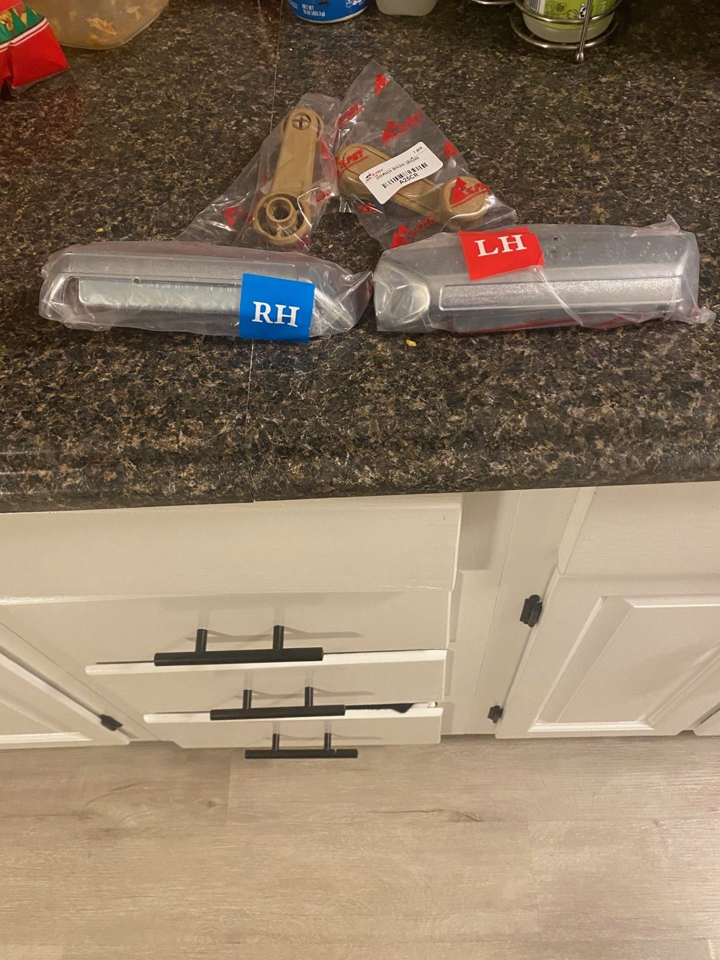

Going to try to knock out the interior this winter. got a few goodies in the mail the other day.

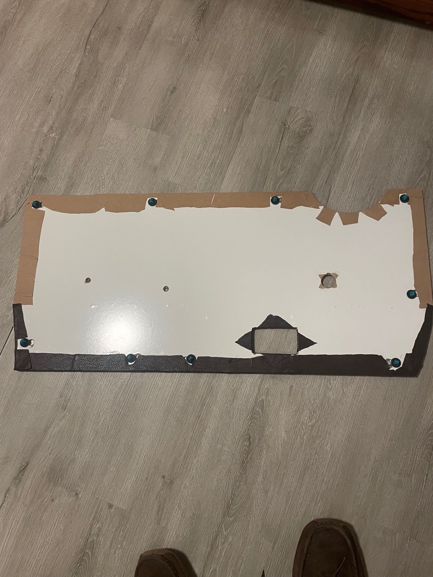

Decided to start on my door panels, followed this guy's thread.
https://www.yotatech.com/forums/f116...panels-256546/
Old Dec 22, 2024 | 07:54 PM
sent112's Avatar
5 Year Member
Joined: Aug 2019
Posts: 69
Likes: 13

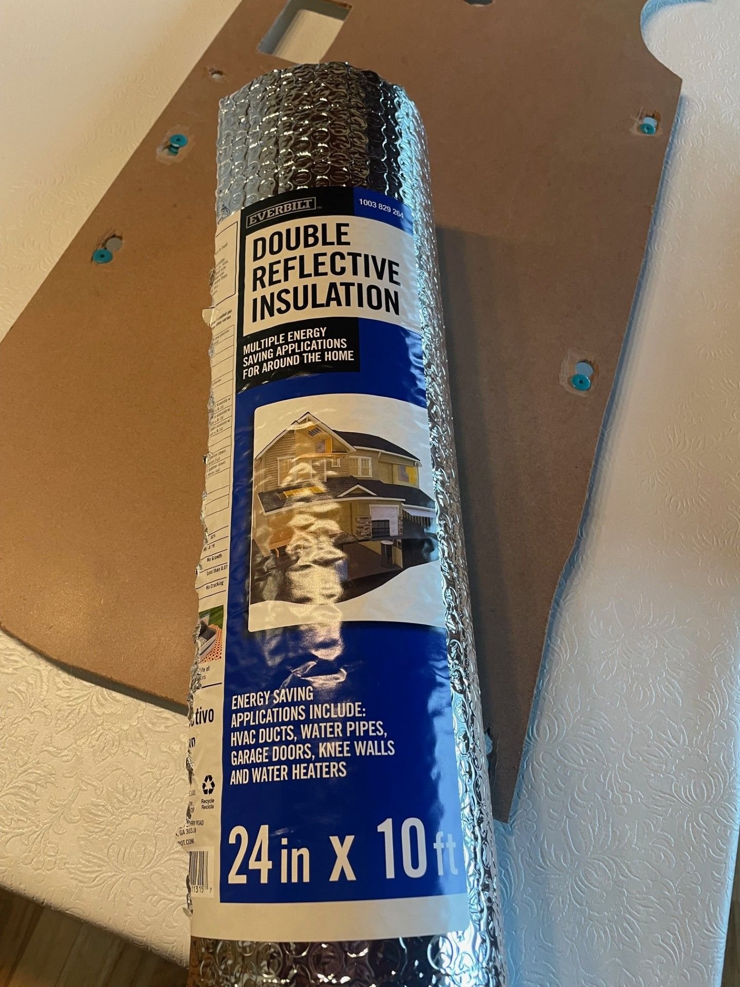

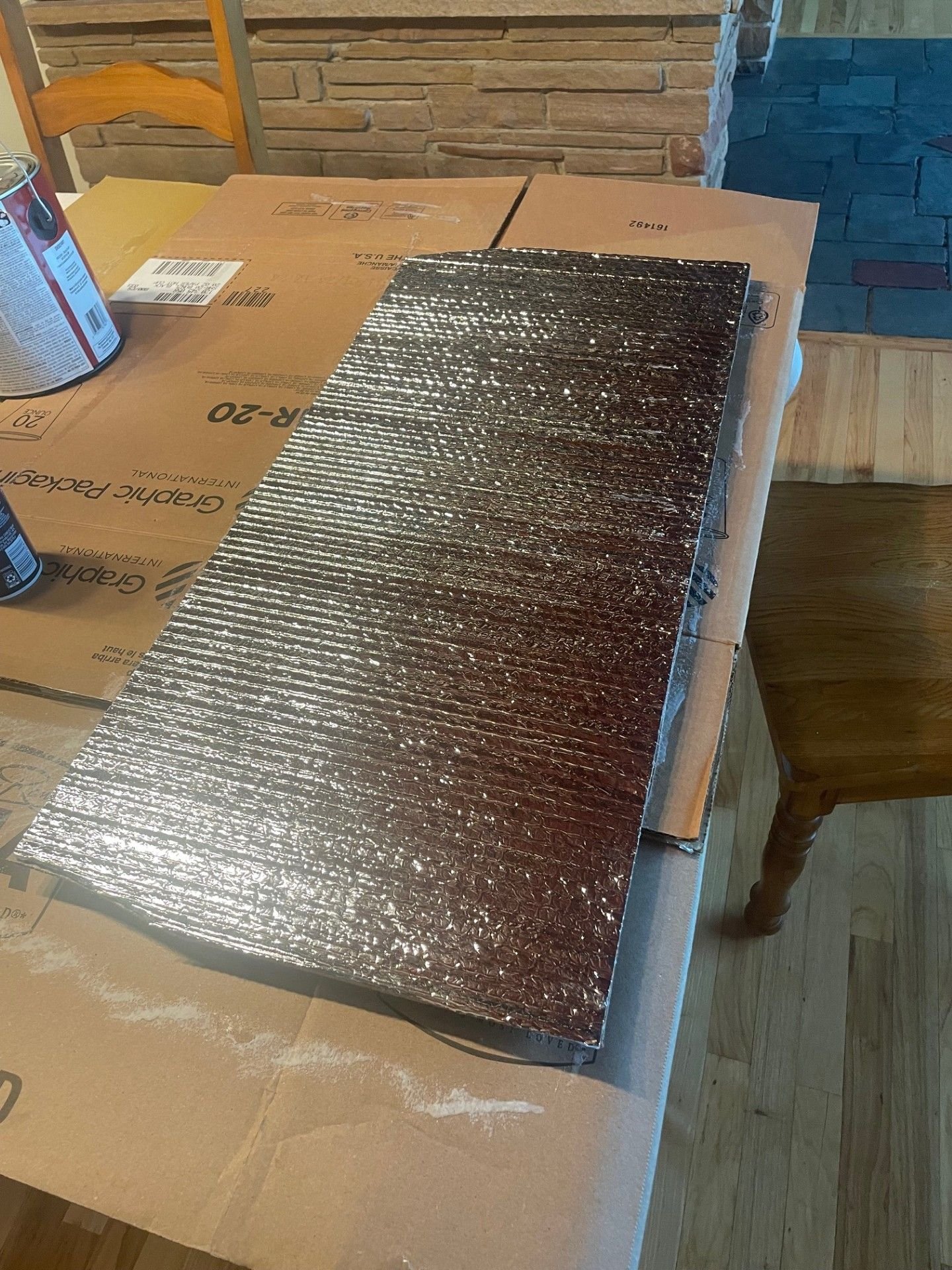

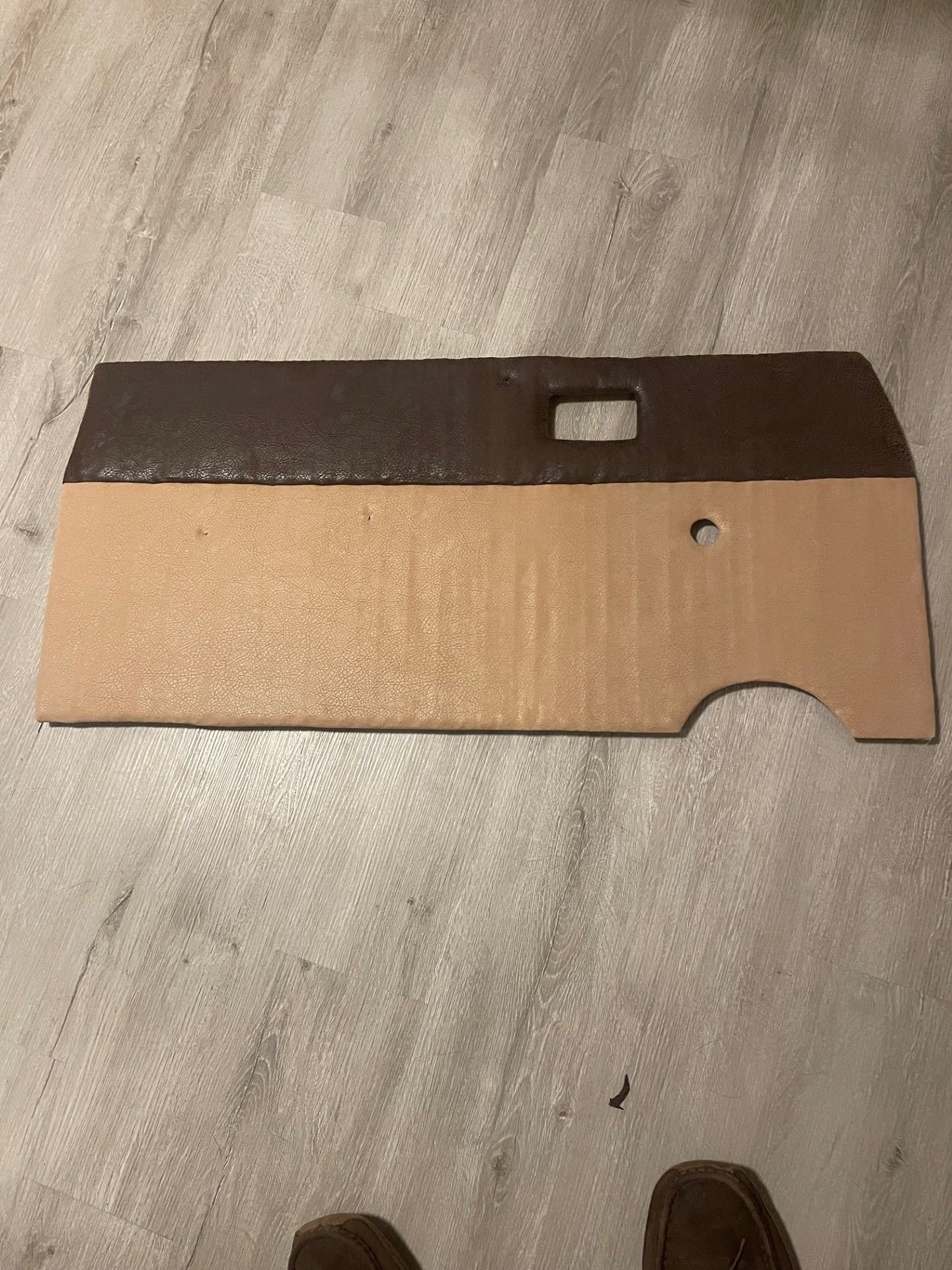

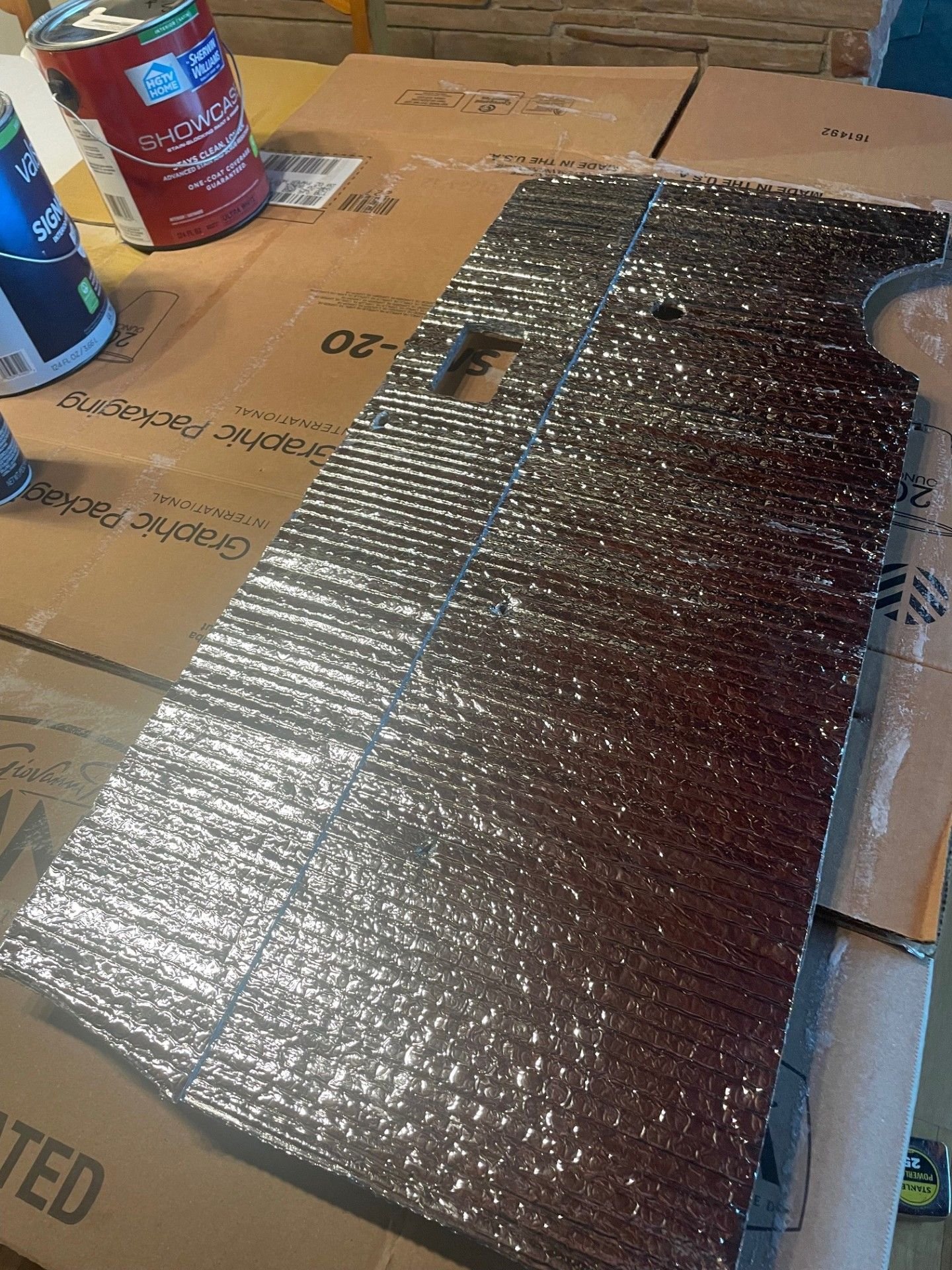

Got some 1/8' MDF and cut my panels. Installed the clips.
Thought I'd try this stuff to put under it for padding, and sound deadening.
Decided to go two tone so I added an extra layer on the upper 1/3 for a little extraz padding.
Lots of spray adhesive and it turned out pretty good. I like how the bubble wrap insulation gives it a textured look. Six hours on this one. Get to repeat tomorrow for the other side...

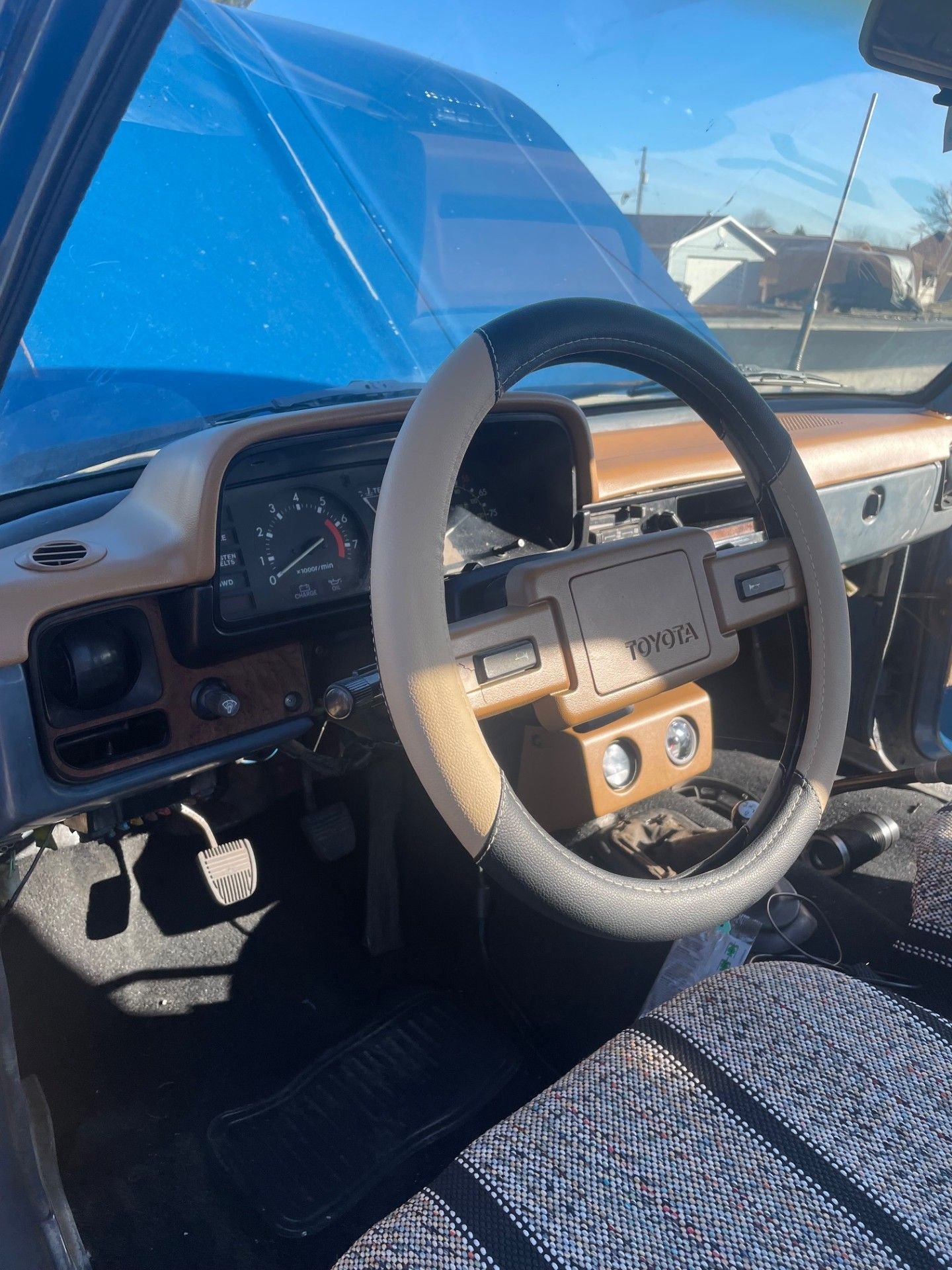

Here's what I pretty much started with on the interior.

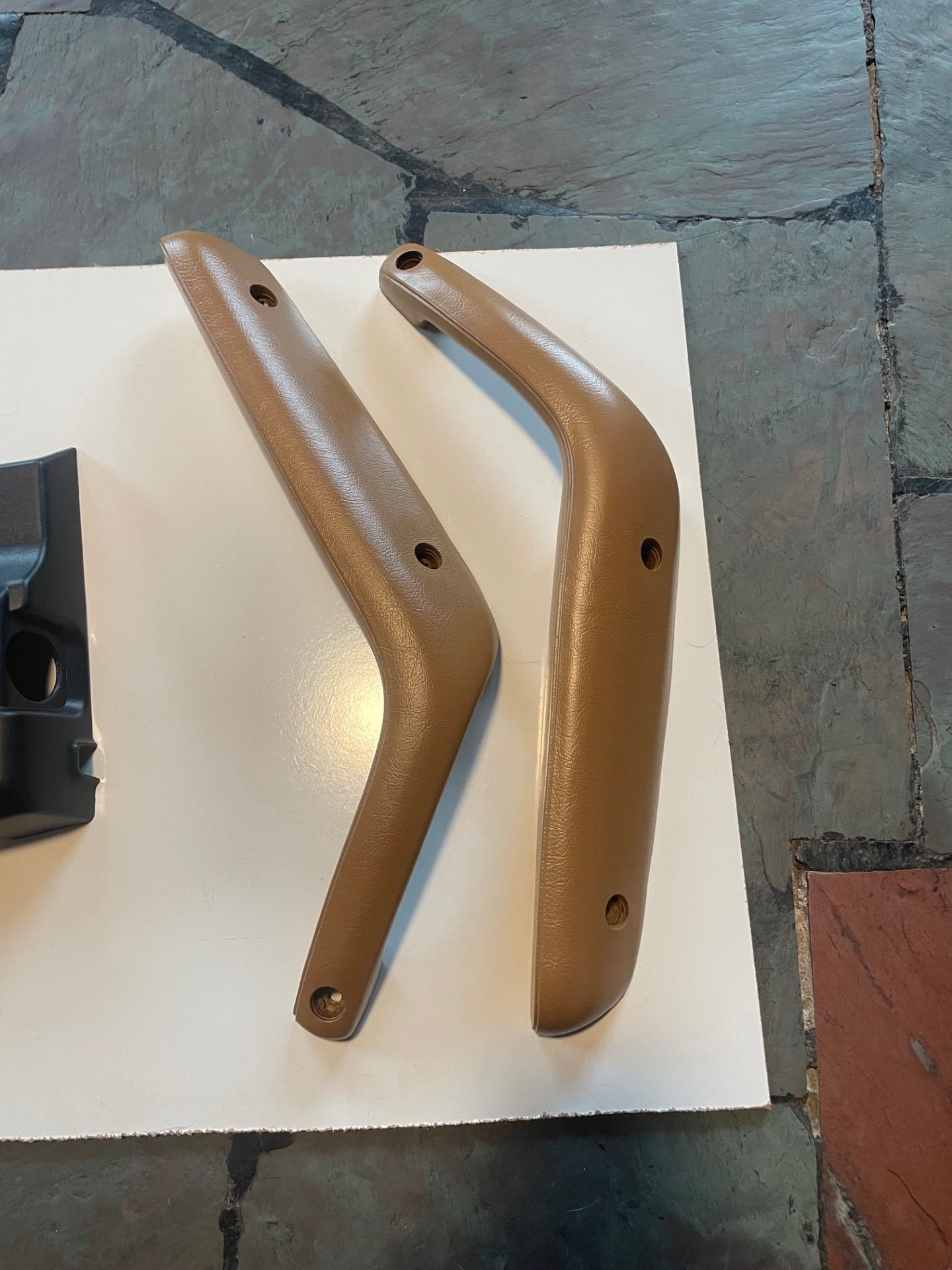

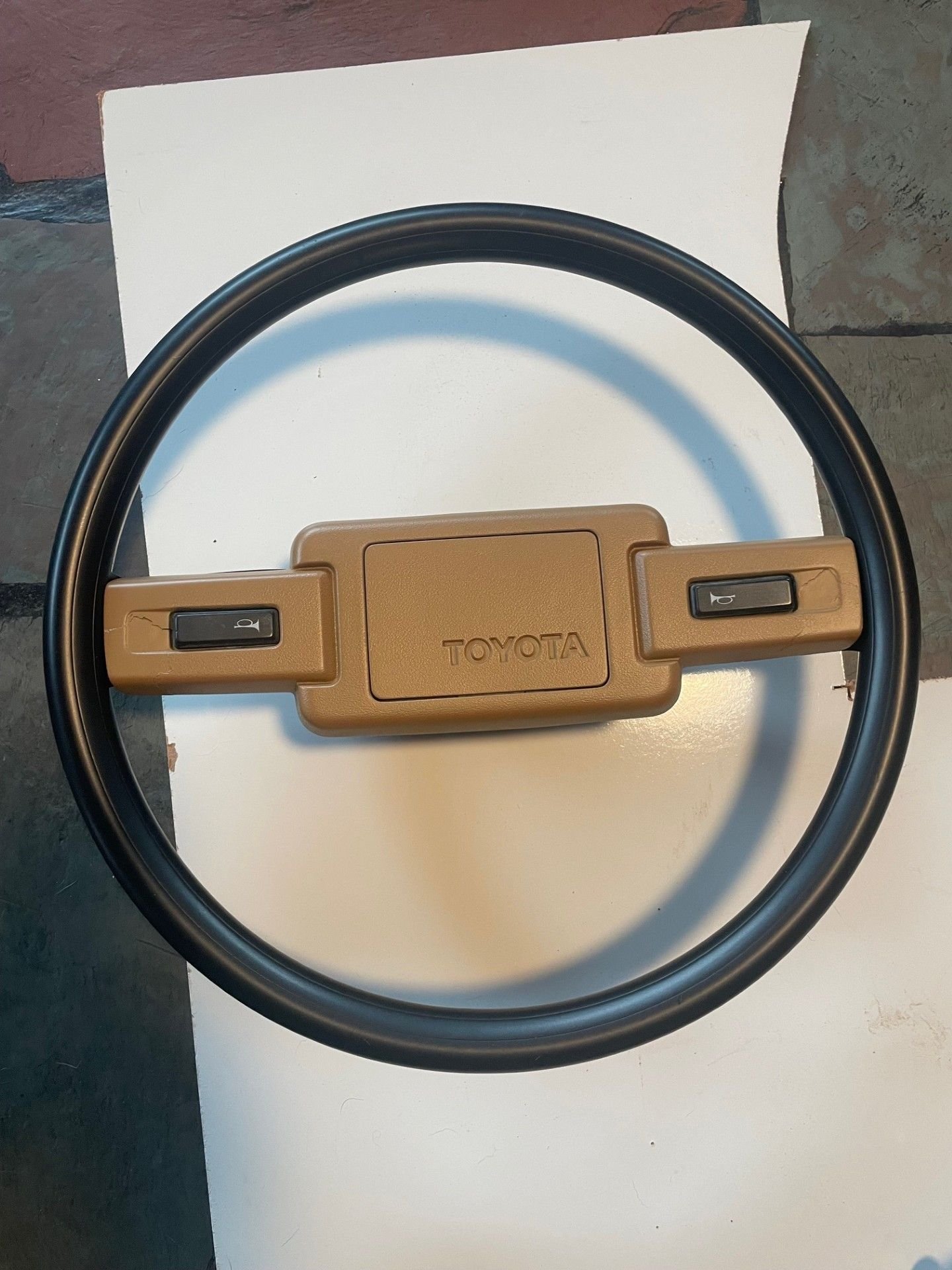

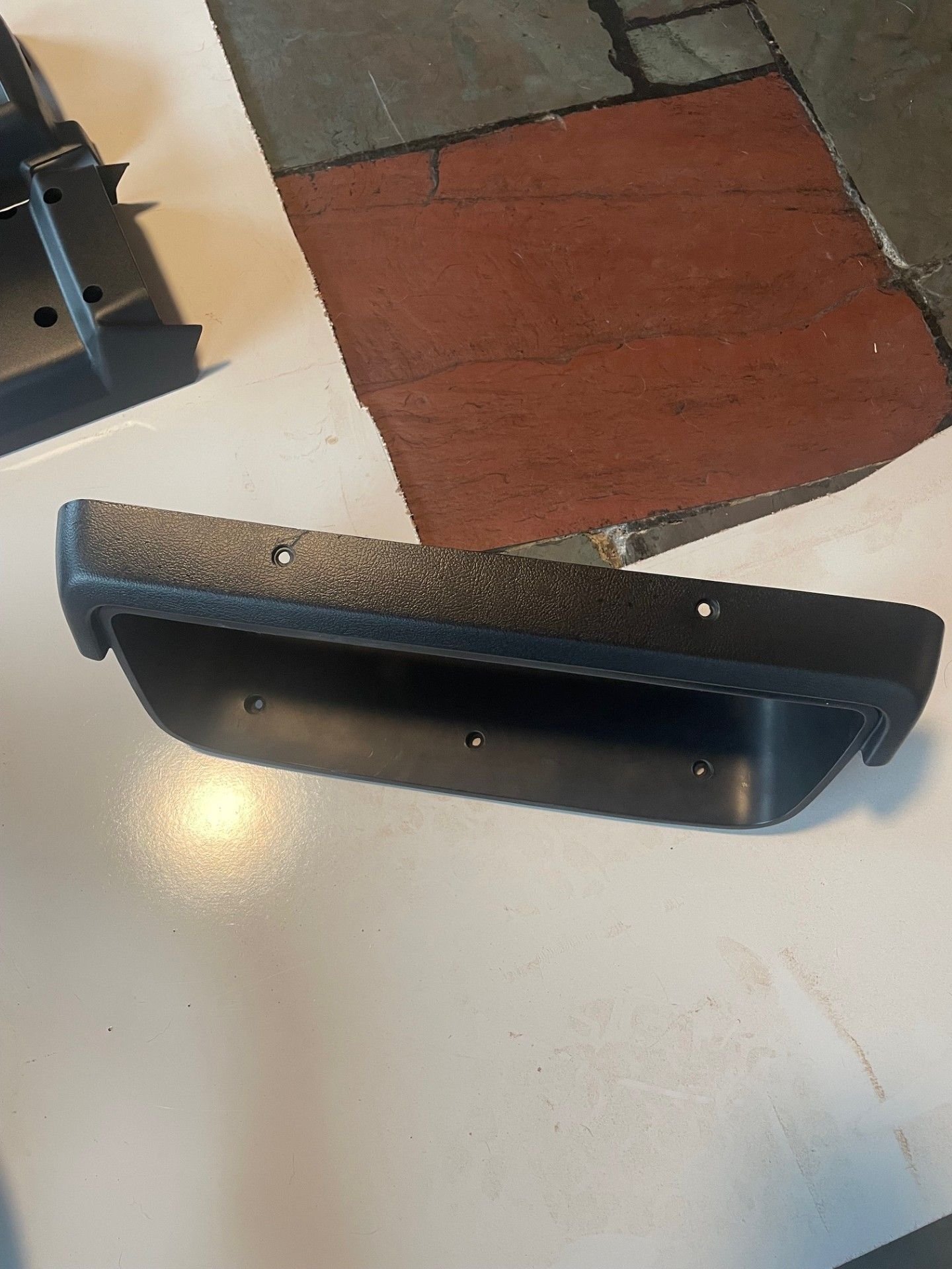

Got some used parts, cleaned them up and painted them with SEM Color Coat. That stuff is amazing. Also did my steering wheel.

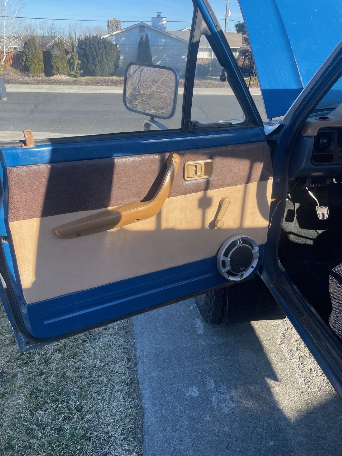

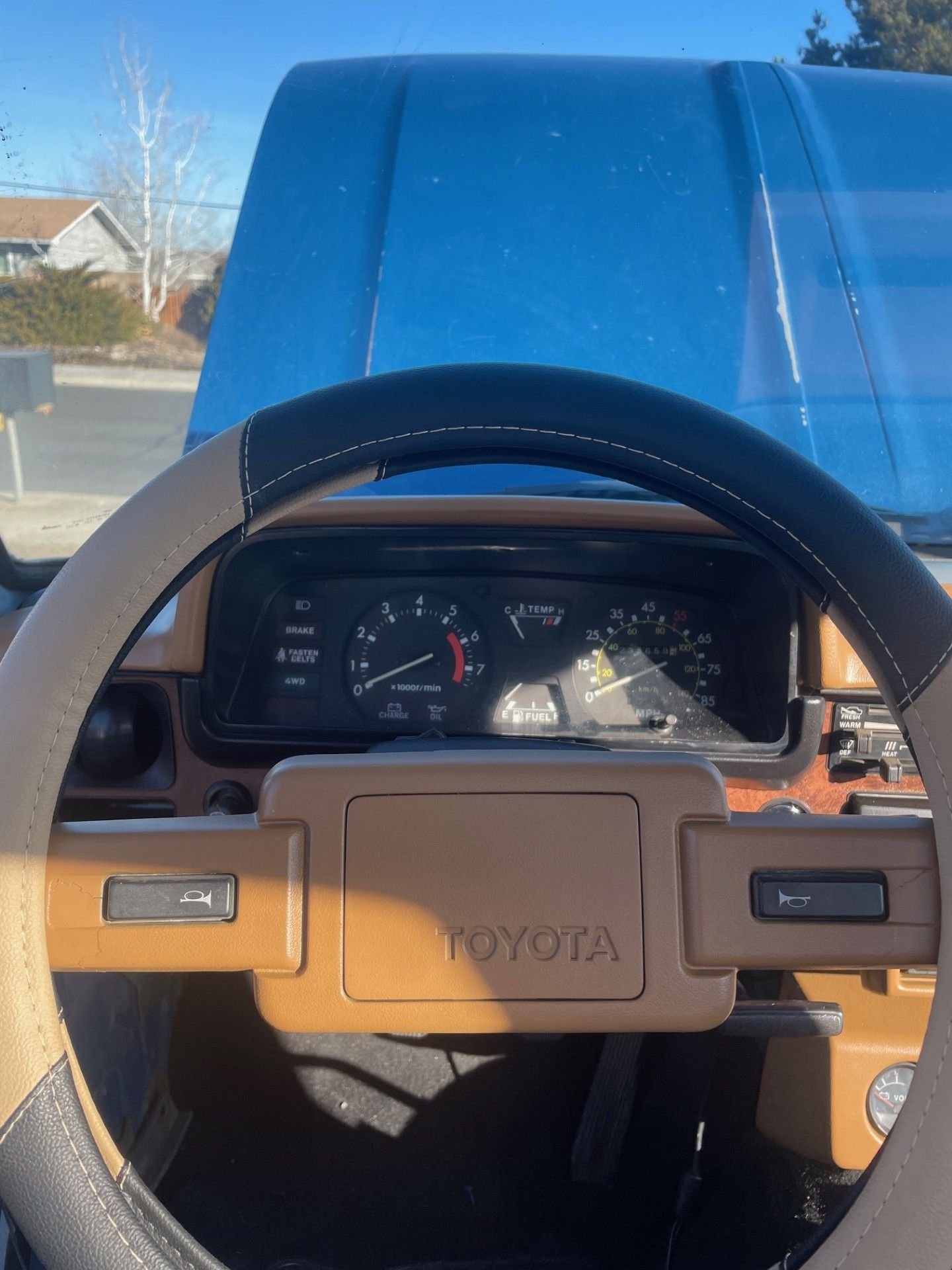

Here's where I am now on the interior. Next summer when I pull the cab to do some repairs, I will paint all interior painted surfaces black. Figured black, brown and blue would clash. It's getting there. Also, my fiberglassed dash developed a hump in it. What I started with was pretty bad so I may have let it get too thin or something. Scored a nice black dash with one small crack in the front. Repaired the crack, cleaned it up and painted it. It looks amazing and like new.
Also, I got a carpet kit from ACC. The fit is worse than terrible. I would not recomment it. I installed an ACC kit in my IROC. The fit wasn't great but it was way better than this. I will post in the tech section to see if anyone knows of a better fitting kit. That's all for now.
