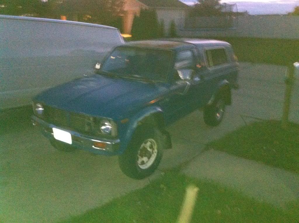

She left garage for the 87's transplant, funny....Terrys87 was there and we were all done with the 87...and he was like..."How you getting that up in the garage?" "Pushing it?" I was "Im driving it"
She smoked and sputtered, but she pulled her but up in there.
