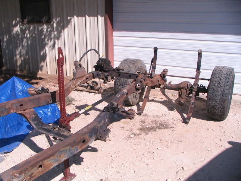

Finally got some more time to work on the beast. Pulled front axle and found a few problems I wasn't expecting.
Pulled
Busted shock tower
Where's the bushings
Glad I have time to go through this rig, don't need stuff like this going down the hiway @ 90mph. I wish

We got some time this last weekend to get the frame worked on. Welded the shock tower back on, rust proofed and painted satin black. I wish I had a bigger nozzle for my paint gun, as the Rust Bullet paint was drying to fast for us to brush nice and smooth. Oh well, its painted black. Next is to get the front axle cleaned and painted. My new bushings and greaseable hinge pins will be here tomorrow. Want to get it into a roller ASAP

Got the front axle put back under the frame, after installing OME greasable shackles and pins.
Been cleaning parts and painting the engine, installing accessories as they get ready. Want to move the alternator to the right side to take some of the clutter out of the left engine bay. Got to get the p/s pump reinstalled to figure out which pulley to use for the alternator and build the mounting bracket. As it sits right now.

Continuing on, Still drawing up alternator bracket, cleaning and painting parts.
Got p/s box and bracket cleaned up/painted and installed
Please, no hassles about my redneck paint booth. Got gas tank cleaned of peeling paint and shooting epoxy paint. Should hold up for a long time.

I see you have everything cleaned up real nice around the power steering system, did you need to put new seals in? I found one, finally, but the whole thing is really oily and I was wandering if I needed new seals and how big a job it is.
Old Nov 13, 2012 | 05:13 AM
  #40
Lons81's Avatar
Joined: Jan 2012
Posts: 711
Likes: 70
From: Stepheville, TX
Mine was pretty dirty before I removed it, found that both the pressure and cooler lines were slashed at one point and seeping oil onto the steering box. I would think that seal replacement would be fairly ease with the right tools. Maybe it could be pressure checked before installing
