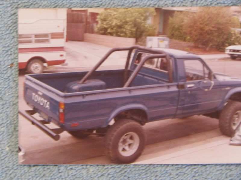

Hello All. Been wanting to start a rebuild thread on my '81 Toyota longbed, had to find some old pics that showed what it looked like back in its glory. I bought as a second owner in '85, so it has some of the old aftermarket axle trusses, dual rear shocks mount and other stuff on it that some are familiar with.
I was stolen from work one day, had tires/wheels, carb, battery, springs and shocks, custom
front/ rear bumper, roll bar and stereo system taken. Major bumper, but was found basically unharmed that insurance did fix. Through out its years it has traveled from San Diego to Texas, with no problems. I towed my '67 Cal Bug with ease coming across I10 to to its present location.
When one of my grandsons was living with us, before going into the Marines, he was interested to know some mechanic'ng, so it is a project for both of us to work on.
It hasn't moved for 5 years. Plans are to rebuild to a close stock condition with any new tech stuff throw in as needed. Ya'll know how hard it is to find stock parts, especially out here in the sticks.
Anyhow, here a pic from around '86 that I found.
