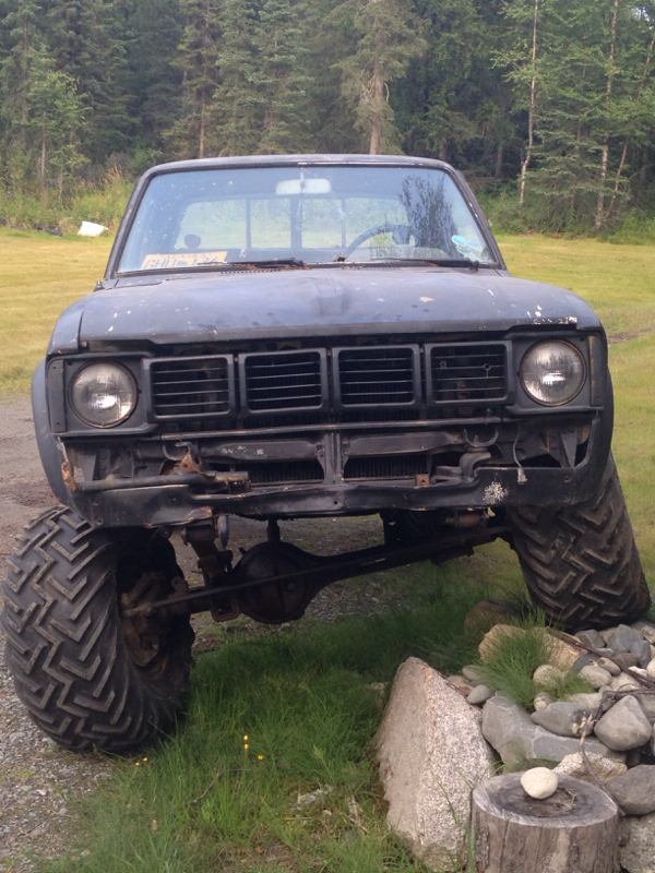

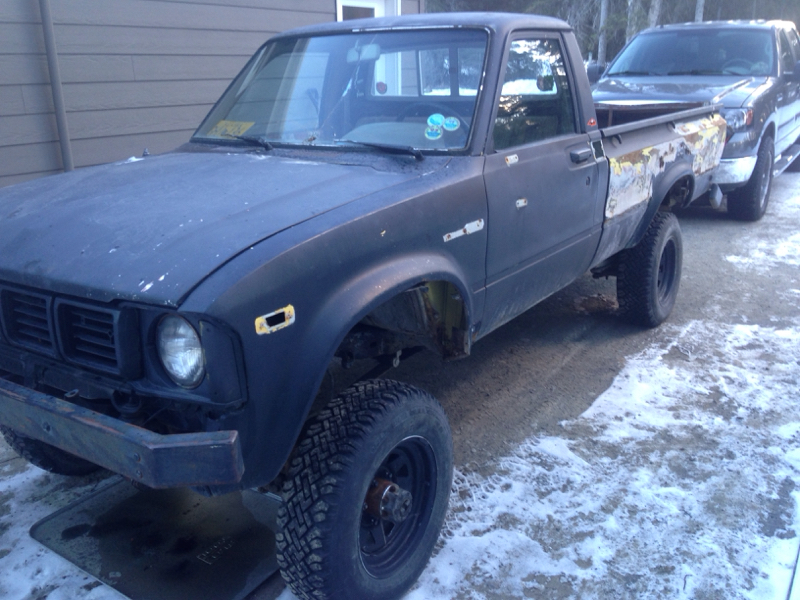

The day I picked it up

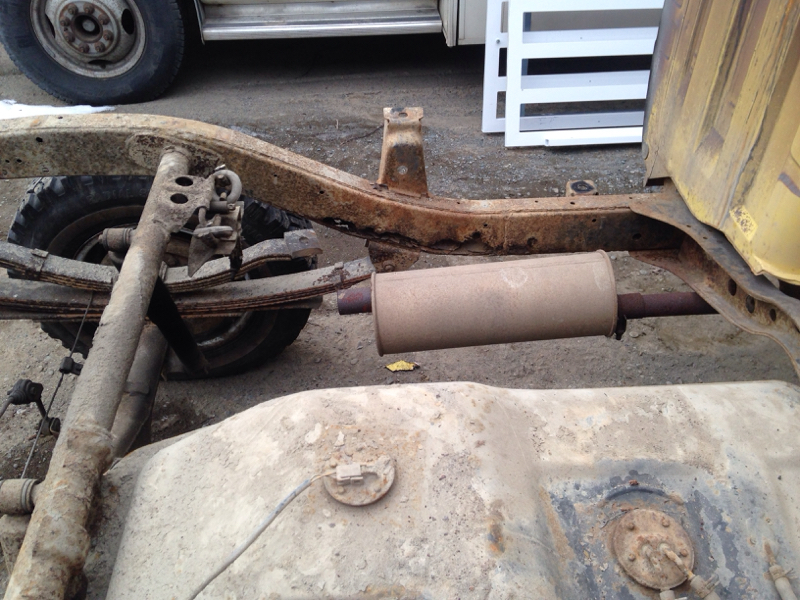

First thing I did was remove the bed to reveal the frame, found frame rot on the rails as soon as they come up from under the cab on both sides.

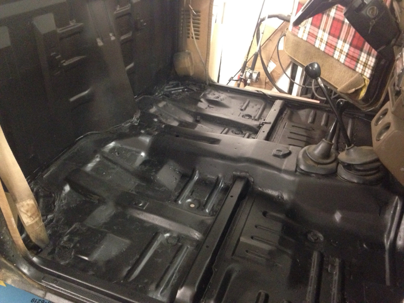

Next thing was to strip the cab and gut the old carpet and lay down some bed liner

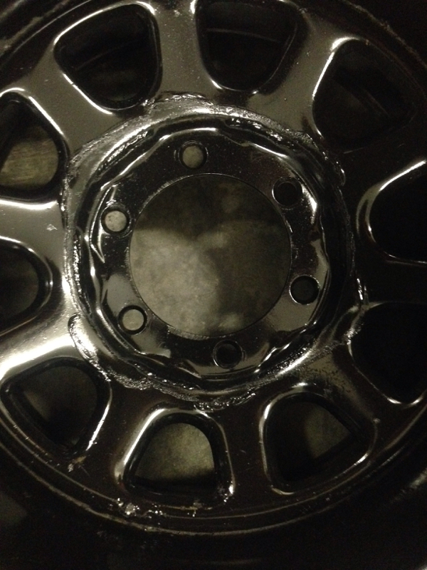

Picked up 5 31-15.50-15 terra tires and some jeep 15x10 wheels. I looked for months for yota wheels in the correct width but with out luck and being an anxious kid I purchased these and just fabricated my own wheels.
Worked out good no wobbles and are balanced, wasn't to worried about it knowing this rig is never going down the highway

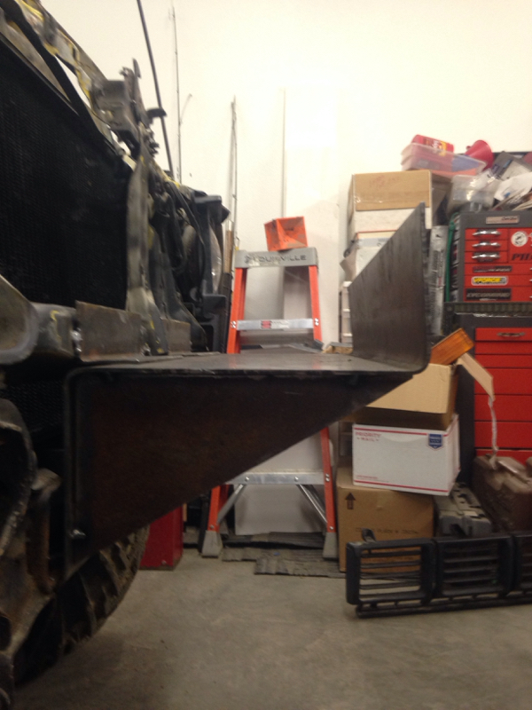

Ordered a 9500# xrc and built a winch plate out of 1/8" cold roll steel with 3/8" gussets. Eventually once I buy a pipe bender I will build the rest of my bumper off of the winch plate

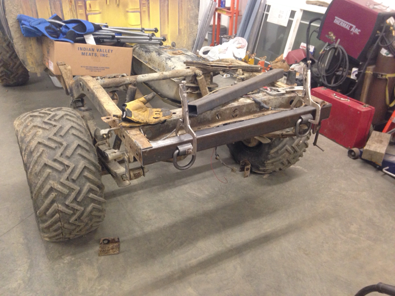

Finished the winch plate up and wanted to start the bed. The plan was to make a flatbed the same width as the cab in order to make it on most trails and not get hung up.
Chopped the frame 5" for clearance off of ledges and boxed it in with 3x2 1/8" wall steel with two d-rings for recovery hooks

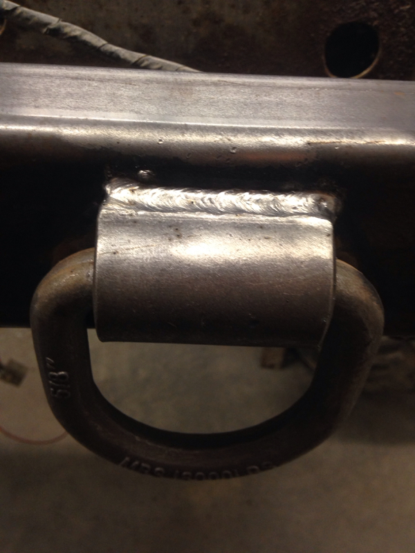

D-rings should hold welded them up with some 7018 instead of the mig

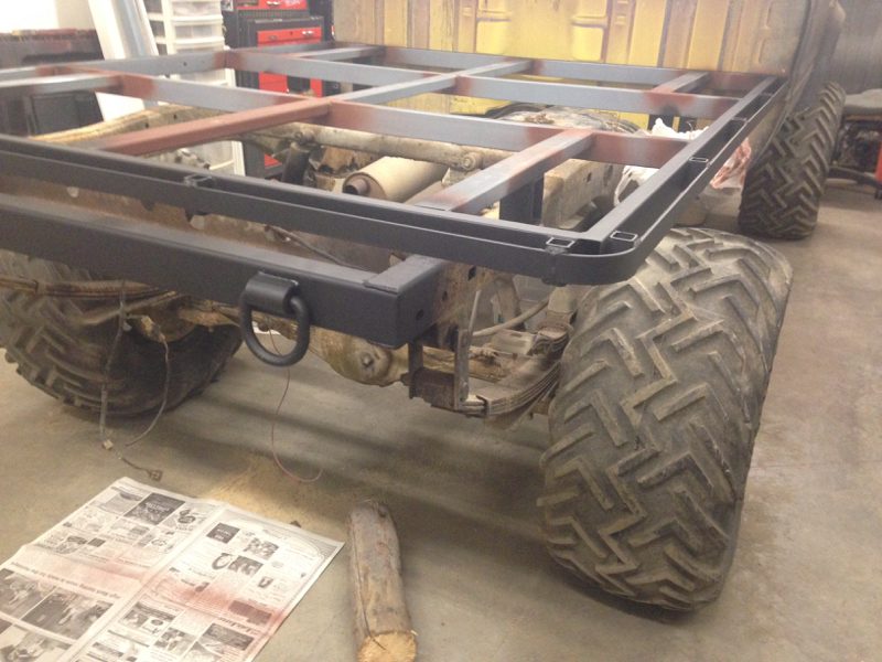

Built the actual frame of the bed 2" narrower because I welded on 1" rec around the perimeter and bent some flatbar around the rec for unlimited spots to strap coolers and gear on

Took the bed to a salvage company down the road along with one from an 81, one was pretty rough shape and original off the 79 was falling apart. Overall not to much rust some on front fender wells and the floor boards had some holes just riveted some sheet metal that I had left over from building trailers. Not a perfect solution to that but main purpose was to keep most of the mud and water from splashing up

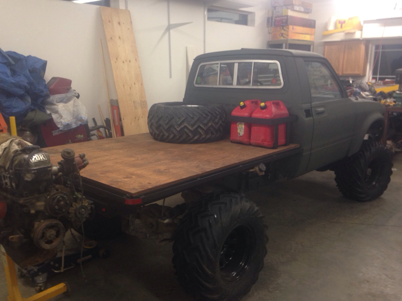

Decked the flat bed in some 3/4 plywood that I stained to help protect it from abuse

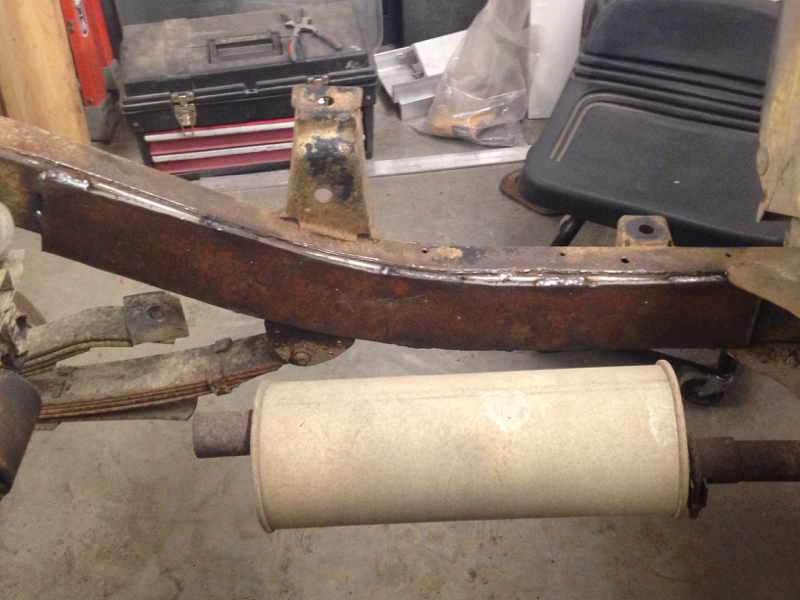

Tore the gas tank out and parched the frame with 3\8" plate and some 2" flat bar that I bent to fit bottom of frame

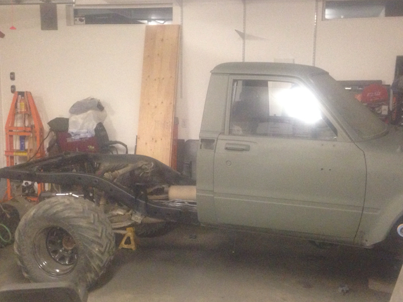

Got the frame welded back up and everything put back together. While I was in there I cleaned up the frame and painted the truck since previous owner did a crap rattle can paint job, didn't even tape anything off painted over blinkers, lights, etc..
