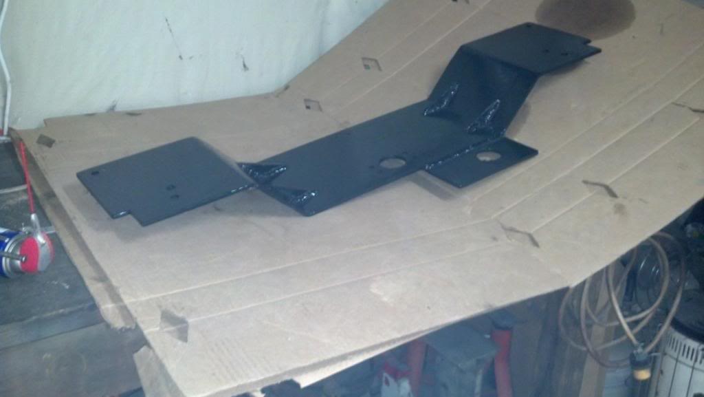

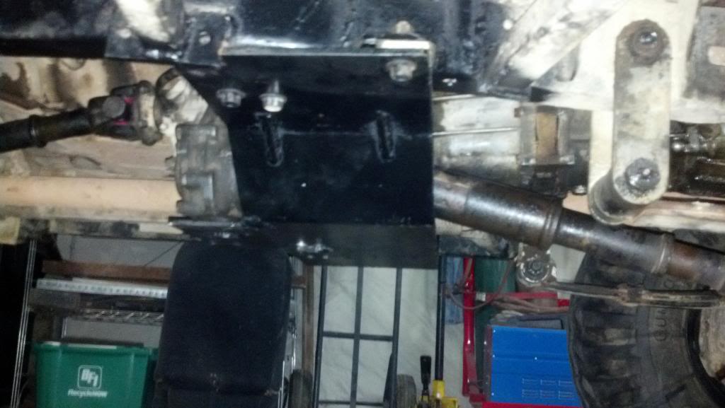

Been a while since I've had any thing to post....The transmission fiasco was a pain in the A$$....
I ended up putting a transmission from an 89 in. I had to shorten the rear shafts ( I have a spare ) and I used the front shaft from the 89..
I made a skidplate / crossmember..

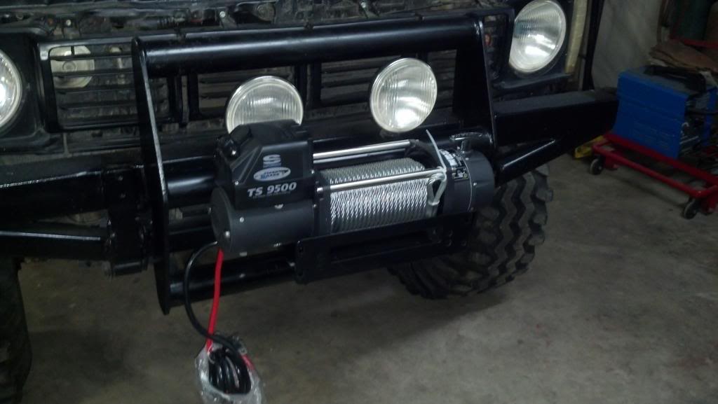

For Valentines day, I got myself a winch....
Front view.
Rear view.
I put it on a receiver mount so I can use it off my Tocoma & the tractor...

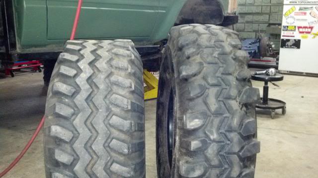

Early B-day present...........Love craigslist, $950 for damn near new 12.50x36 Swampers.....
Compare to the 14x35 Gumbos.........
I sure hope these ride better....lol

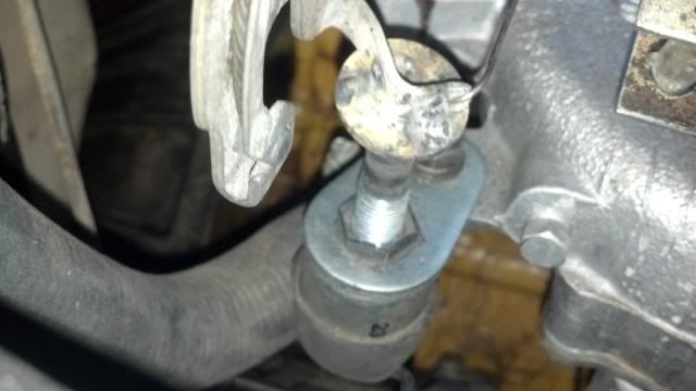

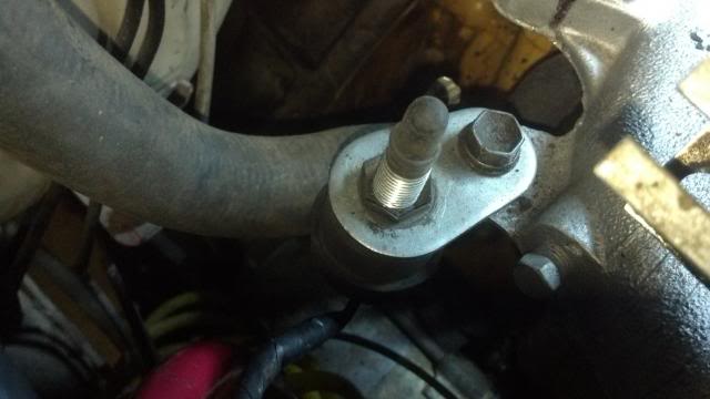

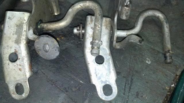

I need a way to idle the truck up while winching, so I did a little Yodarigging.....
Stole a high idle switch off my buddies Heep....I know, I know, but they are good for some things...I used a bracket from Lord knows where, but it worked perfect...
There was no where on the Weber ot the linkage for the switch to hit, so I welded a washer to an extra linkage I had.....That way if I fudged it up, I still had a good linkage.
The modded linkage on the left...
On the truck....Holds the idle @ 2100rpm...With the flip of a switch..
Opinons?

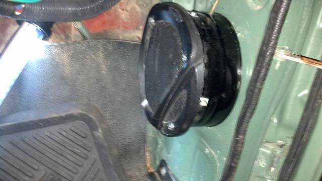

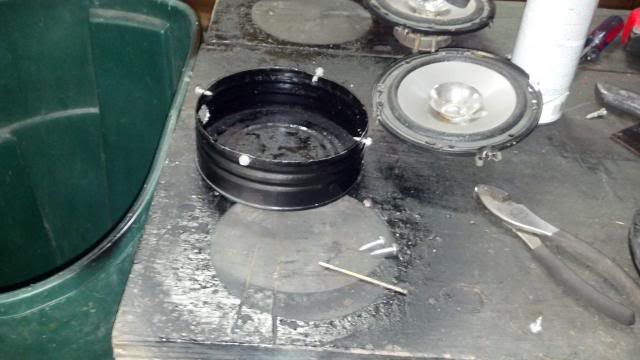

SUMMER is coming (someday)....So its time to take the doors OFF...I had to figure out what to do with the door speakers, so I made some speaker boxes (cans).
The cans cut down...
The can mounted to the kick panel...
And the speaker installed...
Now if it will just get warm & quit raining so damn much.....

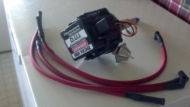

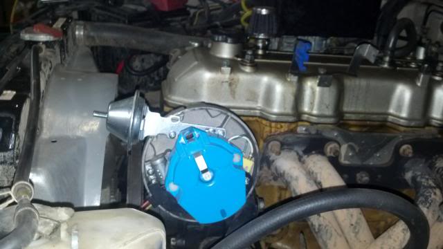

Another Craigslist find......
In the truck.
I had to yodarig a hold down, made this from an old shifter linkage..
All done & ready for a test run..
OMF'N GAWD....Talk about waking up a 22R...Man what a difference...

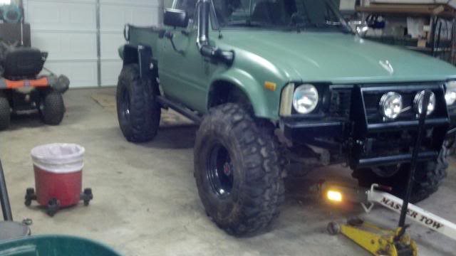

A couple of poser shots with the new 36's

I just looked up that distributor and now I'm super jealous! Is it really as good as it supposed to be?
