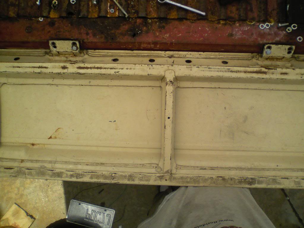

as the beastie boys once said, ch-che-ch-che-che-check it out!

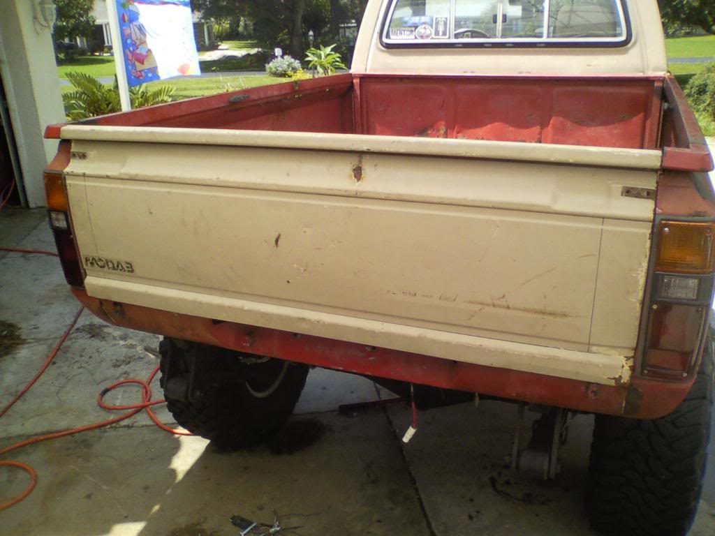

new(used) rust free tailgate.
Big ups to the previous owner who has been hooking me up with all of these bitchin parts for his old truck
being that it is a two-latch gate, and I have a center handle bed, it didnt fit as good as it should, and there had to be spacers made for it. (will post those pics tomorrow)

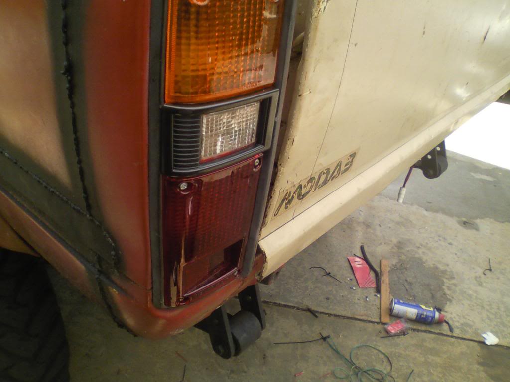

Did you guys know that you can buy new taillight lenses from autozone?

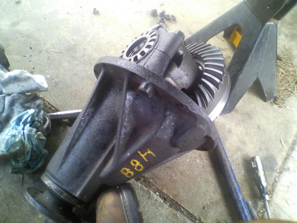

The previous owner gave me a 3rd member with 4.88's and a locker, so I went about trying to install them.
Here's the new 3rd member, looks alot different than the one that is already in my axle.
it was so different in fact, that the shiny thing the ring gear is mounted to^^^^^was rubbing on the axle housing right next to the cutouts in the housing. It wasn't able to be installed without some grinding work for clearance.
So I got the 3rd member in there, all excited about driving around without 5th gear feeling like 3rd, and....the driveshaft bolts dont line up.
I got somewhere I gotta be tomorrow, so I had no other choice but to re-install the 5.29's.
Now I gotta find a new u-joint half that will fit the 3rd member, because I am assuming that you cant change pinion flanges without screwing up some sort of preload/pressfit/clearance/tolerance/crush sleeve/rear axle spells/gear oil voodoo...whatever the heck would happen with those mysterious gears that you need a masters in axles to understand.
I can change u joints easy, now I just gotta find an end that will fit my axle.
Any ideas what style of 3rd member I have from that picture? I have no idea what truck it came out of.

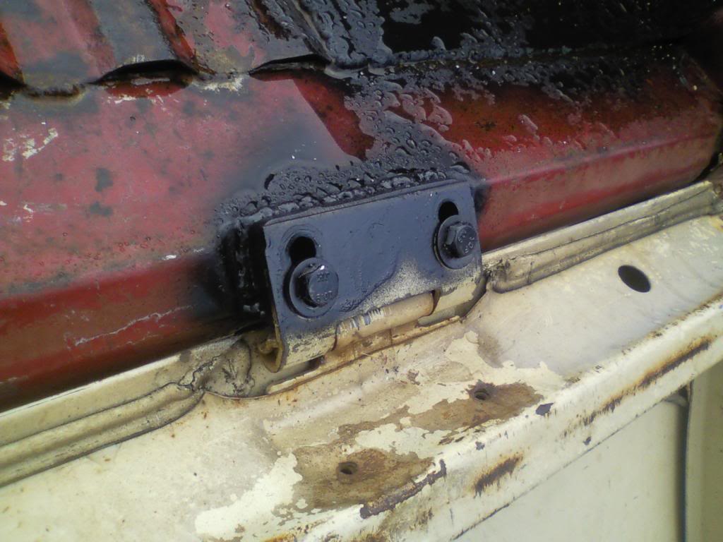

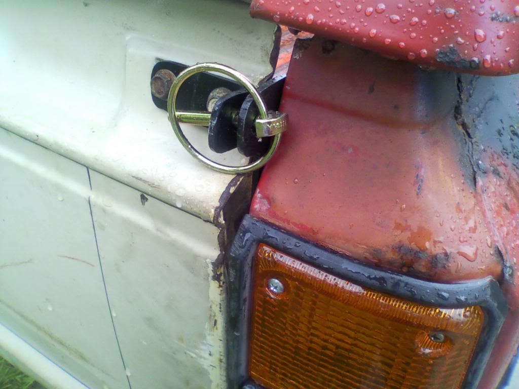

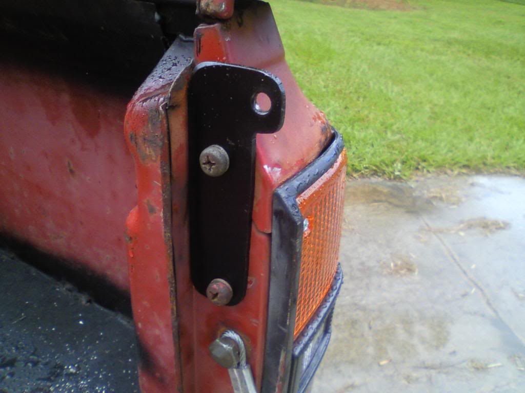

but eh, it works better than no tailgate
hinge with 3/4" spacer
and the latch system
#45
tail gate is absolutly from 84-88 (2nd gen truck) import , with side latches .. but great work getting it on .. your right .. better then no gate !!

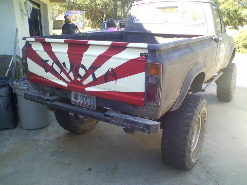

OOOOOHHH JEEEEZ I've neglected this build thread, startin school again really doesnt gimme time to work on my truck.
I have made some decent progress though,

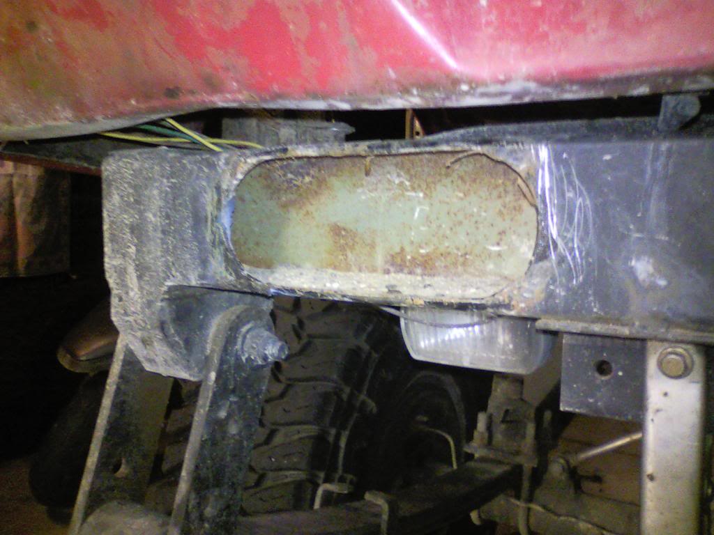

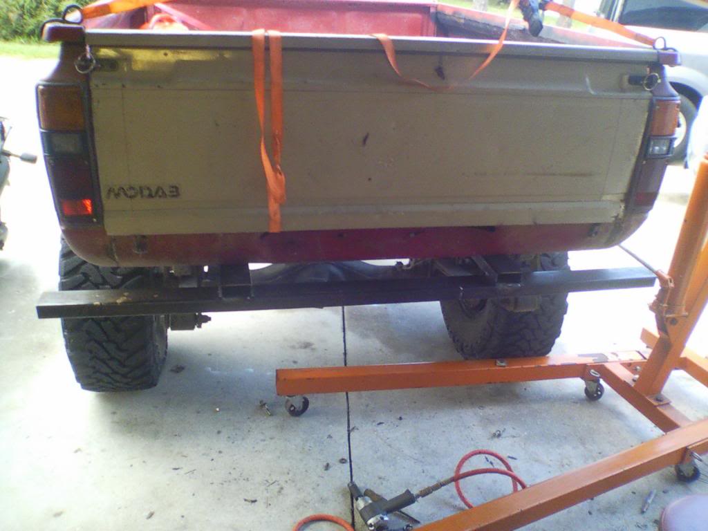

First, I made a rear bumper for it.

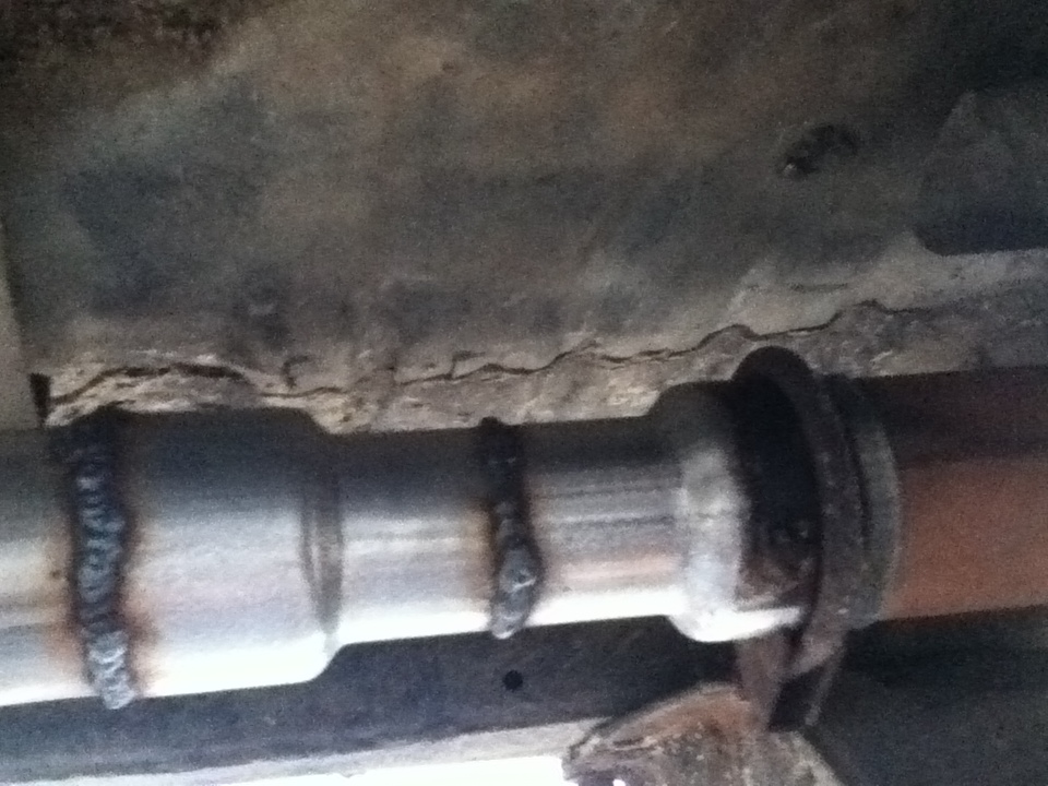

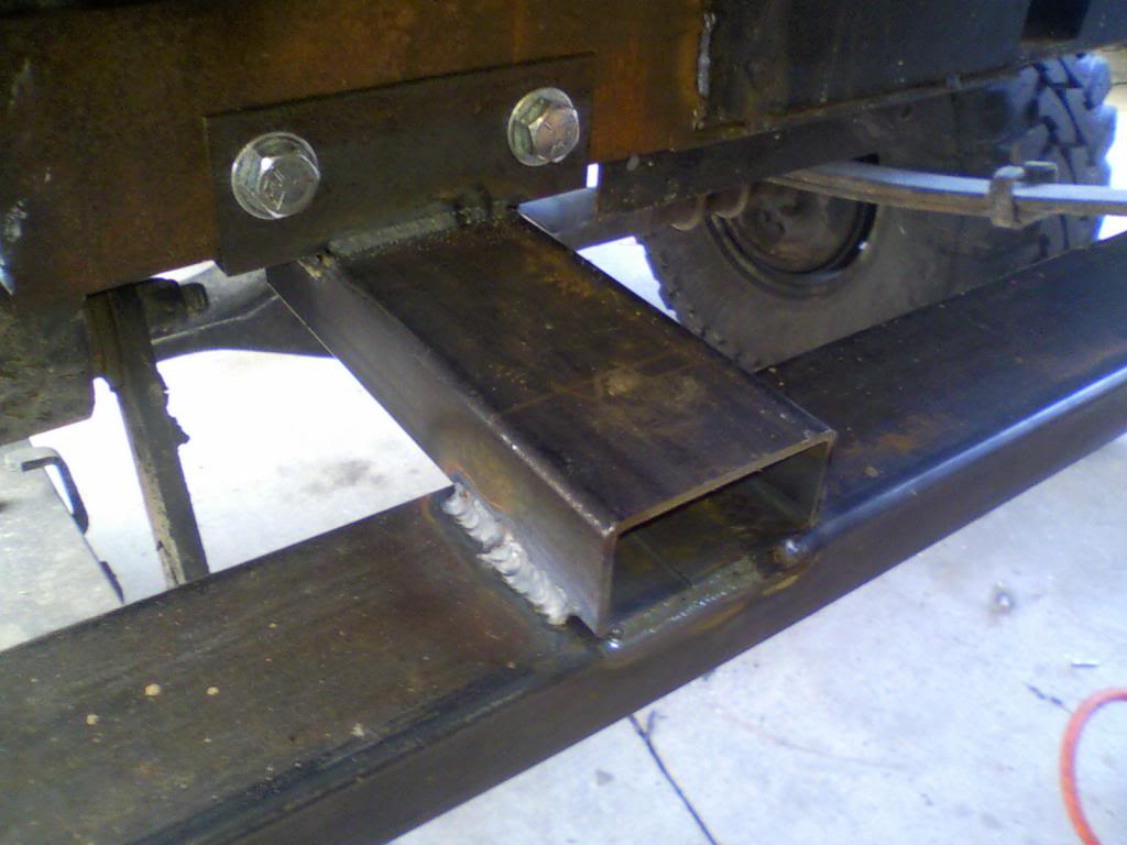

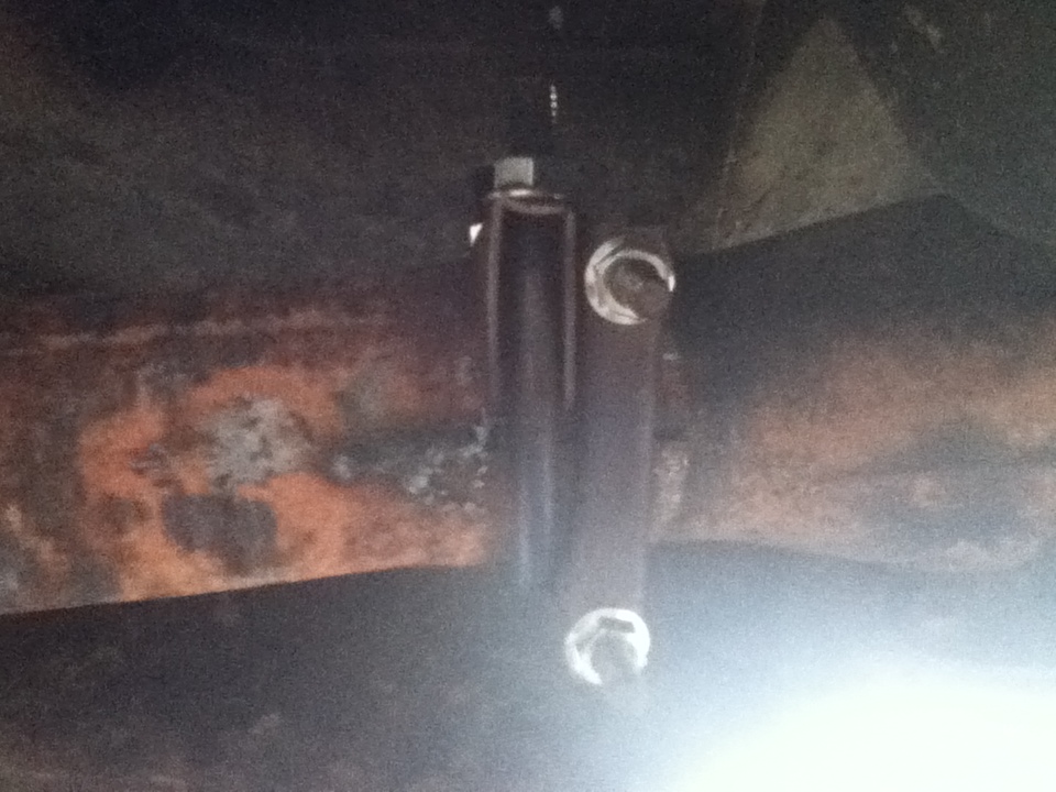

Here's a picture of the frame section I attached the bumper to, it had holes in it from lights.
I can't run bolts through light holes, so I welded on some plate right over it.
sorry for the blurriness, but you get the point

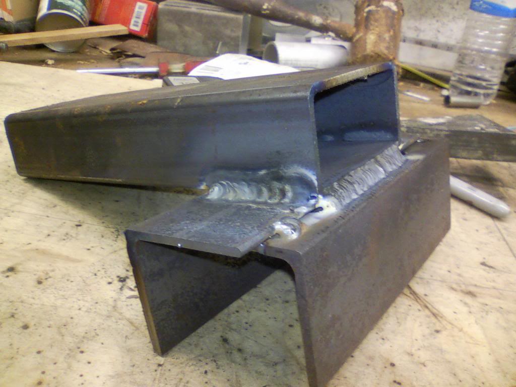

Then it was time to get out the TIG and weld up some brackets
Drilled some holes, mounted up the main part of the bumper..

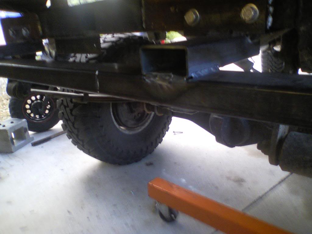

All mounted up

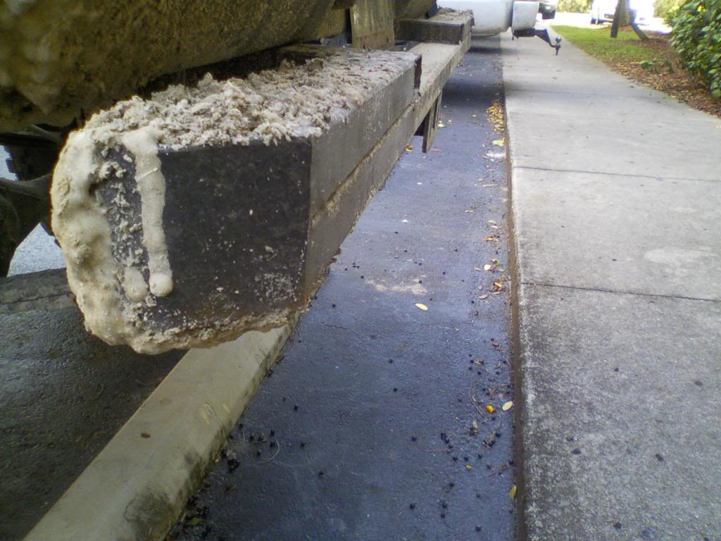

This is it with the bed lowered back down, I also added another 1.5x3 on top of the metal you see here to make the bumper more beefy.

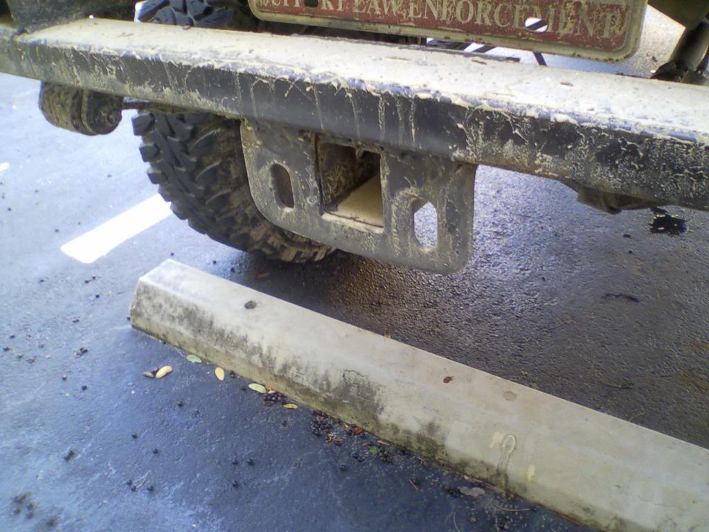

Welded on a hitch as well, it came as this neat little self contained thing with the safety chain holes and everything.

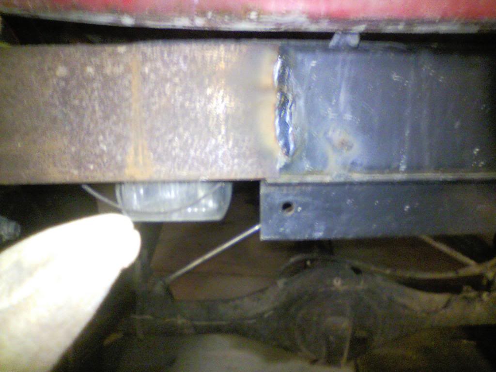

Also cut the bumper down, folded some metal over the ends to make it look nicer. You can see the extra metal I added to the bumper here as well.
I still plan to add more to the bumper, some slanted pieces to "frame" the license plate, in between the main support bars and the main bottom piece of the bumper, as well as some D-rings.

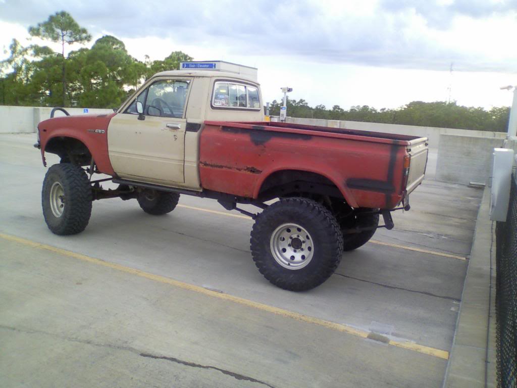

I did some paint work as well,
Black primer for now while I am fixing the rust
31 was my racing number, and I feel it helps out alot when trying to race people at lights...
got the idea for the tailgate from another post I had seen somewhere (here or pirate).
You can see the bumper pretty good here as well, I also plan on putting white led's in the two rectangular holes for backup lights.
All mounted up

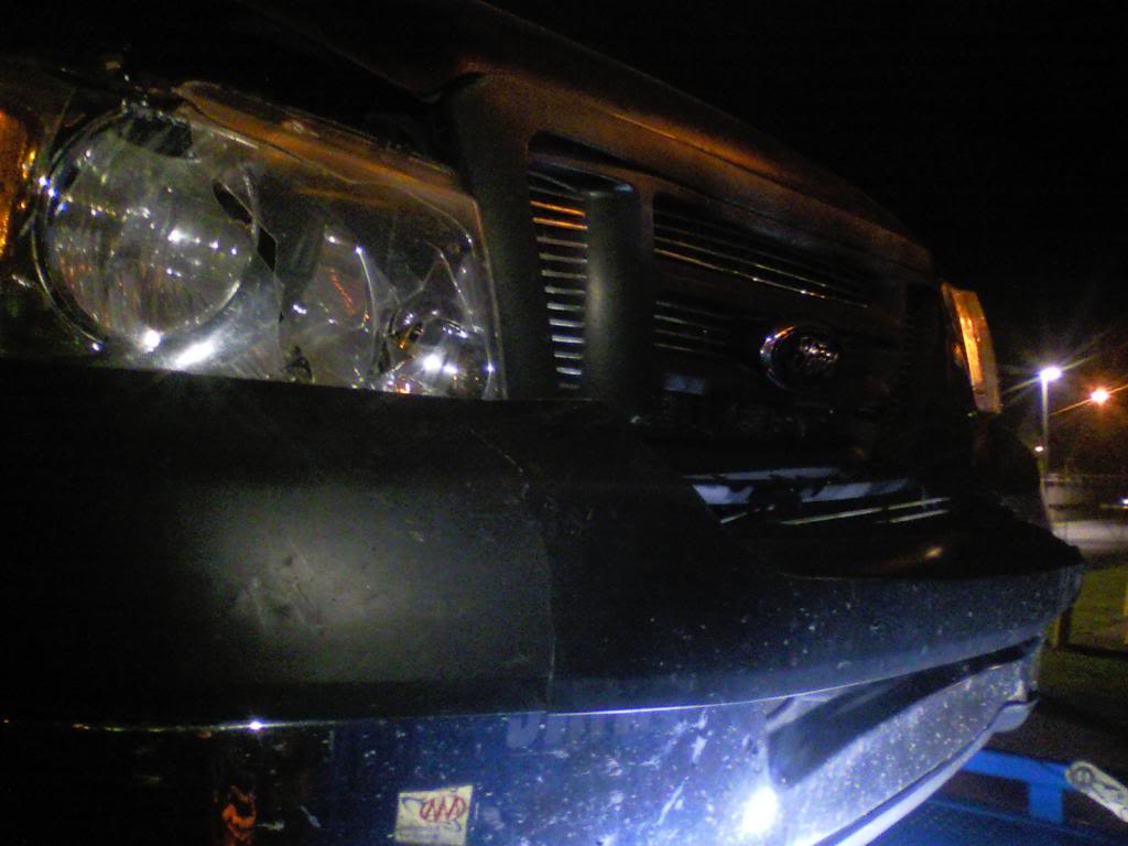

Oh! also forgot to add that I got in a little accident with it.
I was sitting at a stopsign, and a texting idiot smashed into me at about 15mph.
He was driving a 2wd f150 which from what I could see needed
-new hood (his was taco'd)
-new grille/emblem
-new radiator
-new a/c radiator/condenser
-2 new headlights
-new bumper cover
-new bumper
-new radiator core support/crossmember
-new horns
-new hood latch mechanism
My truck has a slightly bent bumper, a little dent in the tailgate, and a small area where the paint was scraped off. (rattlecanned it, good as new)
The only pic I have from that ridiculous and stupid night...

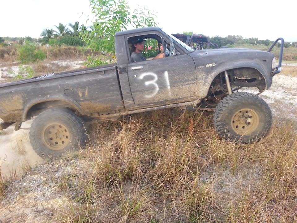

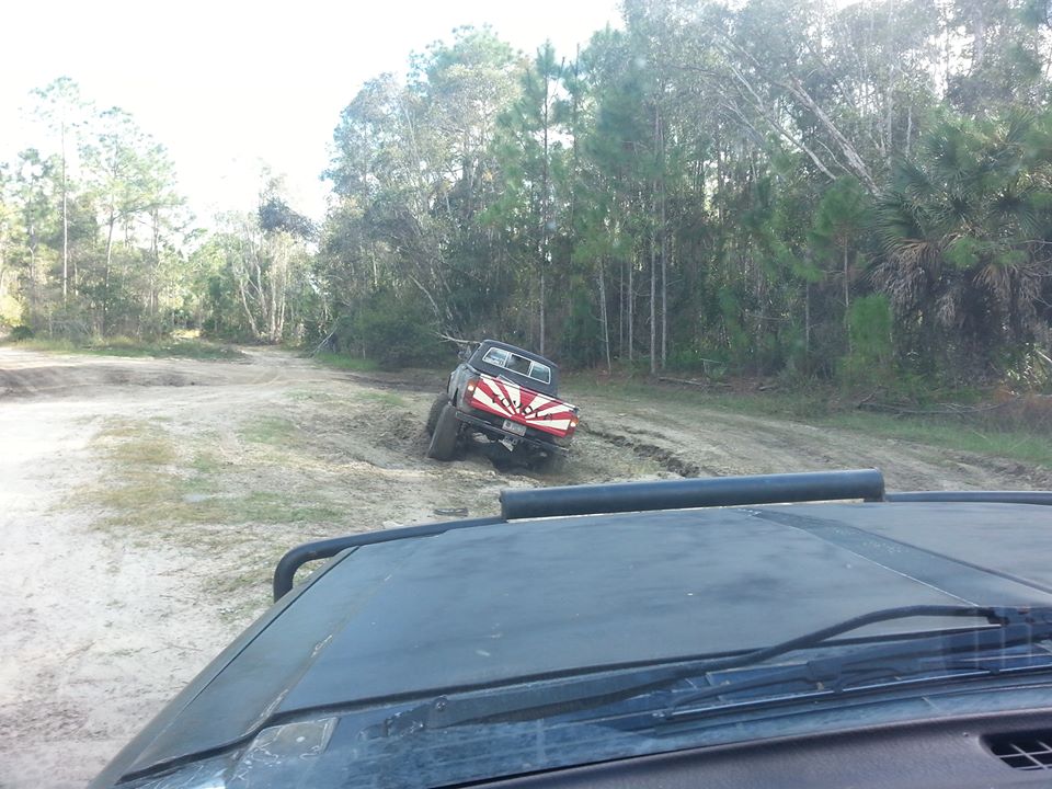

I've joined a couple of the local jeep groups and done quite a few wheeling days with my truck.
Even with only 2wd, it outperforms ALL the grand cherokees, some of the cherokees, and a few wrandanglers.
Barely made it through this one
And a video of the same hole

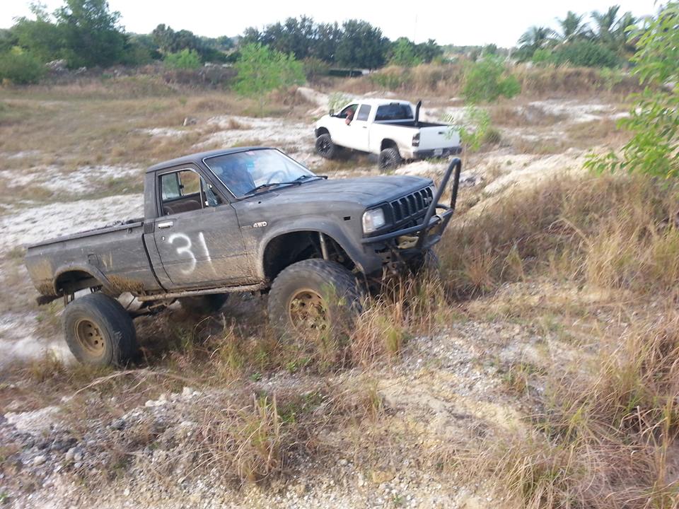

It may be a jeep, but these things look awesome lifted a little bit, and the old AMC I6 is a pretty peppy and somewhat indestructible motor.
Too bad they are unibody though...
Sweet little climbing spot
And some cool action shots of a hill being conquered

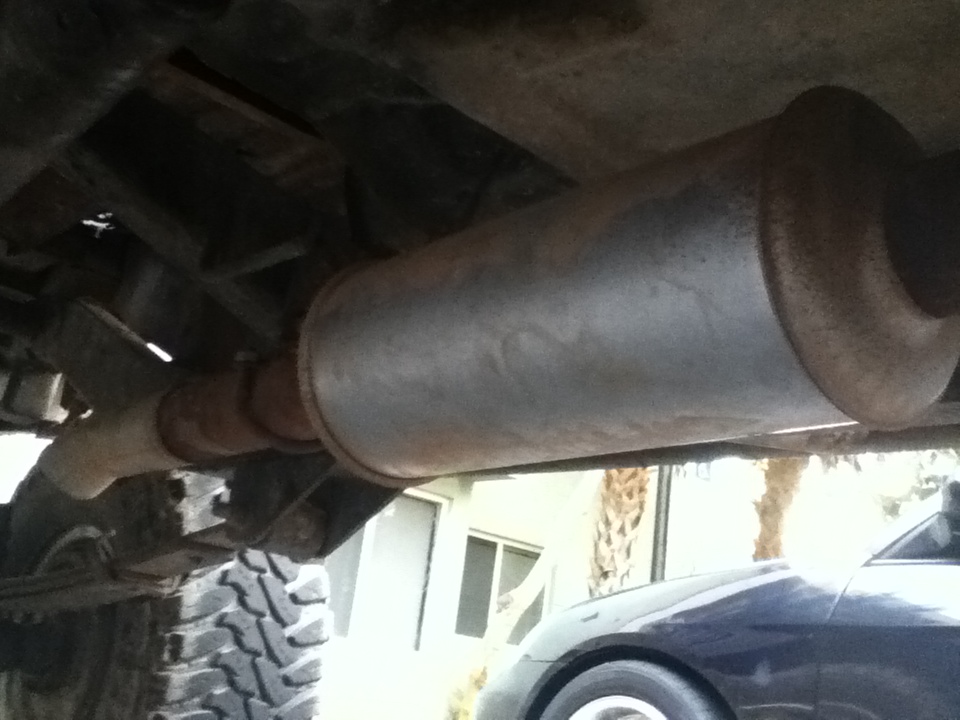

Here is the exhaust Step down, it goes from 2.5 to 2 to 2.5 again, I think I have a little bit more torque now, though it is hard to tell.
And here is where the collector and exhaust system connect. It is hard to tell by the picture, but there is a cut where I had to cut it to remove the pipe. And it is leaking pretty good, so I put 2 clamps on it, but it is still leaking enough where I can hear the ticking.
And the rest of the system
