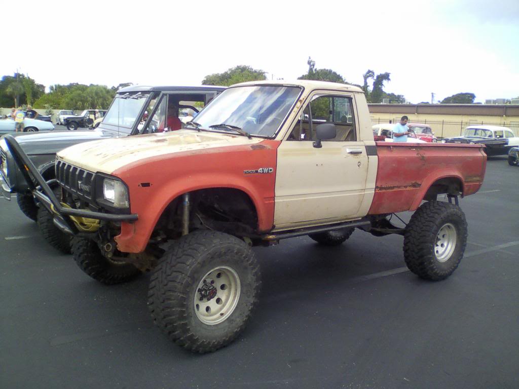

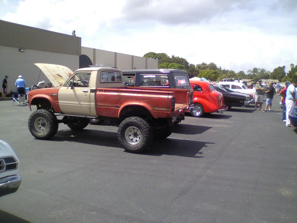

My buddy and I decided to crash a car show this morning.
Well, he didnt really crash it, his truck could actually belong there.
got some disapproving looks for sure from all of the american muscle purists, but the rest of the people there got a kick out of it.

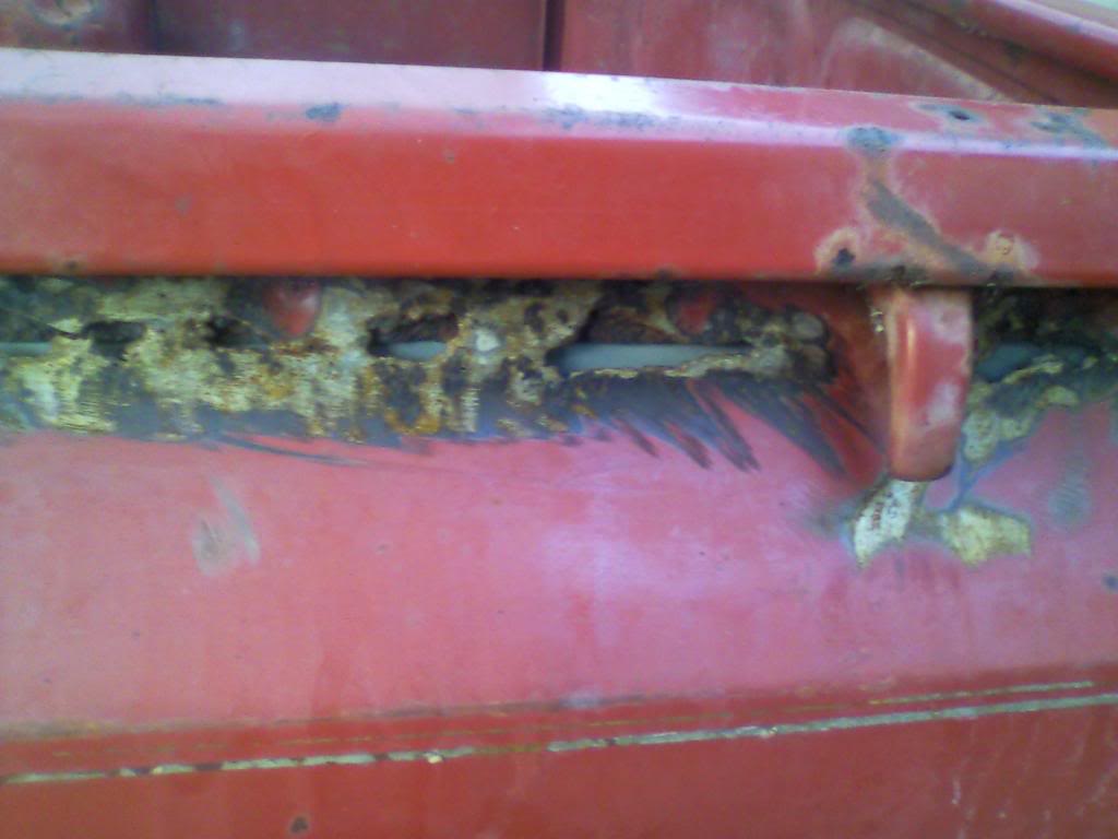

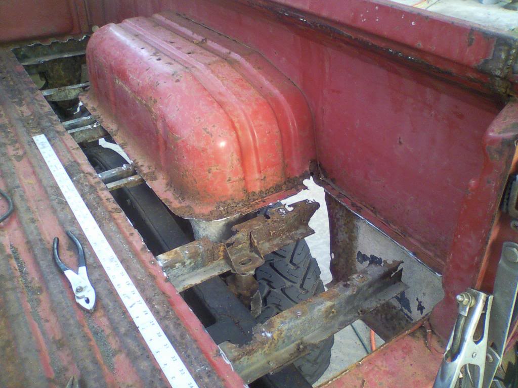

More rust repair on the bed today, mostly cutting and un-spotwelding.
took the paint off of the bad stuff around the rails, made patch panels to go behind the rust, and I will be bondo-ing over the rust on the outside.

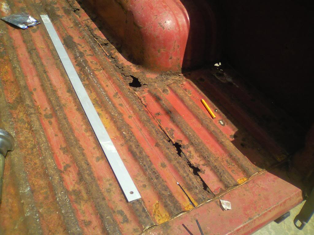

Then there was this mess, it gets worse the closer you get to the cab, but I am lacking pictures of it.
The center of the bed is pretty good, its just the sides that are terrible, so I decided to leave the center, and will only be replacing the sides.
Those cross-supports are getting new metal welded onto them, and have already been treated to the rust-converter and rustoleum.
lots more pictures tomorrow as I weld in the replacement panels.

I'm also sure this is common knowledge, but I discovered today that a pointed tip on an air chisel will smash out/cut out the spotweld from the top. I went from tearing up the bed supports trying to chisel inbetween the panels to leaving small holes where the weld used to be.

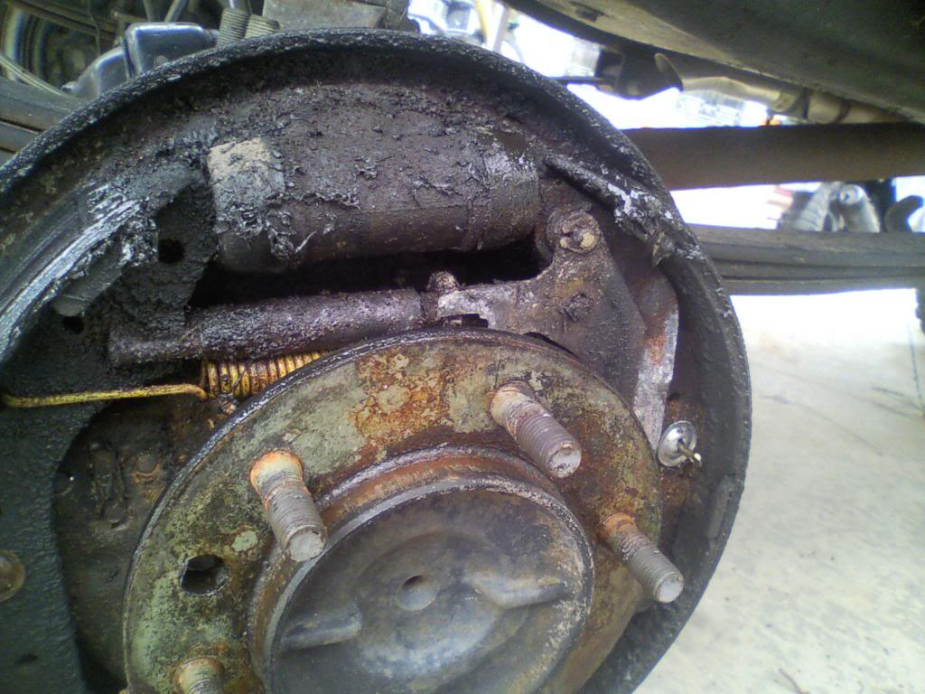

Hey craftsmanracer, why do your brakes suck harder than an Oreck?
oh, I dunno, why don't I go check my brakes over...
master cylinder is low on fluid, wonder where it went?
Oh, lol that's where the fluid went.
And this is where it spewed from

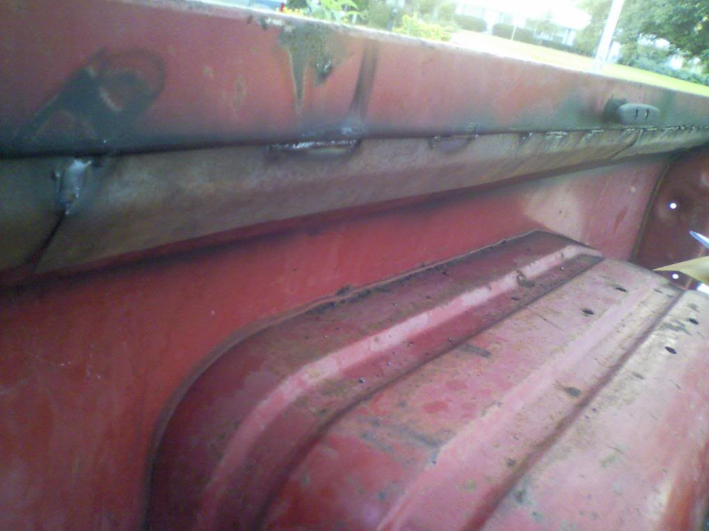

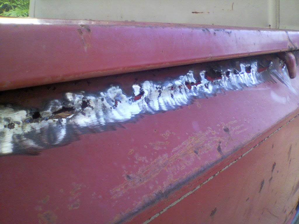

fixed that today, and did a little bit more work on the bed,
welded metal to the inside of the rails
so that I can stuff it up with bondo later (notice the grey primer shining through)
