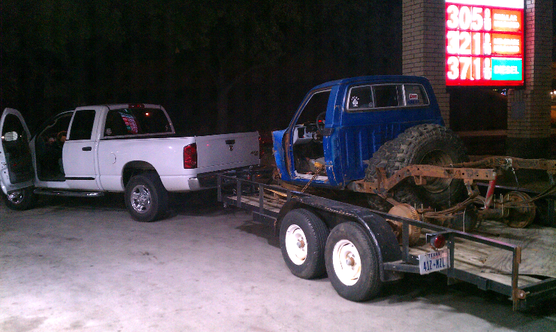

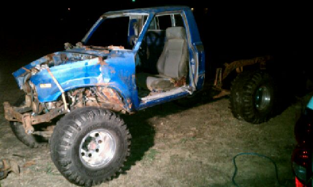

Hey all. Just thought I would post up on here. I recently acquired a 1980 single cab. My plan is to turn it into a crawler. It is pretty rough at the moment. All the truck had was motor, tranny, transfer case, axles and tires.
When I picked the truck up it had a 20r motor that was locked up. I have replace that with a 1978 20r which I am still trying to get running. Both axles have to be rebuilt also.
I plan on doing hydraulic steering, 4 link front and back, converting it to run on propane, and building a full cage. But, for the sake of time and money all this may have to be done gradually. Especially since we have a 4 wheel trip planned for this March. I will post pics as I do things. Any tips, tricks, advice, or just plain comments are welcome. Wish me luck!

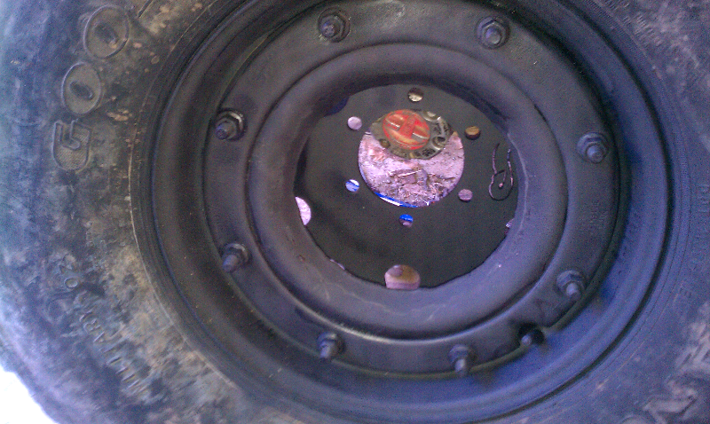

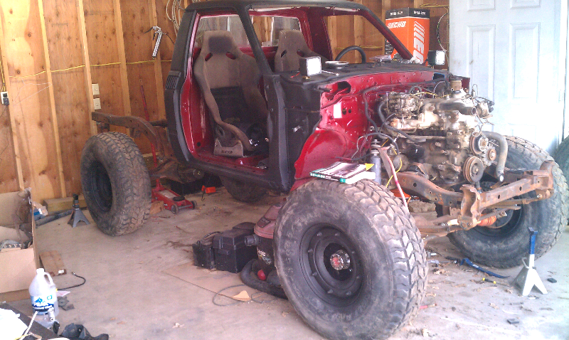

Alright so finally have some stuff mounted up and with a week and a half before this thing is supposed to hit the trail I still have a lot of work to do. But I got seats mounted, recentered 16.5 beadlockers woth military 37's all the way around, h3 lights and new calipers, and new Yukon 4.11 gears in the rear.
