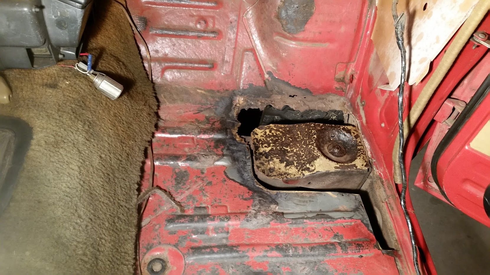

Floor Damage
So Far...bed comes off again this summer and full paint job to follow.

81, had it a couple of years. It had lots of rot in the windshield flange and the pillars. Found a donor cab and the seller let me cut it up on his site rather than having to haul it home and deal with the carcass at my house. Still have little leak at around the new windshield gasket, I don't think the place did it correctly. I have to pull the windshield again to do the headliner, so we'll make sure it gets seated next time. Is there a caulk or sealer I can use with the gasket?
Anyway, fixed the pillars, windshield flange, and floor. Painted the cab (1st time spaying). I've welded before in a previous job, but never did autobody repairs, so I got sills to develop for sure.
