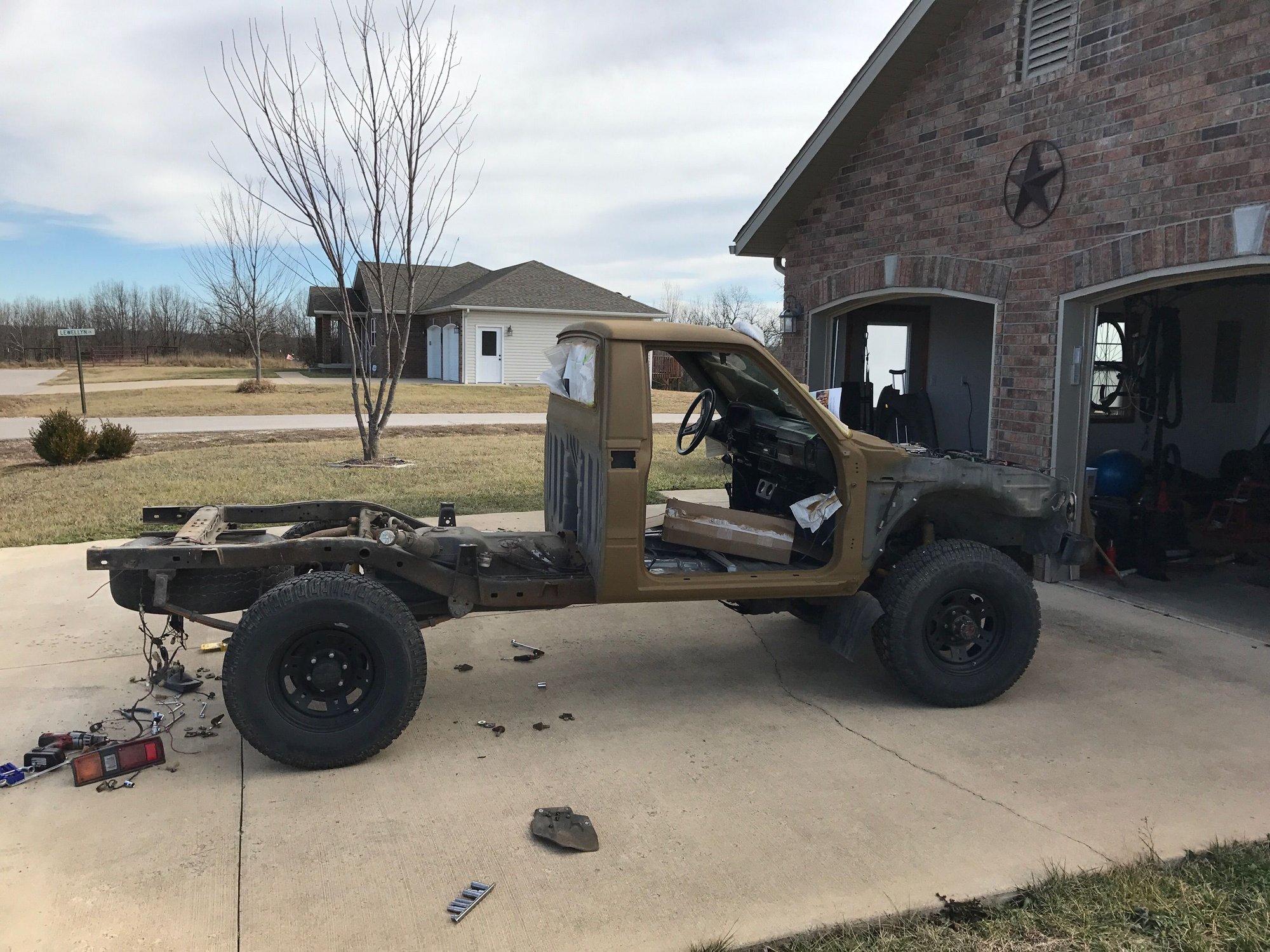

Been very busy with this old war horse!
Work done so far:
The original carb was tired and in need of a rebuild. The p/o gave me a new 32/36 so I put it in and desmogged (this brought the engine right back to life).
Headlights were dull so I changed over to a positive ground setup with a harness from low range so I can use new style bulbs
The big problem I've been chasing was a bad vibe which I thought was driveline. So far I have rebuilt the transfer case completely. Changed the rear u joints as well. I just put in new tie rods and a steering stabilizer and rebuilt the drag links. I also rebuilt the front axle completely with all new seals and bearings. STILL HAVE THE VIBE. Tire pressure checked as well. I am going to change out my rear bearings and seals as well. I'm thinking it must be my shocks/springs as that is about all that's left. The rear shaft is timed correctly.
The p/o had a failure of the rear shaft front u joint. I was thinking the flange could have been damaged because of this or maybe the shaft itself?
in any case I am committed to getting this thing 100% up to daily driver duty. Not too many things left to replace or rebuild lol.
Old Jan 27, 2017 | 09:37 AM
  #51
TBJmedic's Avatar
Joined: Nov 2016
Posts: 5
Decided to re paint with some military flat paint. Color is field drab from Aervoe. Pulled everything apart and rust proofed the frame with permatex rust eliminator and some enamel black paint over top. New windshield installed also as well as new lights and housings all around. Getting ready to install new bushings for everything once im done with the bed.
