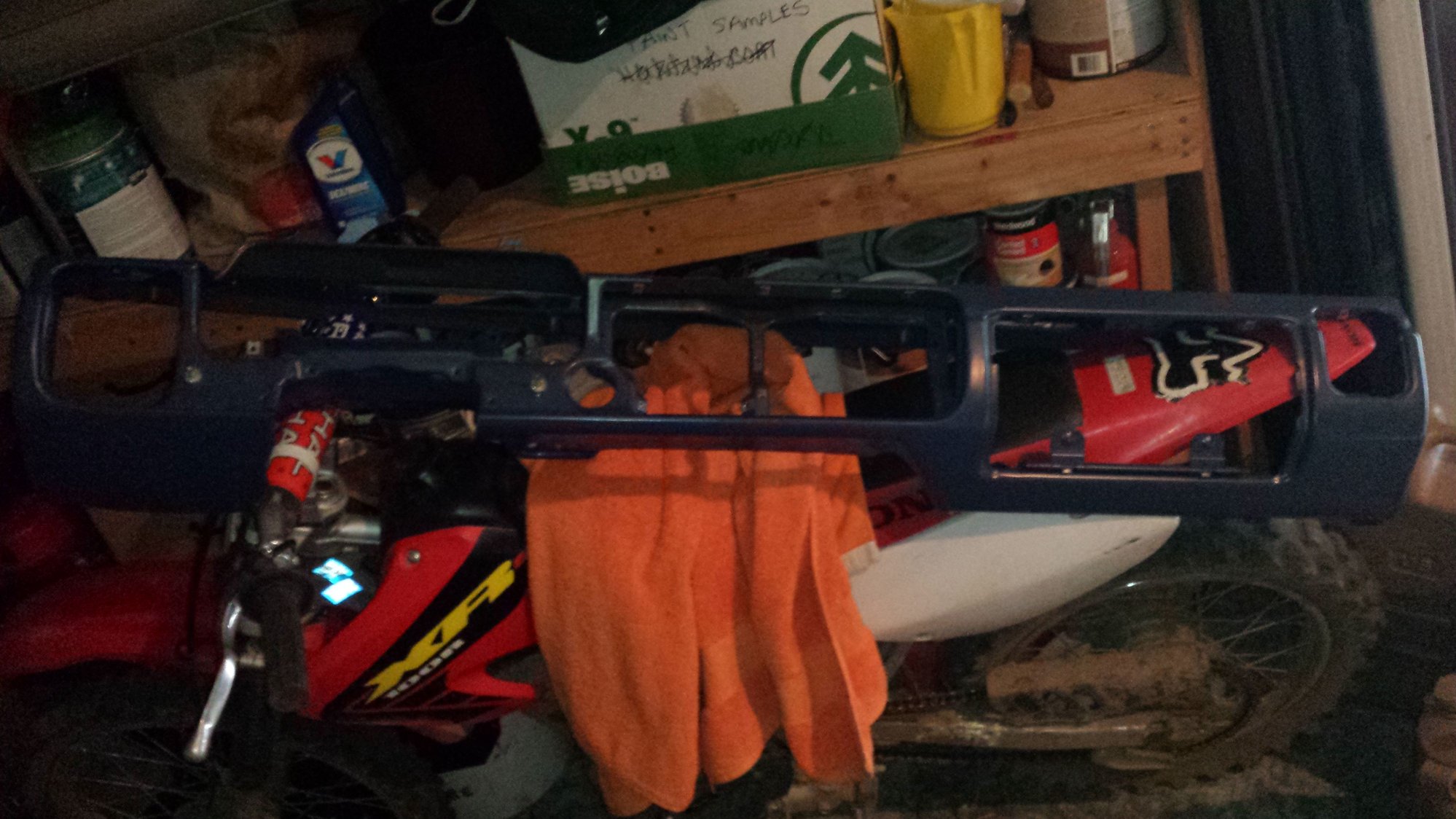

I bought a new dash for it to fix that chopped corner
Here is the 2wd pickup that I pulled the dash from and its even blue!!

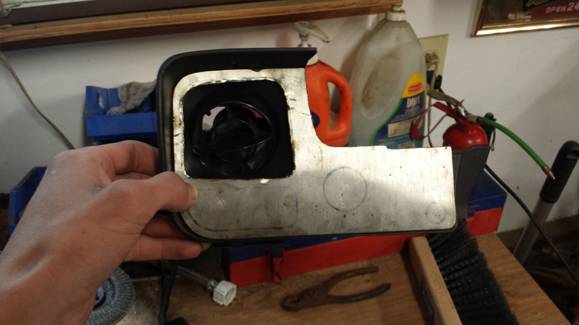

I peeled off the wood decal and stuck it to a piece of card stock for a template, the other side of the dash is going to be a bit harder because of the radio.

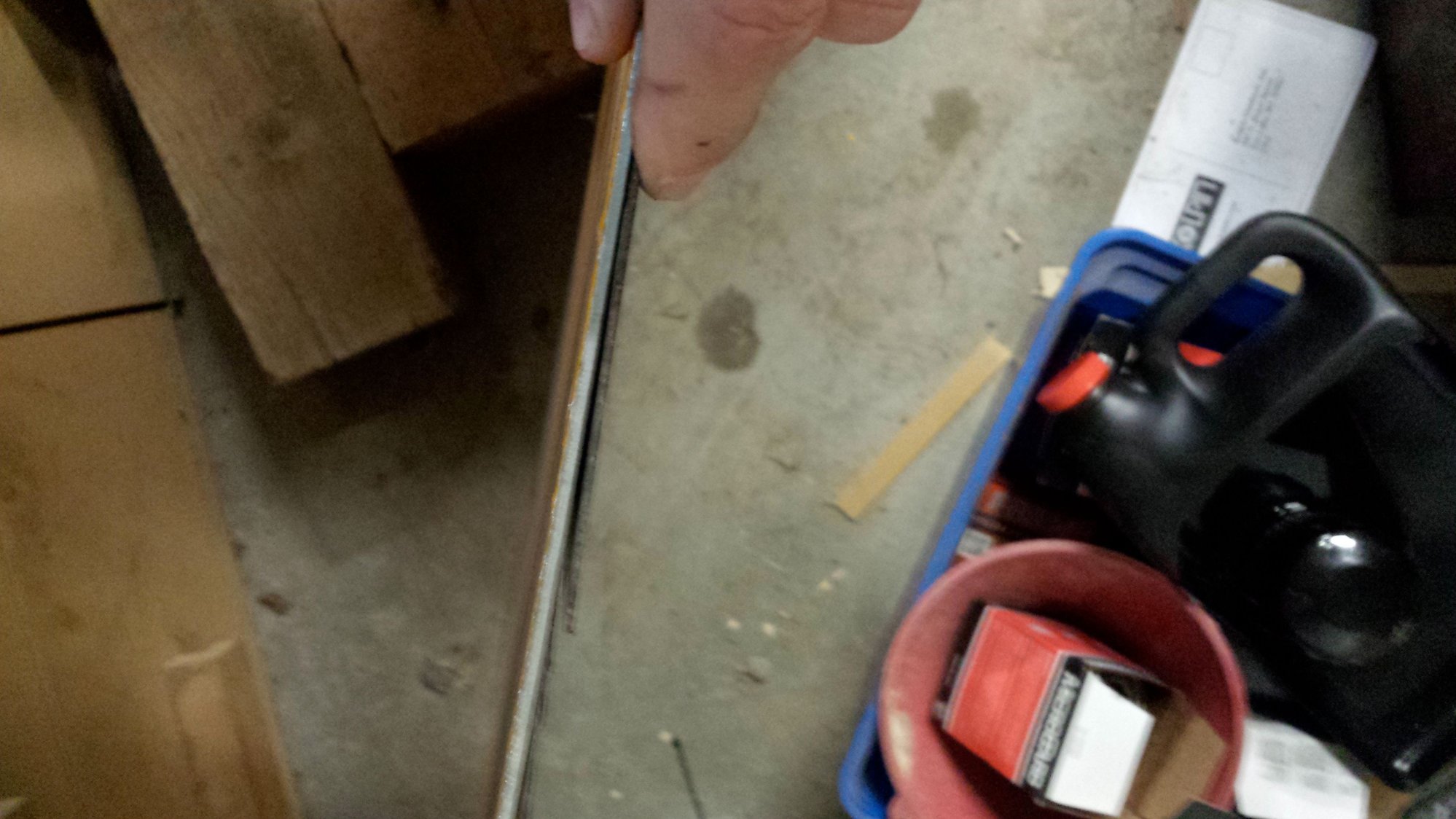

I original was going to use a piece of aluminum from a road sign but I found a piece of stainless that is a bit thinner and stronger so I decided to use that instead. I wanted to make a plate to lay on top of the factory one so that I could relocate my radio and such wherever I wanted without having to cover up any holes. Let me know if anyone has any suggestions, I haven't seen anyone else go about it this way so I'm curious to see how it will turn out.

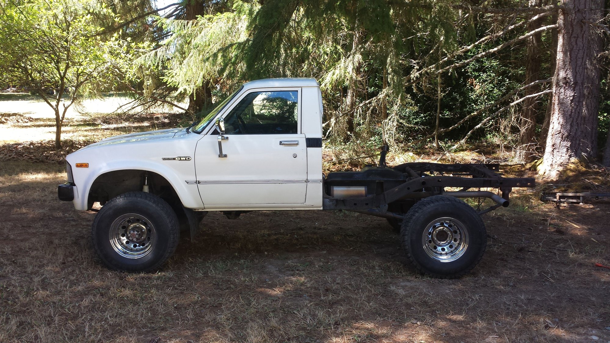

Took the bed off the other day to paint the frame so it wouldn't rust any more.
after a few coats of paint its now protected ...for now...
