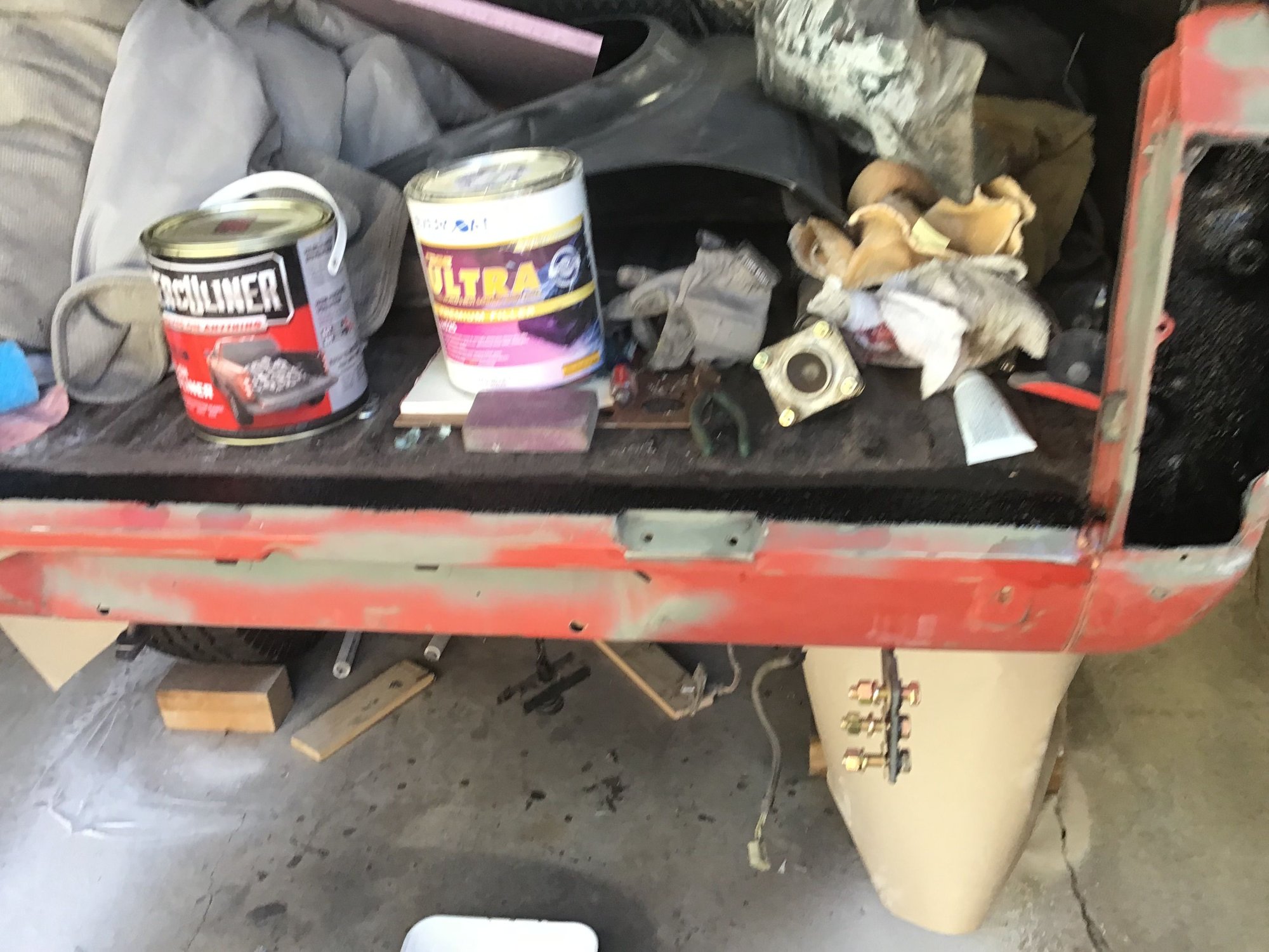

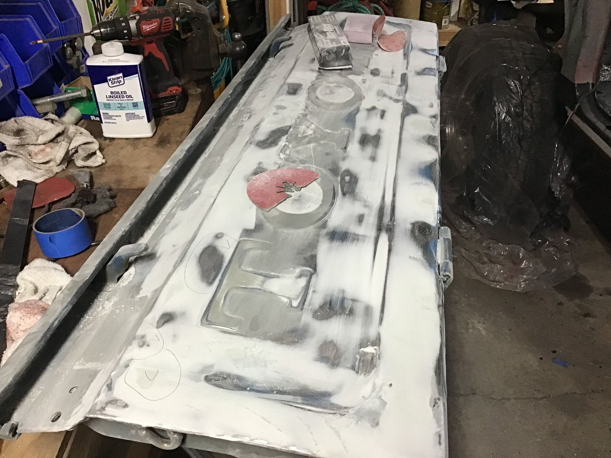

Started sanding the tailgate this afternoon and it’s slow going. The tailgate is all over the place in terms of highs and lows.
Also forgot to take pictures of the bed front and cab back which each got bed lined. The bed is bolted back down now so it’s hard to see any lining.

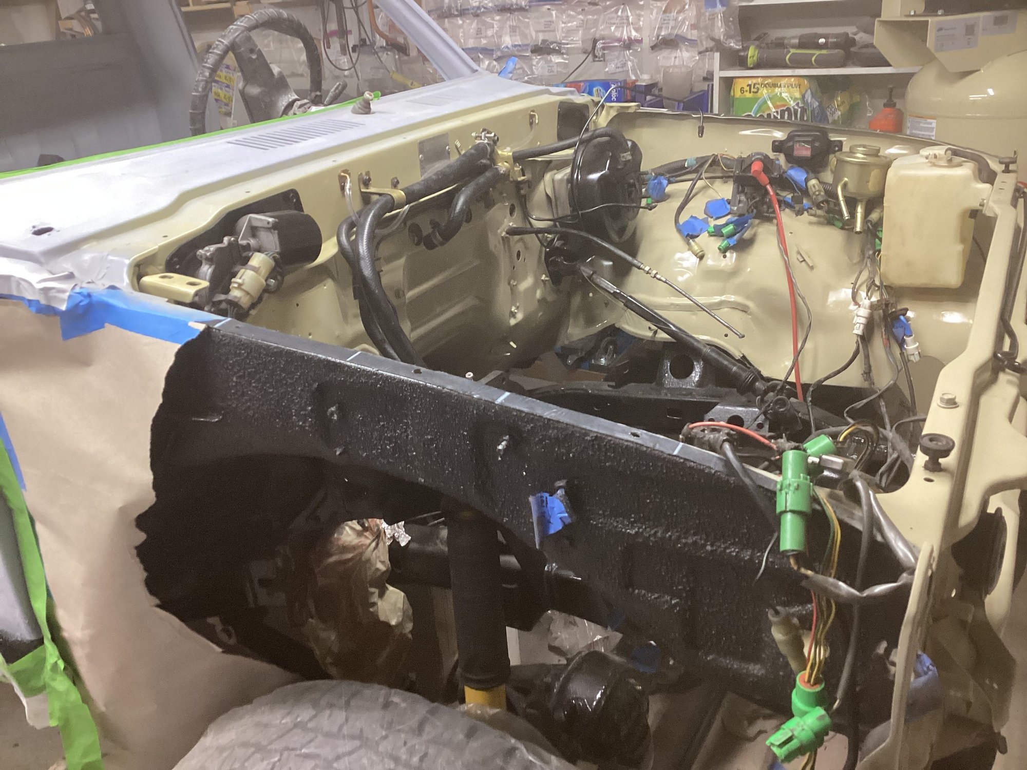

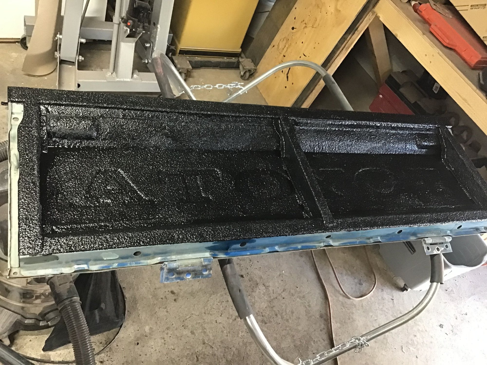

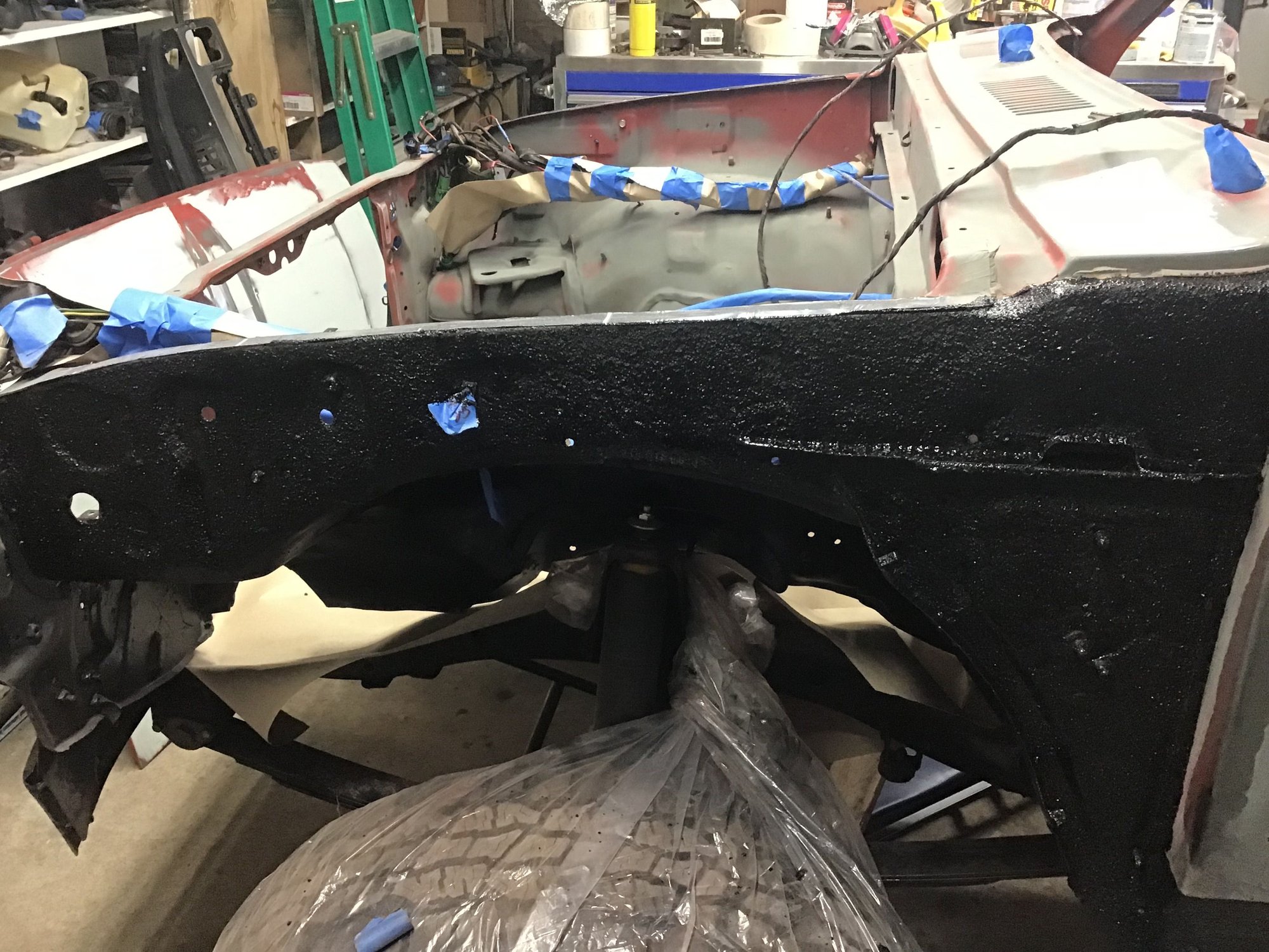

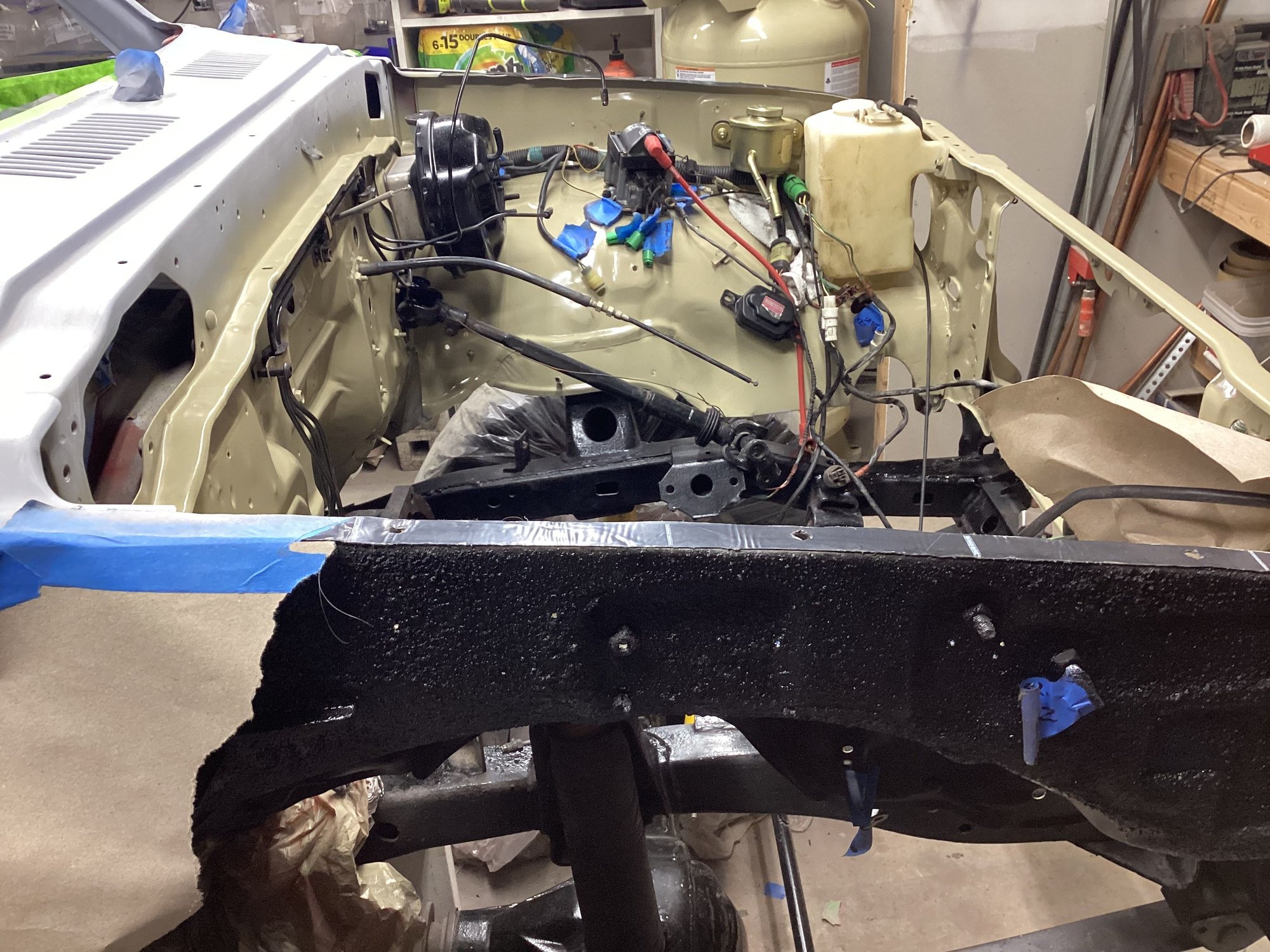

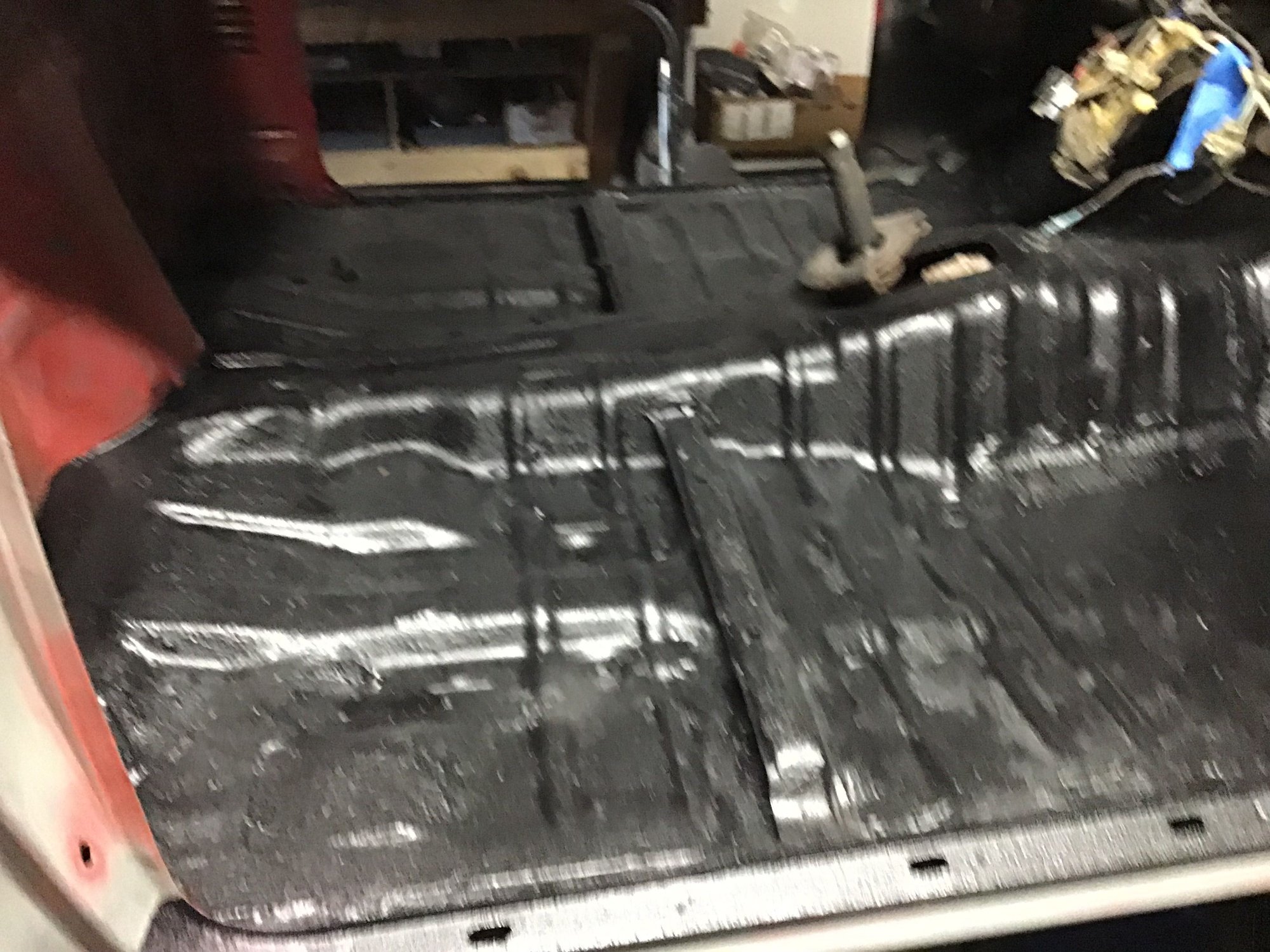

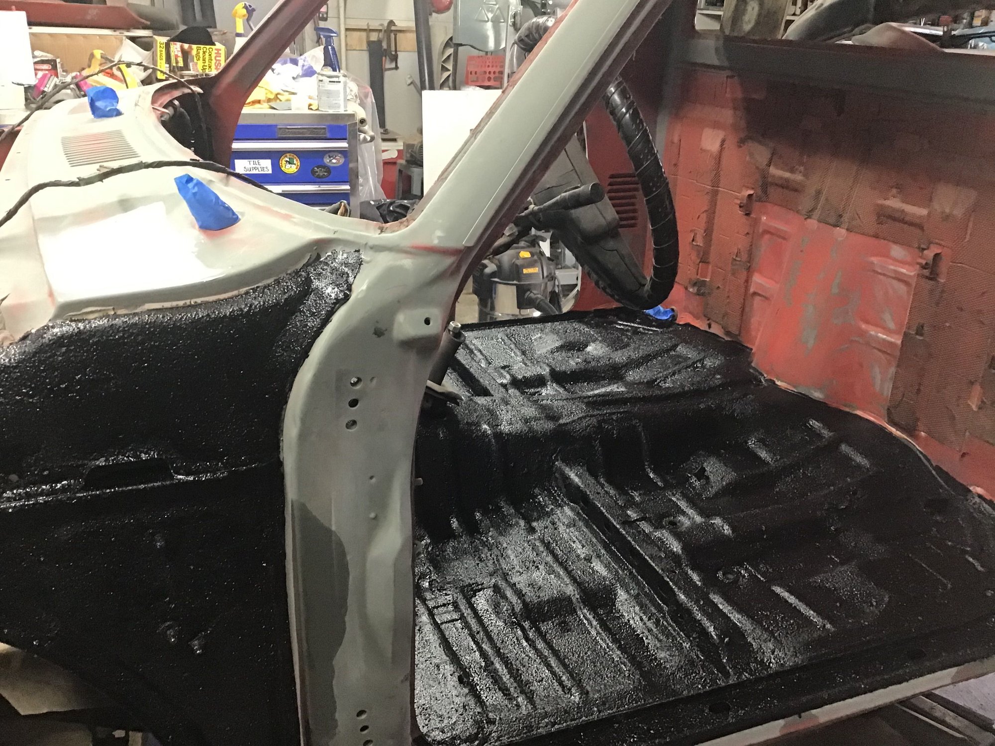

Found some time this afternoon to get some Herculiner in the tail light pockets, upper front fender wells, tailgate and the cab floor. The cab floor was done a few days ago but the product was lumpy in spots so those areas got scraped and then everything roughed up and wiped down for a second try.

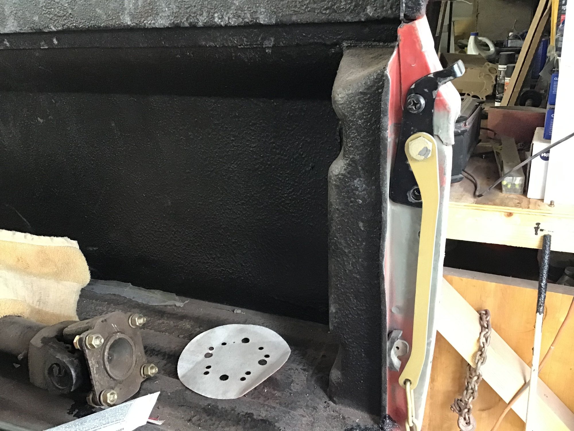

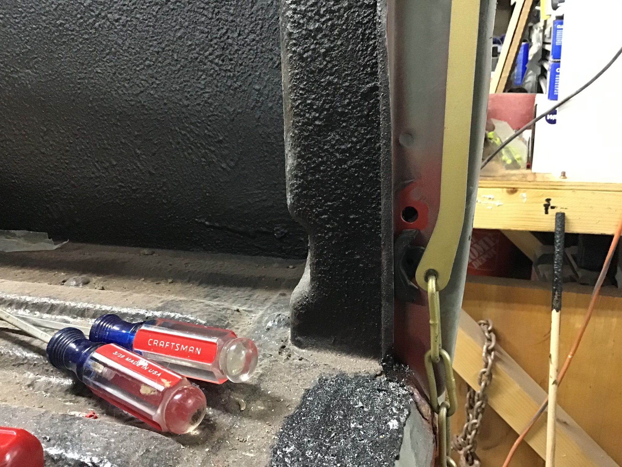

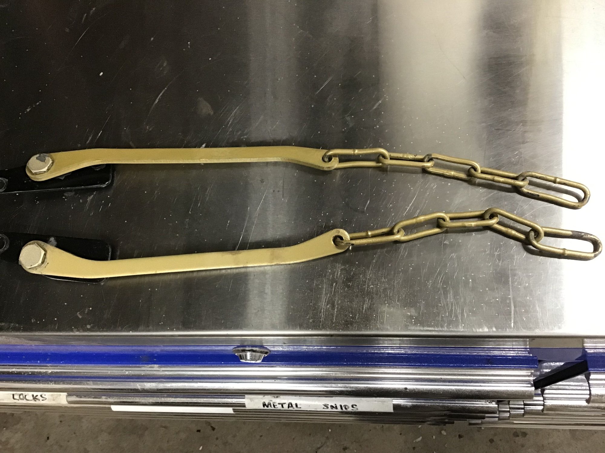

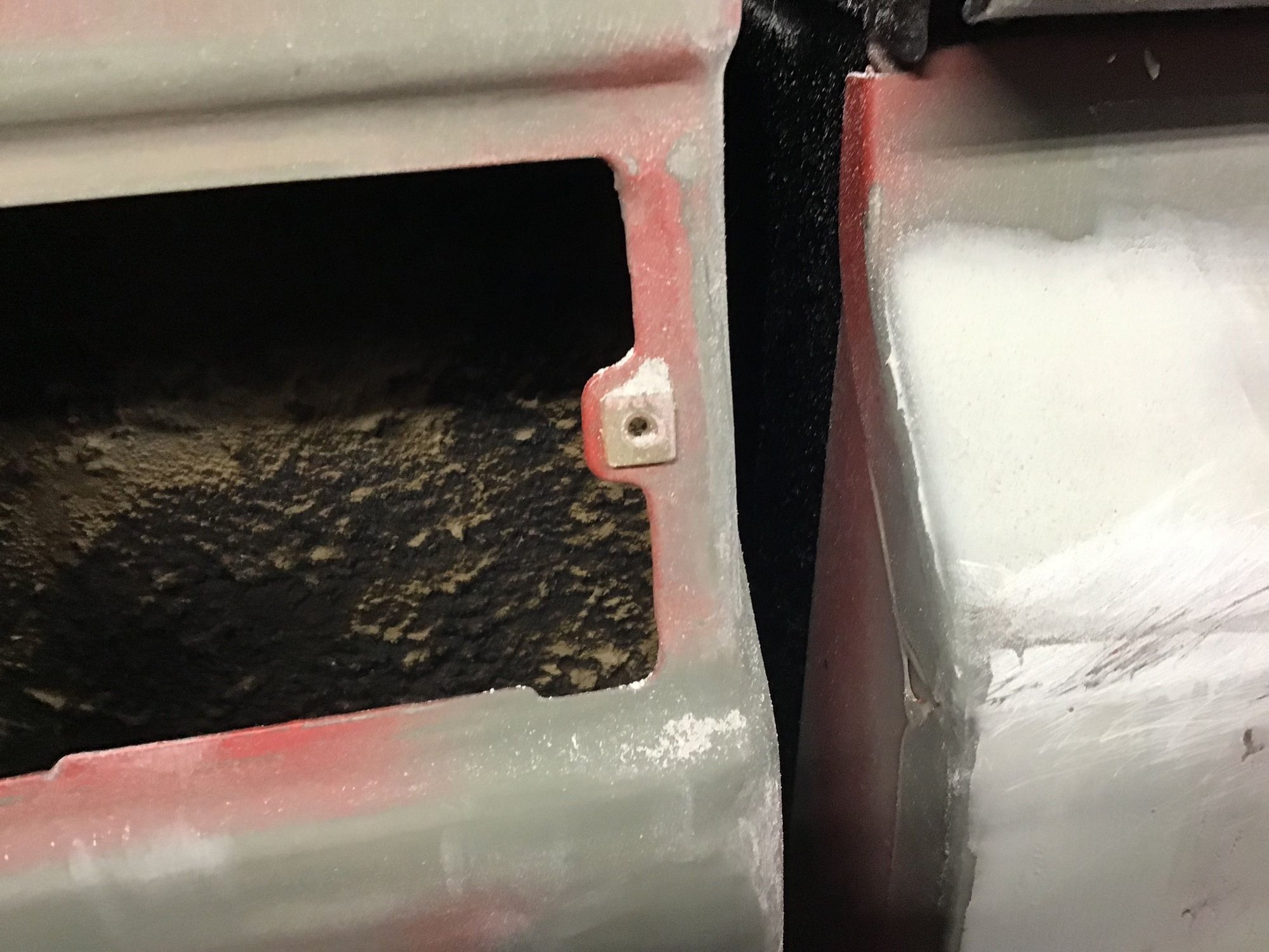

Kind of sitting in a holding pattern right now waiting for the weather to warm up so the truck can get primered. Got the 1979 tail gate test fitted with the 1982 body after a few adjustments.
The tail gate stays arrived from an eBay seller. Here they are cleaned up and painted.
The stays didn’t quite line up with the stops on the newer model bed so the stays got relocated.
The stays didn’t quite line up with the stops on the newer model bed so the stops got relocated.

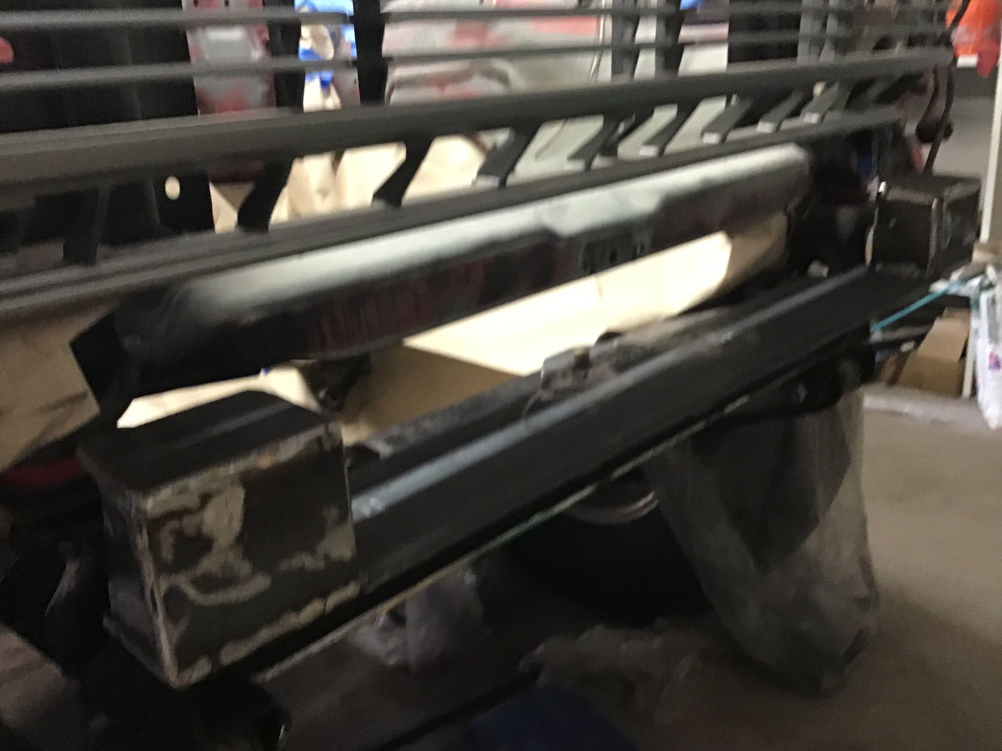

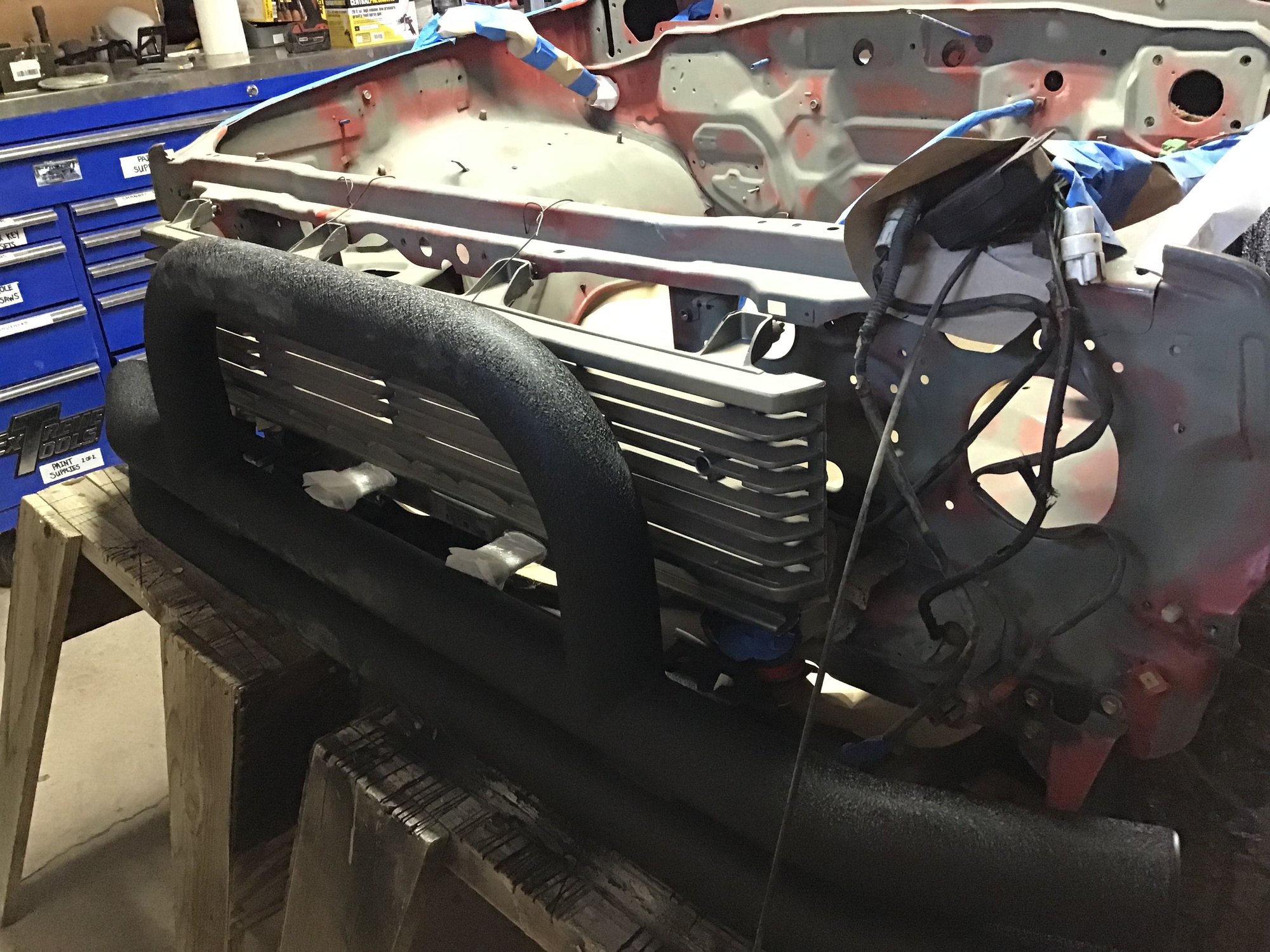

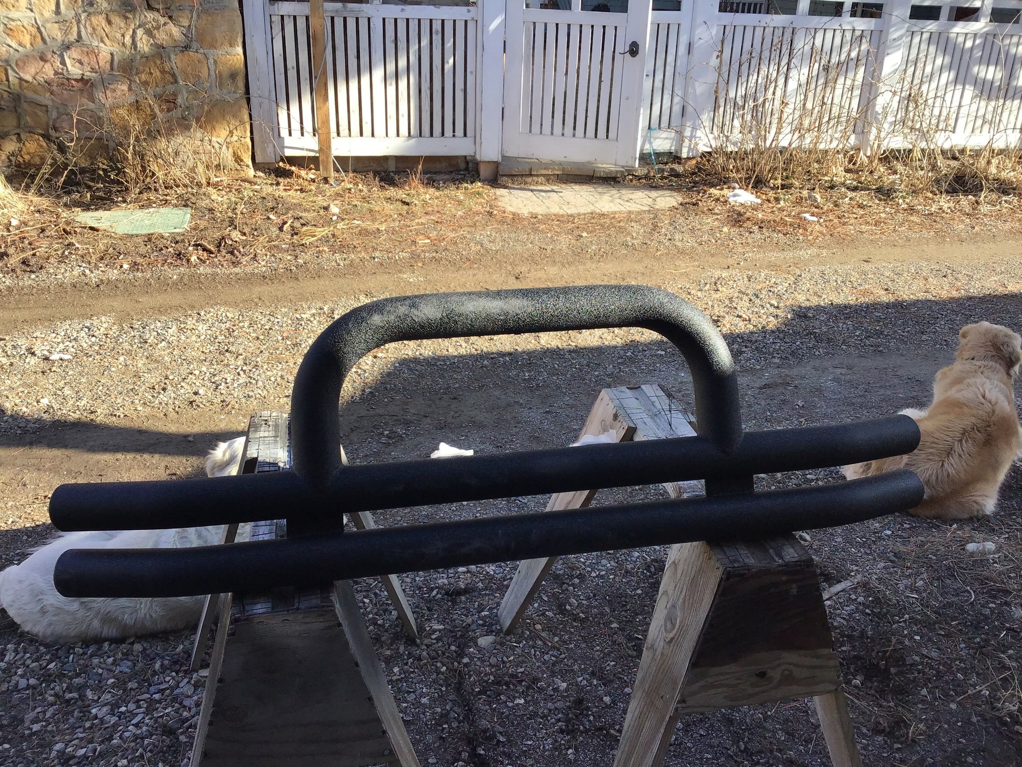

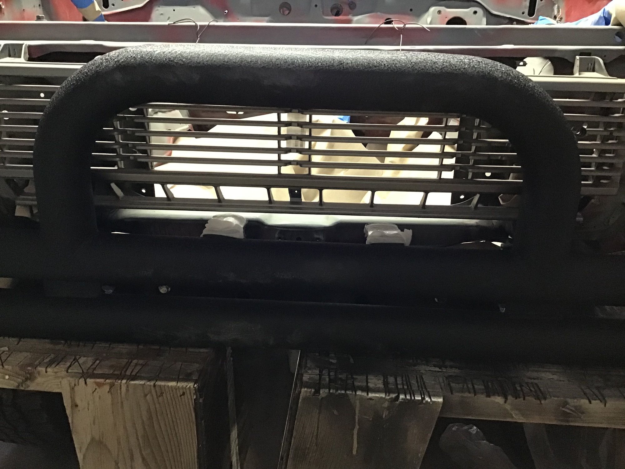

The front tubular bumper arrived today courtesy of Fed Ex. It’s manufactured by Barricade Off Road and marketed by Extreme Terrain. Smittybilt still has the double tube bumpers for sale on Smittybilt.com but their overall width was 56”. The Barricade bumper for the 1976-86 CJ7 is 61” wide which is just right. The right length plus free freight and priced at $239 was a good deal. Now to figure out how to bolt it up to the Toyota front end. Overall weight of the bumper is 28 pounds. Here are some pics.
Fresh out of the box. The dust spots are body filler sanding residue that transferred over to the bumper when I grabbed it.
Side view at the approximate finished install height.
Side view at the approximate finished install height. The bottom of the bumper in this pic is 29 1/2” off the ground.
Front view. The truck is close to the front wall of the garage so this picture isn’t the best.
Another front view.
Another front view. Optional light mount tabs are visible wrapped in packing insulation. 7

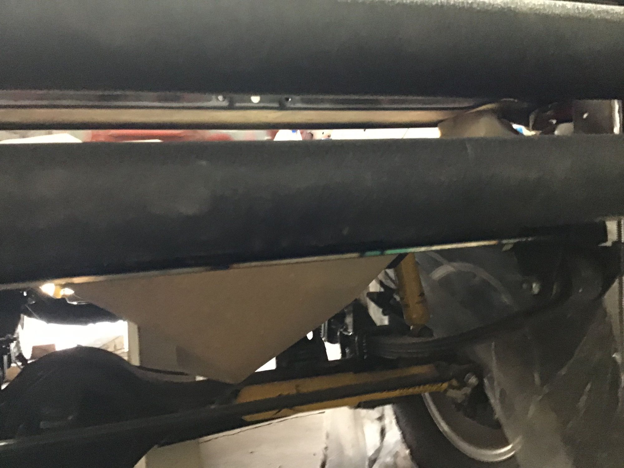

This is a side view showing the location of the OEM bumper stay bolts in relation to the tube bumper brackets that are designed to bolt directly on to the front end of a CJ7 frame. The bumper stay bolt visible in this pic is the bolt just below the green tape.

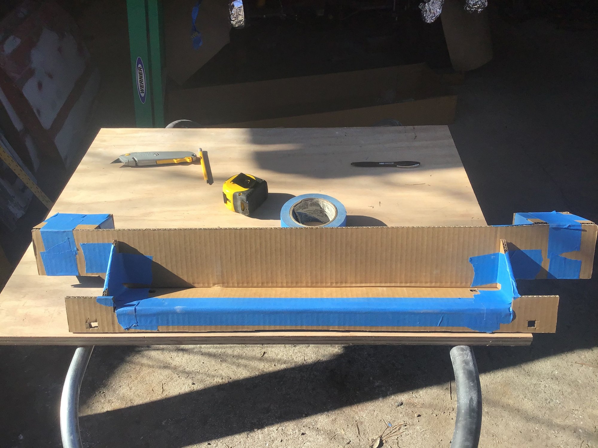

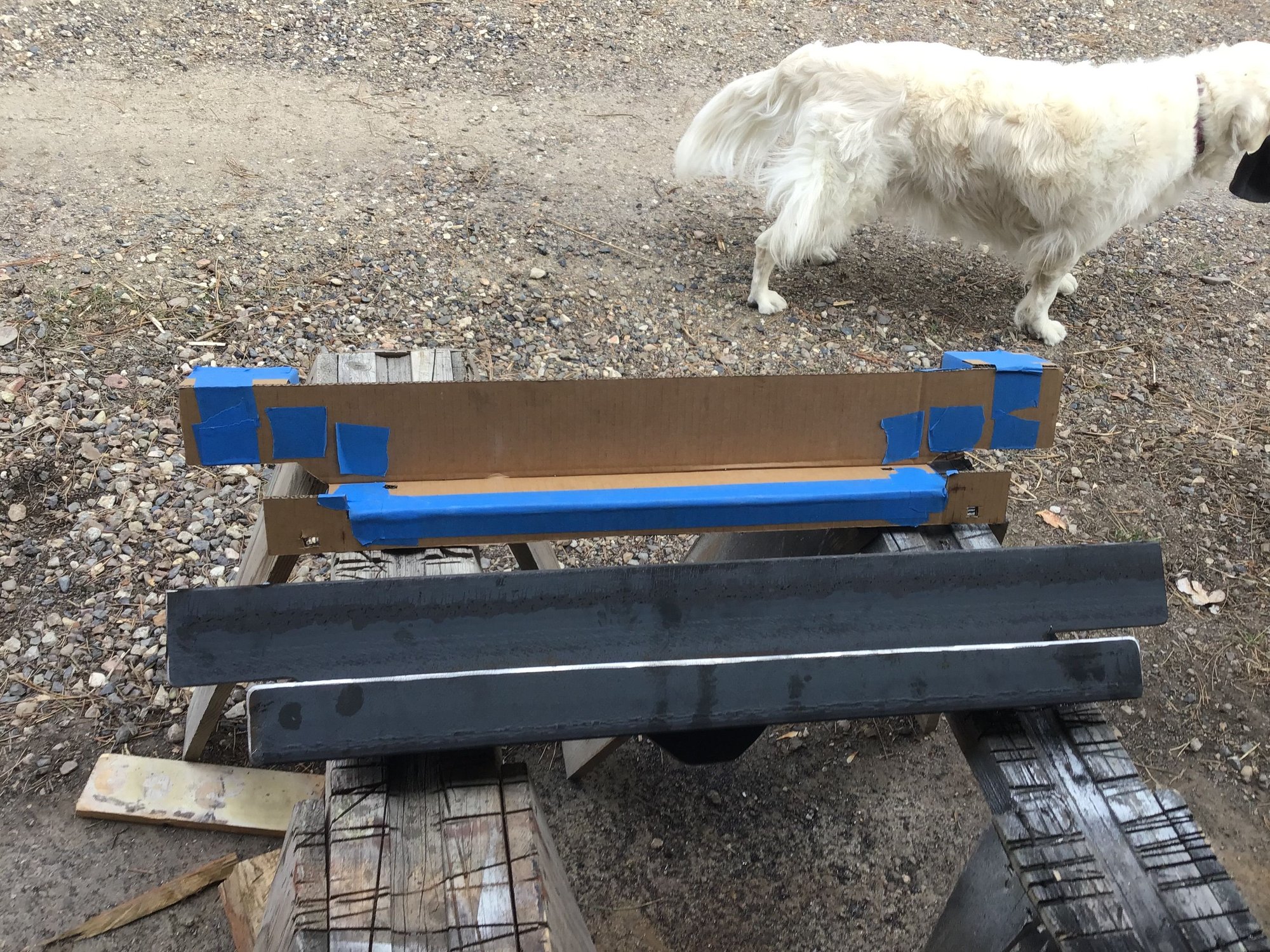

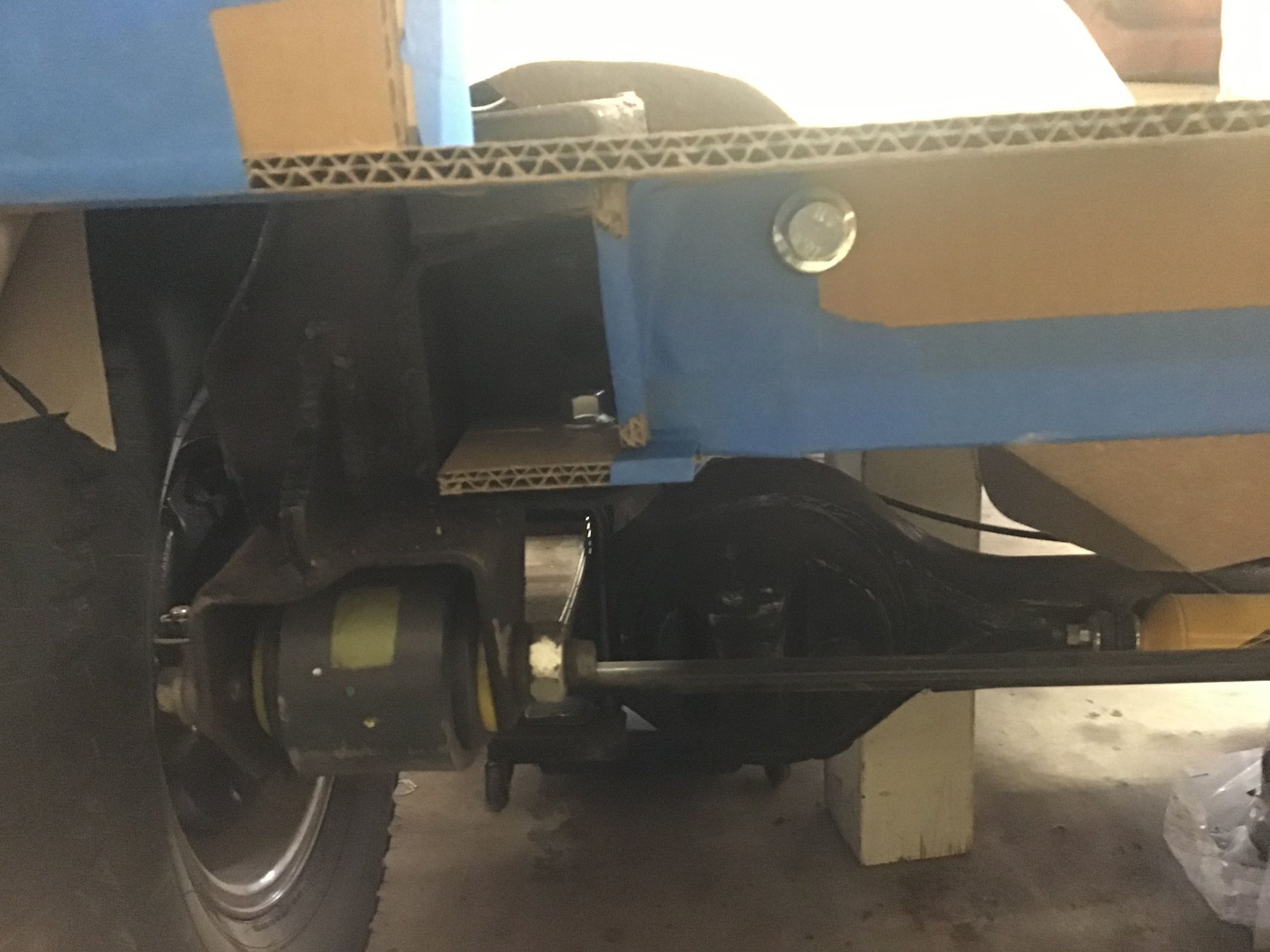

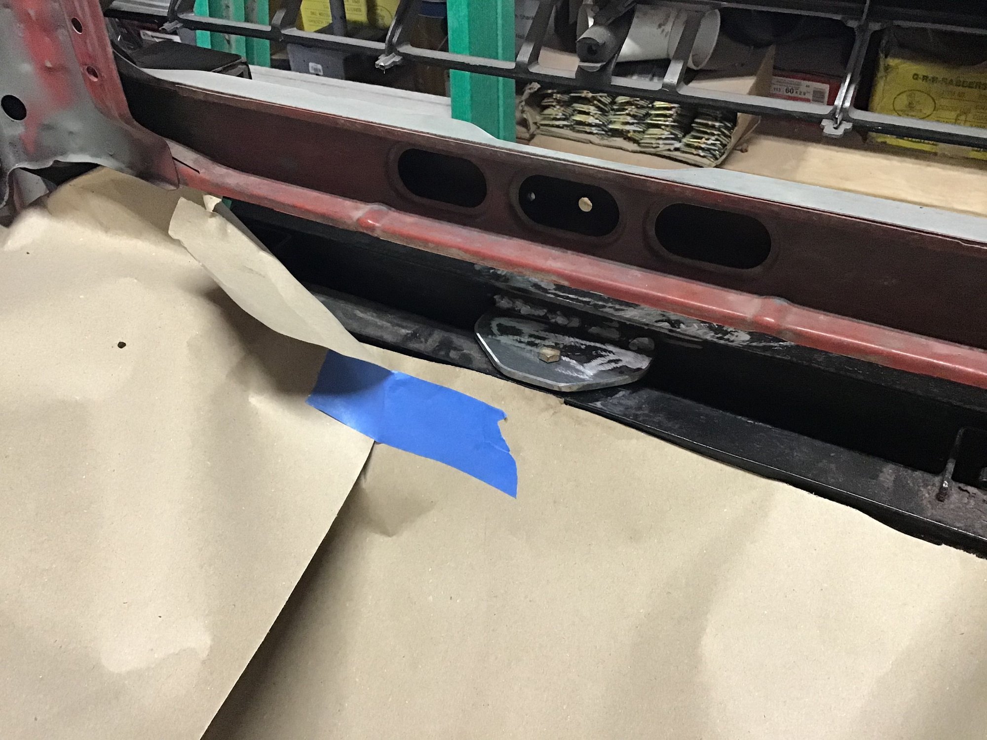

Got a cardboard mock up of the bumper bracket taped together today. The bracket will have five bolts securing it to the frame ends and front cross member. Here are a couple pics.
The vantage point of this photo is looking up at the bottom of the bracket. The two visible holes are for one bolt in the end of the frame on each side.

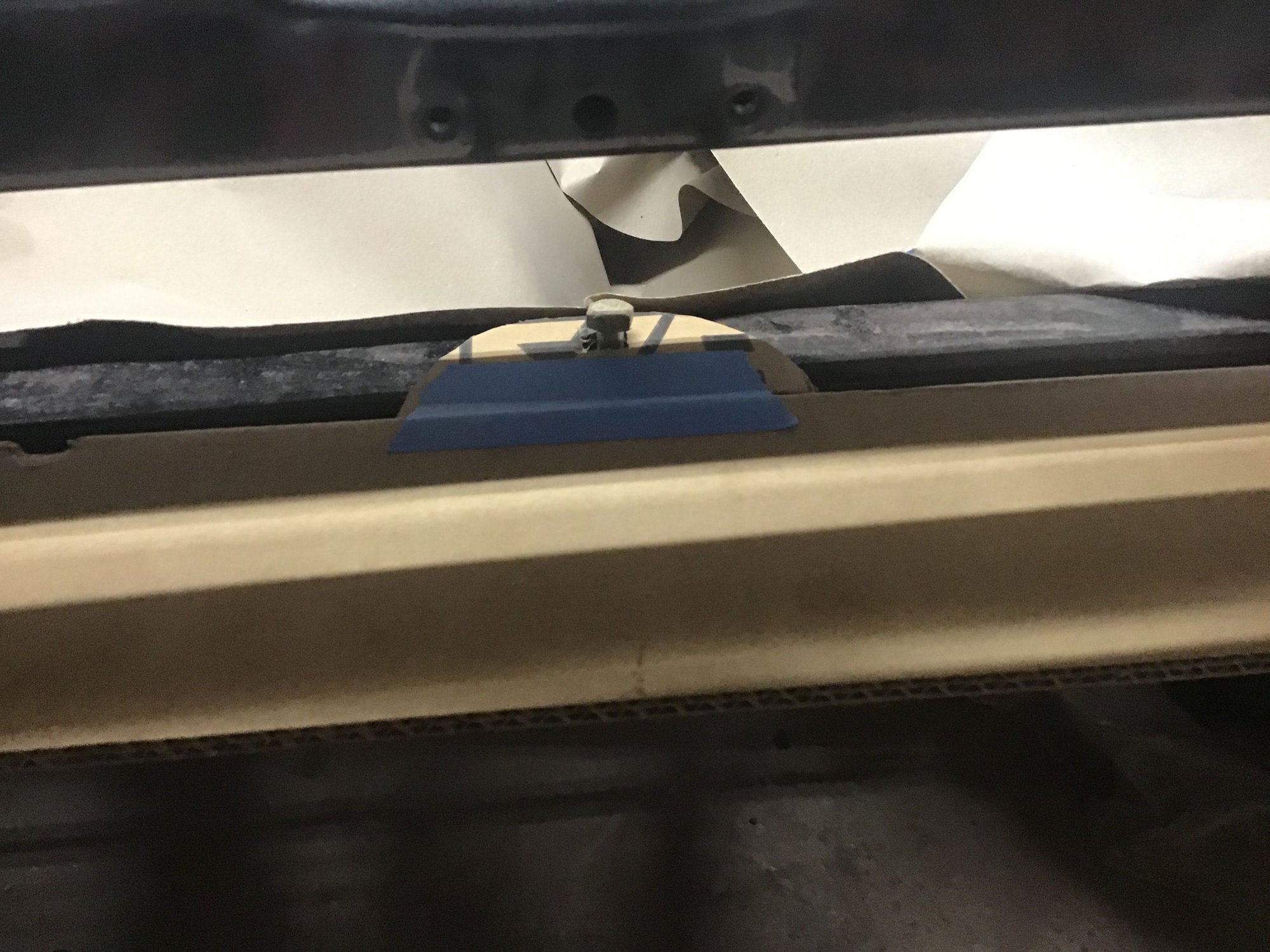

This picture of the passenger side of the bracket shows one bolt in the OEM bumper stay bolt hole in the front cross member and the bolt to the lower left going through the end of the frame.
The fifth bolt will go through the middle of the top of the front cross member. All five locations are factory holes so that is great.
Not too good a picture here. Just a verification that the bumper will slide over the mock up and everything is a proper elevation. Time now for a shopping trip to the local steel recycling facility this week for some 1/4” plate.

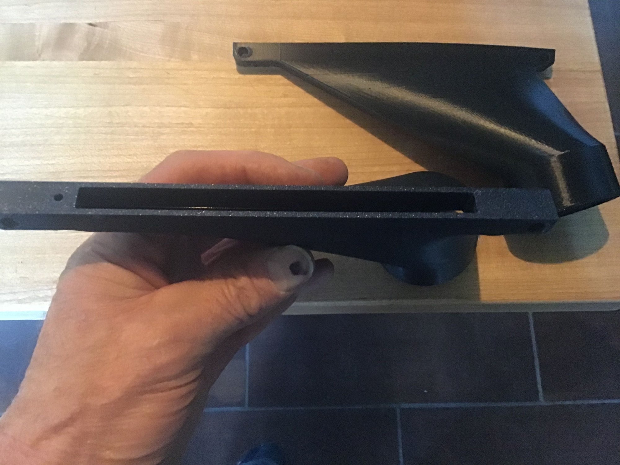

Wow. Two weeks since a progress post. Been busy gearing up for another sprinkling system install season. Good news in the mail today though. Just received a couple 3D printed window vent boots. Build quality is very robust. I was afraid to get a used pair off eBay since they’d be at least 40 years old. Also received a couple pedal pads 🙂. Cheers!
The shipping label pic is from the 3D place that printed the vent boots.

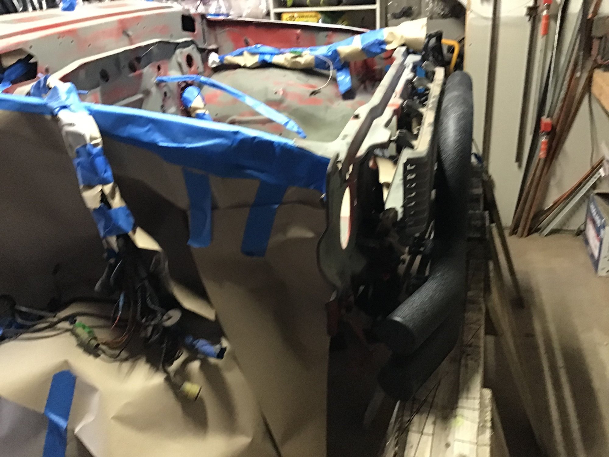

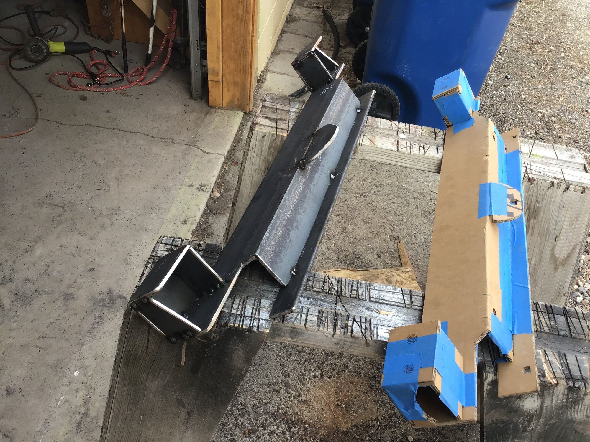

Finally found a little time this afternoon to get back to the bumper bracket. A steel cutting blade on a Skil saw was used to cut the 1/4” plate and it was shocking at how clean and easily the cuts were accomplished. After that the pieces were tacked together following the cardboard mock up as a guide and hopefully the holes can get punched in the bracket tomorrow for a test fit.
Old Mar 30, 2025 | 04:17 PM
  #171
Enzothehound's Avatar
5 Year Member
Joined: Jan 2021
Posts: 235
Likes: 181
From: Northern Nevada

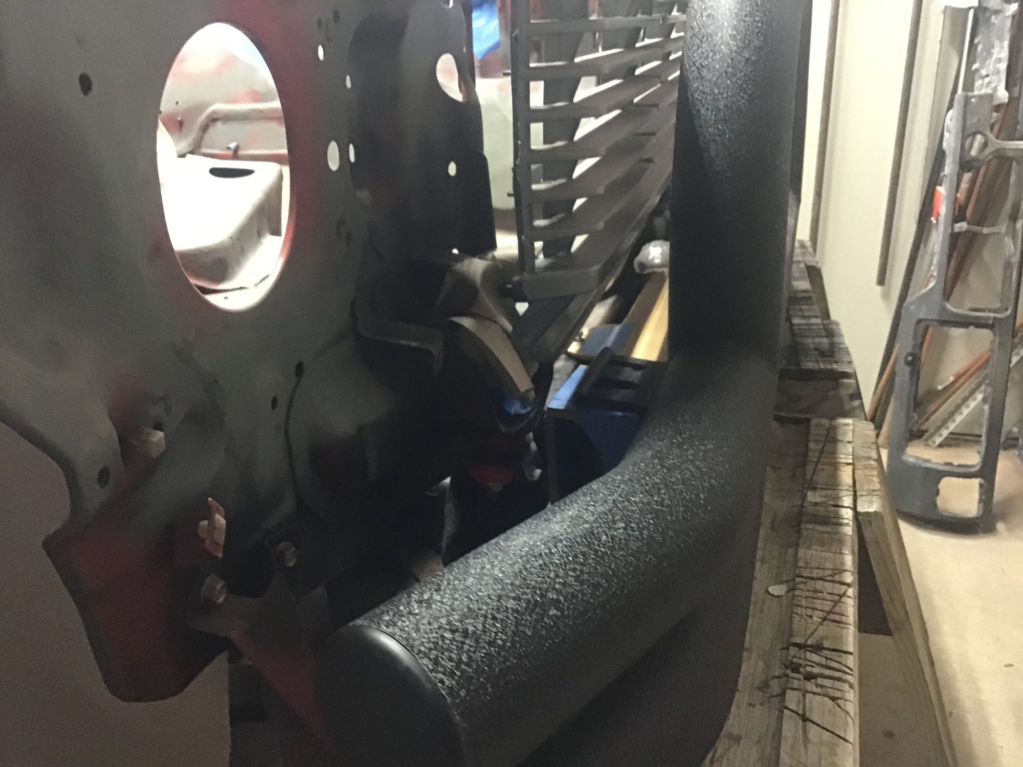

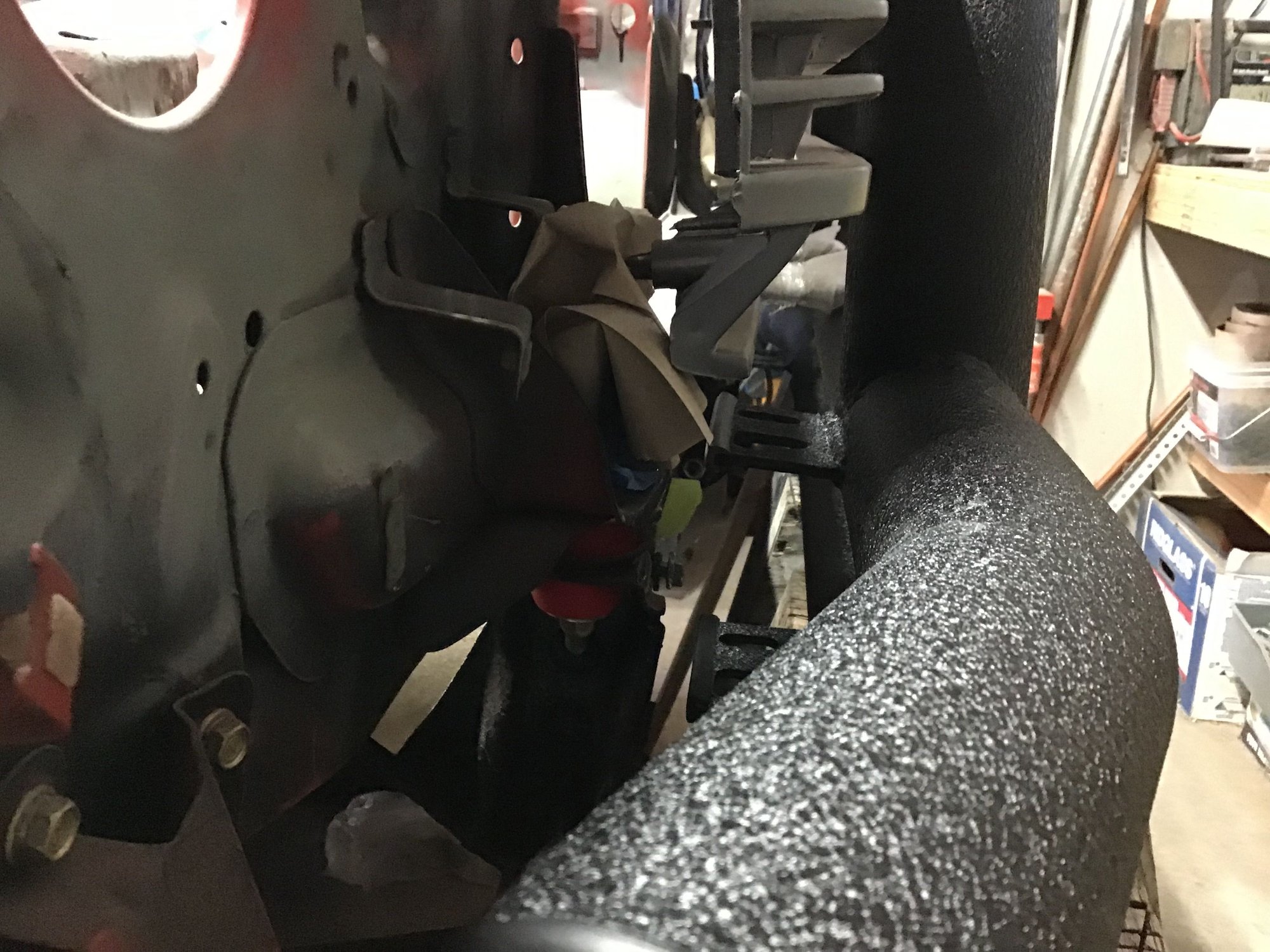

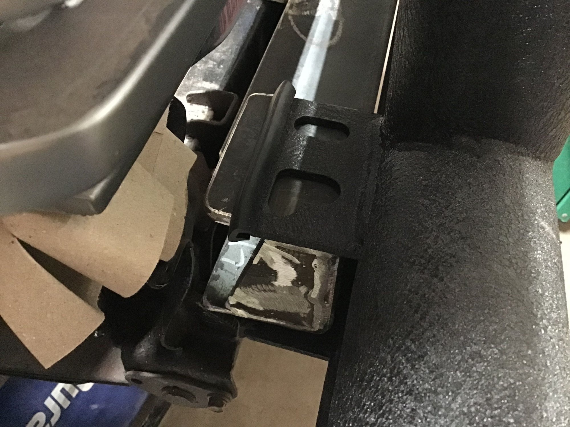

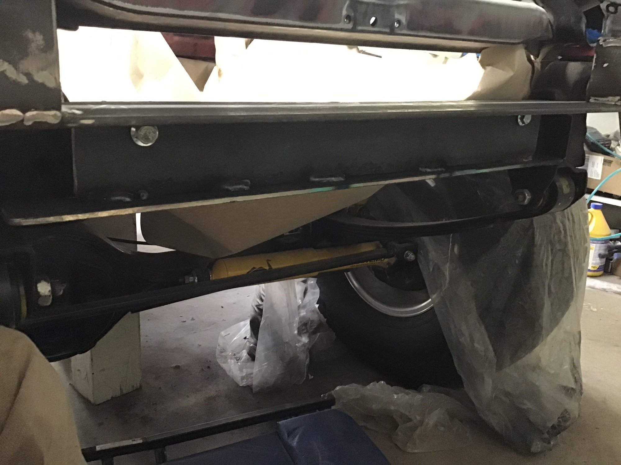

So the bumper to frame mounting holes got drilled today along with most of the welding. Bolted the bracket to the frame with a couple bolts, C clamped the tube bumper to the bracket and checked everything for level and square. Everything still looking like it will work. Just need to punch the bracket to bumper holes now.
View from engine compartment looking at rear mounting bolt and tab.
View from the front with top two bolts installed in bracket.
Angled view of bracket.

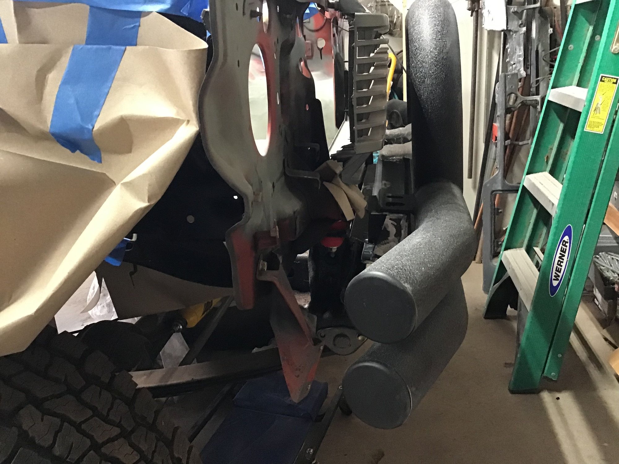

And three more pics I forgot to attach.
Front view of bumper. The bottom of the bracket is the shiny piece of steel beneath the bottom tube. Truck is parked too close to front wall of shop for a good picture.
Side view of bumper C clamped in place
Looking down at the left hand mounting point. Two bolts on the top and two on the bottom per side.

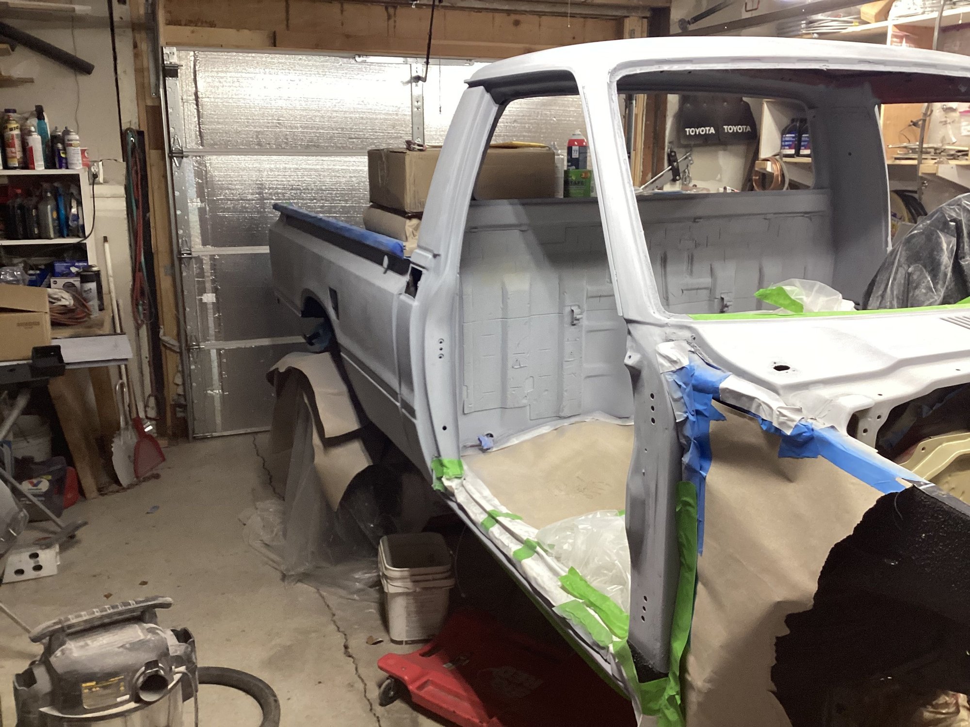

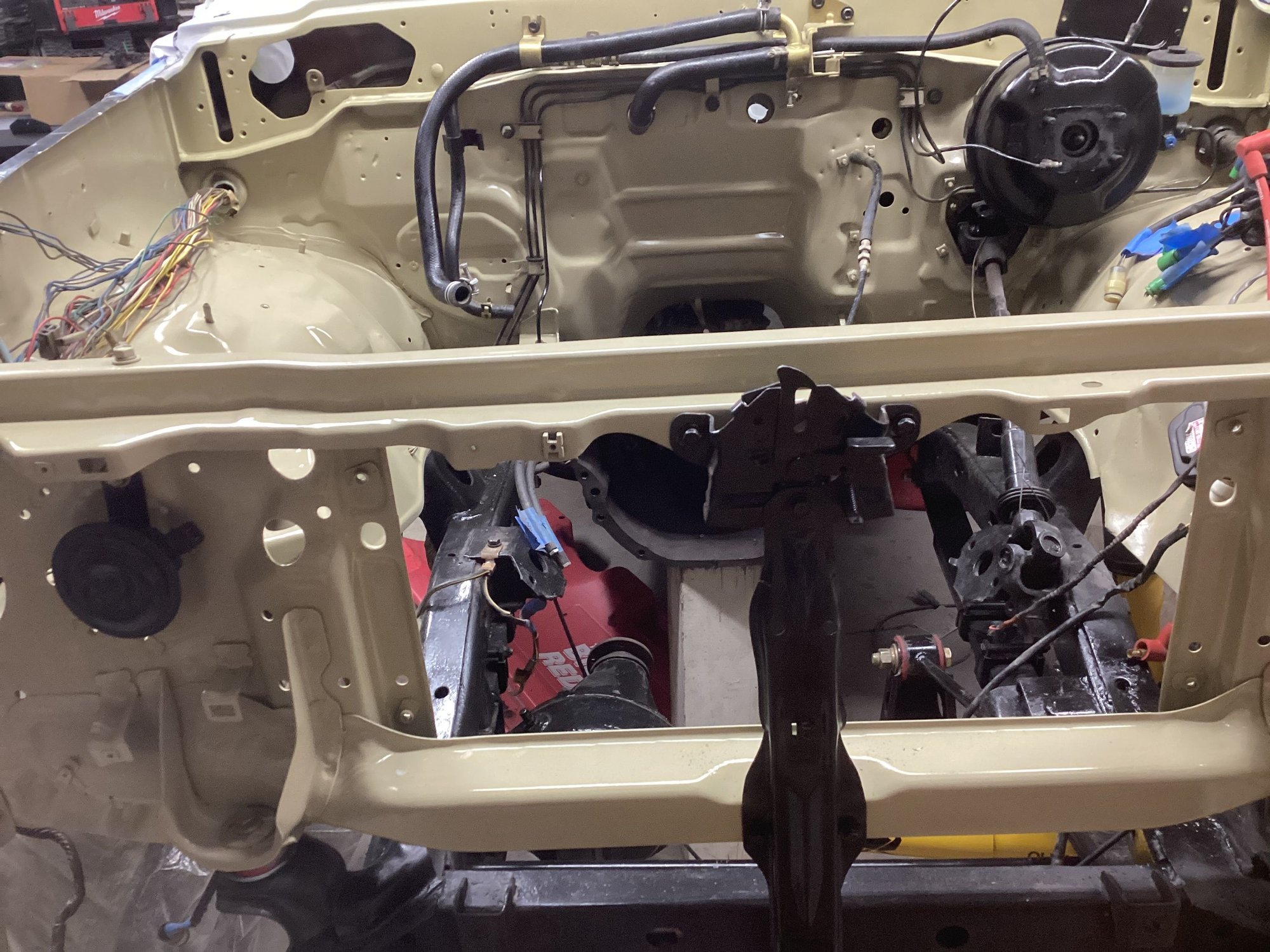

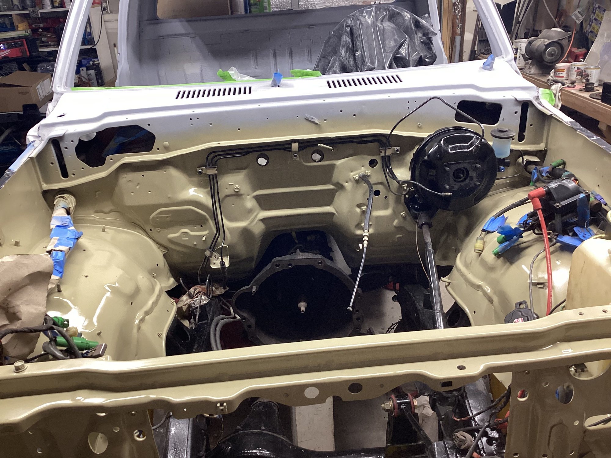

Finally got the truck sanded down and primed. It’s fairly cold here so I’m going to wait awhile before I paint. Did decide to paint the engine compartment so work can hopefully move forward this winter. Here’s a couple pics.

Found a few extra minutes today to get back to the reassembly. Took a quick pic, here it is.

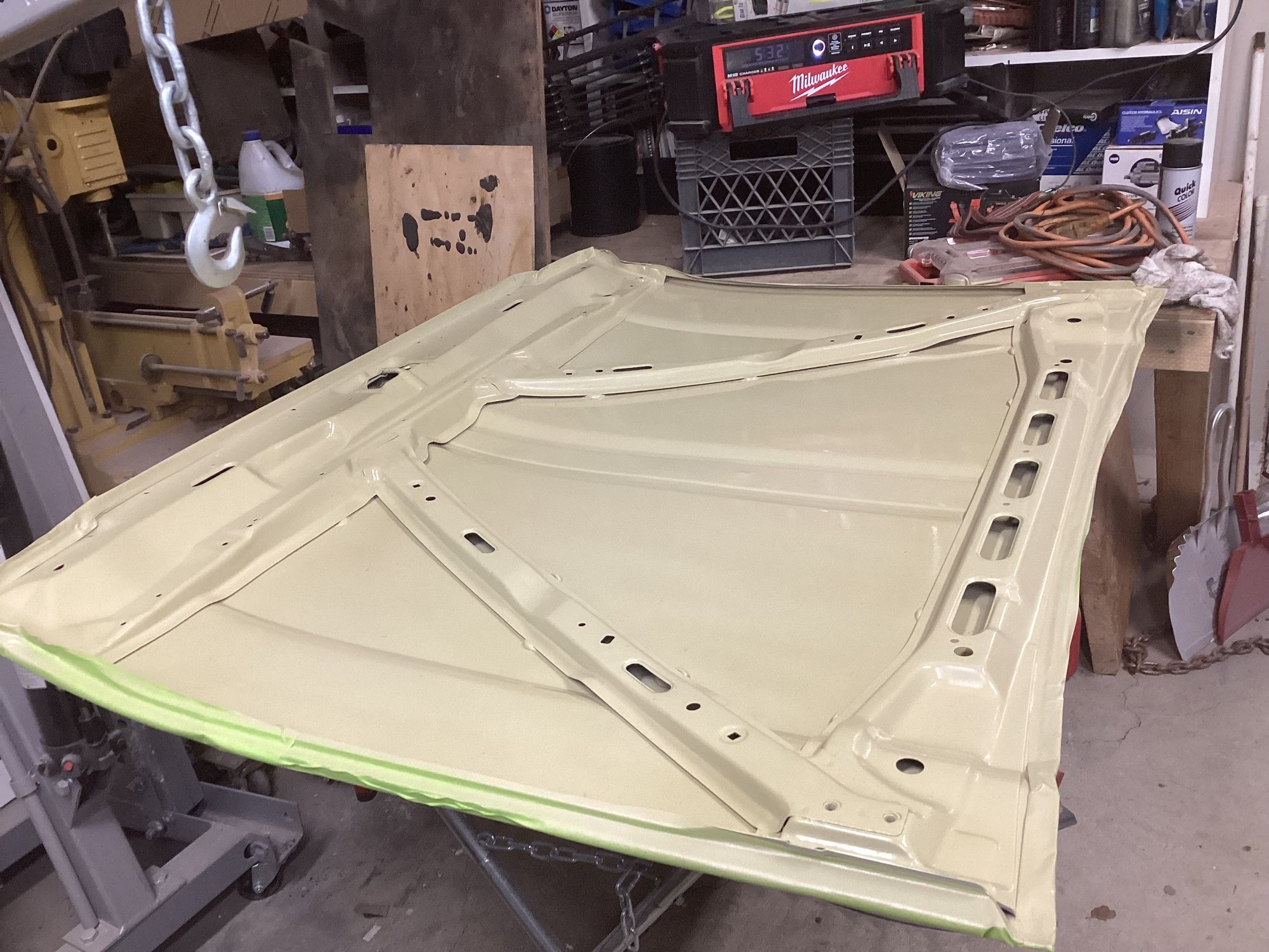

Did a little more re assembly work this afternoon on the windshield squirters, hood hinges, underside of hood, etc. Still waiting on a throw out bearing and clutch master cylinder gasket to arrive. Here are a couple updated photos.
