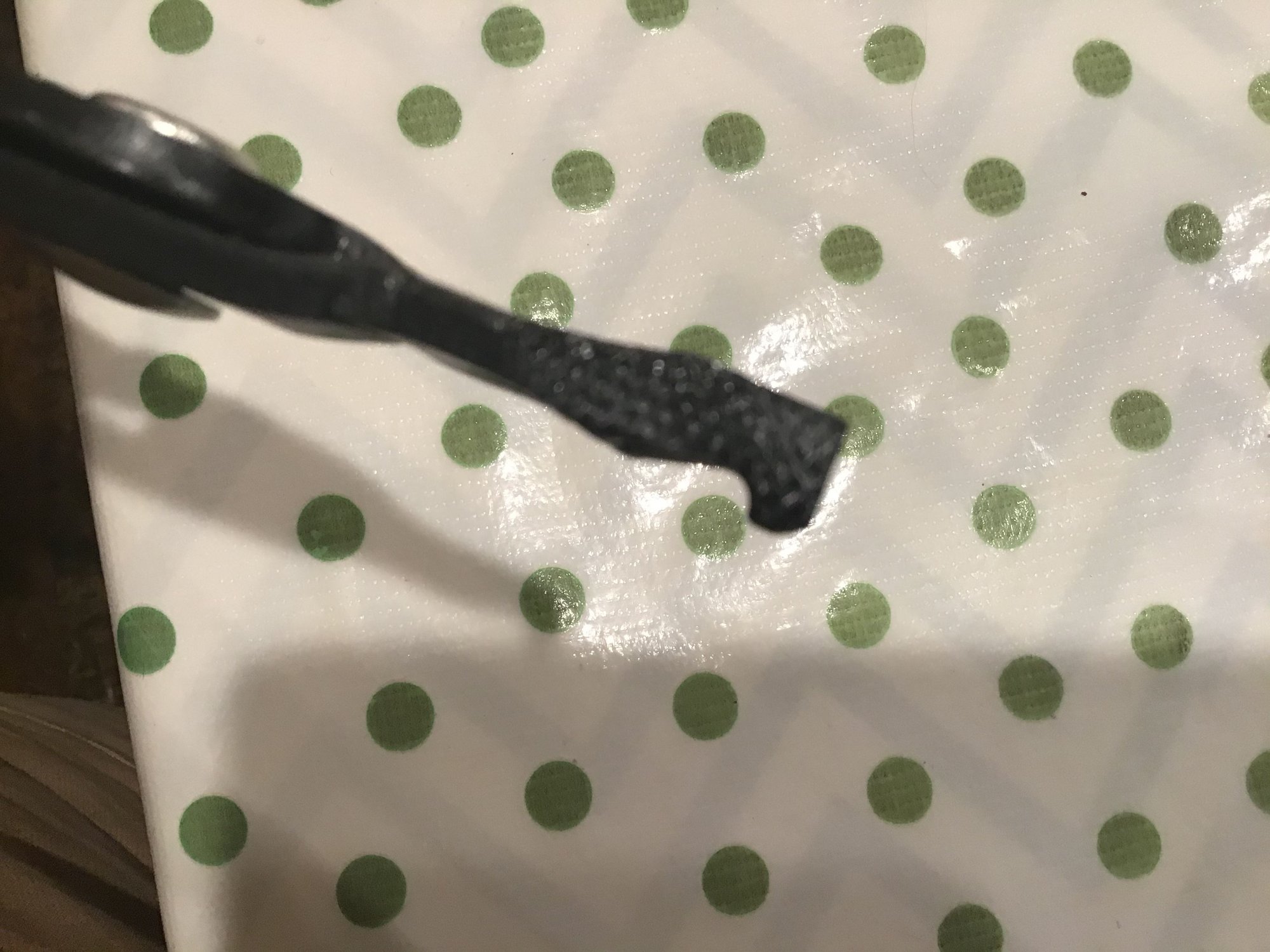

Sorry about that last photo of the pliers. Here’s a better shot of them. The second photo shows how the outside faces of the tip are knurled to get a good grip on the retaining rings.

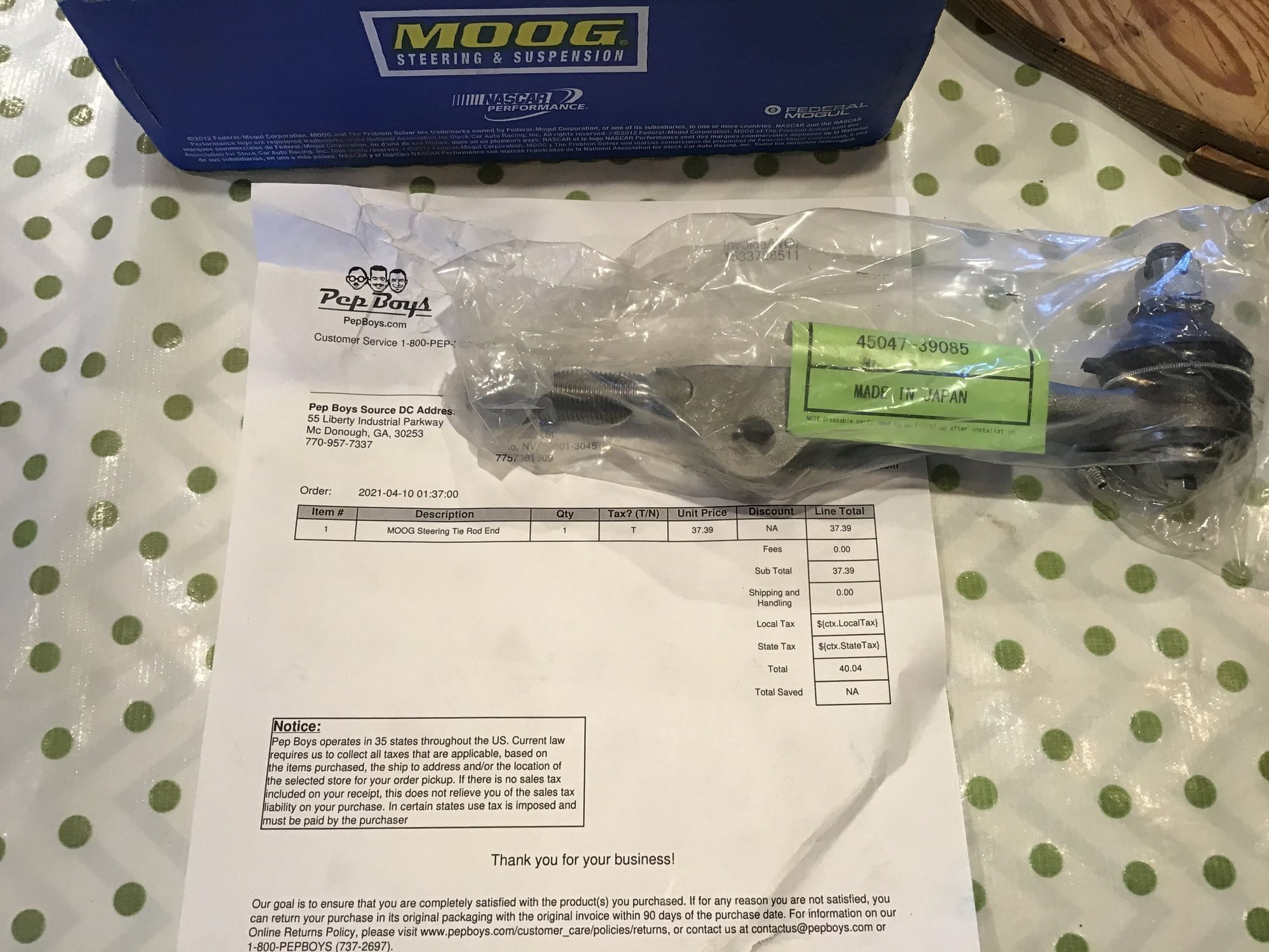

No time to work on the truck today but I did receive the discontinued Moog tie rod end from an eBay seller. Have a great weekend everybody!

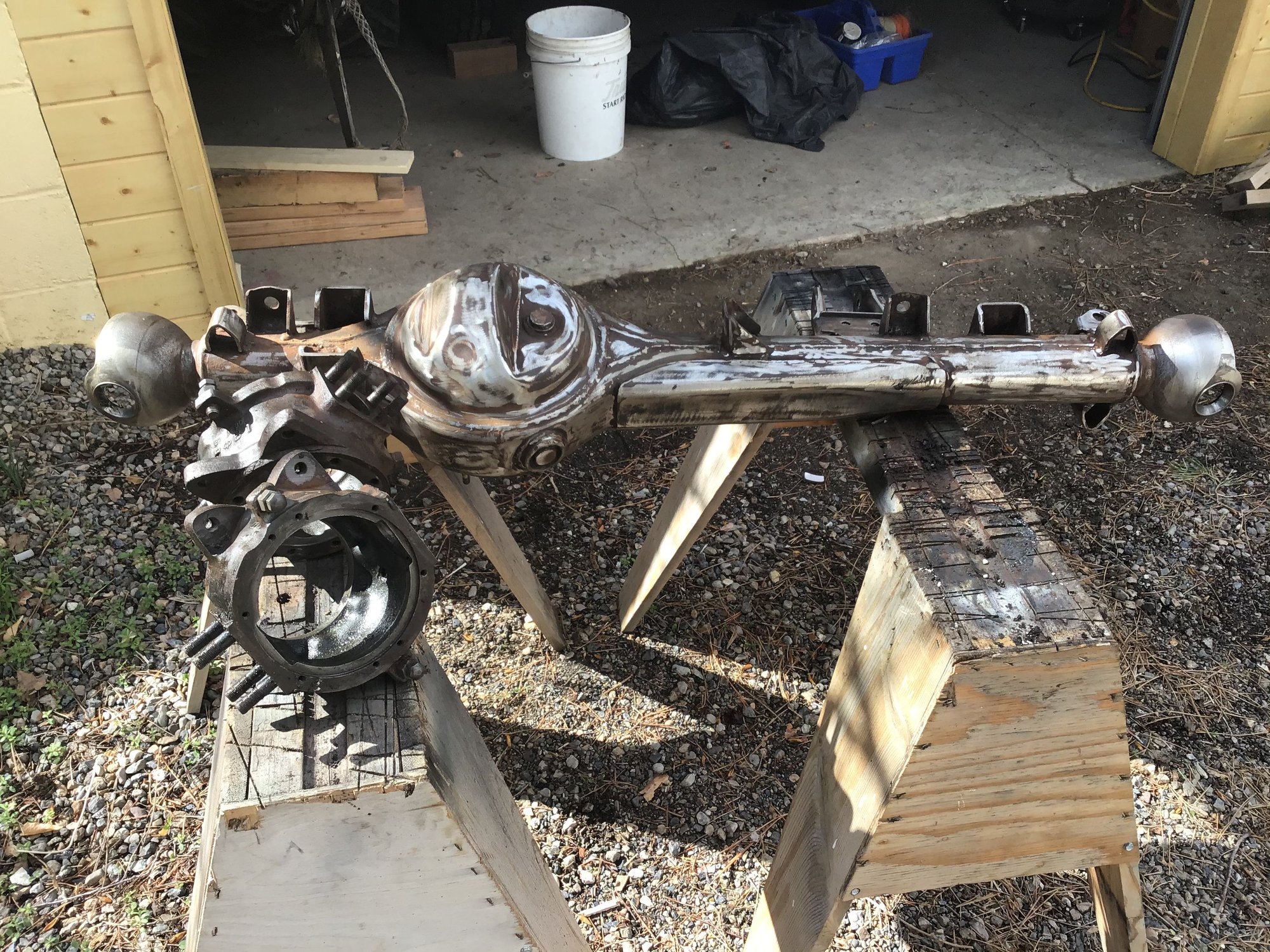

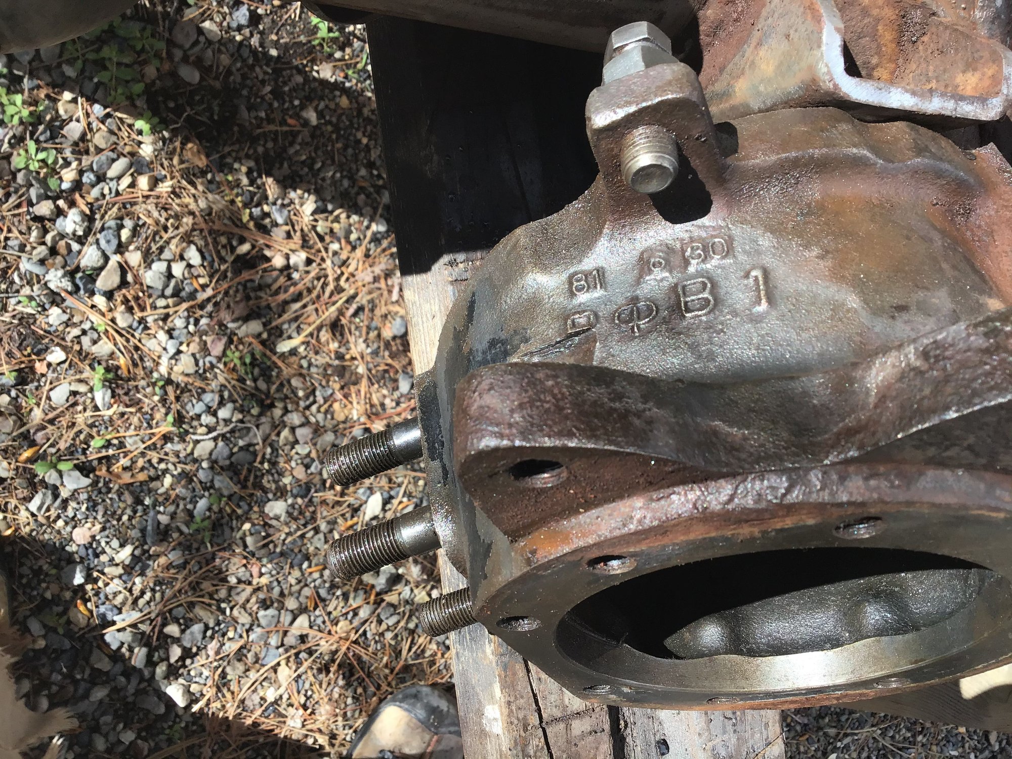

Snow day today so no landscaping. I spent the afternoon disassembling the front axle and prepping the axle housing and both knuckles for paint. I wouldn’t mind if it snowed again tomorrow but the forecast is for progressively warmer temps with Friday at 84. Typical high desert 🙂 Here are a few pics.
Casting date 6-22-81
Casting date 6-30-81

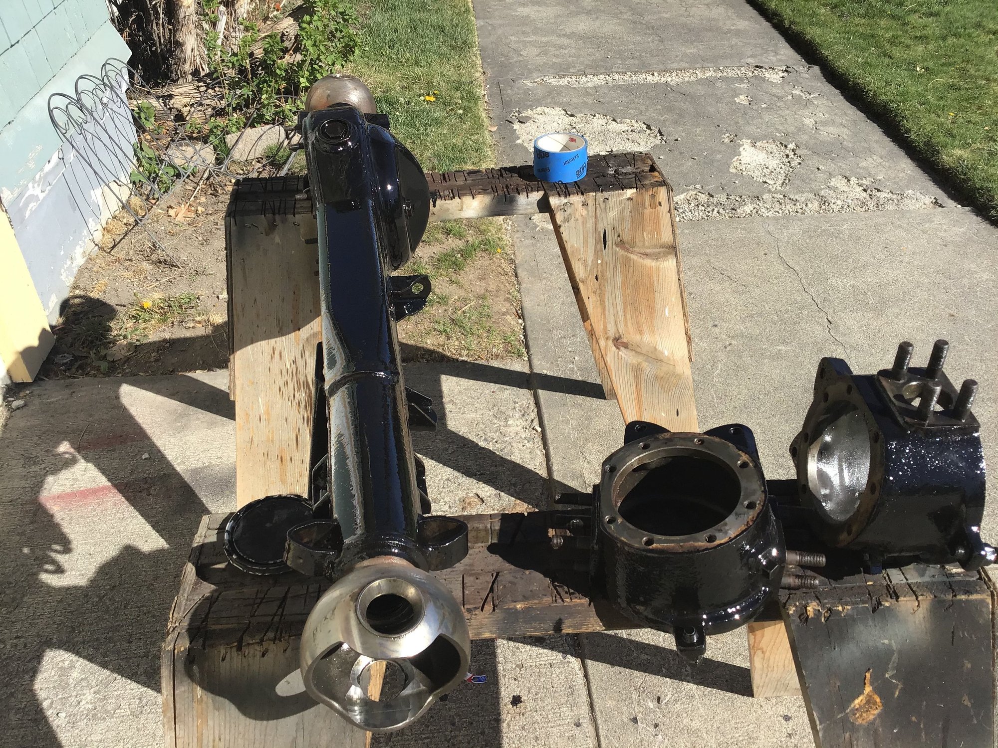

Decided to take off a few hours early today, finished prepping the axle housing and knuckles for POR15 and put two coats on. It was extremely gratifying as these were some of the filthiest parts on the truck.

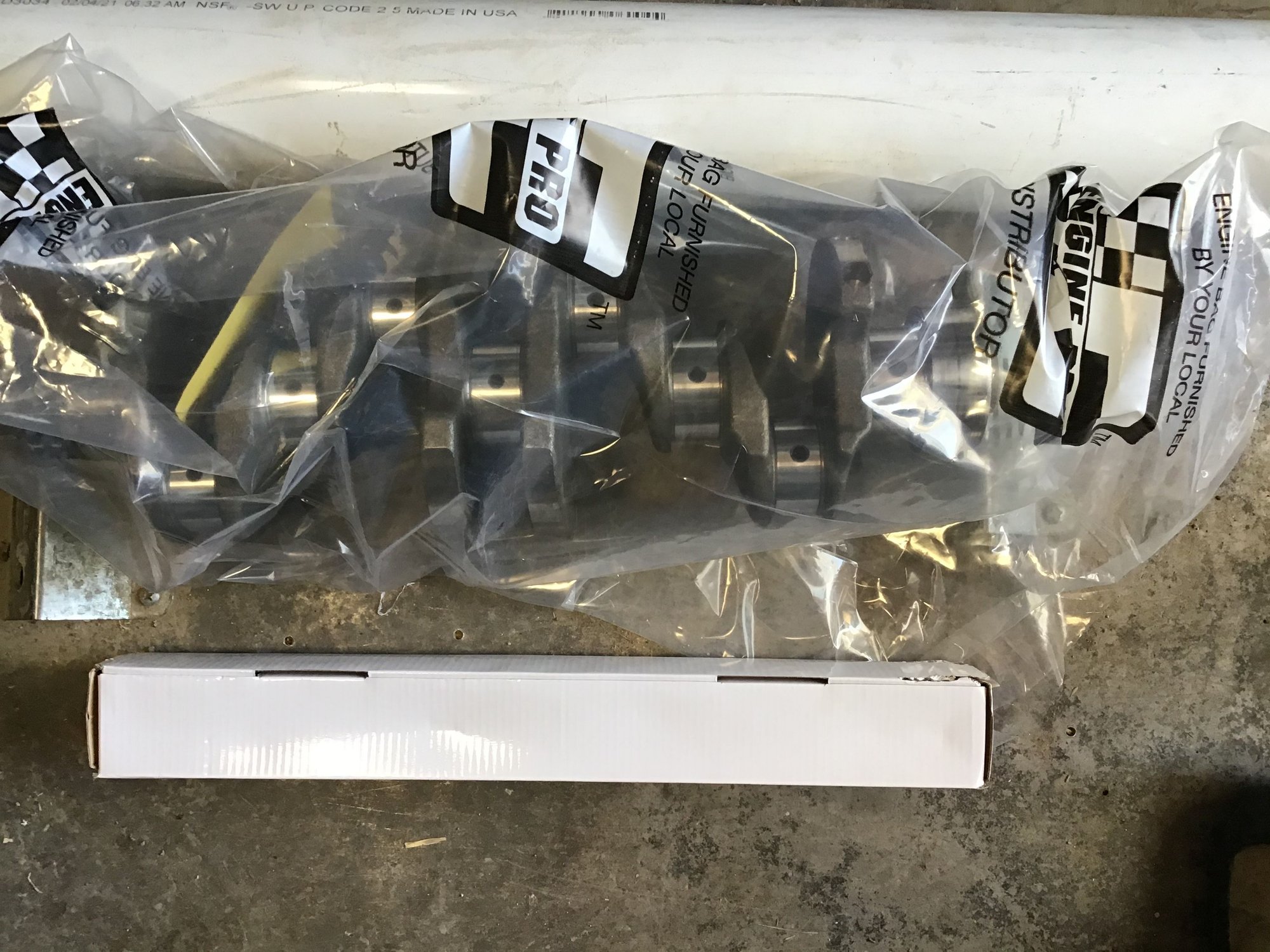

Got a call from the machine shop that my engine parts were ready to pick up. The block was bored .060 over and crank polished. Connecting rods were re bushed on the small end. The head was surfaced, new valves and guides were installed. Here are some pics.
