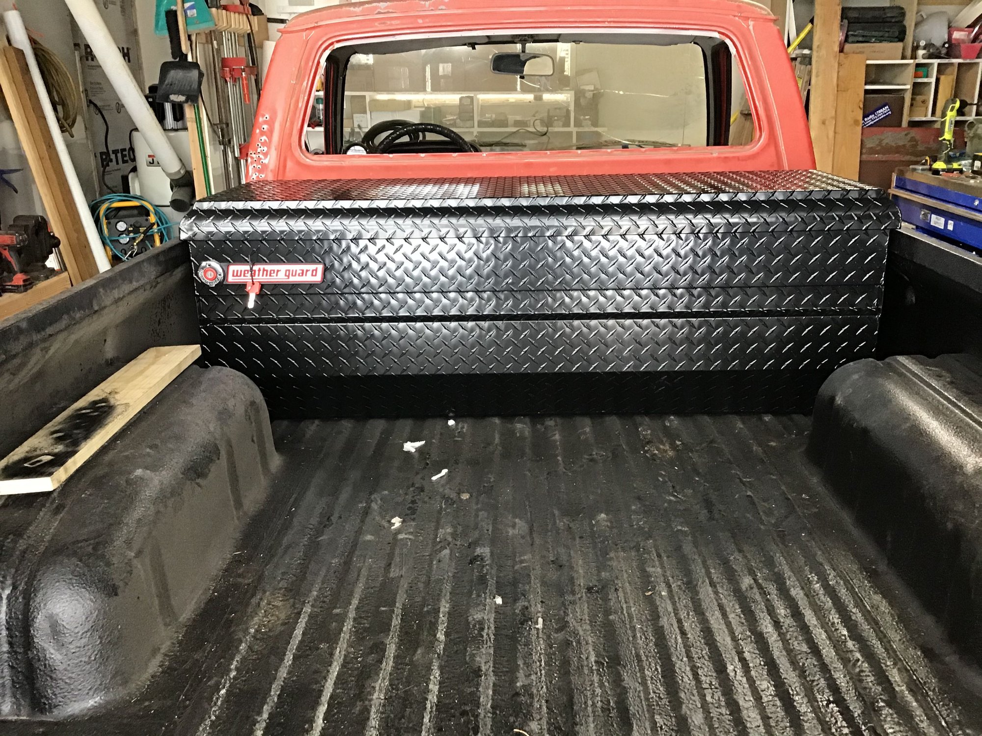

Today was a snow day so I checked the condition of the toolbox which arrived yesterday in damaged packaging. Fortunately the box arrived unscathed. Set it in place to double check the fit and it looks good.

Here’s a view from the side.

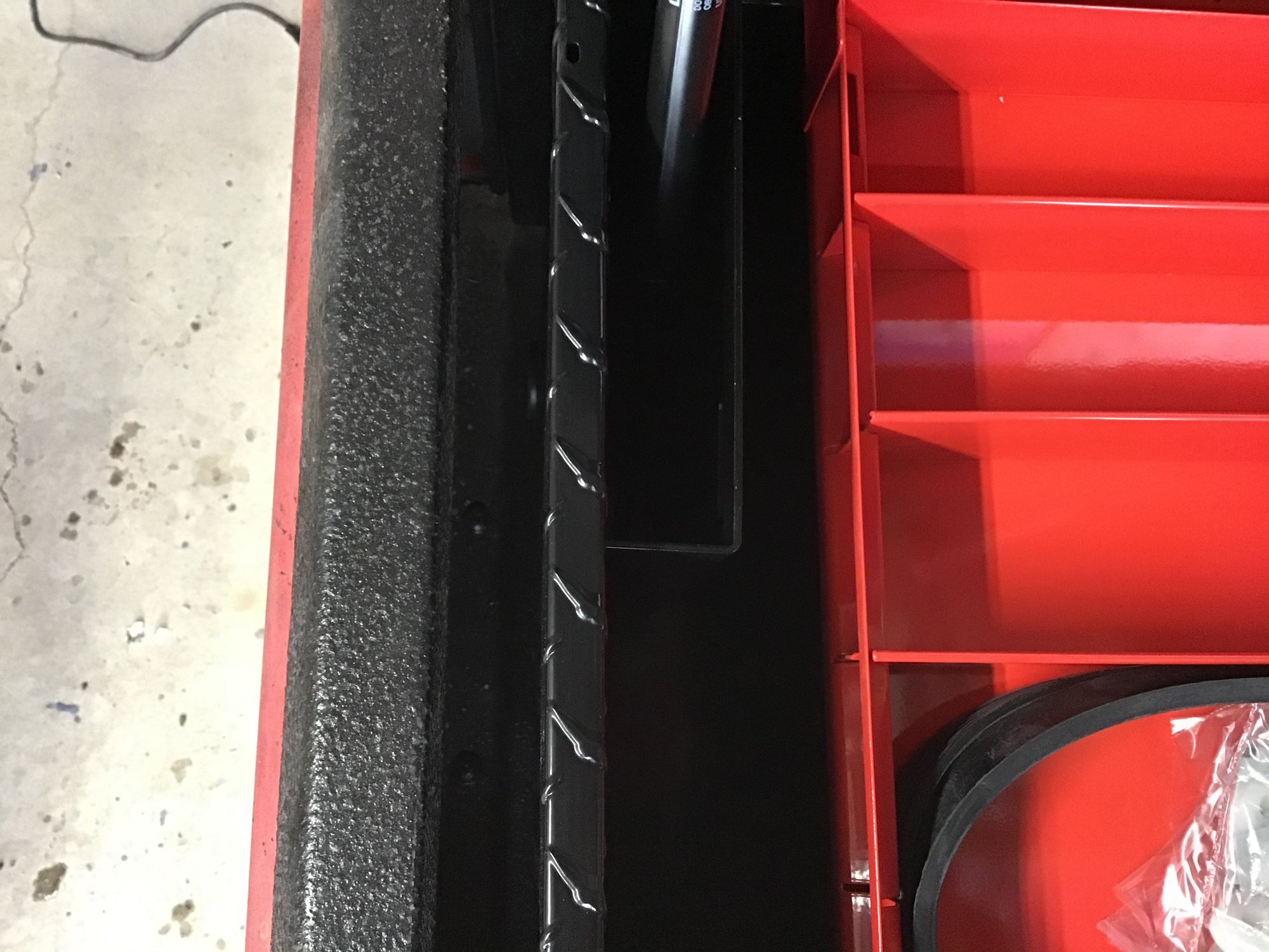

And a view from the top. The box has been pre drilled and rubber grommet installed for power to 12V accessories. Grommet is visible looking down the side of the box closest to the truck bed.

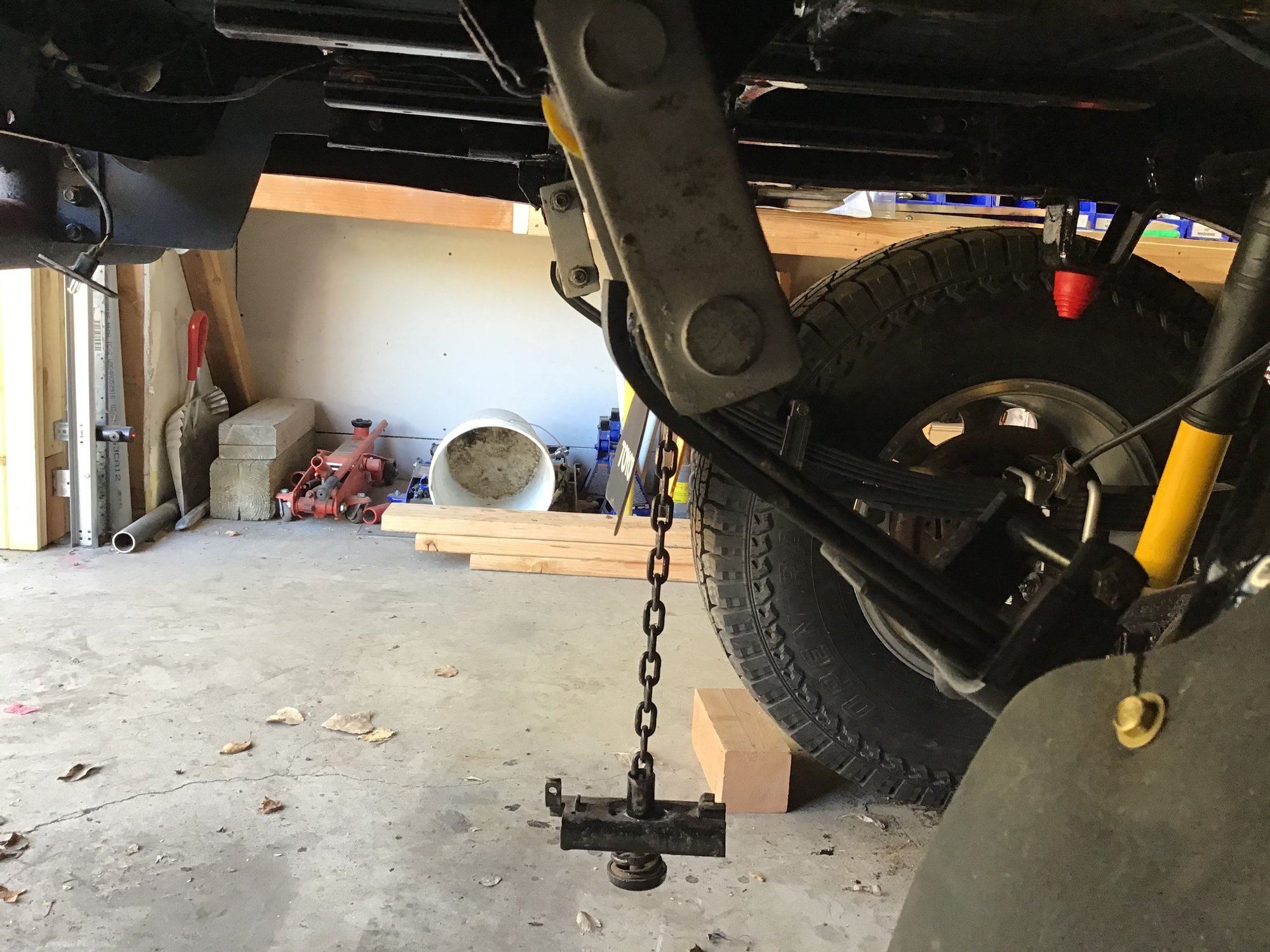

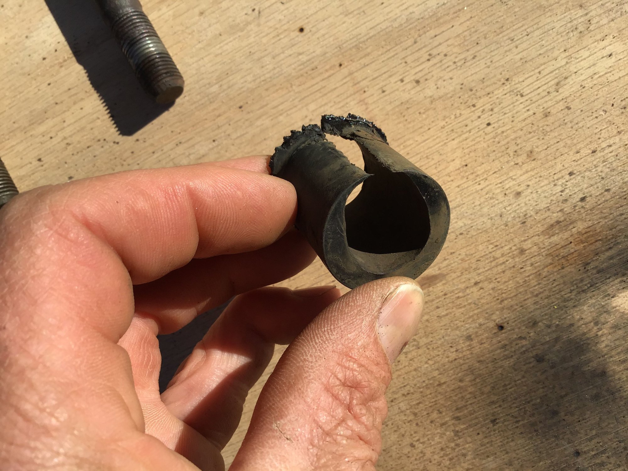

Snow melt/ mud day so I worked around the house and on the Yota. Finished up the passenger side tailgate latch catch. Started on the driver side rear spring with the OME kit and did ok until I got to the front bolt. The bushings on the front bolt would not allow me to remove the bolt. Finally I took a torch to it and the heat cooked the bushing and the battle was over. The spring went on very easily.
Here’s a pic of one of the original bushings which has endured a little wear and tear.

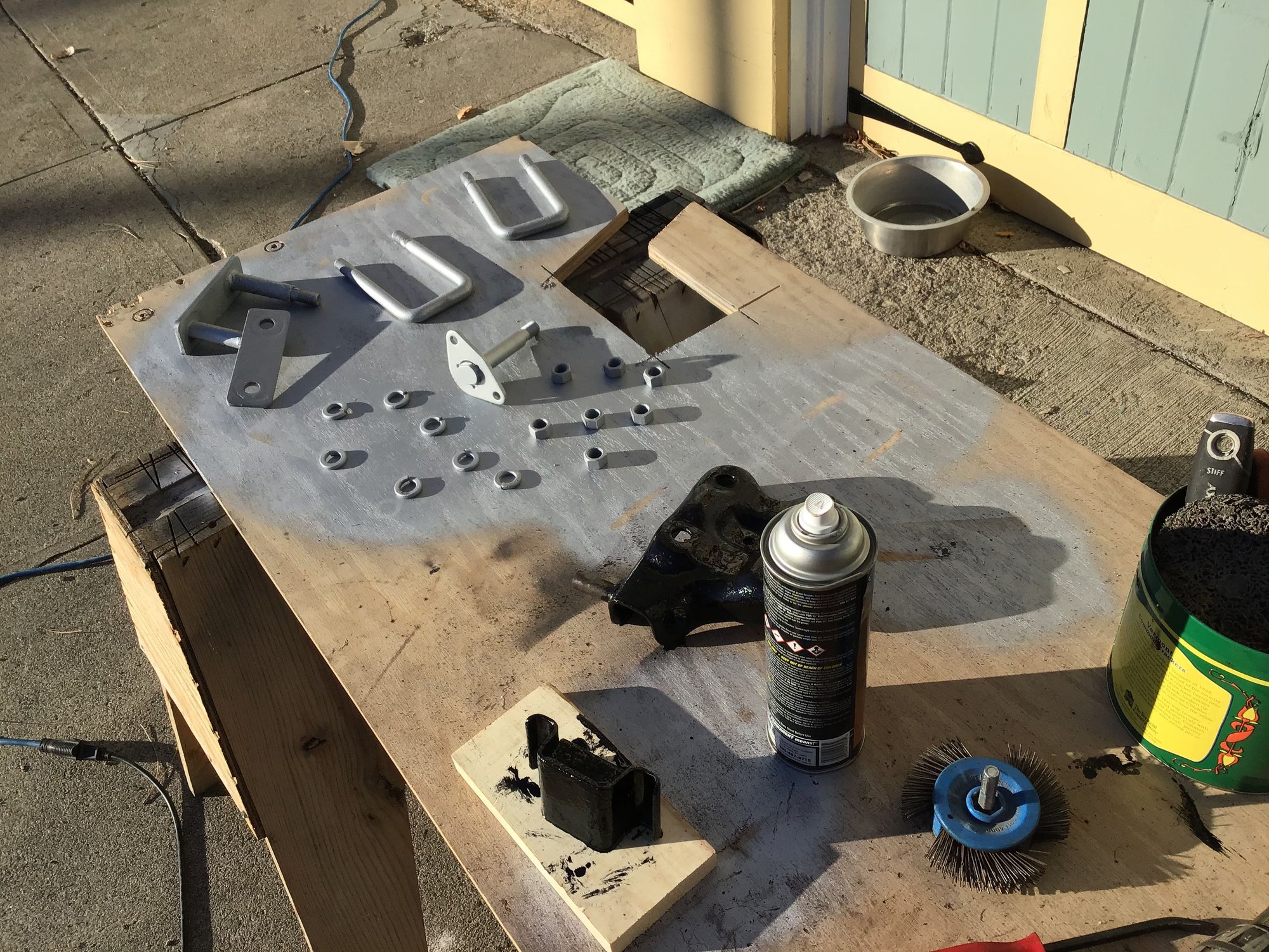

And the passenger side spring removed easily (thanks again to the torch) so I painted everything up and hopefully all goes well tomorrow. Salud!

Wrong picture. Here the parts are painted up. 🙂

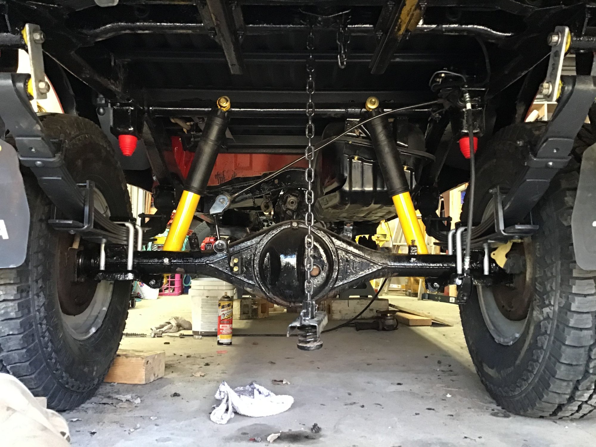

I agree Ivans’s. I was smacking it with the hammer and I could feel it move but as it turned out all it was doing was flexing back and forth inside the rubber bushing. Took me a while to figure out what was going on. Anyways I had a little time to work on it today and got the passenger side spring pack in along with the two rear shocks. The truck now has a lean toward the driver side of about 1/2”. Wish the engine was in I’d take it for a little cruise and see if things settle down properly. Here’s what I’m talking about.
Here’s a pic of the underside.
And here’s a pic of the shackle angles. You can see there is a slight difference between the two sides.
Also the new rubber brake line is too short now so it’s time to shop for an extra long one.

The truck is almost level this morning after settling 3/4” on the high side and 1/2” on the low side.

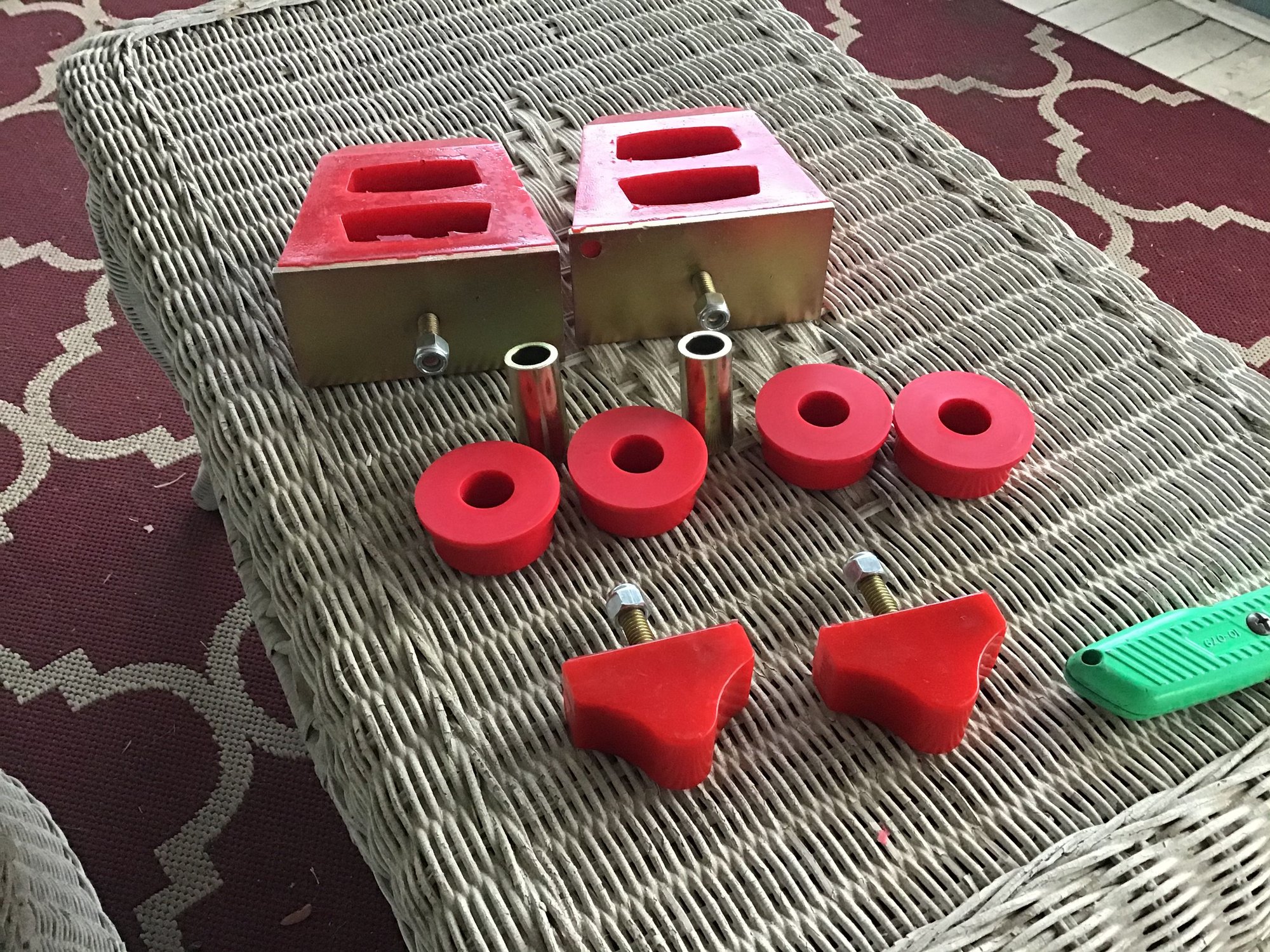

Just arrived home from work to find more goodies from Energy Suspension. The bump stops in the foreground are a GM bump stop but they were the closest in size I could find to the small stops that hang down from the frame just behind the front axle and above the front leaf spring. They’re a bit oversized compared to the OEM Toyota stops but since the OME springs lifted the truck 2” I figure no harm using them.
The bushing kit in the middle is for the torsion bar and the large bump stops in the background I’m using to replace the OEM bushings that sit on the front axle in between the spring pack U bolts. Again they’re oversized compared to OEM stops but probably pretty close to the right size considering the added lift. Cheers!

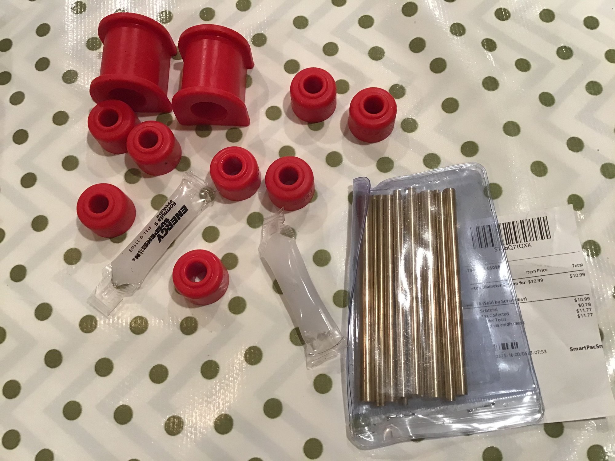

More parts from UPS tonight. Sway bar bushing kit (sway bar is back ordered until 4/26-5/3) from Energy Suspension and a set of brass rods (punches) ranging in size from 2-8mm off Amazon for a very reasonable price. Since I don’t own any brass punches and need to disassemble my front axle to install a new third member assembly the brass rod assortment seemed like a good way to go.
