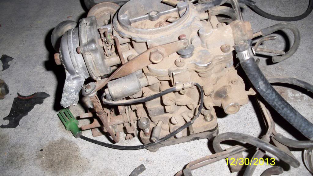

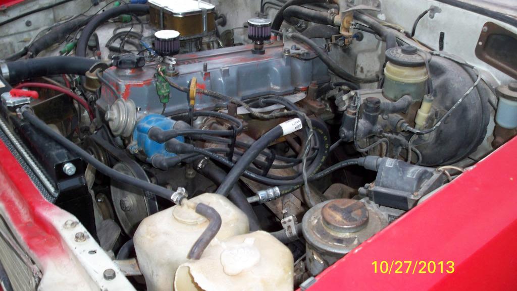

The first thing i did was pull the carb out to try and find out what it was. After about
2 hours, i found it to be a 32/36 E-Choke(not connected) Weber. I wish i had taken pic's of the dis-assemble, but it didn't come to mind to make a thread. After cleaning it and checking all the little ports for possibly sand, i put the gasket kit i order from the webers site, about $31-ish.

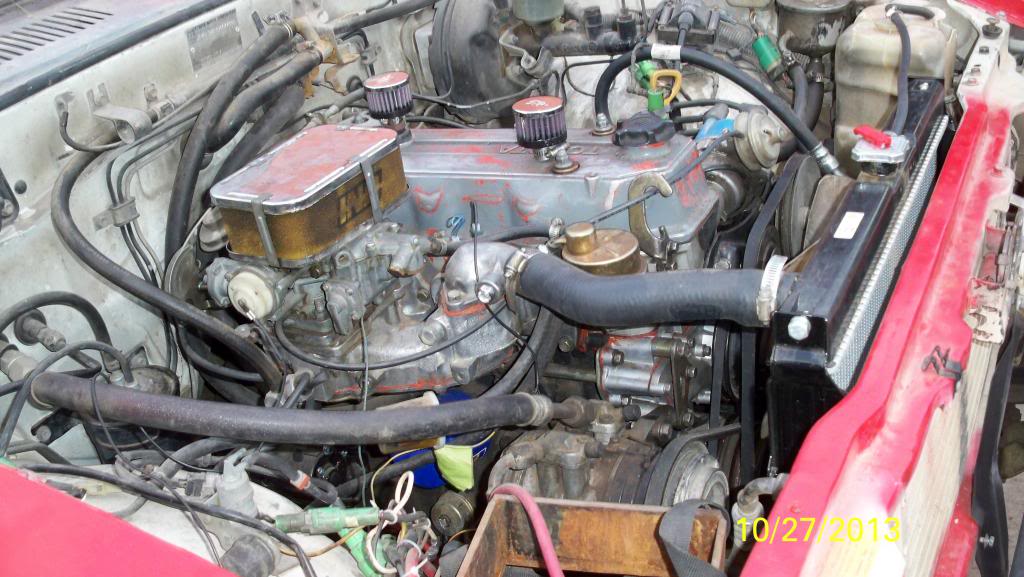

Then i had taken apart the cylinder head, and oil pan (for peace at mind) to check the condition it was in. The block was just perfect, but the head needed a bit of cleaning and the oil pan bolt hole had to get straighter. After that i took 320 sand paper/cotton like rotary piece and smoothed the combustion camber, and polished.
And just clean up everything else, dirt duel-plane intake, emission ports(thick black walls). The old radiator had a bad core, so i put an aluminum single row just like my 4runners. It does get just a little warm, but i got a hose to redirect, and it only has water in it.
Here's what it look like now
If the the engine is clean,something must be wrong.
After putting it all back together, i made a wire from my alternator to the electric choke.
And man did it start running beautifully, was able to get at 1000 rpms (sounded sexy) and start up.
Had put in for the engine, gaskets, lude, oil filter, cyl. head cover air filters, and a new starter.

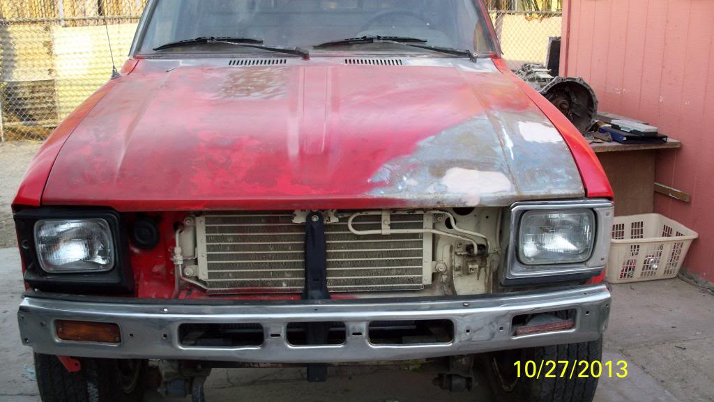

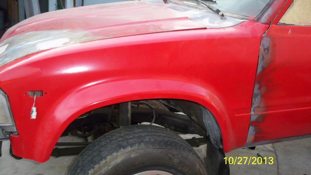

Next was the body, imagine the entire cab, hood, and fenders cover by a layer bondo and then premiered over. I took a 40grit sand paper to the fenders and hood first, went down to the metal, hammered (not to perfection, it is a truck)and cleaned with mineral spirits. Add 3 layers of Rustoleum red cherry enamel, the fenders temporarily done.
The hood on the other hand i didn't complete, 3 areas i gonna have to bondo since the metal was too stretched. i left it until the rest of the truck gets painted.

Man look at all the rtv my god I would put new gaskets on that thing quick

Looks good! You mentioned you have only water in it now, I suggest flushing it or putting an additive in because water will rust out everything and create nightmares, it also boils at a lower temp than coolant and has not lubrication to it, but the worse thing really is corrosion.

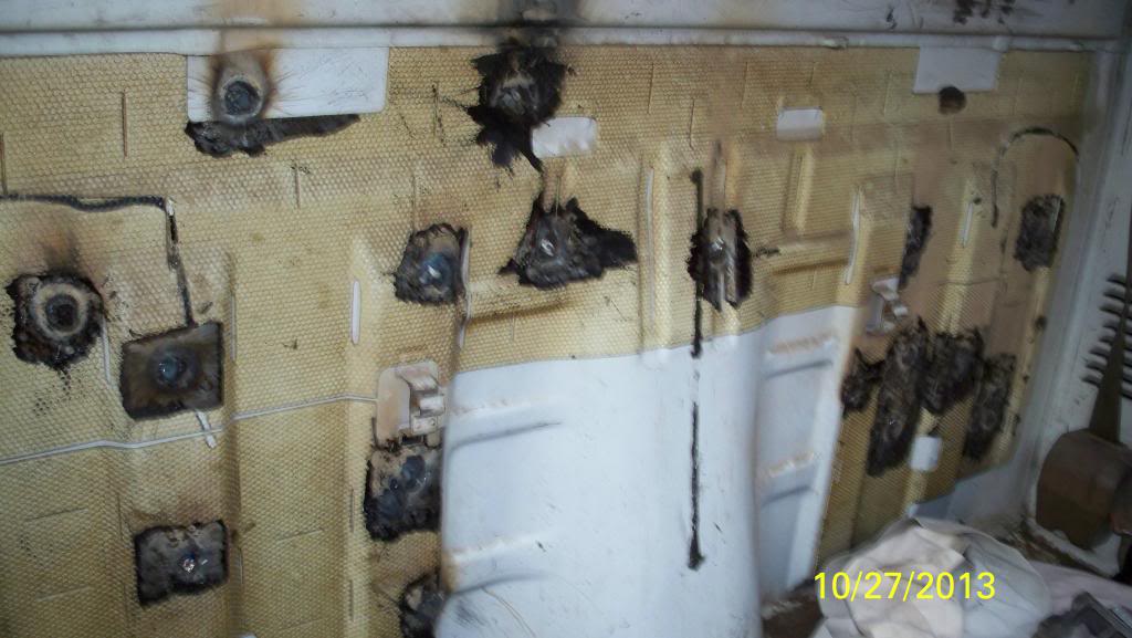

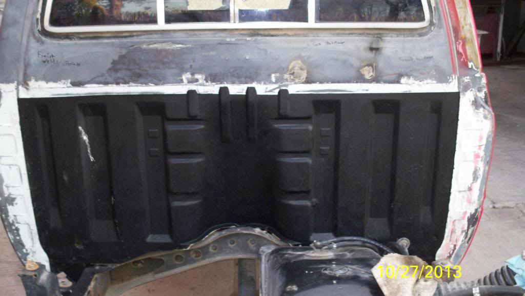

Also i notice a lot of screw holes on the back of the cab, i believe the other guy had a system (amps, crossovers, etc.) in the truck. So i decided to weld those up and smooth the outside of it, then added some Dupli-color Kevlar Bed Armor. Nice.
Had metal termites.

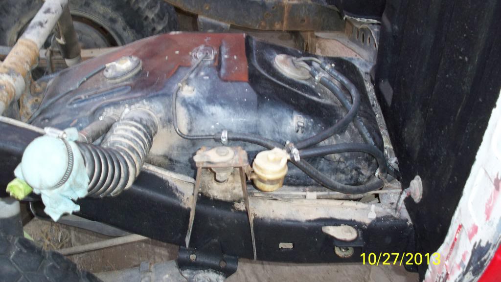

I even did some of the frame (not done), did all the fuel lines and played with the filter i put between the carb. & steel fuel line.
Will get front filter pic later.

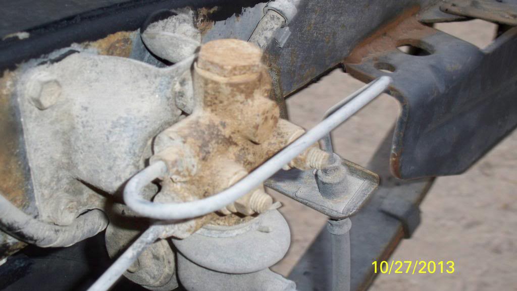

On a side note, i thinking of removing this and given it a good cleaning, but on the side line because nothing is wrong with it, no crud in the lines all brakes work. What do you guys think?

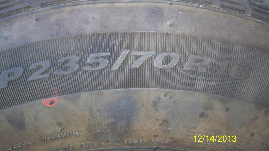

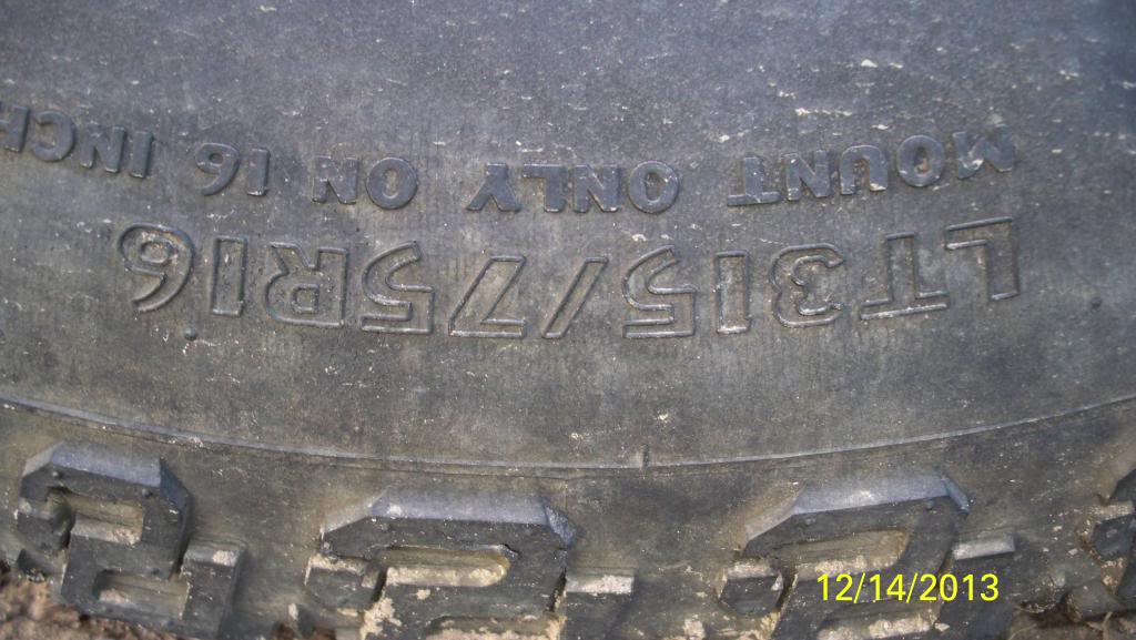

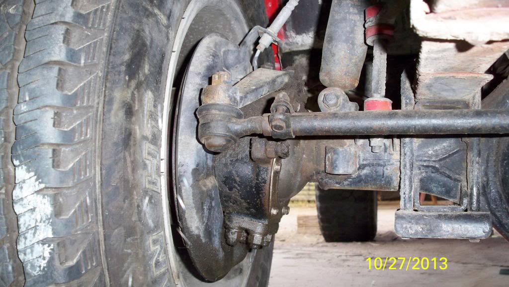

Also put a set of aluminum wheels on 16x8, with an 1.25" wheels spacers on the front. Other wise it would be right on the pitman arm, Before there were 15x11.50 Steelies on 32" BFG M/T's, to much for the 22r to drive done the road with enough push. wasted a 1/4 of the tank going about 8 miles to a buddy's yard, straight from where-when i just bought it.
Nice safe spacing. Will get images

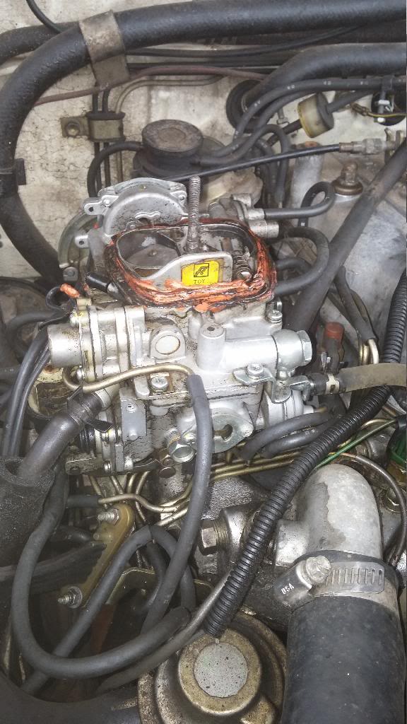

Originally Posted by 83
Why is that people who go crazy with rtv always do it with red?
Yea p/o RTV jobs make me feel real confident.

For AZ, just to be clear, I'm not mocking your truck at all. Just what a previous owner did to it. If you're the one who did that rtv job, well...I can't say I agree with your methods, but if you know what you're doing, I won't argue!

So continuing from the wheels, i bought these wheels from a guy that had them on a dodge diesel truck lifted. The ones from above images, they're aluminum with 2 different sets of tires front and rear. Rear has Mickey's and front Dunlop.

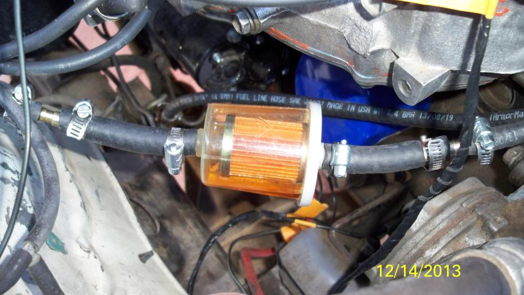

Here's the rigged fuel filter redone with two brass fittings, and correct rubber lines to fit the filter and factory metal lines and fuel pump. Can see the redone wires in the back.

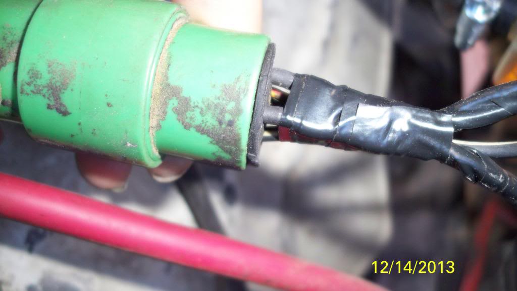

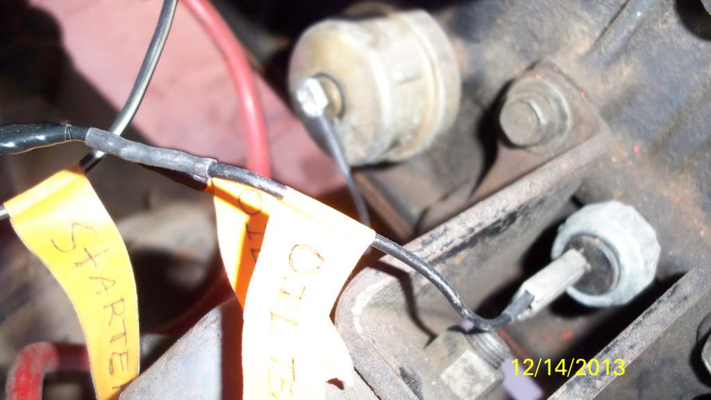

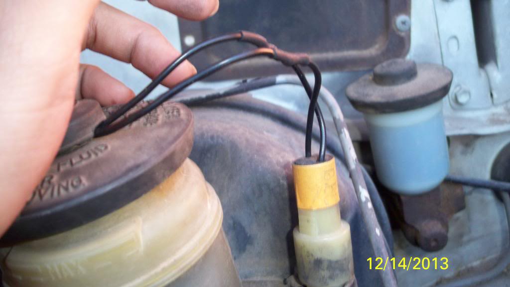

I also re-did some wires on the brake fluid container and plug, plug for four sensors and starter all wires done with 18-gauge.

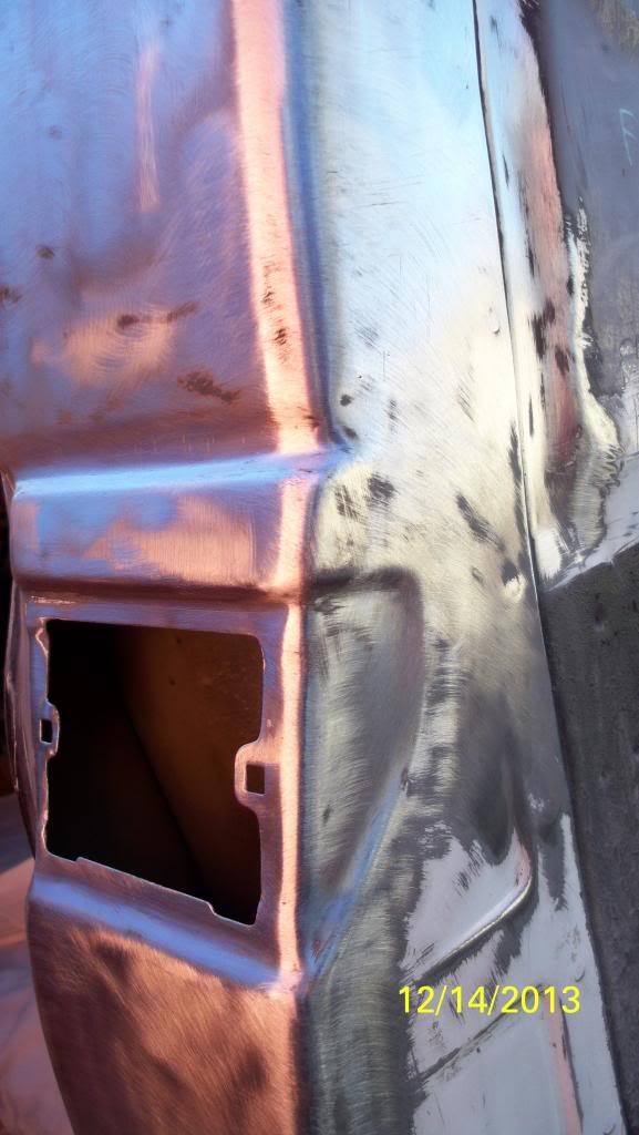

To give and idea, i take the paint all the way to the metal and then do and final 400/320grit wipe down to the surface and clean with mineral spirits, then add the Rustoleum rattle can.

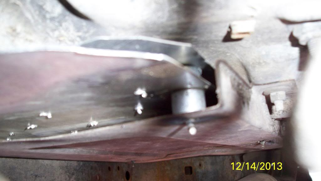

Here's the two pieces of drilled aluminum sheets and 1" piping on the heat shield to reduce the muffler heat on the drivers side. Double tacked on four screws.
And the plate i had to rig.
